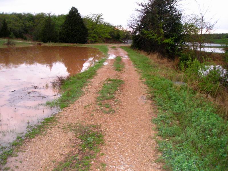

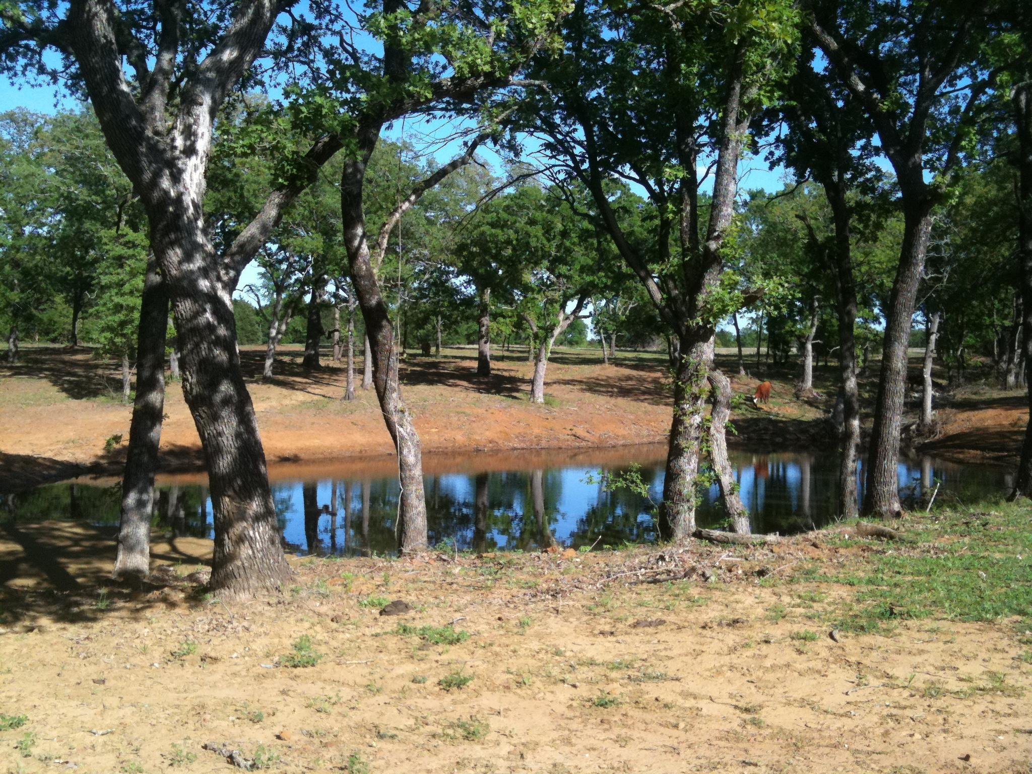

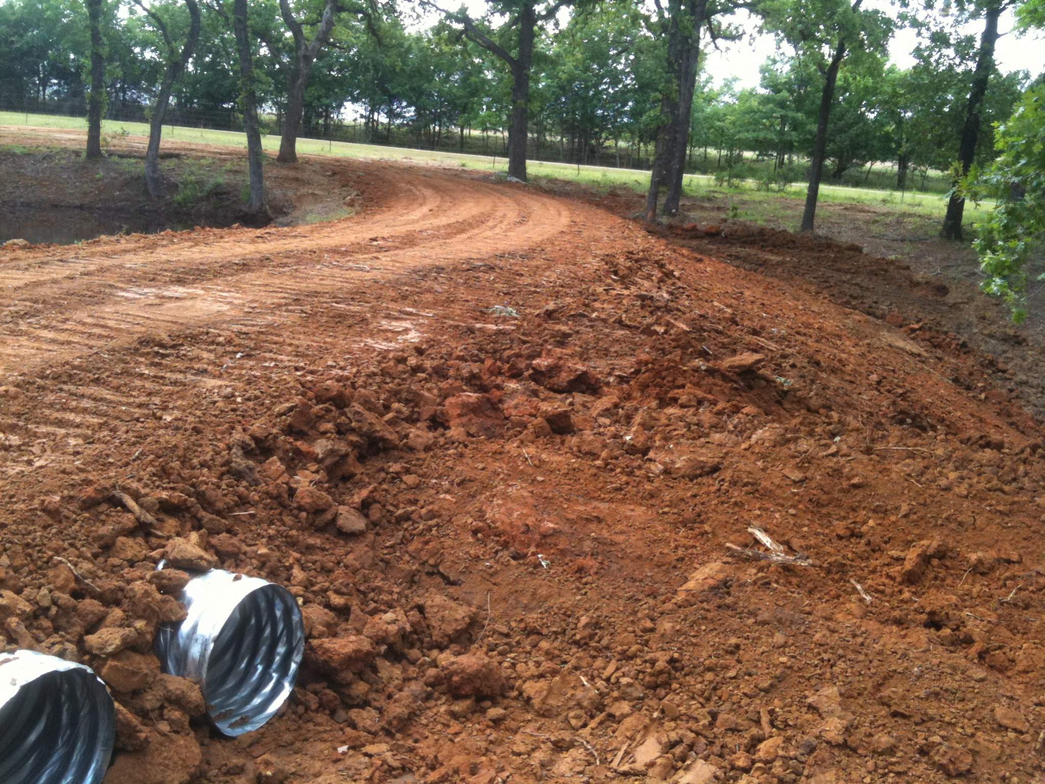

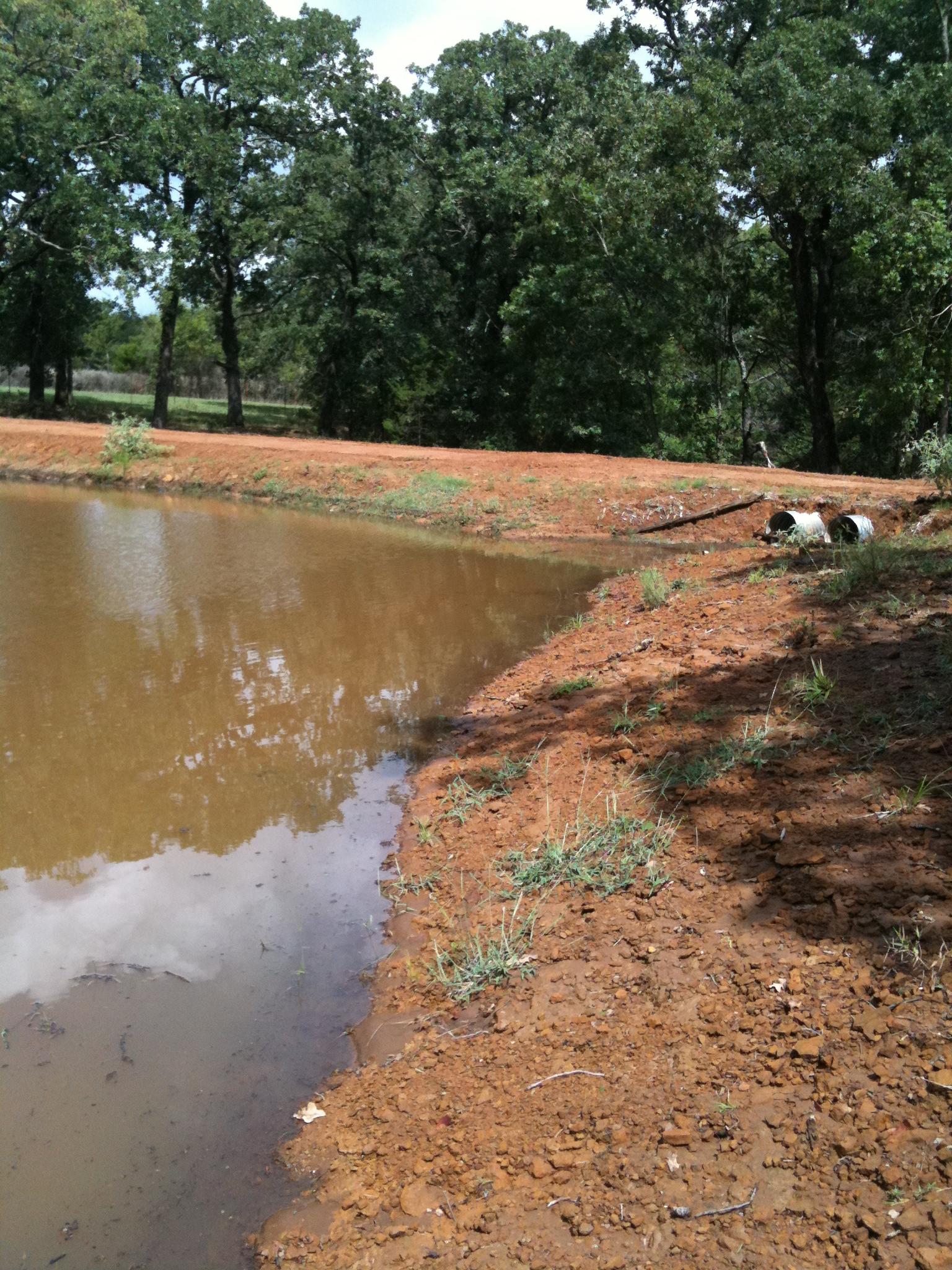

I've really enjoyed reading and exploring this thread Eddie. I lived in Tyler myself back in the late '90s and know how beautiful it is out there. There are lots of great tips you've revealed in this thread about maintaining a body of water. Back in April, the wife and I bought our place with a newly created pond...and from day 1 I've been worried about the dam giving way. Luckily, the man that sold it to me and built it has been running a dozer company for many years and knows what he's doing. He's also my neighbor :). It's red clay based and he put in the tin horns just after we closed. It's a relatively small pond, but is at least 20 foot deep next to the dam since it was a deep creek ravine before. I hope to buy another 30 acres from him someday. We've had a few good rains and everything seems to be holding up well. I just need to get some grass growing on it. You've inspired me to start a thread myself as I work to correct some erosion, grow my 100 starter catfish, and basically just beautify the thing. My bigger concern at the moment is the other side of the tin horns after a big rain (not pictured) but I'll chronicle some of that in a separate post. Once again, awesome job on Lake Marabou.

I like how open your woods are. I'm trying to do that in areas, but it's a very slow process. How big is your pond? My small pond is 3/4 of an acre and I started out with 200 channel cat fingerlings in there. I think that was five years ago, and with daily feeding, and not a lot of fishing pressure, I have quite a few over ten pounds and the current pond record is 12 pounds. Nobody has even fished it in months and to my knowledge, about a dozen fish have come out of it this year.
I didn't build a dock on it at first because I didn't think I wanted one. That was a mistake, and after building the dock, it's eveyones favorite place to be. I almost started building a dock on Lake Marabou this year, but keep pushing it back to do other projects. It's high on my list and something I really want to do next year. Eventually, I hope to hav five floating docks.

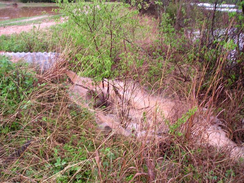

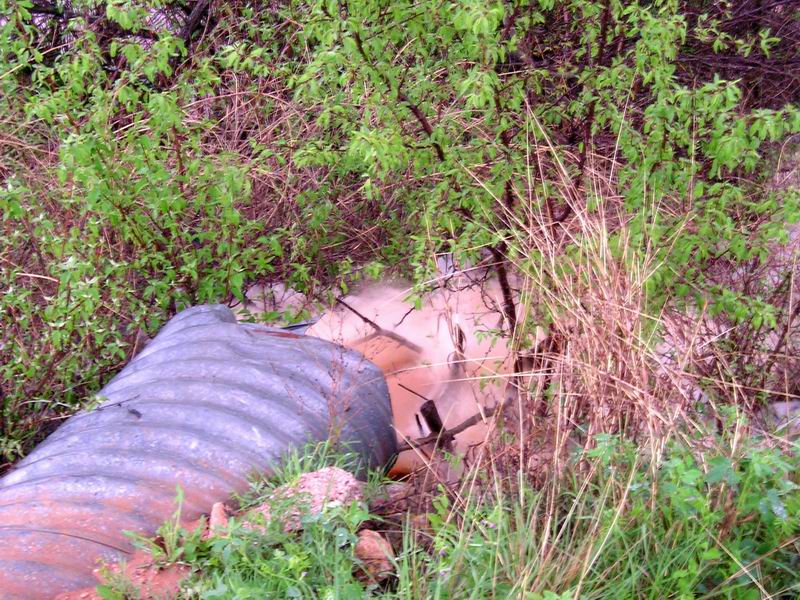

The back side of your pipes has errossion issues written all over it. I've seen how much water can go into a pond really fast, and what that water has done to my culverts going into Lake Marabou. None of my culverts are part of the dam, and only slow down the water going into the pond. If it was to let water out, I'd line all of it with concrete.
You also don't have much freeboard above your pipes. I don't know your area, but my spillway is 20 feet wide and I saw it well over a foot deep with water coming out of it just a few months ago!!!! That was very scary. I was lucky. There where quite a few ponds that failed because of that one storm. From what I understand, erossion at the back of the pipe is what washed out the dam. Once it gets to going, nothing will stop it until the water is done flowing.
When I finished the dam, it was November. I planted hulled Bermuda seed then and it started to grow. Then it died off and I thought I had wasted my money, but once it got warm out, that grass really took off!!!! In hindsite, I got lucky. Sometimes lucky is better then good. LOL
Good luck with your pond and I look forward to your updates on it when you start your thread on it.
If you add the part upstream out of the picture, it might add up to half an acre total, it's shaped like a long tadpole and very deep at the body
Your right, we've had a couple of isolated big storms that caused a little erosion around the end of the pipes but mainly because I can't get the grass to grow yet.
I'm watching this area closely, so far the two overflow situations have run through the pipes.
Good luck with your pond and I look forward to your updates on it when you start your thread on it.Eddie
Thanks, these pictures are 6 months old and I've gotten some grass and ground cover to grow since. I'll be taking fresh pics when I start a project post.

Tony, if this question was for me...not a huge problem for me because of a drought this past summer, but I do most by hand with loppers, and little by little I'm digging up the thorny vine root balls with a grubbing hoe. Other than the thorny vines, my other challenge is getting rid of the unwanted cedar and various oak saplings.
If your thorny vines have heart shaped waxy leaves, I think they are common greenbriars. The root balls are a source of stored energy and they will bring back new plants with renewed vigor everytime you cut them up until they use up all their stored energy and give up. If you let them get a few inches tall, they rebuild the energy in the root and will never die. I've eliminated mine in my yard by years of close mowing and using the string trimmer. Goats absolutely love young greenbriars and will eat them down to the nub so that they will finally give up and die. Actually, some people also use the young leaves in salads because they are edible. Old dry greenbriar vines have about the worst thorns around except for mesquite.
I agree with Eddie about the back side of your culvert on your dam. I don't think any grass will successfully prevent erosion. I'd use rip-rap stone or maybe build a cascade waterfall with bag concrete to prevent undercutting. I think that's a lot more important than the amount of freeboard you have above your culvert as long as you don't have water that regularly overflows the culvert area. I have one culvert that has been in over 15 years and it has only about 12" of clay freeboard above it. It has never been a problem, but I have lots of football and basketball size rock on the backside to prevent erosion and undercutting by water flow.

Yep I have to agree with Jim. From what the photo's show it will take more than grass to hold back the eventual overflow of water that is going to come through those culverts. Rock is what I would be putting on the outflow side.
