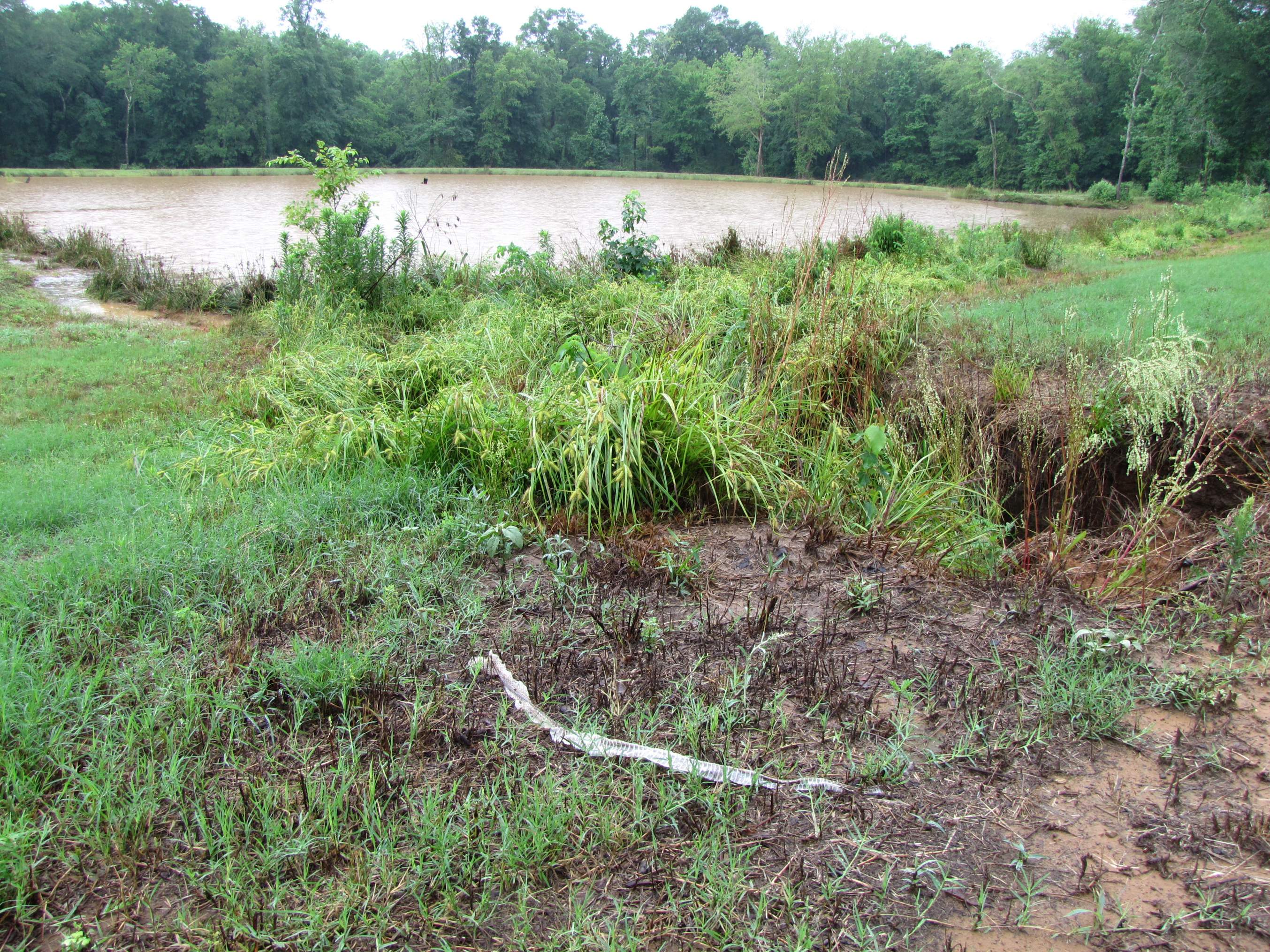

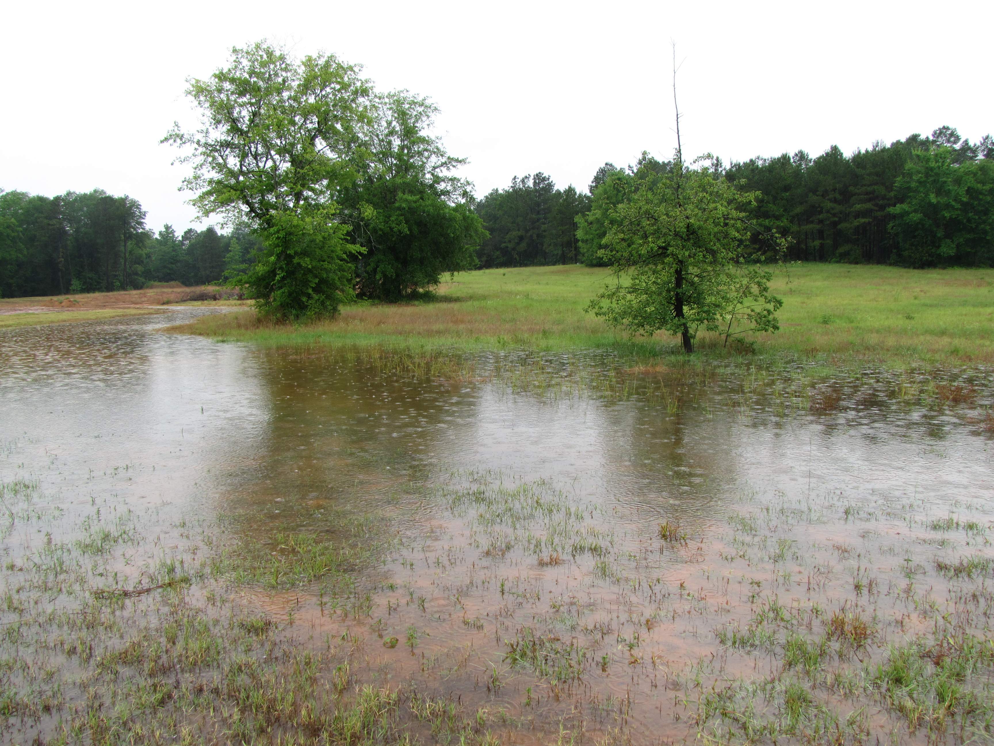

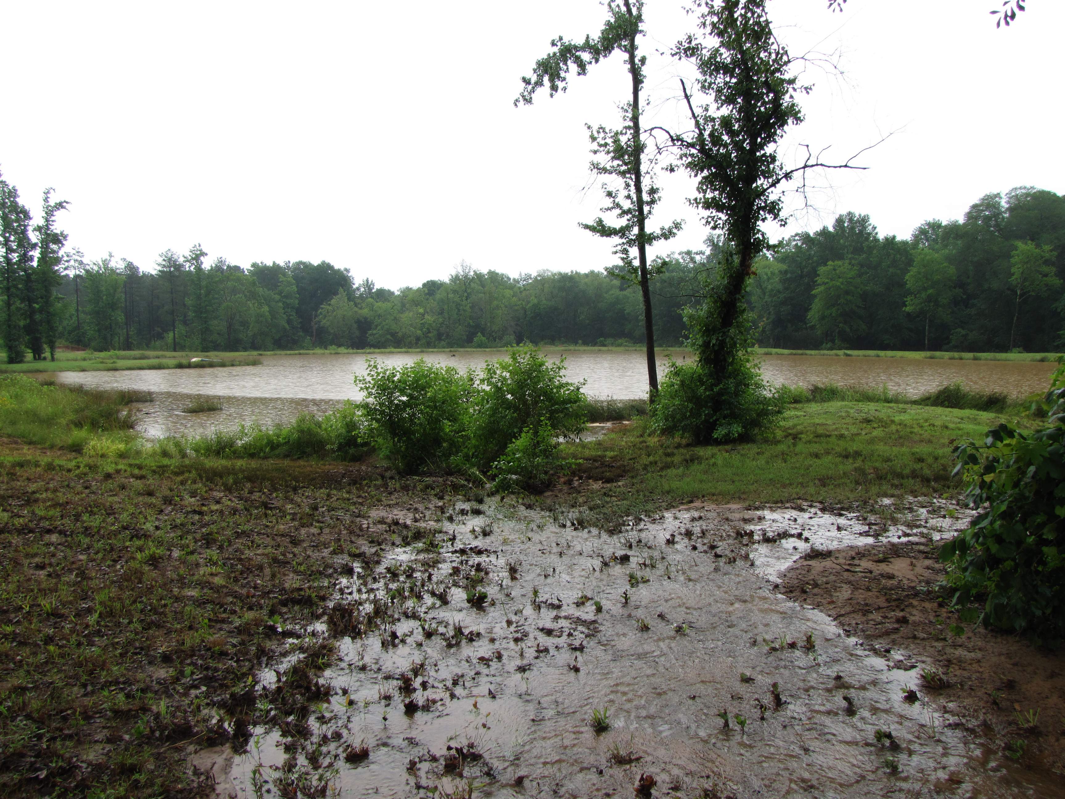

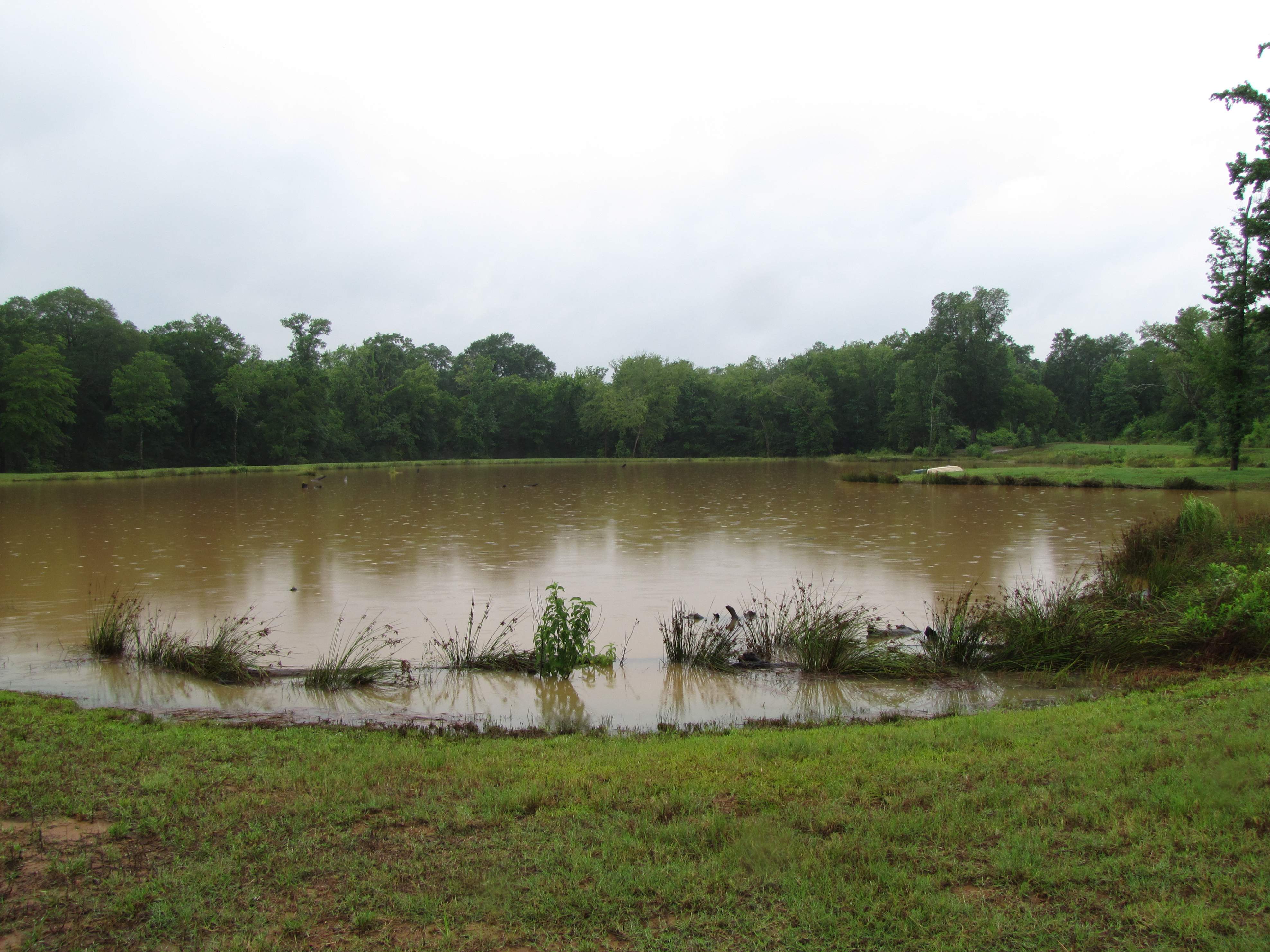

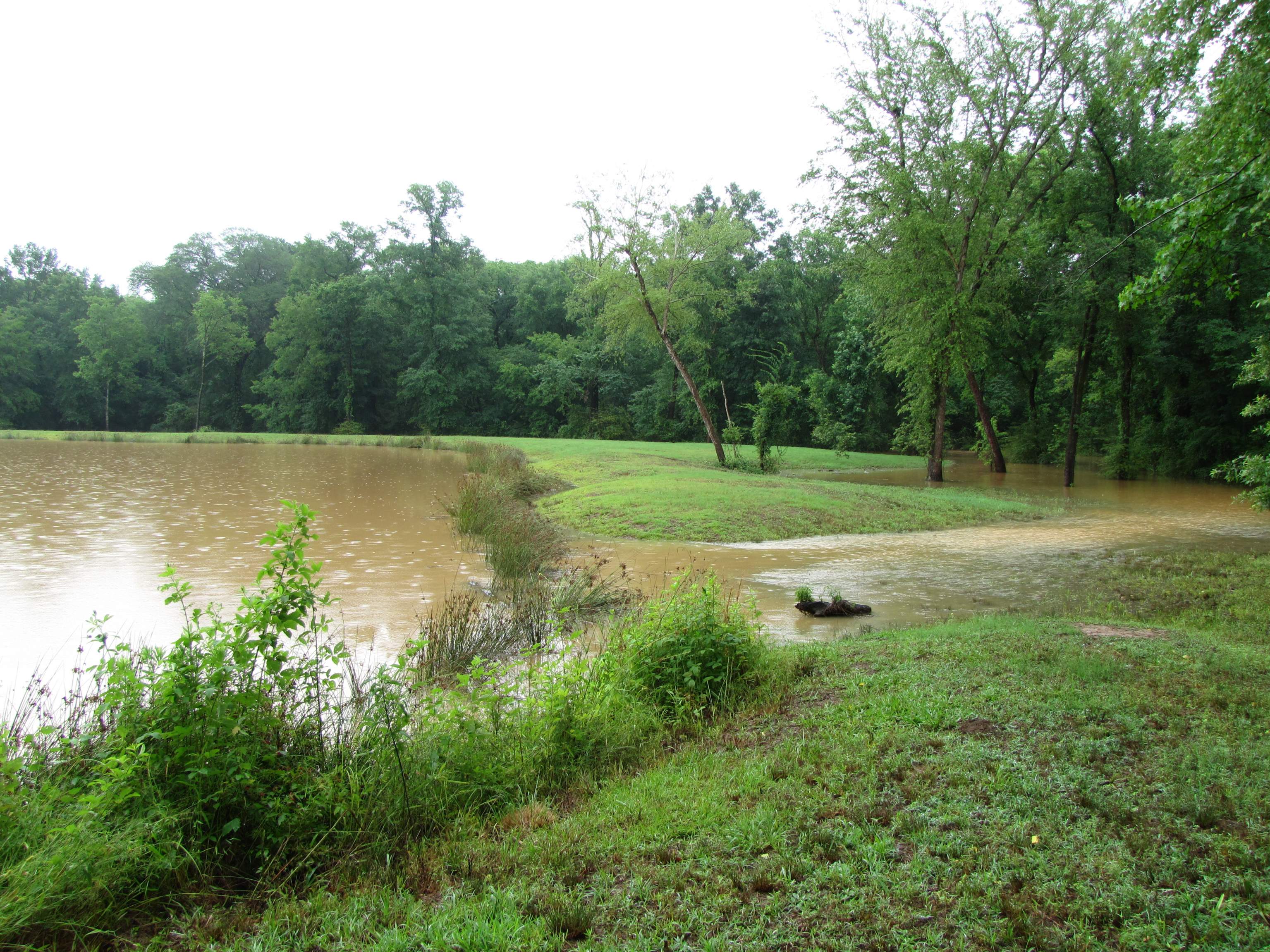

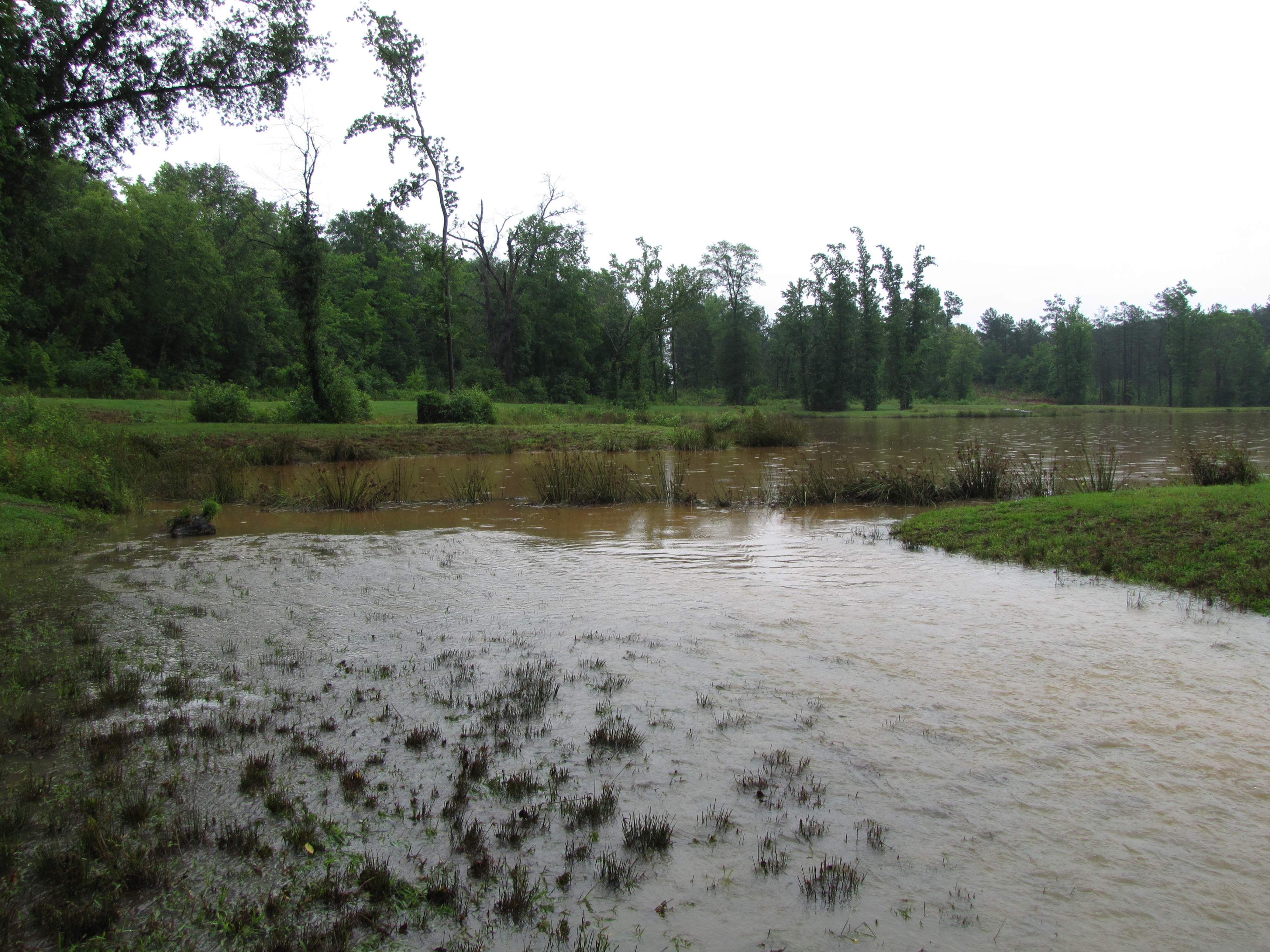

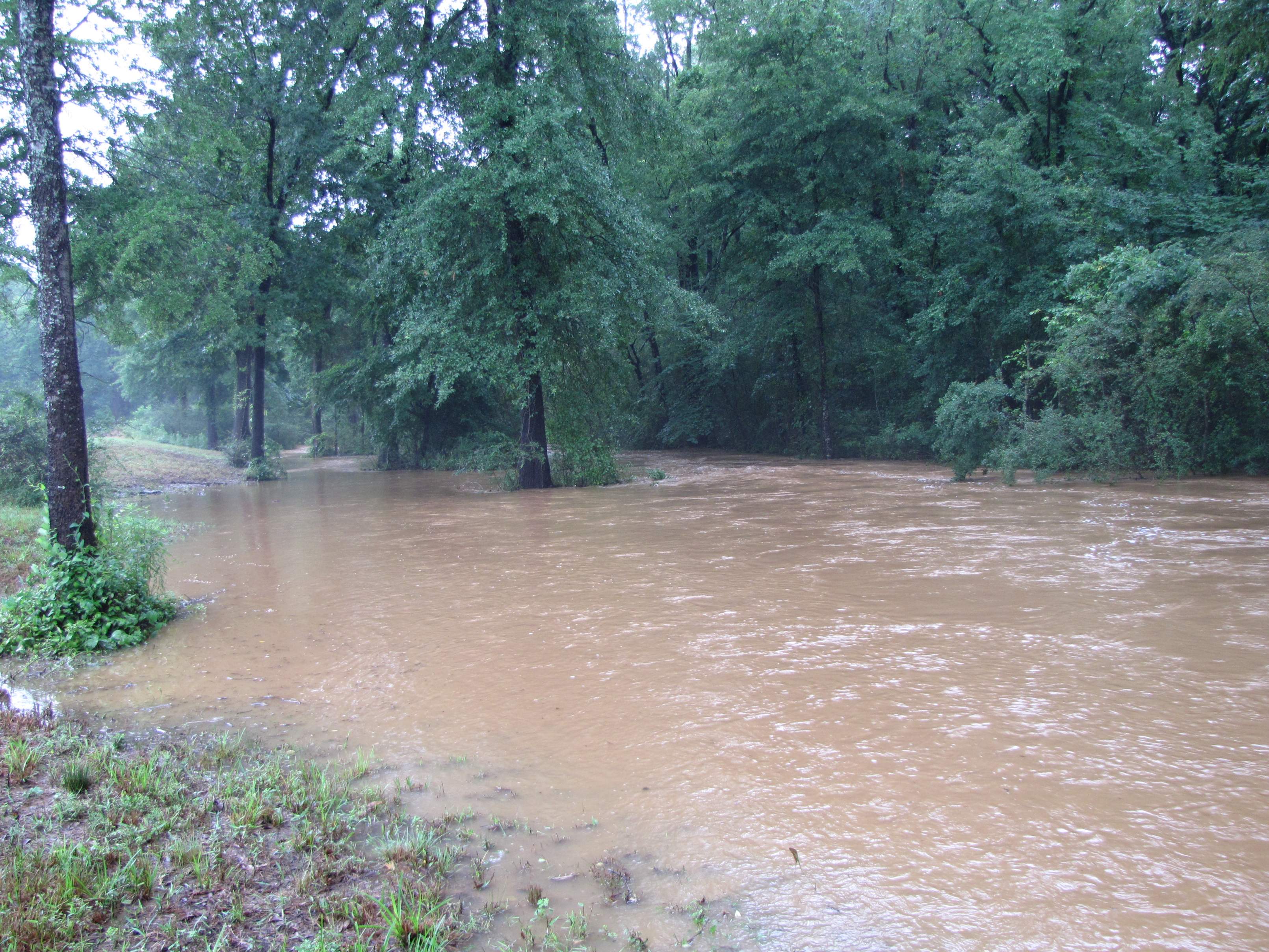

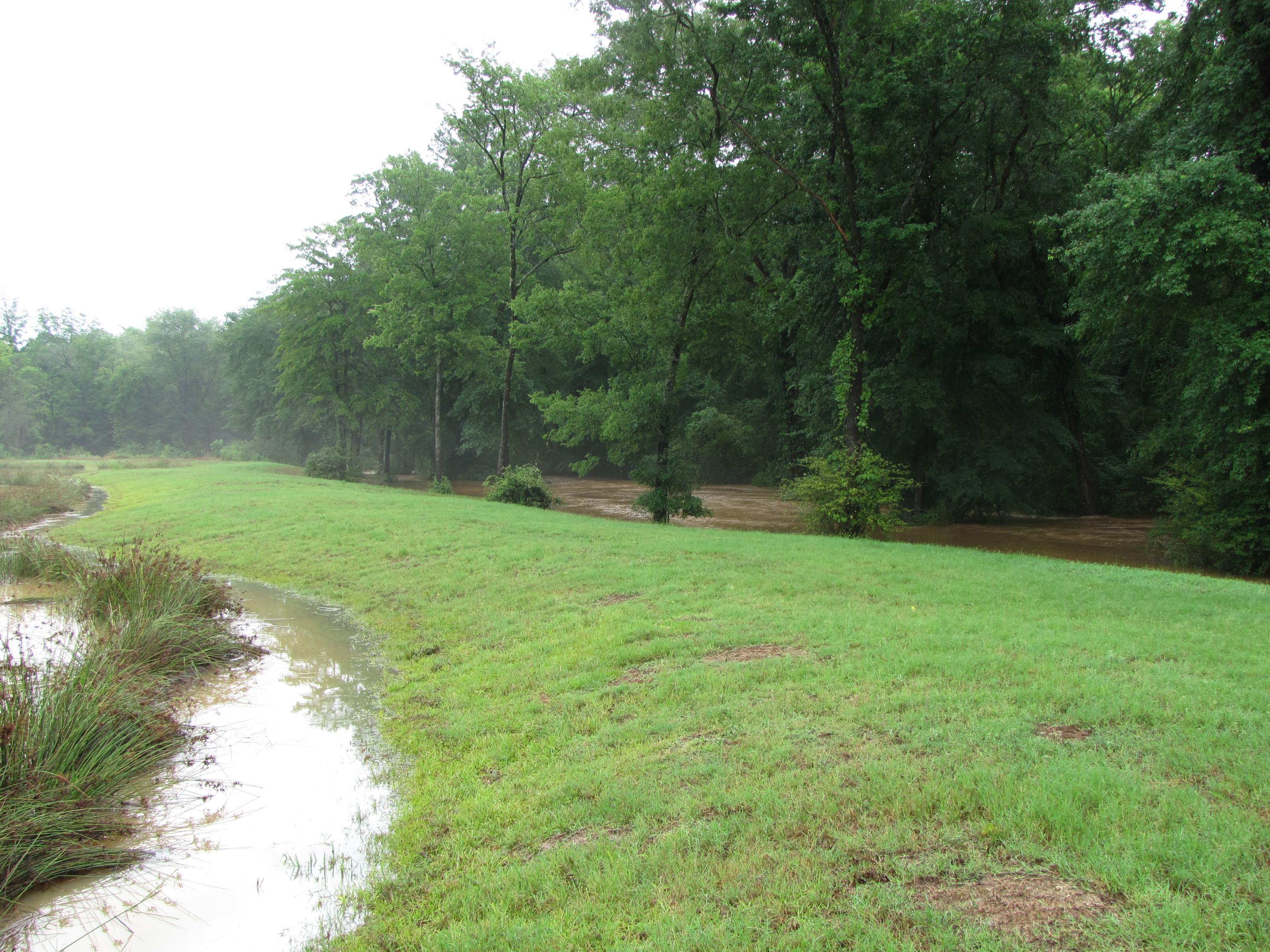

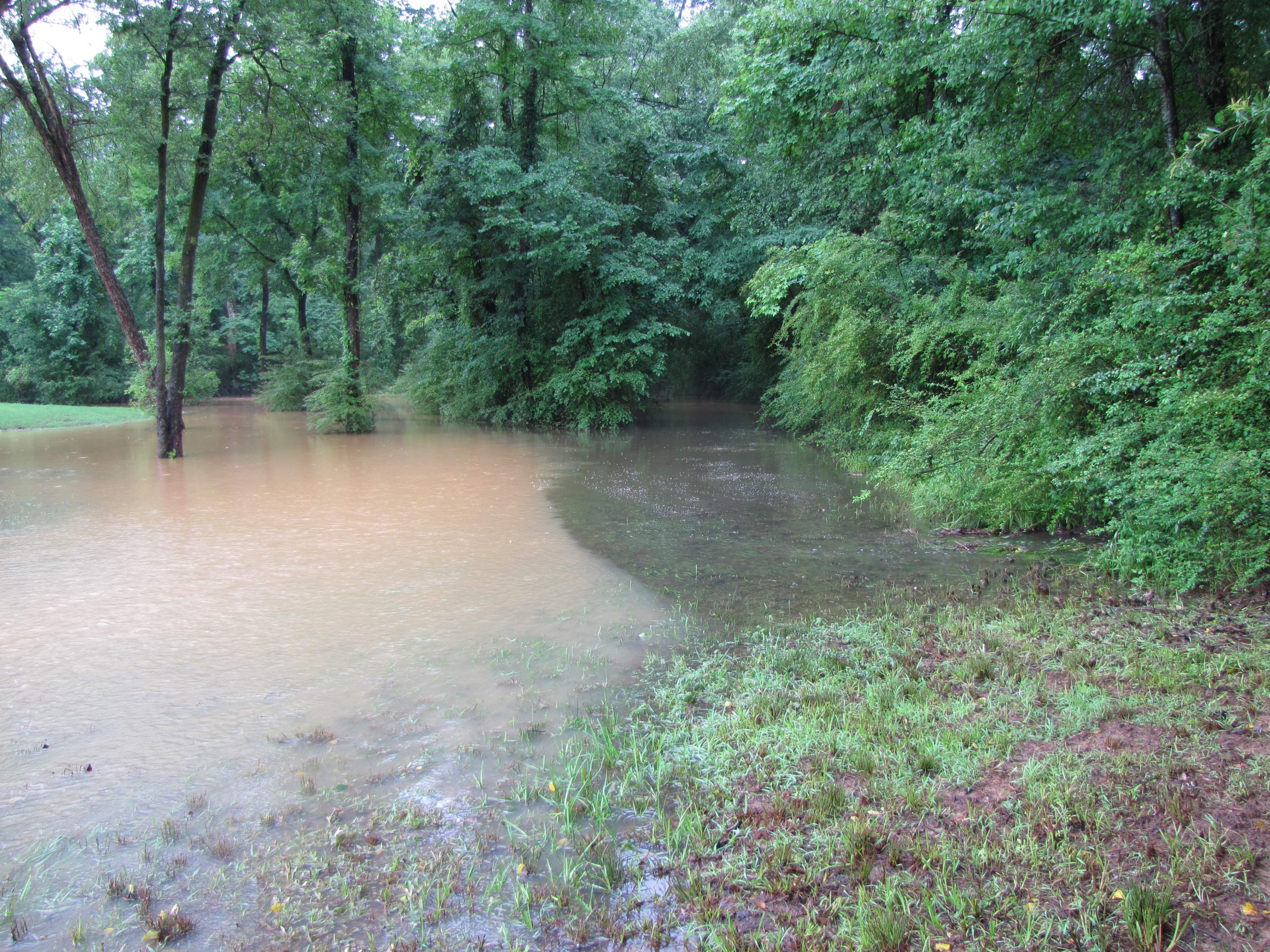

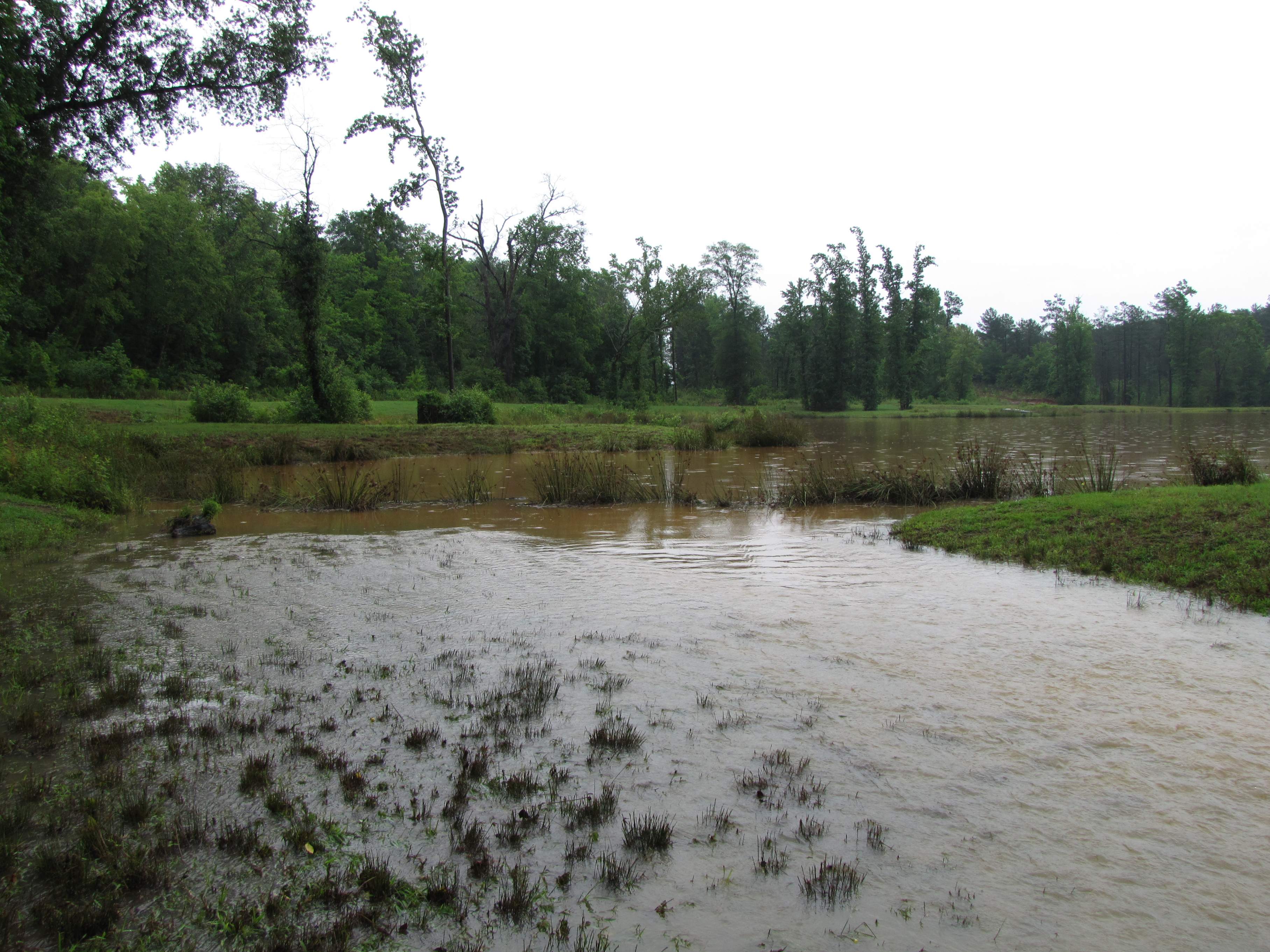

No decisions on picnic tables yet. Northern Tool just opened their store here in Tyler and I'm wanting to go there and look at their picnic tables. Plus a couple dozen other things, maybe more. LOL
The big news is that to I've received well over 8 inches of rain so far, and it's still coming down. Add yesterdays rain to it, and I'm over ten inches in a day and a half. Everything around her is flooding and there are several dozens of roads that are closed.
Lake Marabou went from being a foot low, to being a foot above full. The reeds grow right at waters edge when full, and I when I mowed last week, the water was below the reeds. I even mowed some of them down in places.
I walked through the spillway, and its amazing to see all that water coming out!!!! I'm hoping my fish have enough sense to swim up streem, but there's no telling how many I'll lose. I don't even know if that's a good thing or a bad thing. I'm worried that I'm over populated and not taking enough out, but since I can't change it, I'll just live with whatever happens.
In one of the spillway pics, you can see the brown water coming out of Lake Marabou, and the clear water coming out of the woods. There is another picture showing water going into Lake Marabou, and it's clear too. My problem with brown water is coming from the areas that I moved alot of dirt, and it hasn't grown back again. In the last picture, you can see part of that pasture, and how it's gotten alot better. Of course, there are still other areas of exposed dirt that are carrying that silt down to the pond.
Wiggins Creek is my property line, and it's normally at the bottom of a four foot deep ditch. Twice before in the past five years I've seen it flood like this. This time, the water is at the same height, but seems to moving alot faster then I remember. I have enough grass on the dam to keep it safe, and the dam is so much bigger then it needs to be, that I'm not worried.
The biggest news is just how well the spillway is working. I'm very please and so happy that I don't have pipes in there. Of course, even with pipes, I'd have to have an emergancy spillway. The spillway is 24 feet wide and it's doing a fantastic job of letting the water out without causing any erosion. It's so nice to see a plan work out!!!
Thanks,
Eddie
/ Creating a Lake
#1,636
I also saw that my wide, shallow ditches in my big pasture where doing a good job of catching runoff and sending it to Lake Marabou. That was alot of work, and it's nice to see it doing what I had hoped it would.
Thanks,
Eddie

That's a lot of rain. But looks like your spillway it handling it. Did I see the Lock ness monster in one of those pictures?
/ Creating a Lake #1,638
During a similar "WET EVENT" I had fish wash out of ponds, across hundreds of feet of pasture, and into a downstream pond. This happened in three different ponds of mine that I know of and maybe more.
