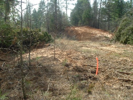

#40
When I decided to explore the area I wanted to build the lake, all I knew was what I'd seen on a topo map.
This is my first pass into the area. The orange paint marks the shoreline.
I got really lucky the way it's all fitting together.
