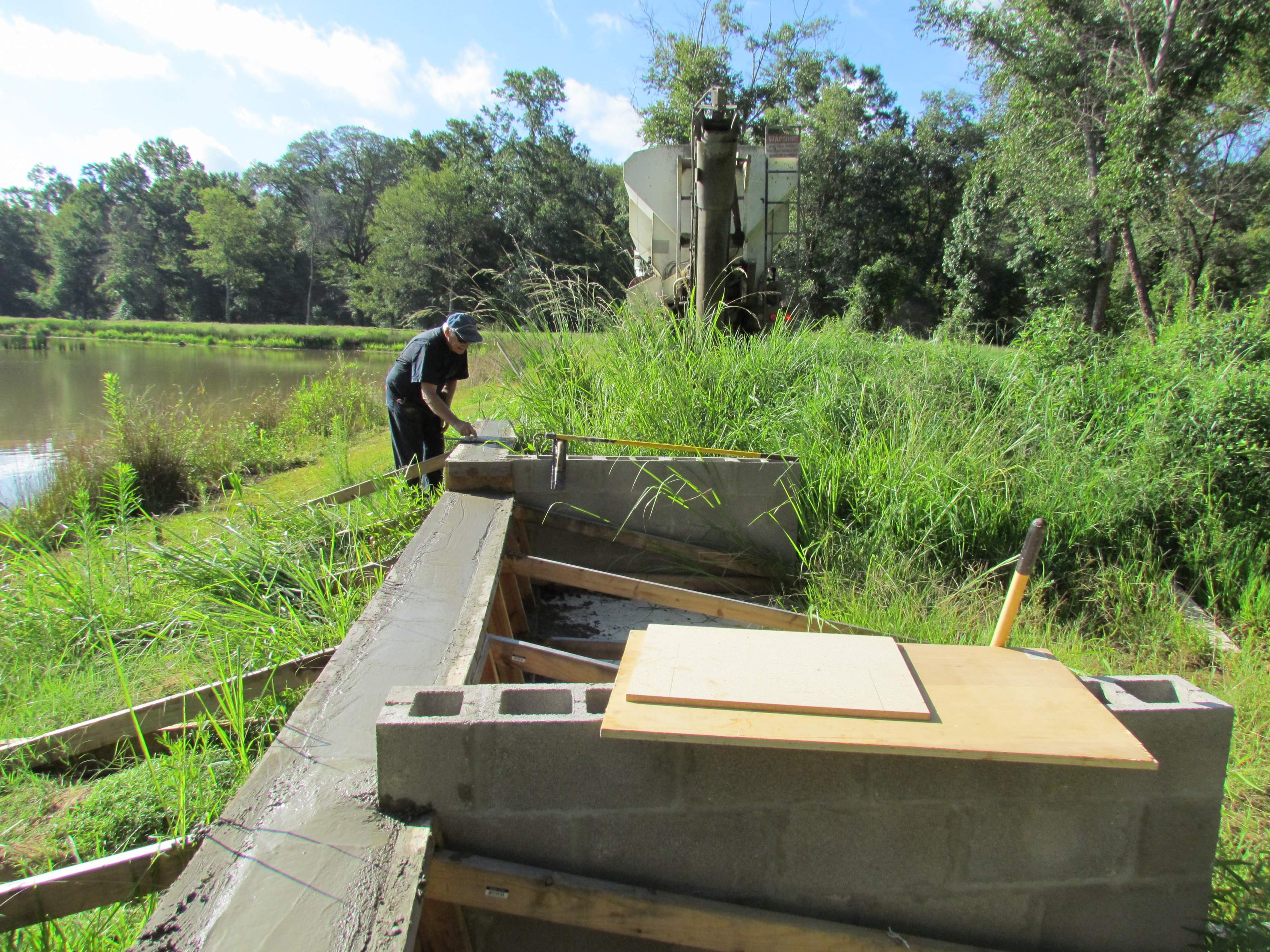

After months of delays, I was able to pour concrete today. My parents where here to help me, and we got it done in a couple of hours. Total was five yards for $647. I had estimated 7 yards, which proves that I can't do math and it's very hard to estimate concrete!!! :confused:
I'm going to let it sit for two weeks, and then pull the forms. The rest is pretty easy now, just a matter of taking it one step at a time and not being in a rush.

The spillway looks great, Eddie. But when are you gonna cut the weeds?;) :laughing:
The back side of my dam is grown up with Johnson grass and cockleburs. I told my grandson that all those weeds would cut down on erosion and they are good.:D

Any progress Eddie? I'd like to make a suggestion to you. I know you are relying on vegetation to keep erosion from occurring where the water leaves the concrete pad. However, I think you could reduce the chance of erosion from happening by making a shallow energy dispersion pool out of your concrete pad. Gravity is going to increase the water speed a lot where the water falls off the cinder block wall and just hitting the concrete is not going to slow that very much before reaching the edge of the concrete. By making a pool of water on that pad of 3" to 6" deep, the water will loose most of the energy produced by the fall by hitting the shallow pool. Use bricks or block to make a small dam across the end of your pad about 6" to 12" from the edge. That way the water leaving the pool over the top of the bricks will still hit concrete before gently entering the soil bottom spillway. You could even leave a few gaps between the blocks so the water eventually completely drains to avoid a mosquito raising pool. You just need to trap some water there while there is a lot of flow coming over your block wall.

Thank you for the nice comments of my pictures. I might enter that one in the County Fair, but will do a test on facebook first. What I like isn't always what everyone else likes!!!!! Mostly I take the pictures and post them on facebook to remind my clients that I'm out here and for them to think about me. Oscar, my pig, does that for me too. It's blatent marketing that has proven to be very effective for keeping me busy and increasing my rates.
I just got back from Peru today and haven't been down to see the pond yet. Hopefully tomorrow I'll be able to see how it looks and get the forms off. If not, it will be this weekend.
The reason the spillway is where it is, is because the land has a VERY GENTLE slope. It's almost level, the water flows very slowly over the grass until it gets to the creek. I'm 99% sure that once I get it smoothed out and planted in Bermuda grass again, there wont be any errosion. My only concern is where the concrete ends and the grass begins. This might develop into an area that I'll have to add some river rocks to. Worse case scenerio is that I create a hole or depression in the ground there. Even if there is massive errosion, it's virgin soil that has nothing to do with the dam, so I'm good either way. My only concern is how will it look and how hard will it be to maintain.
Pics as soon as I get some!!!

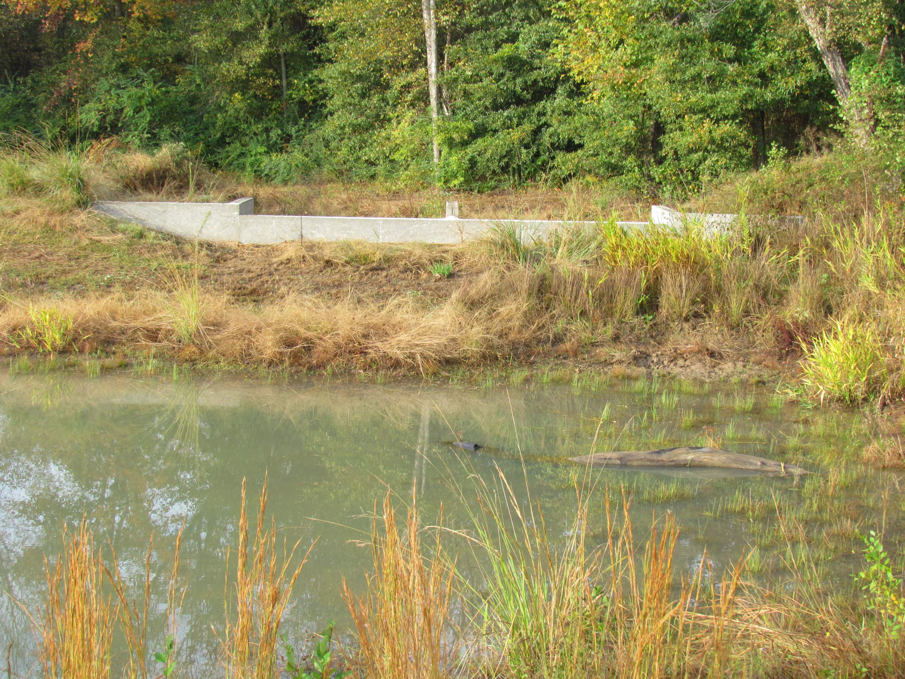

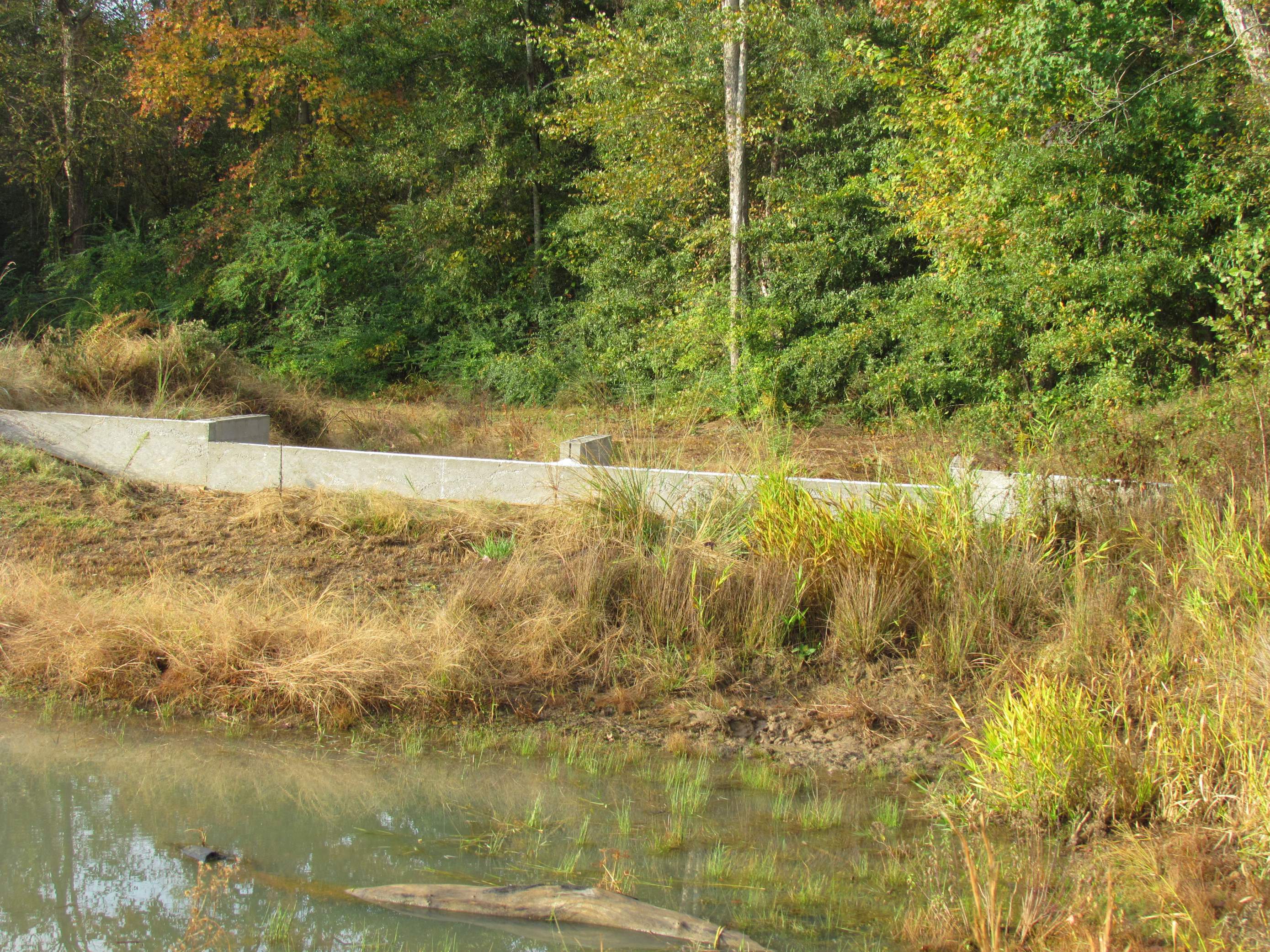

Nothing new to add to this other then that I was walking by the pond this morning and took a few pics of the concrete dam. I'm still three feet low from what used to be the full mark, and four feet low to overflow the new dam height.
View attachment 287443 View attachment 287444
Eddie
