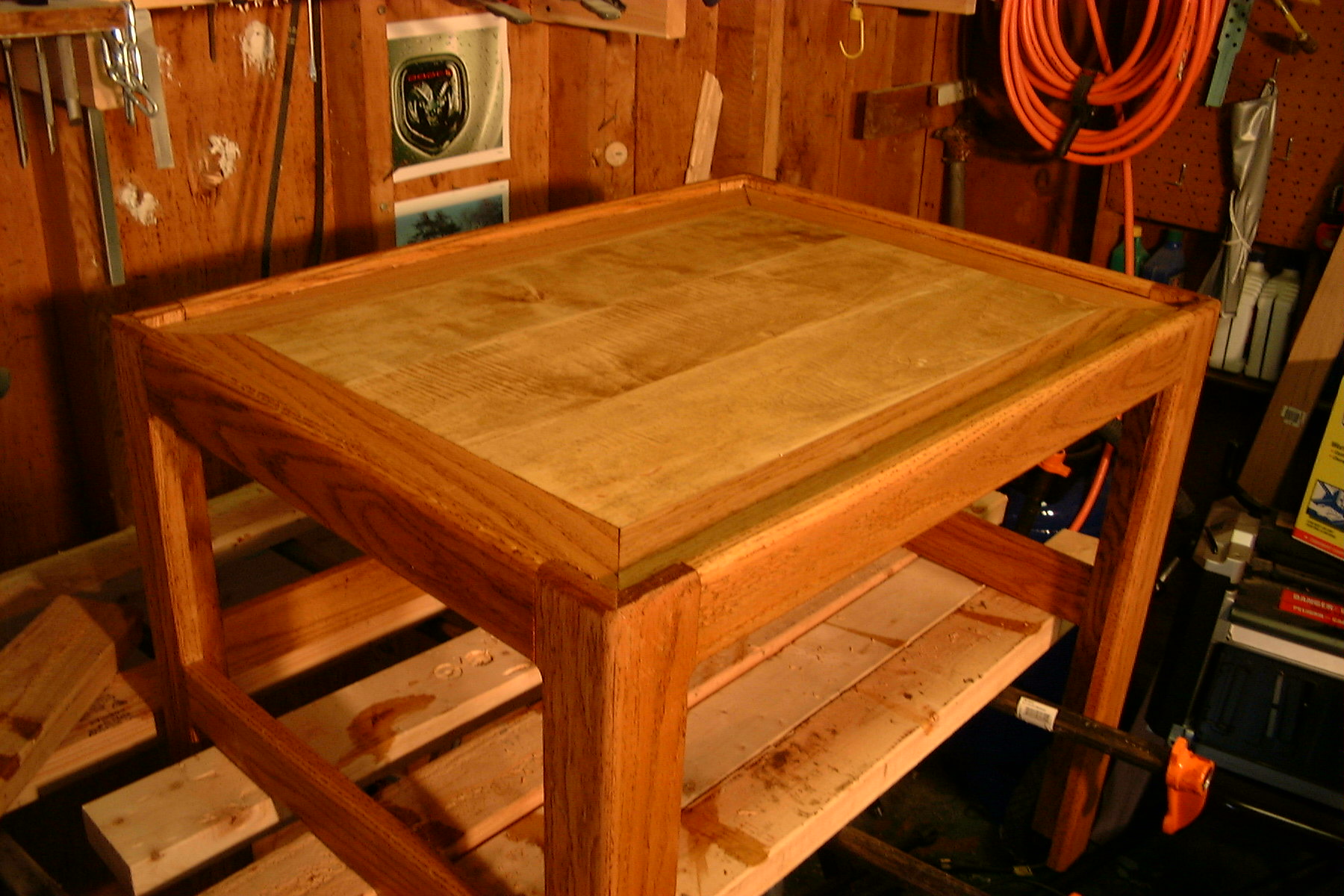

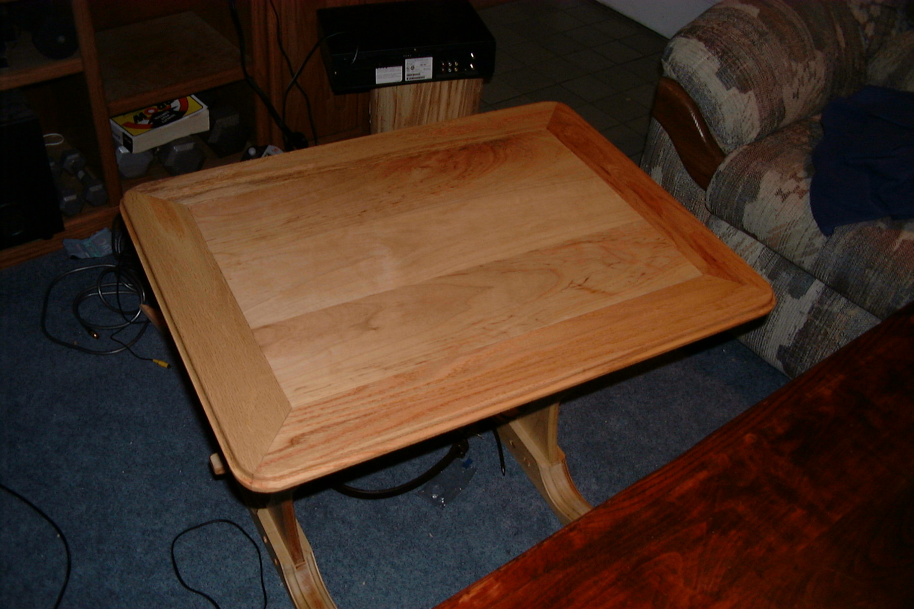

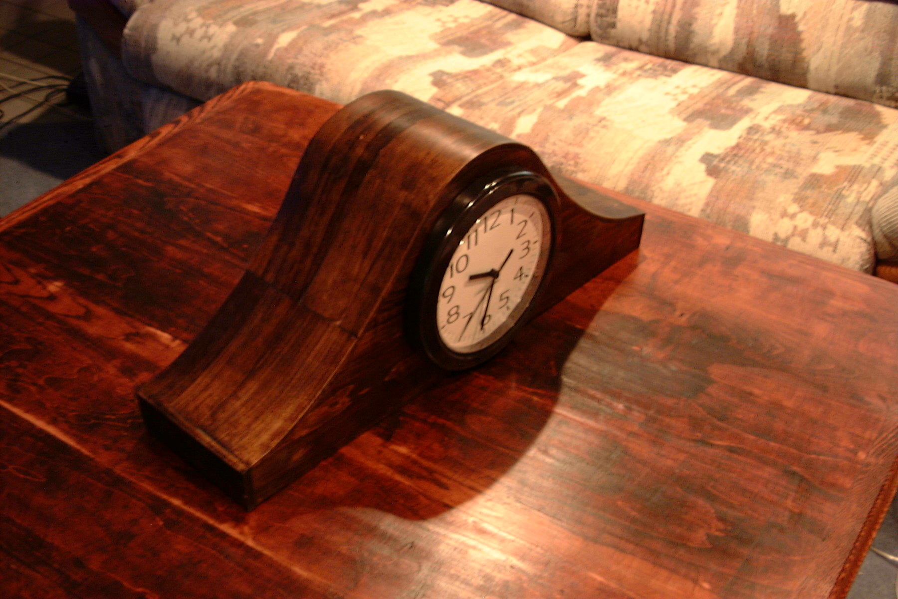

Eddie,
I am definitely not trying to make a living woodworking either. I made the same mistake you made only worse, I used oak to trim maple. Fortunately I have central air,
and since 2001 I have only had minor expansion/shrinkage issues. Most notably on a winter day I left a door open and the cold air pouring in on the table made it pop loud enough to make me jump. So I used some sawdust and glue and shoved it in the gap. Like I said I am not charging anyone.
In the last pic I actually routed out for the plate to sit in as described in another post. Unfortunately I didn't know any better and glued it ( plus the two type of wood problem). Live an learn.
I know they won't last a 100 years, but they are still solid tables that I use every day and get satisfaction knowing I made them. I am sure you and your family will enjoy your table for years to come.

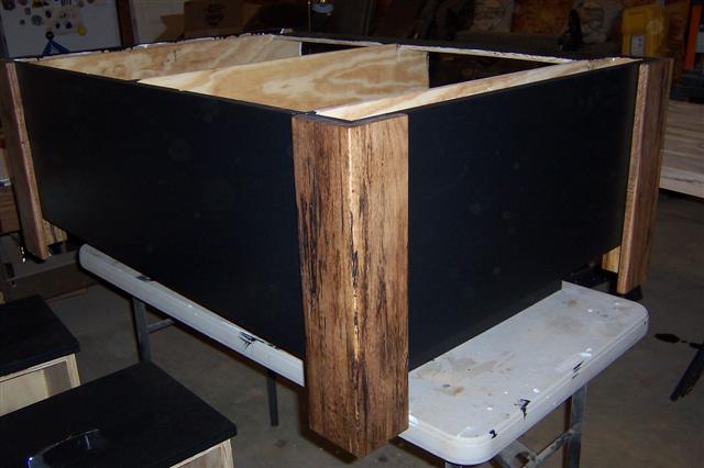

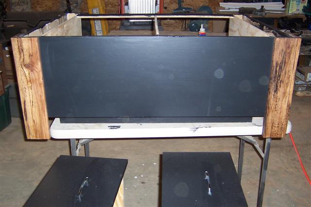

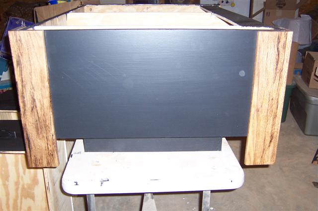

Michael_E_Tx came by today and gave me some pointers and ideas. I'm not very knowledgable on working with different woods and I'm especially ignorant on cutting my own and turning it into furniture, so it's fun to have an expert stop by.
My table top is still drying from an overly aggressive coating that I put on the underside of it. Cool weather and too much polyerethane takes allot longer than I thought it would!!! hahahaha
I did finish off the legs and put them on the table today. We want the table to look like a table, not a chest or cabinet, so that's why the legs are like they are. The black OSB sort of blends into the background and the overall look I'm trying to get is that you almost don't see the bulk of it, but sort of concentrate on the top and legs.
The pics are the same, just different angles. The last one is probably the best.
