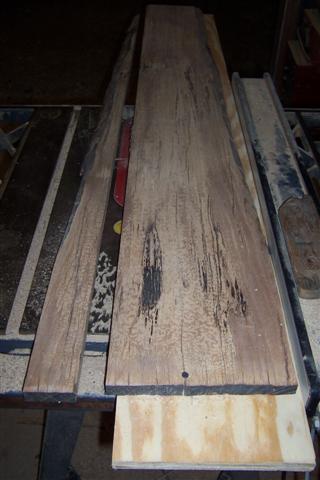

Here's a picture of Steph with my colection of stains. She a diferent piece of scrap with each stain. She thought she wanted "Red Oak", but changed her mind when she saw "Early American."

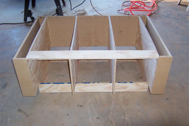

Good Evening Guys,
I PMed Eddie earlier today and expressed my concern on his table design. For all of you that am wondering what Im talking about go back to page 2 and look at oictures 044 & o45.
The problem is that he glued up a solid wood top and then used edging around the entire edge of the table. That looks great rather than looking at end grain. You have a nice looking edging and it makes the top look thicker. Unfortunately, its not quite that simple ! :( His table will look fine tommorrow and next week and probablly next month. The problem will rear its ugly head when that Texas humidity kicks in around next April or May. Those boards are going to expand and push those nicely mitered corners apart, creating gaps or worse :( I was content to just PM Eddie and tell him of this flaw, but being the type of guy he is, he told me to post my opinion !
Im sure many of you guys have seen tables that look similar to Eddies. The difference is that those tables more than likely have a plywood top or MDF that has had a veneer laminated onto it, subsequently it will not move as I say, actually expand and contract is what Im getting at. And then of course you can use the type of edging that Eddie used and get away with it!
There is also one other way to hide end grain when using a solid wood top with an edging board on the ends but it requires much more work than just biscuit joining the edging. You need to dado the ends of the table to create a tongue and then router a matching slot in the edging just slightly longer than the dadoed tongue. Thats over simplifying the process because you have to calculate how much expansion potential you have for your particular table top. When the edging is fitted onto the tongue, you drill through both the edging and the tongue. Remove the edging and then elongate the holes in the tongue for your expansion. Glue only the center section of the tongue and reassemble. By doing this your glued up top will not seperate at your glue joints.
Back to Eddies problem : 1 He can live with it and hope the gaps are not objectionable
2 He could remove the edging, but unfortunately he would still have to cut an additional 1/2" off each side to remove the biscuit slots.
3 He could leave it as is and make another top when he has the time.
My thought is to leave it as is for now and make another top when he can.
Another item is attaching the top to his base. Same principle, if he screws it from underneath, he needs to elongate the screw holes for expansion.
One more thing and then I will fade away :) Whenever I make a coffee table or such, I dado a 1/4" slot in the support rails running between the legs and then use L shaped clamps that fit into the dadoed slot and screw through those to attach the top. This way the table can expand and contract all it wants and I never worry about having the top pull apart on me.
Hopefully I have saved someone from making a similar mistake.

Scotty,
Thanks for the detailed explination. I now understand how I should have done it, but what's done is done. I'm not sure how bad the damage will be with it inside the house and I'm kind of curious to see what happens. Obviously it's a good thing I'm not trying to make a living with my woodworking. hahahahha
In our PM's I mentioned screwing some plywood to the underside to help hold the top together. If it doesn't hold the table together, it will give me a good mounting point for my bracket.

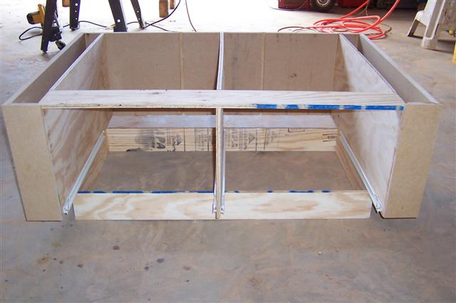

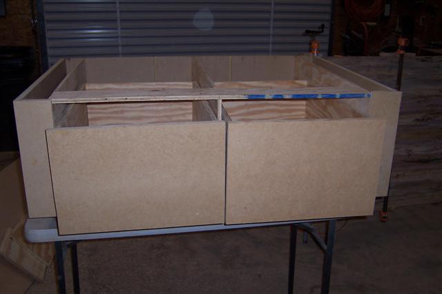

The second picture shows a picture of a bracket I'm going to make so we can lift the table top up to eat off of it. Our home is very small and we don't have a dinning room or even a diner table. The kids eat at the breakfast bar and we eat at the coffee table. My goal is to be able to lift the top up and eat without bending over the coffee table. hahahaha
Eddie

Hey Eddie and Scott. I've been following along here and would like to contribute to the discussion. Scott I defer to your experience building new tables, I have not done much in that way, especially this type of tabletop construction. I am a retired woodworker, but my career was almost entirely focused on major repairs to valuable antiques. I understand and agree with your ideas about how to deal with expansion, however in this case, I will predict exactly the opposite.
I think your tabletop will shrink Eddie. This is because you've fabricated your top from planks that you've just cut from a log. It doesn't really matter how long that log has been sitting, in my eyes, you have green wood. Green wood shrinks. How much spalted cedar will have a will to move, I can't really predict, but I would say that I believe spalted wood of any kind will have less will to move. Spalt, by definition is rot, and rot, even partial, absorbs some of the movement of solid portions of the wood.
So I think you may get away with it, the top glued up in the manner you have done. I agree with Scott about staining the underside the same as the top. In fact, I would go a step farther and suggest you remove your plywood braces if they are not glued on, and apply not only the stain but whatever other finish you apply to the top. Then reattach your cross braces.
Clever idea with the bracket and adjustable height tabletop.

/ Creating a Coffee Table for Steph #31
Mornin Mike,
Thats a very good point and one I didnt fully take into account ! I was so focused oon the table design that I forgot that he rescently milled these boards from logs. Talk about tunnel vision :confused: :)
In any event, with your experience you understand what Im talking about.
Im sure that Mike understands that a moisture meter can be used to find out what the moisture content is any particular board. But this tool isnt something that the average Joe would have in his garage.
Back track to the milled boards. My friend milled up some 2 1/2" thick oak for me a couple of years ago. I let it sit out in my screen house for over a year and last fall I moved the planks into my basement to dry the rest of the way. I also have my wood stove in my basement. I feel that Im finally ready to start rough milling the legs for an oak kitchen extension table that my wife has been after me to make. So as Mike stated, my boards have shrunk durring the drying process.
Im sorry about the tunnel vision guys, and thanks for the heads up Mike ! I was just so focused on the design that I forgot about the rest of the thread ! :confused: :)

Thanks Scotty and Mike,
Seems I have a few potential issues to worry about. The plywood is glued and screwed, so it's not coming out. LOL Can I just seal the entire bottom, plywood and all?

One of the goals of this coffee table is for the top to be able to raise and convert into a table to eat off of while sitting on the sofa watching TV. I priced brackets from various online sources and thought they were way too much money.
Being cheap and a do-it-yourselfer, I decided to make my own bracket. My brain always starts out on these things in the most complicated way to accomplish it. There is a process that I have to go through to get to a practical, working design that will work and do the job.
Once I cut out all the extra BS in my deisign, I realized I only needed three pieces for each side. Then I cut some scrap plywood to size that I guessed would workd and started to test my plan.
When I knew how long the metal had to be and where the holes needed to be, it was pretty simple to cut some angle iron to size and drill holes for the bolts.
Eddie
