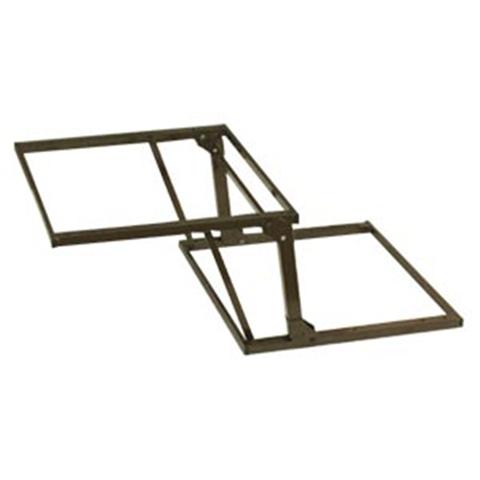

EddieWalker said:
Morning Scotty,
I've been wondering about that. How hard will it be to lift? Two of us will be able to do it easy, but can Steph lift it by herself?
On the ones they sell for $150, the metal is much thinner and they seem sort of flimsy overall, but they have springs on them. I'm wondering if some heavy duty springs might help?
I'm just confused on how to do it right now. I know that it's something I can add at any time, so it's not a rush, but it is something I'm thinking about.
Thanks,
Eddie

/ Creating a Coffee Table for Steph #47
Eddie,
As you know i have been missing here onTBN since fall, so I am jsut now catching up and enjoying all the topics. One accessory to add to your table is coasters. Like coasters for your glasses and pop cans. I have the same beautiful furniture we bought 25 years ago and it is still beautiful because of coasters. You and steph really need to be coaster ****'s. Actually that is a very ice project to work on with her children. a surprise gift from them to her. You could work with the kids to make coasters. Actually what I have found that makes the best coasters, and i know how, ahmm "conservative" you are with spending money, is mouse pads. The thick mouse pads that have like rubber backing on them are low cost and they absorb the liquid really well. They look rather junky after a while but because they are ahm, low cost (notice I didn't say cheap, I said "ahm.. low cost') they can just be thrown out and new mouse pads cut up to make new coasters. Full size mouse pads also make a very nice protector to have on the table when putting a hot plate out of the oven or microwave on the table. If you protect the table from heat and moisture, every time, your table should look as good 25 years form now as it looks today. At computer stores you can usually get mouspads pretty, ahmmm low cost. The kids would enjoy cutting the mouse pads up into coaster sized pieces.
I love the idea of the pop up top, I almost bought this same type of design for my uncle who has jsut a studio apartment. I think it will be handy to pop up the top and get inside the drawers, as it seems to me that you are going to need the table pretty close to the sofa in order to eat, and it might be kid of hard to get into the drawers if it were close to the sofa. oh silly me, you'll probably pull the drawers out form the opposit side that the top pops up to.

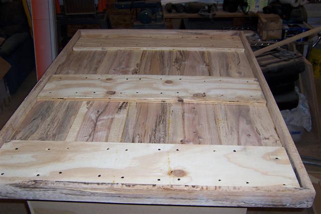

Michael_E_Tx came by today and gave me some pointers and ideas. I'm not very knowledgable on working with different woods and I'm especially ignorant on cutting my own and turning it into furniture, so it's fun to have an expert stop by.
My table top is still drying from an overly aggressive coating that I put on the underside of it. Cool weather and too much polyerethane takes allot longer than I thought it would!!! hahahaha
I did finish off the legs and put them on the table today. We want the table to look like a table, not a chest or cabinet, so that's why the legs are like they are. The black OSB sort of blends into the background and the overall look I'm trying to get is that you almost don't see the bulk of it, but sort of concentrate on the top and legs.
The pics are the same, just different angles. The last one is probably the best.
Thanks,
Eddie

/ Creating a Coffee Table for Steph #51
Eddie,
Nice project. Probably you are ot going to do this, but casters ont he bottom would make it easier to move for vaccuming etc, considering the size.

Rox,
The table wont move. The wood legs are just for looks. The weight of the table is on the supports that the drawers are attached to and there is a cabinet style towkick. There is just six inches of carpet under the edge of the table.
