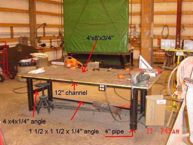

Built with scrap metal off the job. Didn't cost a dime:cool:, other than the vice.

/ Crazy idea for a welding table? #16
Wow! a 4' x 8' x 3/4" scrap? I should be following you around job sites.
Was thinking the same thing :laughing:
It is amazing the amount of scrap steel a large construction company has. And when the job is done, most of the time you can take home what you want. That way they don't have to pay for shipping back to the storage yard.

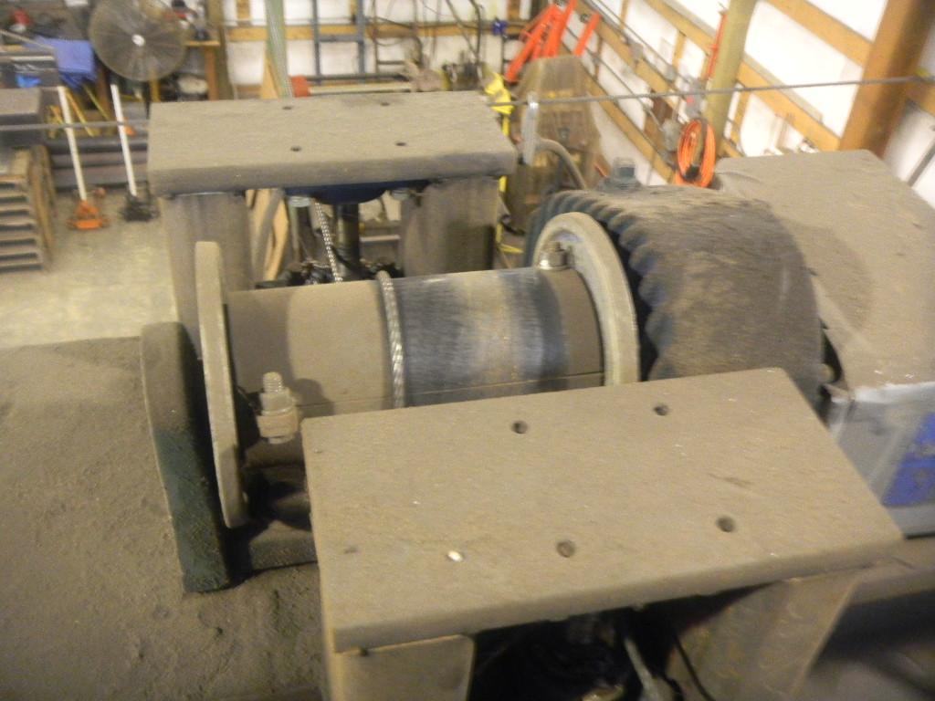

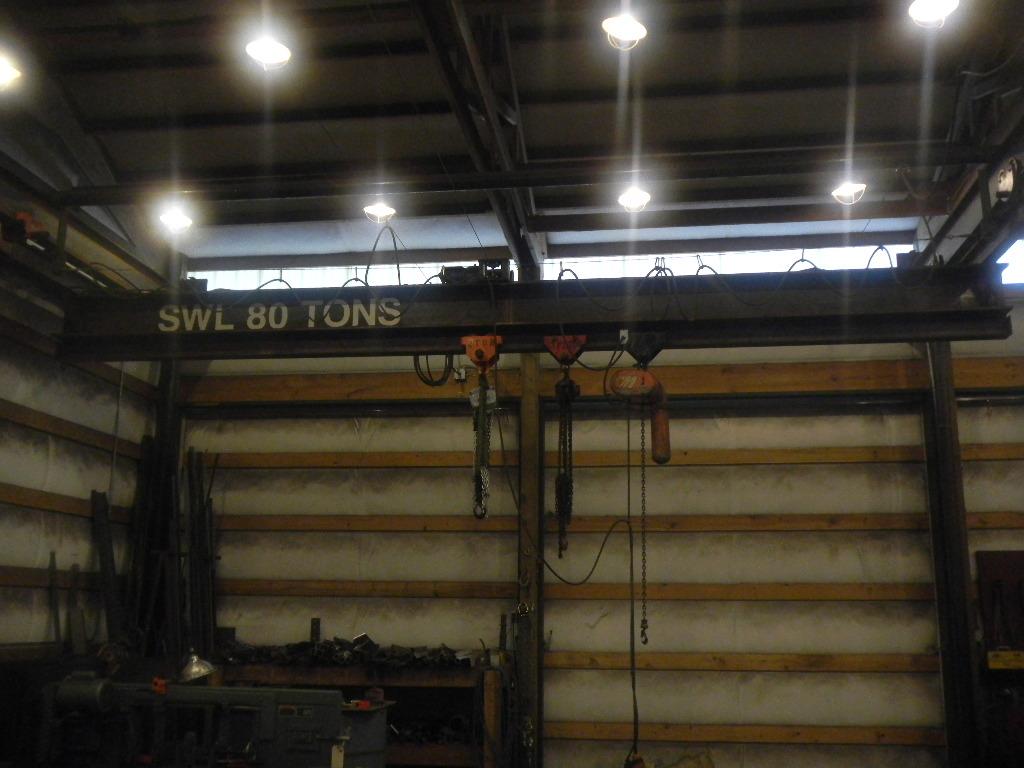

The majority of this 24-feet span by 40-feet powered travel bridge crane came off the job.;)
Hey SA, gonna hijack this thread just a bit, but it all pertains to Welding Tables.... I know these are vague questions but just give me your personal thoughts. I trust you. Got a chance at a 34"x60"x5/8" plate. Properly built is that adequate for a top used similar to the one you pictured?? What is your preferred table top height??
/ Crazy idea for a welding table? #19
Been in service almost a decade, and still as good as it was the day I built it. Looking around google, it appears the idea caught on. :D
