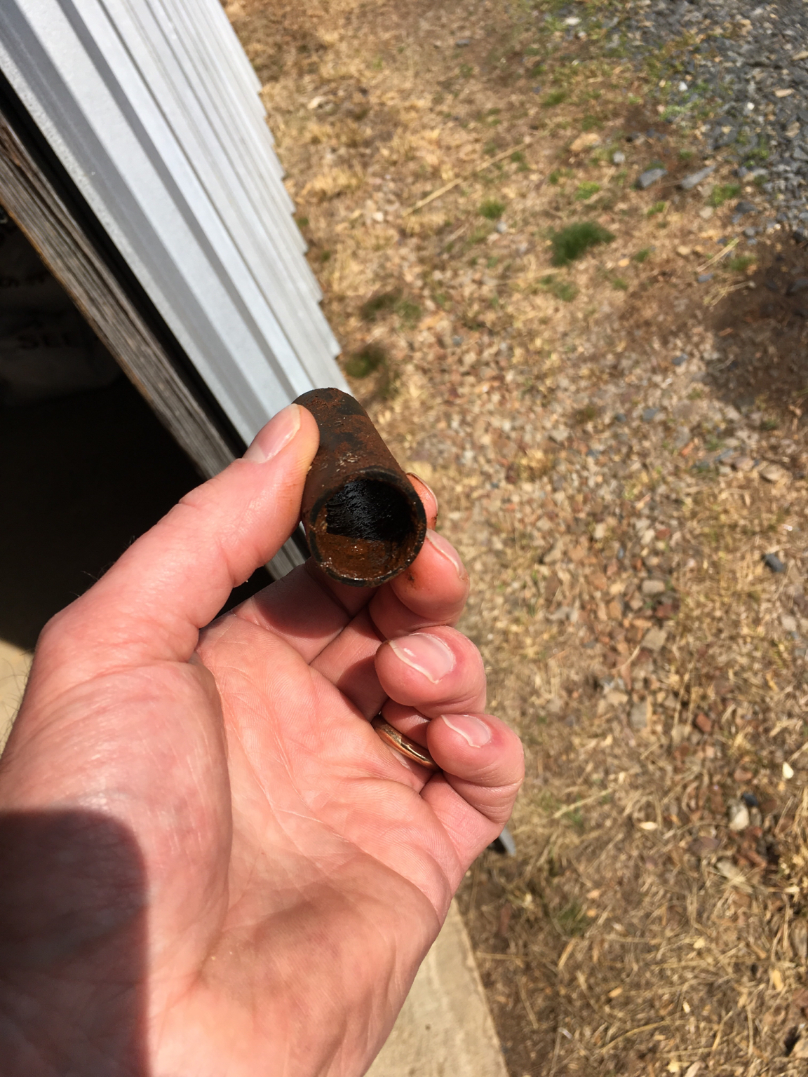

Ok just flushed 2nd vinegar soaking. Also was able to fish out a piece of black PVC pipe. No idea how that got in their along with a broken spark plug. Anyway the gunk in their looks like brown greasy mud which is why I think the vinegar is not working. How do I remove the greasy stuff without taking off fuel tank? IMG_2219.JPG
   / Crap in fuel tank. Help! #30
At this point I think you're beyond not removing the tank. If mysterious items are appearing it's time to get to the bottom of it, so to speak. Is the tank metal? An old motorcycle trick is to burn out the tank on a campfire, then coat with sealant and repaint. This is a drastic step, and should only be done as a last resort.
