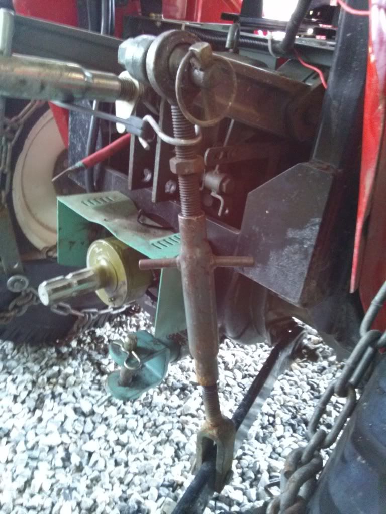

I have 1 hole and a slot below that on my left link at the bottom so either its fixed or it will float if in the other position. Not sure why they wanted to float the links but that is all I can figure.
Thats interesting, I thought they all came with 3 adjustment holes, I suppose depends on models,
I had tried to make a 4th hole in an atempt to get the arms up higher trying to get the bush-hog from scalping, the drill bit was dull and never got the hole through,
I found the problem was due to out of adjustment on the float linkage,

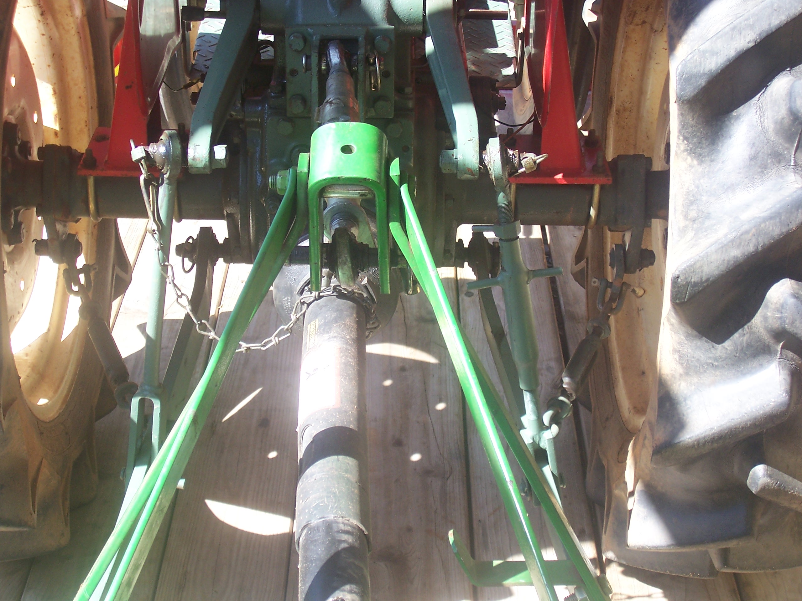

oh yea I got cha! I think there is a few different arms where you can move the vertical lift arm forward or back on the lower lift arms, this will as well put that arm higher or lower on either side if you doe one side and not the other? Maybe I am remembering my tractor wrong, its been months since I have seen it and even longer than that since I ran it. I have only started it and let it run for 10-30 minutes 2 times since about October.

More pictures of mine...I only have one additional hole on my left lift arm. My original question was just more out of a convenience situations. Mine works well enough but when I saw my neighbors Kubota and the JD 950 with a cranking one I thought wow, that's is definitely better than what I have and would make life a tad bit easier especially in the cold hand season. I can adjust it to the other hole, which would work really well when its summer, but I use a back blade for snow removal and I am always getting off the tractor and re adjusting the blade angle and then I have to adjust the height as well.
