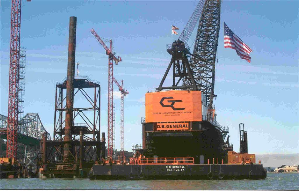

I feel more comfortable working with these! This crane is rated at 50-tons at 285-feet radius.:cool2:

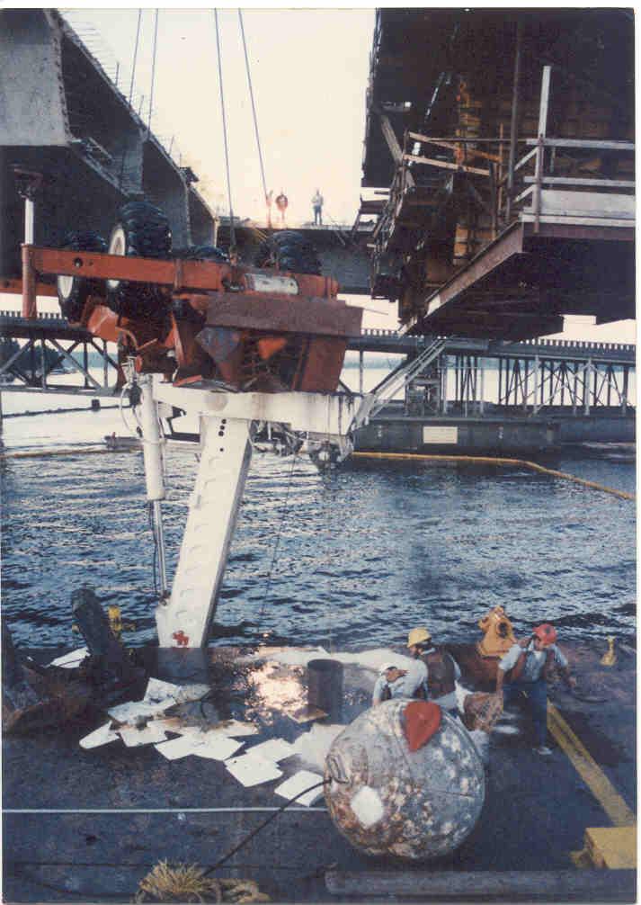

I would have to disagree with the "counterweight" theory. While the cab and engine will act as a counterweight, the long moment arm of the front of the crane far exceeds the counterweight effect. It becomes a very long stabilizer and is far better at resisting overturning.
In other words you have to push the cab into the ground to overturn it just as you would have to push a stabilizer into the ground on a side lift.
Finally found it, my charts from long ago for a 70T Grove hydraulic truck crane. If you compare ratings, you'll see that the ratings over the rear are all structural limits, and are greater than the 360* tipping limits. Where both ratings are structural, they will be equal.
But operating over the rear puts the carriers engine into position as an additional counterweight, and allows the picking capacity to increase from a tipping to structurally limited load.
