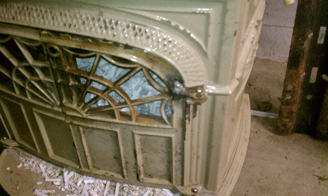

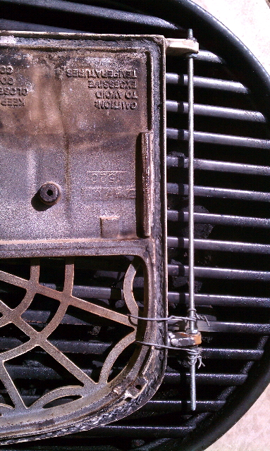

It seemed to weld ok but was not aligned right for the hinges. So I'm giving it another go with a threaded rod to align the hinges.

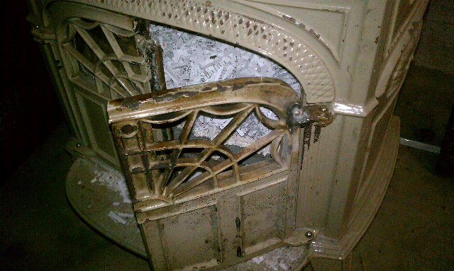

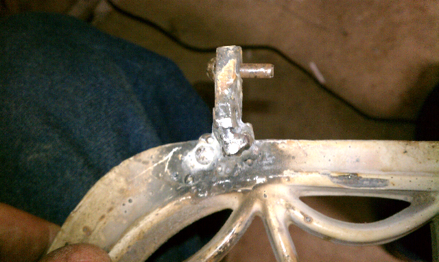

Well, it worked great. The hinge lines up and operates corrrectly.

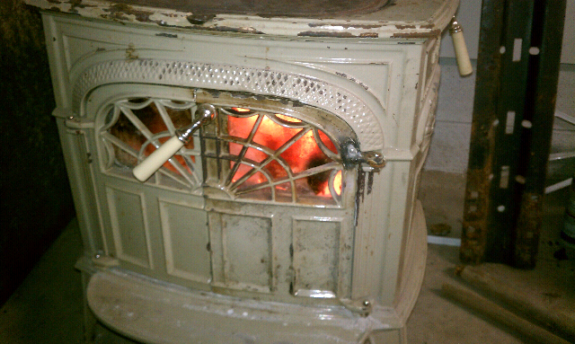

And here she is doing her thing.

Ha ha, the ribs were burned at 600 F!
Thanks for the help and ideas guys.
