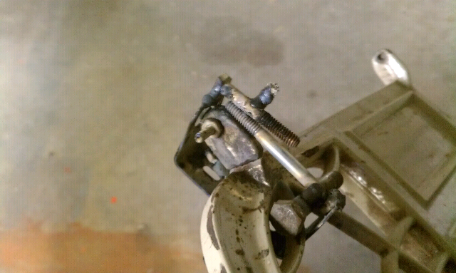

Ive welded cast with a 7018 ac rod..Just preheat the piece your welding and weld..After completed wrap in insulation to cool it down slow
   / Crack in cast iron stove? #14
Simple repair. Go ahead and weld it with a high Ni Rod or 312 stainless. If that doesn't work. Have it spray powedered. If you were close, I would enjoy fixing it. :thumbsup:
   / Crack in cast iron stove? #15
Would that be cast steel or cast iron? I've used 7018 on dozer pads with success, cast steel.
   / Crack in cast iron stove? #16
last one was a hand operated well pump made out of cast iron..Just clean preheat ,weld and throw into insulation to let it cool slow
#19
Ok, I'm welding today. I tacked some odd and ends to form a braket to hold the piece in place. I cooked it in the propane bbq until it got up to about 600 F. Then I welded it with a nickel rod.
Now what is considered a slow cool down? It's still in the bbq and at about 475 F now.
