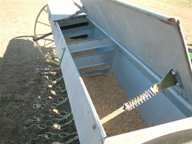

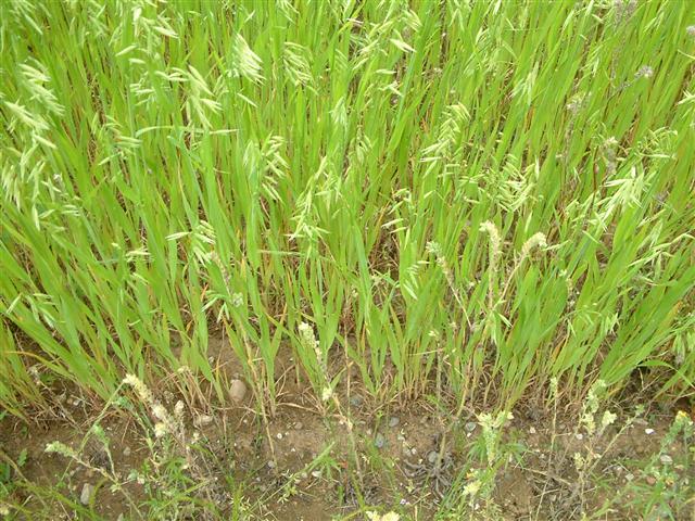

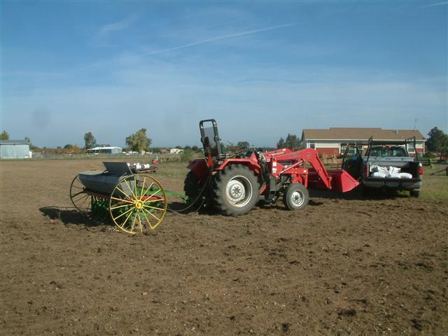

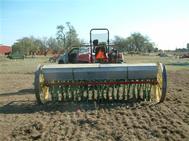

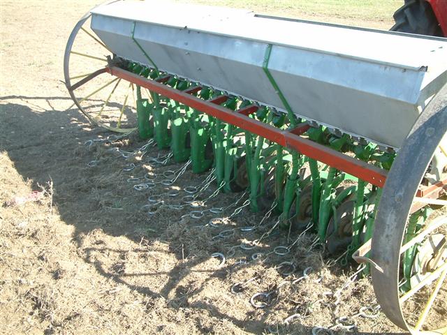

My preference is a grain drill and chains to cover the seed.
DSCF0156 (Small).JPGDSCF0157 (Small).JPGDSCF0158 (Small).JPGDSCF0159 (Small).JPG
Bought two Minneapolis Moline P3-6 grain drills for $275. Spent another $250 for parts and about 2 months to clean one up and make one good drill. Plant Kanota oats.
Got pretty good results. Nice thing about drills compared to broadcast is less wasted seed that fails to germinate.
