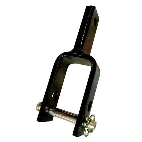

I ordered a Harbor Freight Quick Hitch, my first QH. Following are some pre use questions that came to mind:
1) I have some old implements in my arsenal which are most likely not QH compatible. Assuming the lower pins work, will the adapter bracket from Agri Supply likely solve most/all top link problems?
2) What has been your experience with PTO shafts; specifically have you had issues with PTO shafts becoming too short because the QH has moved an implement further away from the tractor spline?
3) Has the QH caused geometry changes that have affected how some implements work?
I'm just trying to anticipate things I am going to run into.
   / Couple of Harbor Freight QH questions #2
1) You will need to tweak implements to fit. You should get the hook with the QH. I use the adapter since my implements could not easily be modified to accept the hook. QH.jpg
2) No
3) No

What is the purpose of these bushings? This is my first QH so I'm not yet up to speed. Trying to learn the finer points prior to putting it on my tractor.
   / Couple of Harbor Freight QH questions #5
The quick hitch attaches to a larger diameter post with a wide end. I cheaped out and just slipped a piece of pipe over a big bolt.
   / Couple of Harbor Freight QH questions #6
Bushings of some style are needed as the specs for Cat 1 hitch are for Cat 3 size hooks. I never saw the use for those expensive bushings with the knobs. The cheap bushing seem to work fine. The implement can't slip off as the hitch structure on the other side prevents that.
The knob-end bushings are also not easily removed if for some reason the implement needs to be used on a tractor without a quick hitch.

I've had the HF qhitch since they first offered them. Here are a couple of things that have worked well for me.
With only 18 and 24 hp tractors, I never bothered with the sleeve adapters for pulling implements. After several years I don't see any resulting wear or feel noticeable slop. I suggest try operating with your Cat 1 implements riding directly in the qhitch's Cat 2 (Cat3?) hooks before making anything more complex than it needs to be.
The only place I used simple sleeve adapters - not the ones with shoulders - was when I made the adapters in my photo below, on the ends of my trailer-hitch crossbar. The flat pieces are bolted on their inner and outer ends to the crossbar and are also welded to sleeves. These adapters are removable, just unbolt and slide off. The purpose of these adapters is to keep the trailer ball pointing upward. They substitute for the more robust stabilizer that engages with a 3-point arm in a normal setup. While my sleeve adapters look lightweight I regularly tow a 2600 lb watering trailer on rough ground and as you can see, they haven't deformed.
Also shown in the photo is removable pins securing the top hook, and the lines I painted to show where to return the hook to after some specialty application. I bought the Y-shaped adapter shown in a post above but haven't used it recently. What works equally well is pull those pins and install the hook upside down over the upper mount point on my back blade etc, ie implements that have structural components near the top that block hooking under the implement's top mount point.
One more tip that works for me, YMMV: a rotary mower works better with a flexible top link to let it follow uneven ground with less stress on the upper 3-point link. I remove this qhitch hook, tighten the tractor's 3-point upper link to tip the qhitch forward, and throw a loop of chain around the top 'tower' on the qhitch and the top of the mower. The mower is carried entirely on its lower pins until I need to lift it, then the chain helps raise it.
Finally, here's another application of the qhitch, for mounting up to four ballast 70 lb weights on the back when I need to use the loader or loader forks in tight quarters and don't have room to maneuver carrying an implement. The trailer hitch crossbar shown in the photo below is normally on there also to reduce swinging (if I haven't left it wherever I left the trailer like in this instance:)).
