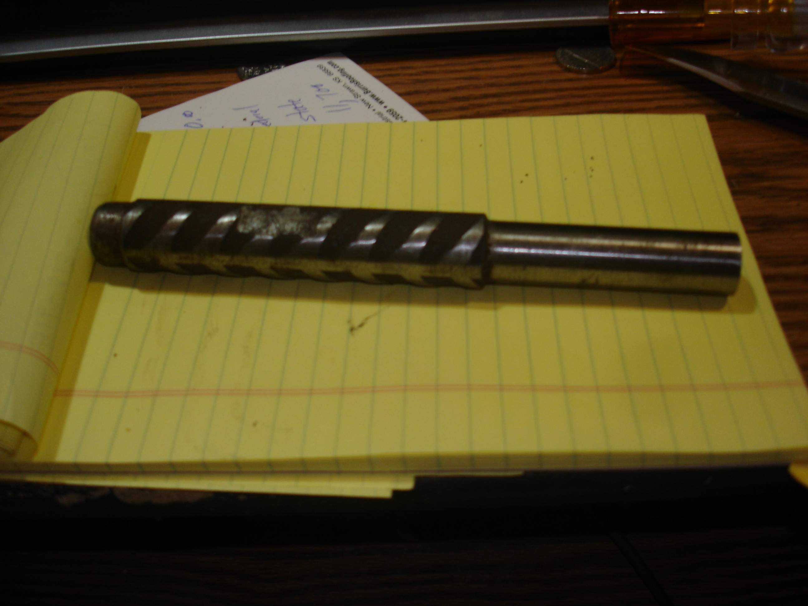

Everybody asks for pictures. This is a 5/8" transfer punch made from rebar as stated in a past post by me in this thread. This one has seen a lot of action and should last forever if it is only smacked hard enough to to make a mark to be enlarged by a regular center punch. There seems to be some question about the rebar that is available today. Transfer punches are pretty inexpensive when purchase from firms like Enco. Didn't trust my photography skills enough to go for a close up of the point.

You did a really nice job of making that transfer punch. I can't imagine having the time to make a full set that way, but they would sure look really cool.

Thanks Rich Waugh, I built those back when I was still trying to teach myself some things. I checked tonight and a 28 piece set can be had for as little as $9.95 up to $29.95. My wage would be less than $.25 an hr if I made them today. I still have 2 lathes, a mill, and shaper, but don't do much due to fading eyesight and a love for the recliner.
Very nice job Mr. Booth :thumbsup: I like the non-slip handle. :D
