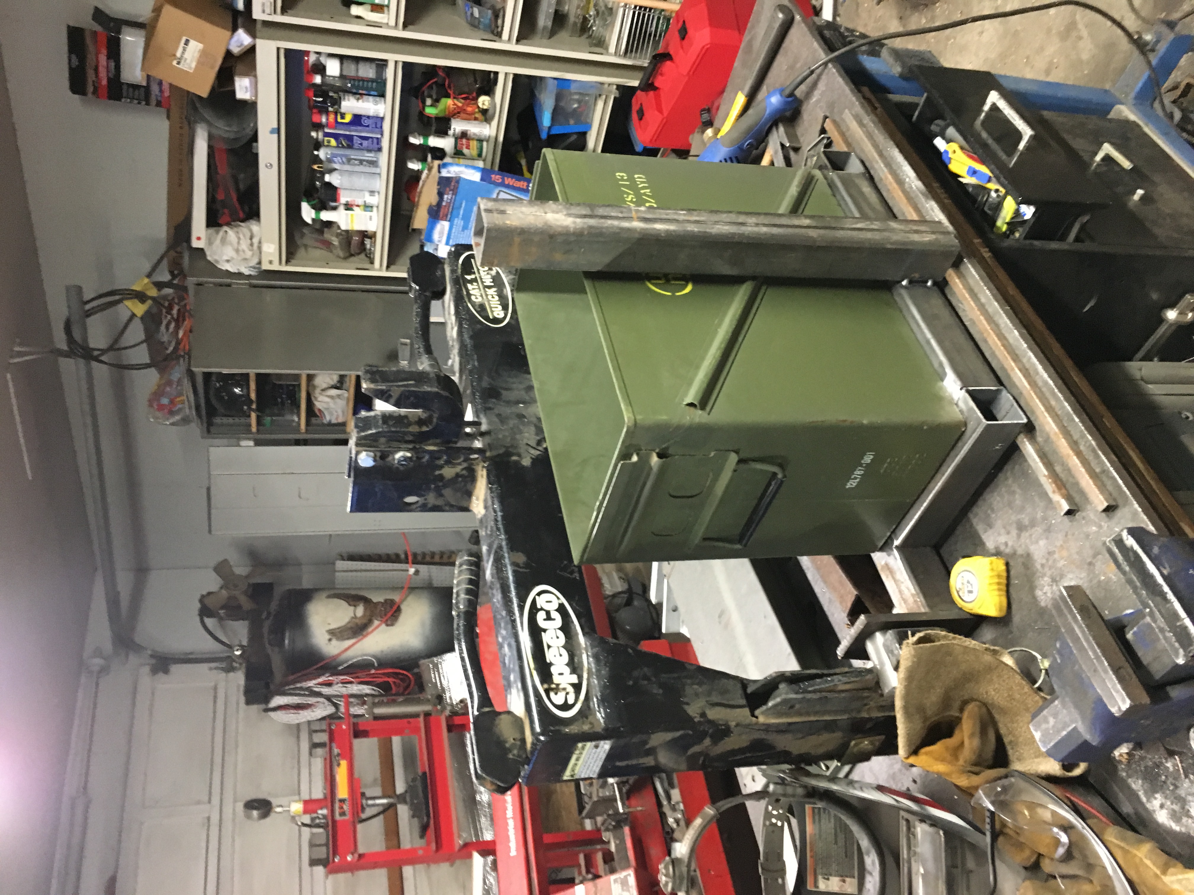

A new project for the Massey. Looked at many diy weights, came up with a compact version. Short history. A few years ago, I was involved in the lead wheel weight frenzy. With all the do-gooders frowning on lead, pressuring governments to ban them and go to steel, I salvaged and melted down about 800 lbs for future bullet casting. So with all that sitting idle, cast into one pound ingots, might as well put it to use. One cubic ft of lead is just over seven hundred lbs. My ammo can has more than enough volume to get a substantial weight in a small package. Made to work with the quick hitch. 726CB216-D053-4F49-AD3D-D93AC8C5B6AB.jpeg

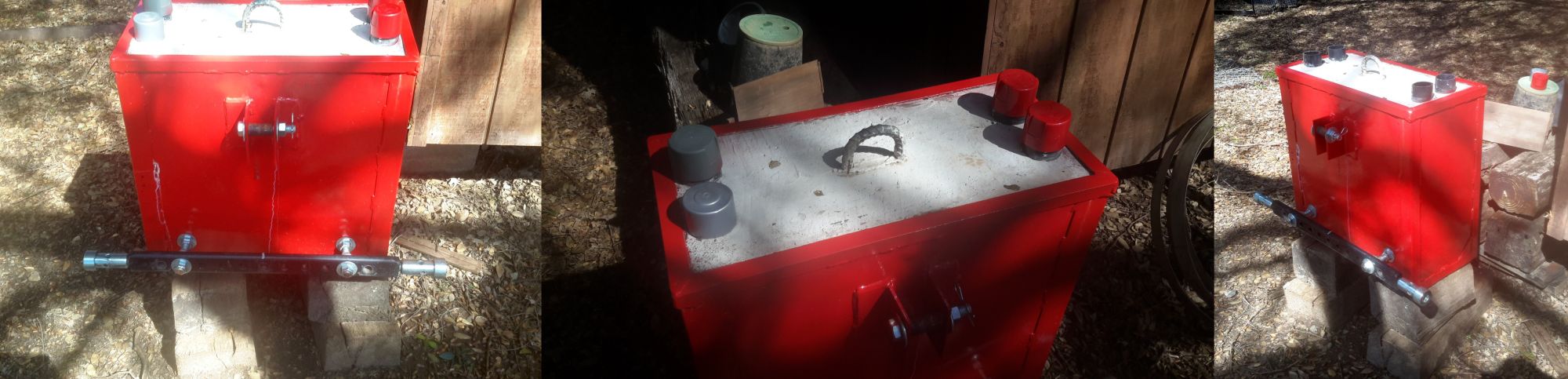

Didn't have any wheel weights so went with concrete... Frame made of old angle iron bed rails and some 10 gauge steel sheet... 8 - 60lb of quick mix bagged concrete... Found out old rattle can caps fit 2 inch ABS pipes (tool holders) really well to keep crap out of pipes...

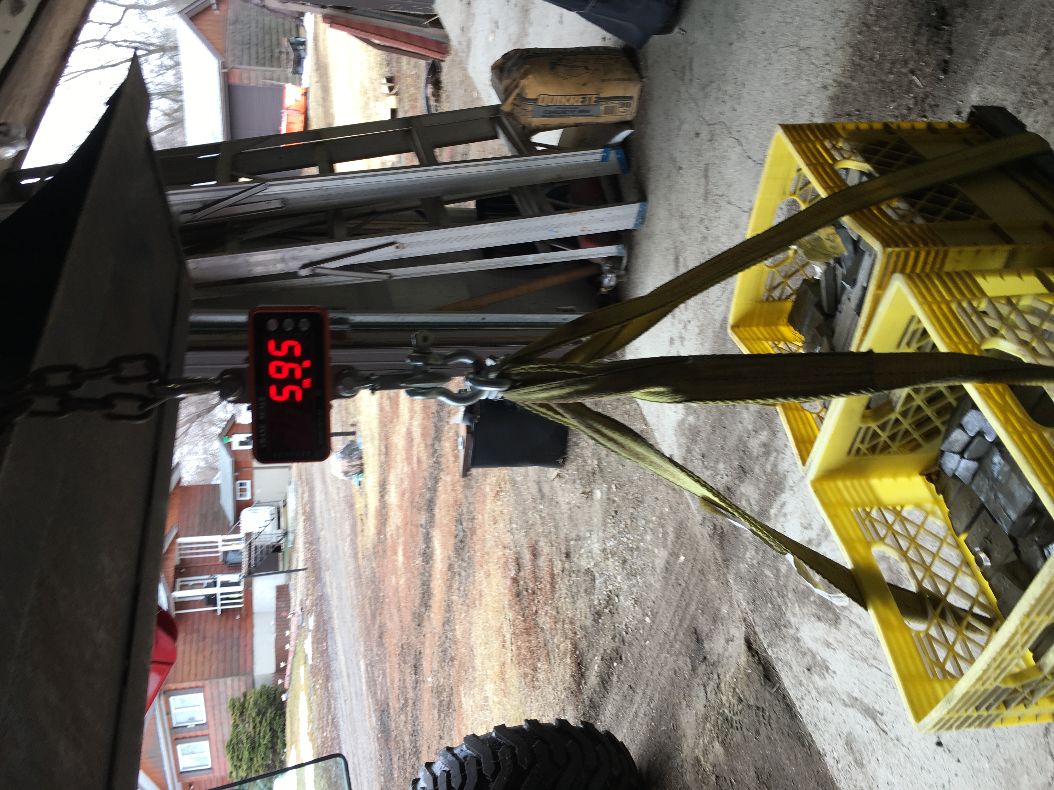

I lied, looked at my stash, found a couple hundred lbs not yet processed. Weighed the good stuff. Another get round to it job. 498E8915-05E5-49E4-82C8-2C938AE9B556.jpeg

I am going to make one out of concrete soon but you have a good idea.
I really like how compact yours is and still be very heavy.
