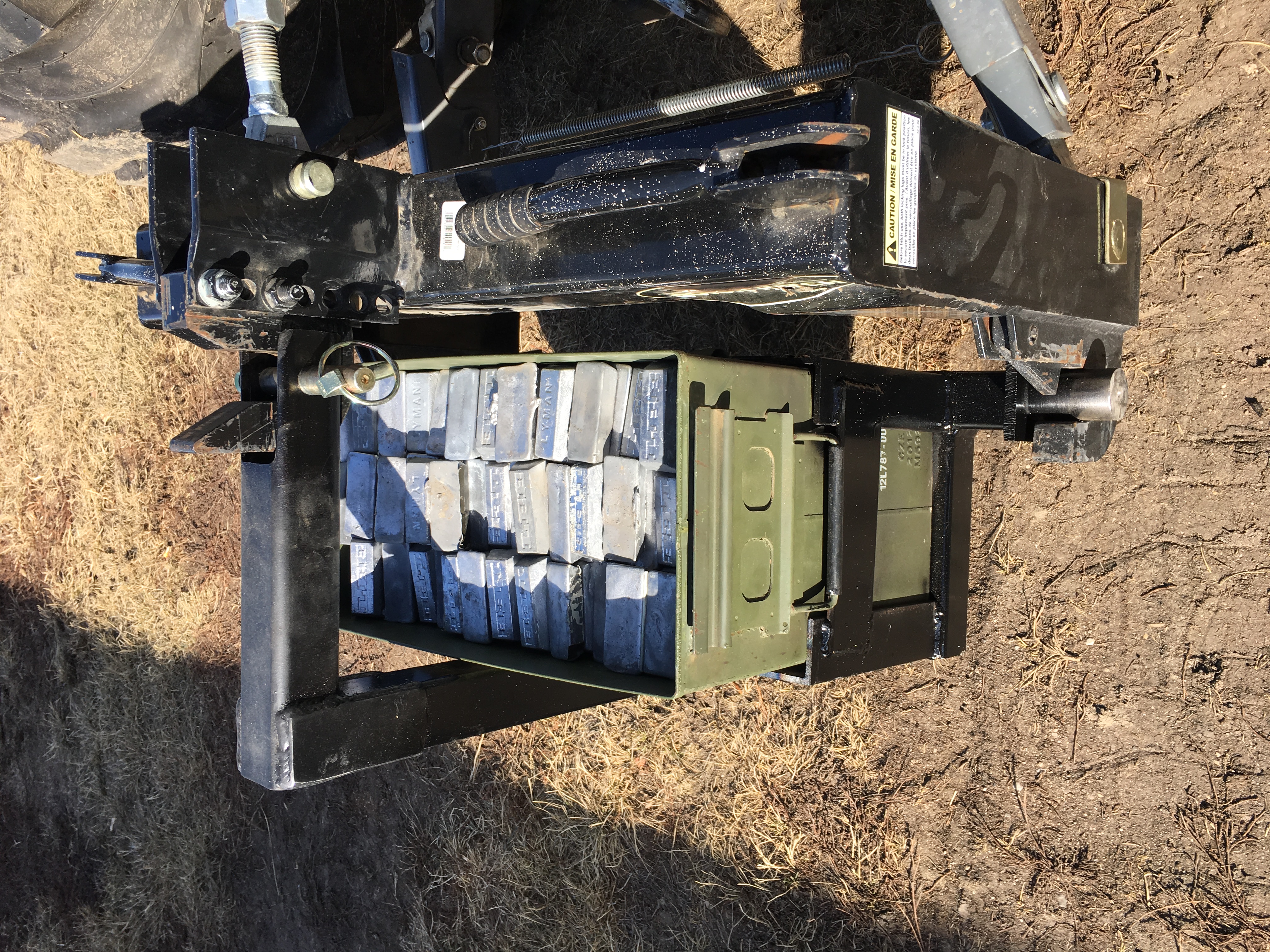

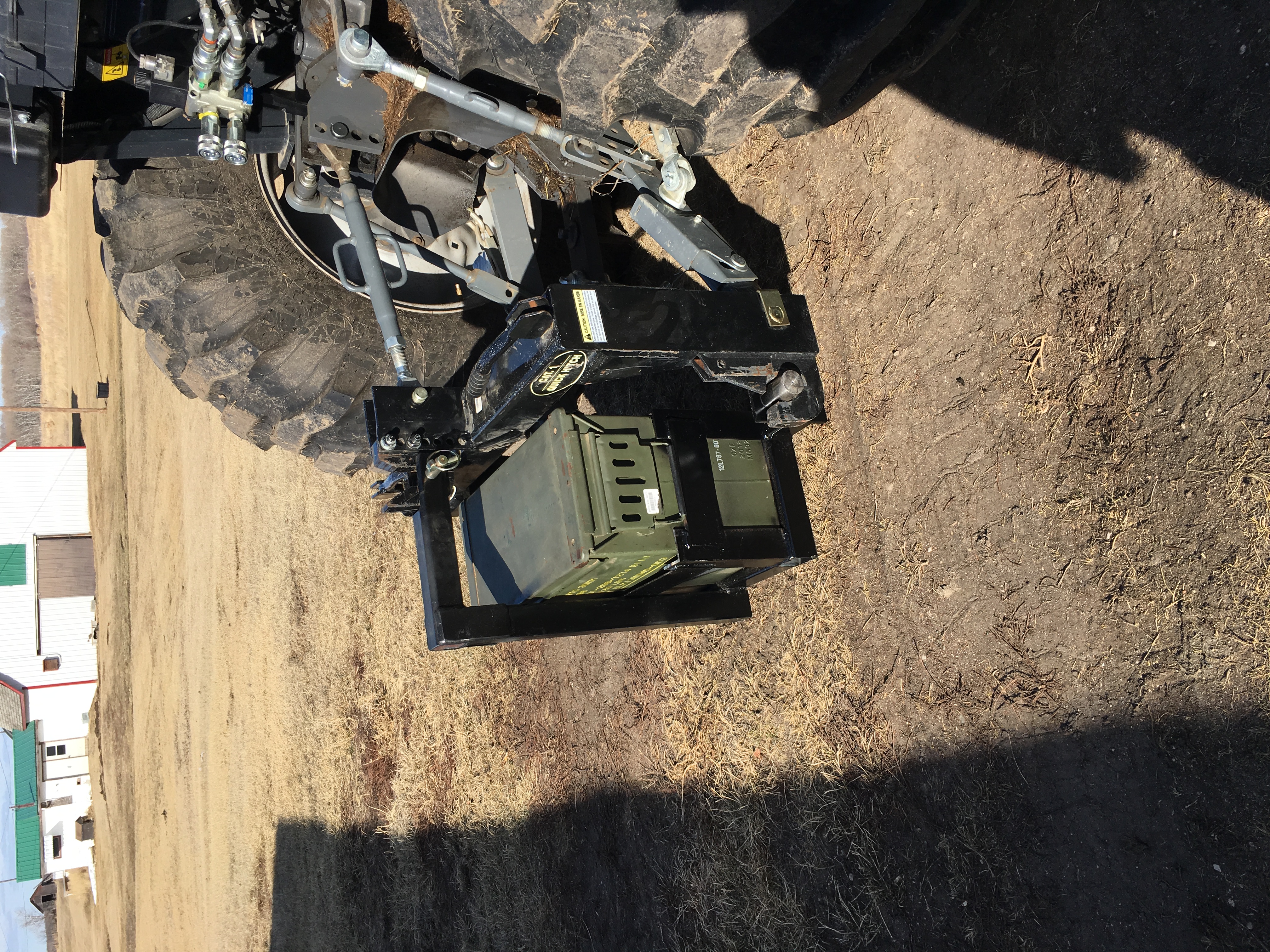

Pretty slick little weight, like the low center of gravity.
/ Counterweight #22
Nice. Very compact for it's weight which is great!!!
If you aren't too far,,, I'd suggest locating the lift pins so you can set it down anywhere. In the pic you won't be able to set it on the ground and get unhitched.
I often pick up my counterweight, do a five minute job, set it back down, never leave the seat, no special unhitching process required. :)
I’d have to second this, of corse mine is just a large concrete square so setting it straight on the ground isn’t a issue.
/ Counterweight
#23
I really don't want the metal frame in contact with the soil. A couple of concrete blocks will keep it up off the ground. Can't see needing to drop it anywhere but in the dedicated implement storage area. Bucket or fork work, both should have the weight on. Great discussions, thanks.

That's what's important. Design it to fit your needs!!!!
/ Counterweight #25
I have about 800 lbs of used sheet lead.
Would like to find an easy way of melting it, and what to use for a casting mold....5 or 10 lbs each
I melted mine in a metal coffee can on an old propane camping stove. I made up metal boxes to pour the molten lead into. I have one front weight for the smaller tractor and two weights for the land leveler.
For just casting into ingots, I use the 2# molds that bullet casters use. I have also used muffin tins with a half dozen round 5# molds. You can also cast into metal cans from peas, etc. You won't get the lead out of the cans but you can leave it in there until you need it and then just melt it in the cans (best not to fill to the top however.)
