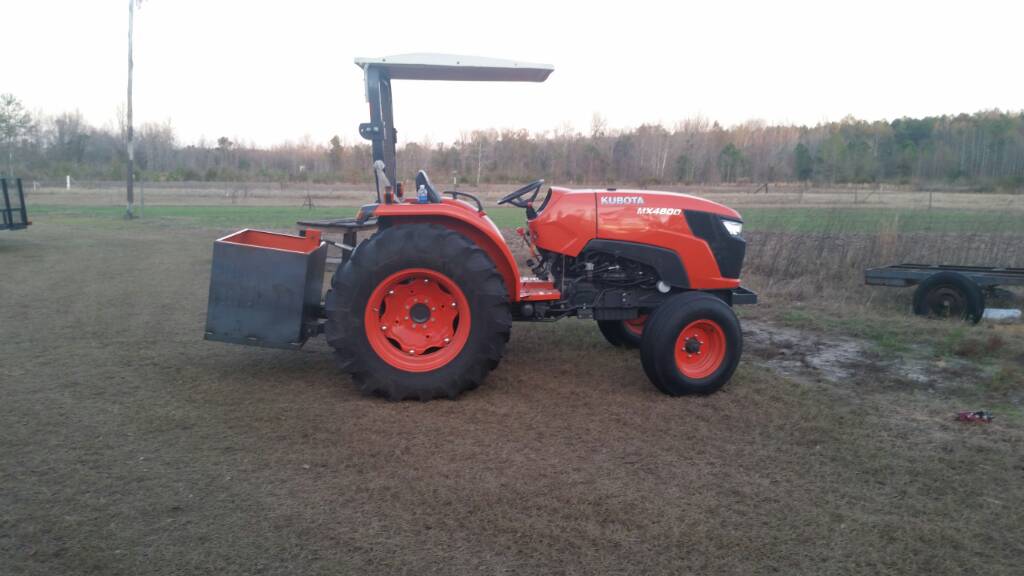

I'll bet the math number is very close to the real number. All quantifiable items and known weights.

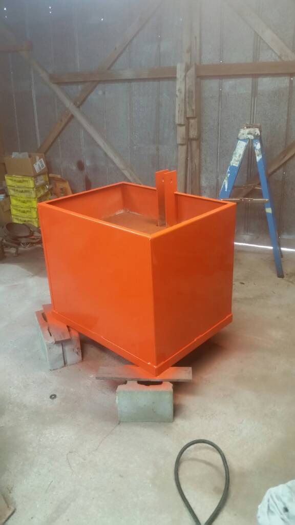

13 bags of concrete - 1040lbs
1 4x8 sheet of 12ga - 140lbs
6 pcs of 3/8pl 4x30 - 76lbs
Total 1257lbs plus the weight of water added to concrete.
/ Counterweight box #45
I googled scales and there are "crane scales" out there to rent but they start about $145 per day. Math is close enough, ha.

If you haven't poured the concrete yet, consider concrete pavers instead. You can easily add/remove weight for the task at hand or empty the box fully making it easy to move around and store when not needed.
/ Counterweight box #47
My box, total weight including concrete is just approximately 500 lbs and balances nicely on my B series. Welded a receiver hitch at the bottom and as others have suggested mounted PVC for holstering rakes and or shovels

Just o update this since I've gotten the loader the ballast is perfect in my opinion. Attempting to dig out some bushes yesterday in the yard and the loader goes into relief and I can't even feel the rear end lift at all.

And if you suffer no steering loss due to a light front end then it's perfect!!!! :)
