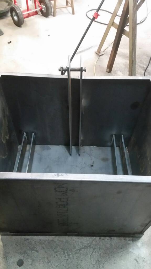

My box, total weight including concrete is just approximately 500 lbs and balances nicely on my B series. Welded a receiver hitch at the bottom and as others have suggested mounted PVC for holstering rakes and or shovels

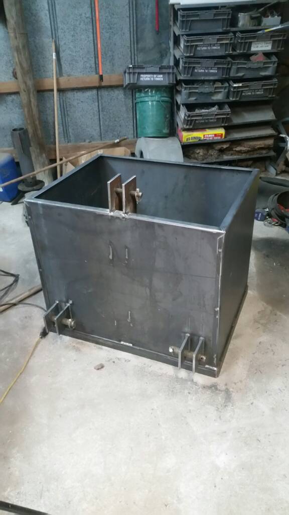

Have you weighed the box? I calculated the volume of that B8160 box and it would hold about 650# worth of concrete or 500# of sand (the 500# number is inline with Kubota's rating for sand). Then add another 100# for the weight of the box itself. So you'd be at 600# for sand or 750# for concrete, minus any loss due to your PVC tubes.
I am planning to weld a receiver too. Looking to do it internally to tie into the pins and top collar, and have the receiver poke out the back.

My 2 cents, If you plan to leave the counter weight box outside. Don't put PVC pipes in unless you drill out the bottom. Mine filled with rain water... same goes with space at the top, you'll have a puddle in there.

Yeah I'm defiantly going to drill some weep holes right at the concrete level when I'm satisfied with the weight although I don't keep much of my stuff outdoors.
Here it is with 13 bags of 80lb mix in it I won't be able to test it out until I feel confident it's cured enough to hold itself up and I'm not anticipating being able to move it until the LA1065 comes in.

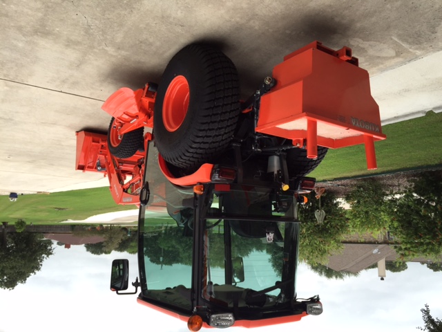

I put scrap brake disk/drums in the bottom of my old 60 gallon air compressor that got a leak. Bottom 1/3rd or just up to the toplink was filled with cement to lock the 3pt parts in better & cover the scrap. The rest was filled with dirty sand.
/ Counterweight box #31
Years ago I had a counterweight barrel and filled it with old pieces of steel and bolts. I could add or subtract if the situation warranted and it worked great for me.
I have not weighed the box, but I put in only 400 lbs of concrete which when you add the aprox weight of the box would come out close to 500 lbs. Yes I do have weep holes in the bottom of the PVC and the box so if it does get wet water will drain out the bottom of the PVC

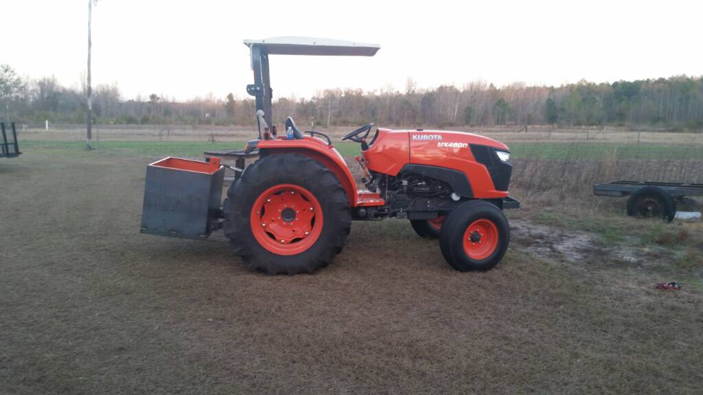

Update hooked the tractor up to it for the first time and it picked it up no problem. I can deadlift the front end of the tractor and judging from what I can do in the gym I'm thinking I'm around 200lbs on the steering axle right now. I've got it in the shop ready to spray tomorrow and I have a piece of old 1/2 conveyor belt big enough to cover the concrete.

Yep I'm pretty happy with it as is but I'm only around 1200 lbs far less than the 2000 I was aiming for. I'll have to see how it responds with the loader installed.
Moving this behemoth magnolia will be the first test.
