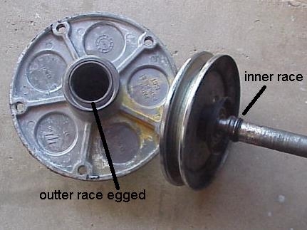

Yep, there's plenty of evidence quality has gone to **** but a good percent of lawn tractor application failures is the manufacturing of the assembly they are used in and that isn't a recent problem. With ball bearings, one of the 2 bearings needs to be able to float ( push fit ) and how many manufacturers do that? Very few.
Extreme example: A very non mechanical Brother In-Law takes his tractor to a mower repair shop to have the deck bearings replaced. After a few hours operation he calls me saying he doesn't think it's right. I disassemble and find 1 assembly was re-assembled without the spacer sleeve between the bearings. If you be mechanical and understand the forces ball bearings were designed for you know that those 2 bearings didn't last 30 minutes.

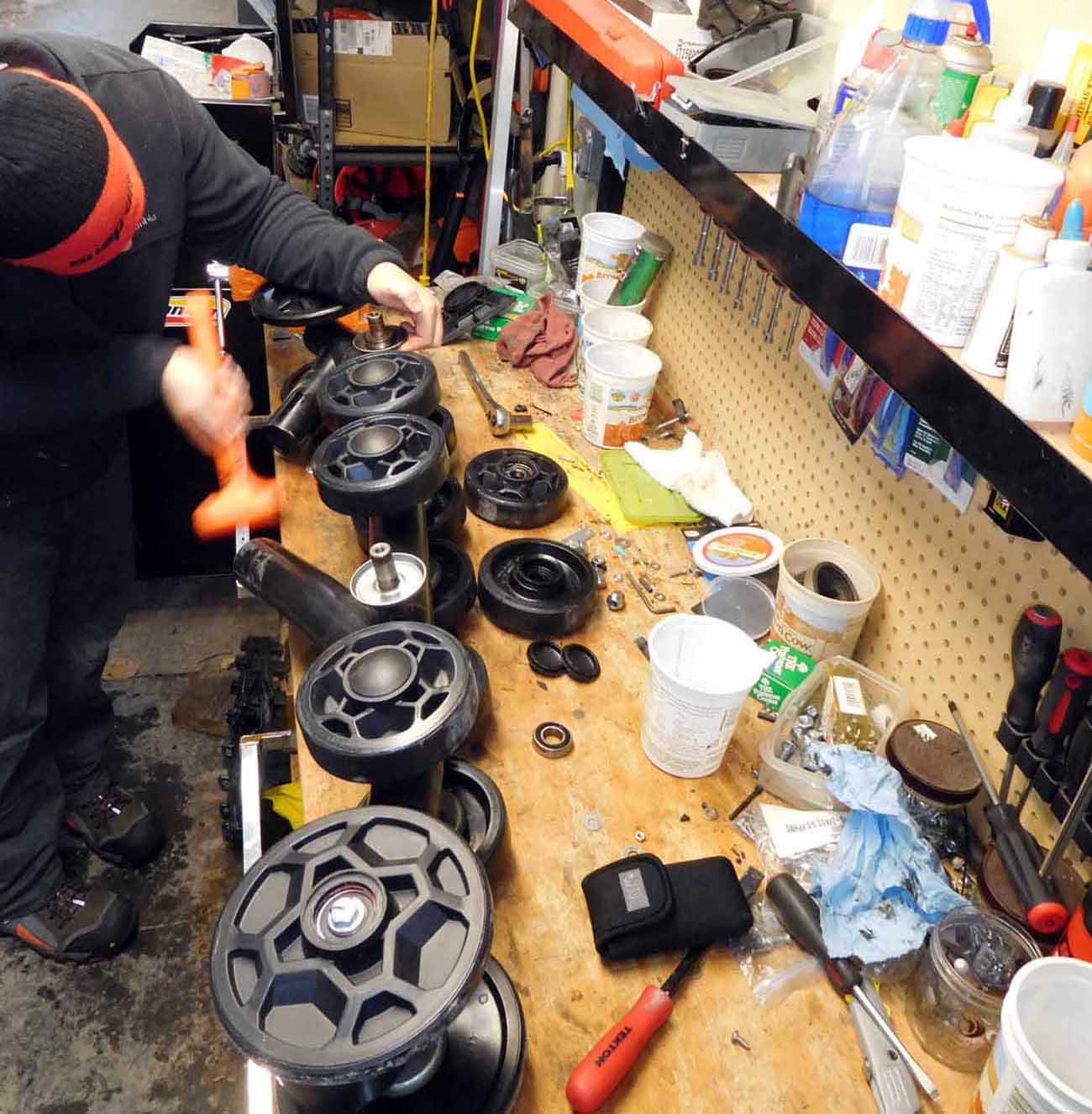

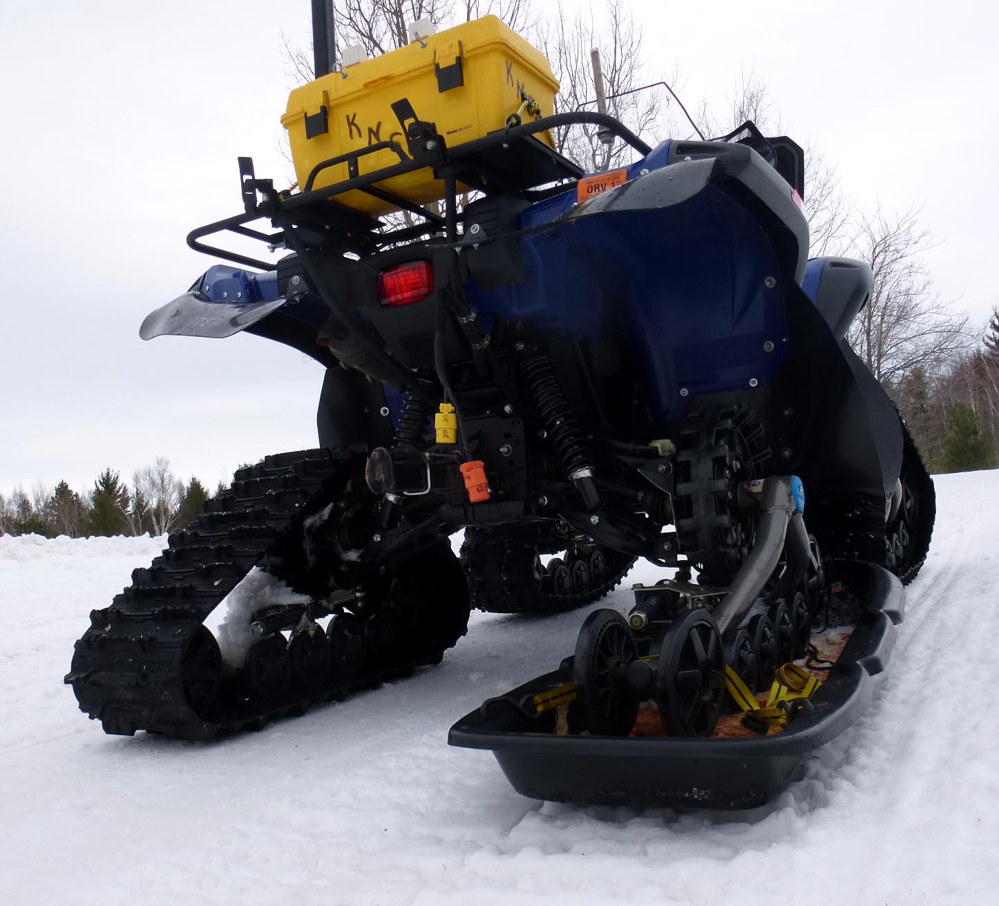

We used track pods with many, many bearings in them so the manufacturers reduced there price by putting poor, less costly bearings in them. They'll used $3 ones and they should go for something for more $ that actually have seals in them. They'll only last a few years, then we're out looking for new ones or something that's better than the crap the manufactures installed.. No fun having to drag a lame machine in.... OEM does not necessarily = better
