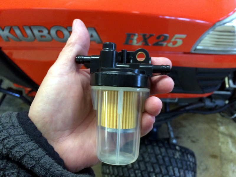

I have that filter to convert my BX25 when it gets warmer. If it ever gets warmer!
Bottom of bulb to top of mounting flange - 4.420"
Bottom of bulb to highest point (OAL) - 4.435"
Do you have a P/N for this assembly. Thanks!
Not to high jack the thread, but I'll be interested to see where and how you mount it on your BX.
Me to.... Iv purchased a slightly larger inline NAPA Gold filter #3324 that looks small enuf to substitute in next change in the BX. Both D and L are a little more - maybe itll give ~ twice the filter area. I have hi hopes.

Roger,
I measured the filter assembly, height only. From the top of the higest point of the base to the bottom of the bowl is 4 11/16. Hope this is the information you sought.

Roger,

Thanks, I need something under 5'' for where I plan on mounting it.
   / Could you measure your B or L filter assembly for me? #18
The 3972 is the factory filter for the BX.
The 3927 IS NOT EQUIVALENT to the BX factory filter, the 3972/33972 is PLASTIC MESH with a 50 MICRON RATING where the Kubota BX filter is water blocking paper.
