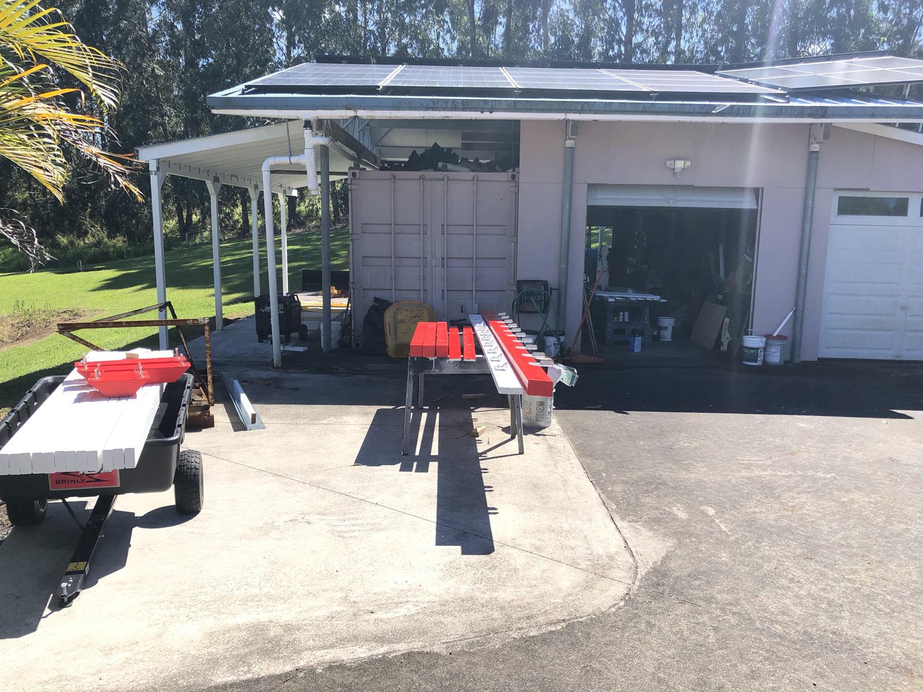

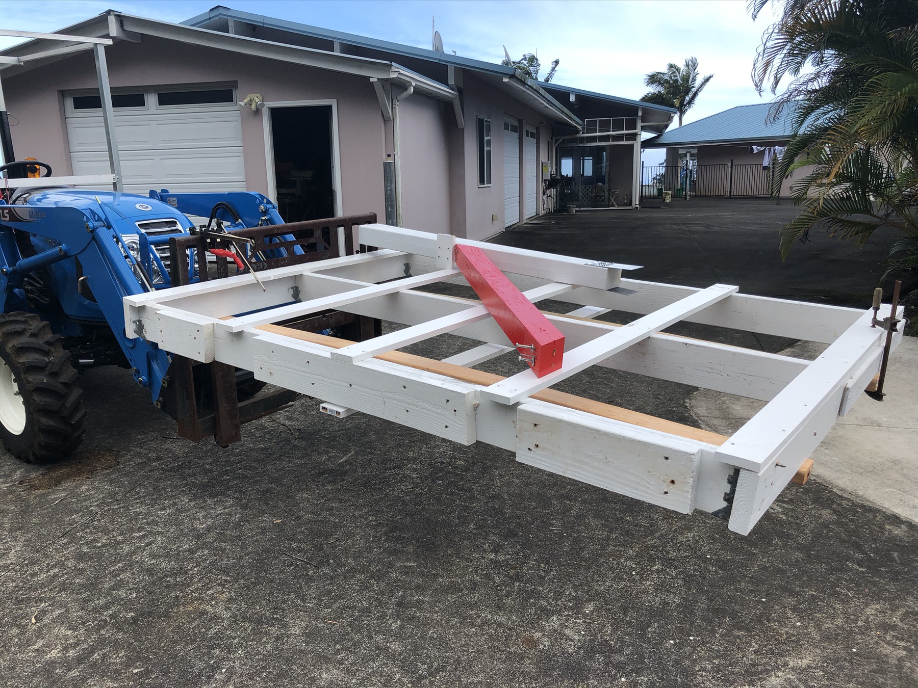

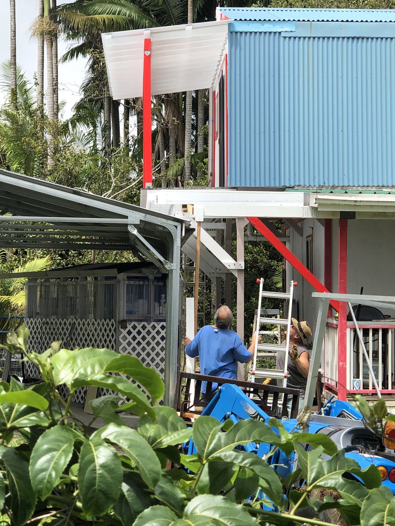

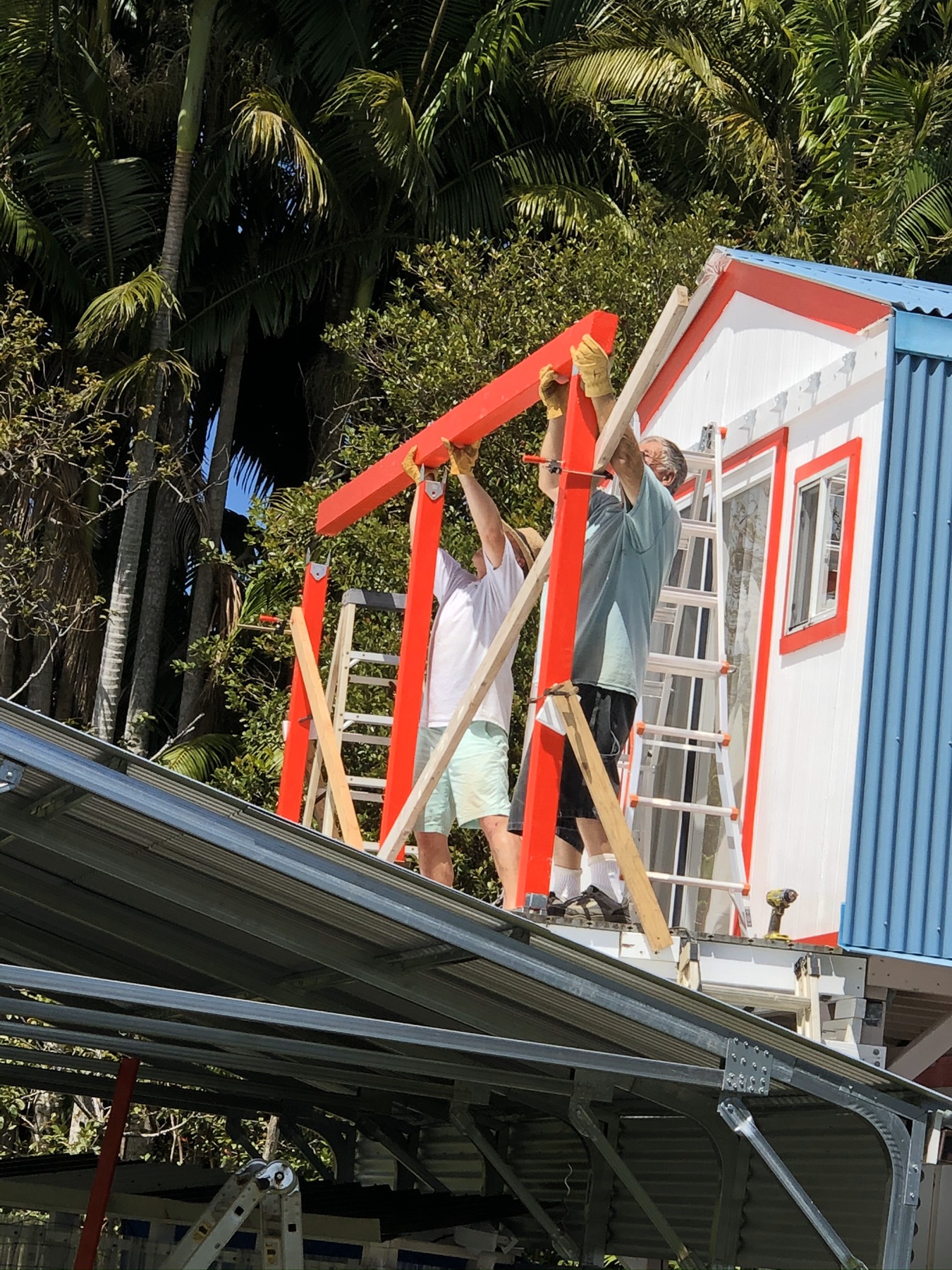

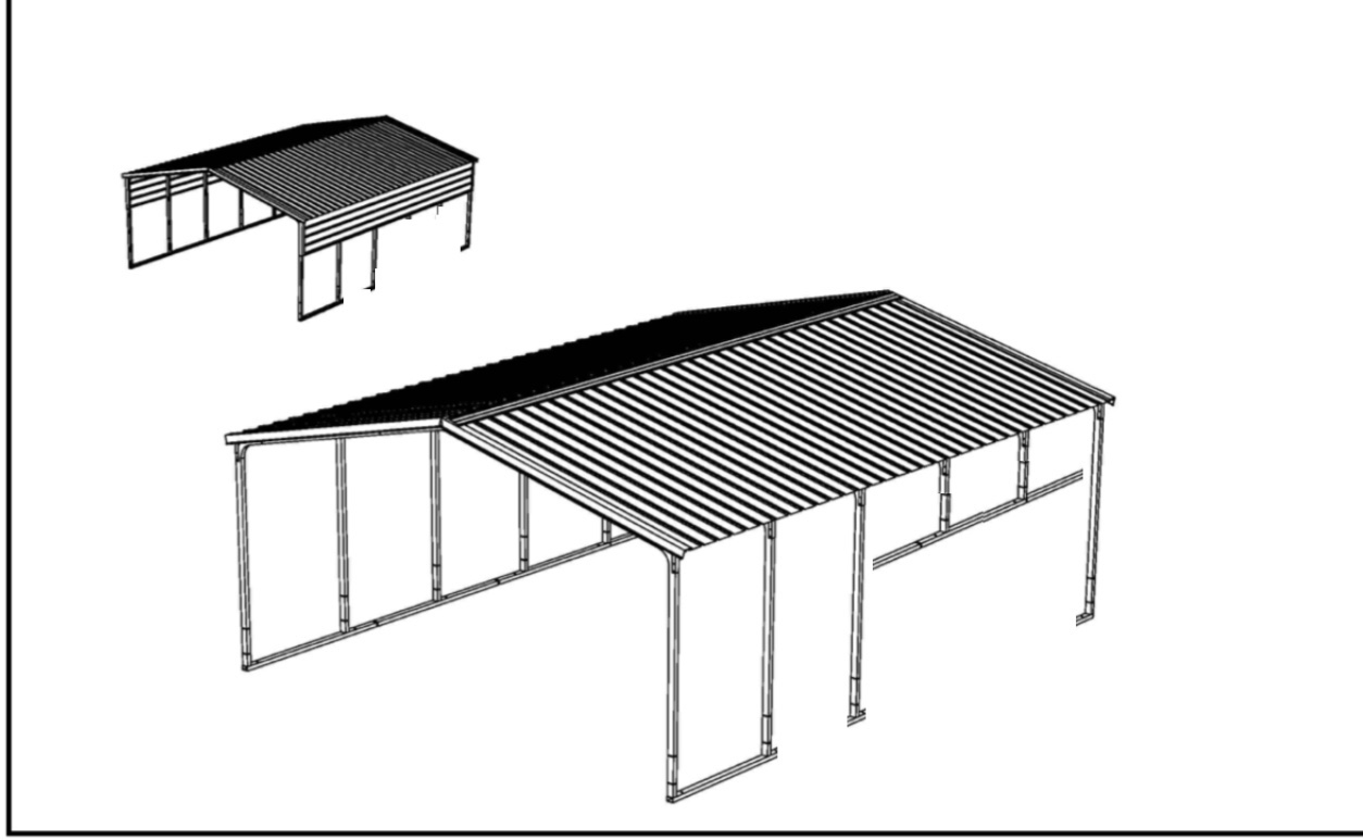

Prepping for cover over rear upper deck.
Rafters, posts, etc cut and painted. Ready to start preassembly after paint dries. Tomorrow.
Goal is be ready to assemble in place on Wed, wx permitting.
/ Cottage Carport
#142

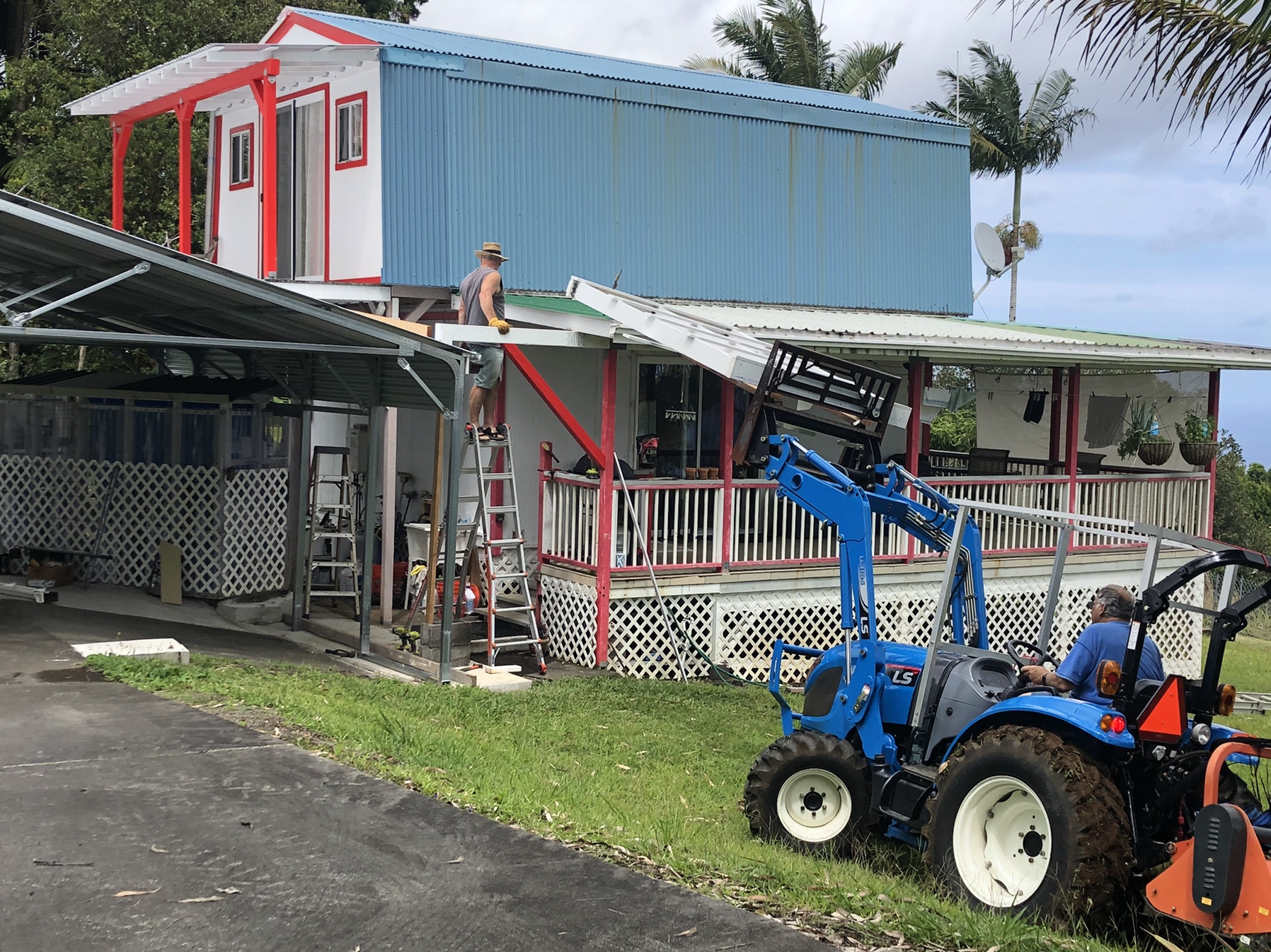

Got about as much done as I can without taking everything onsite and actually putting in place. Think I have a logical plan and Canada Dave agrees so tomorrow.

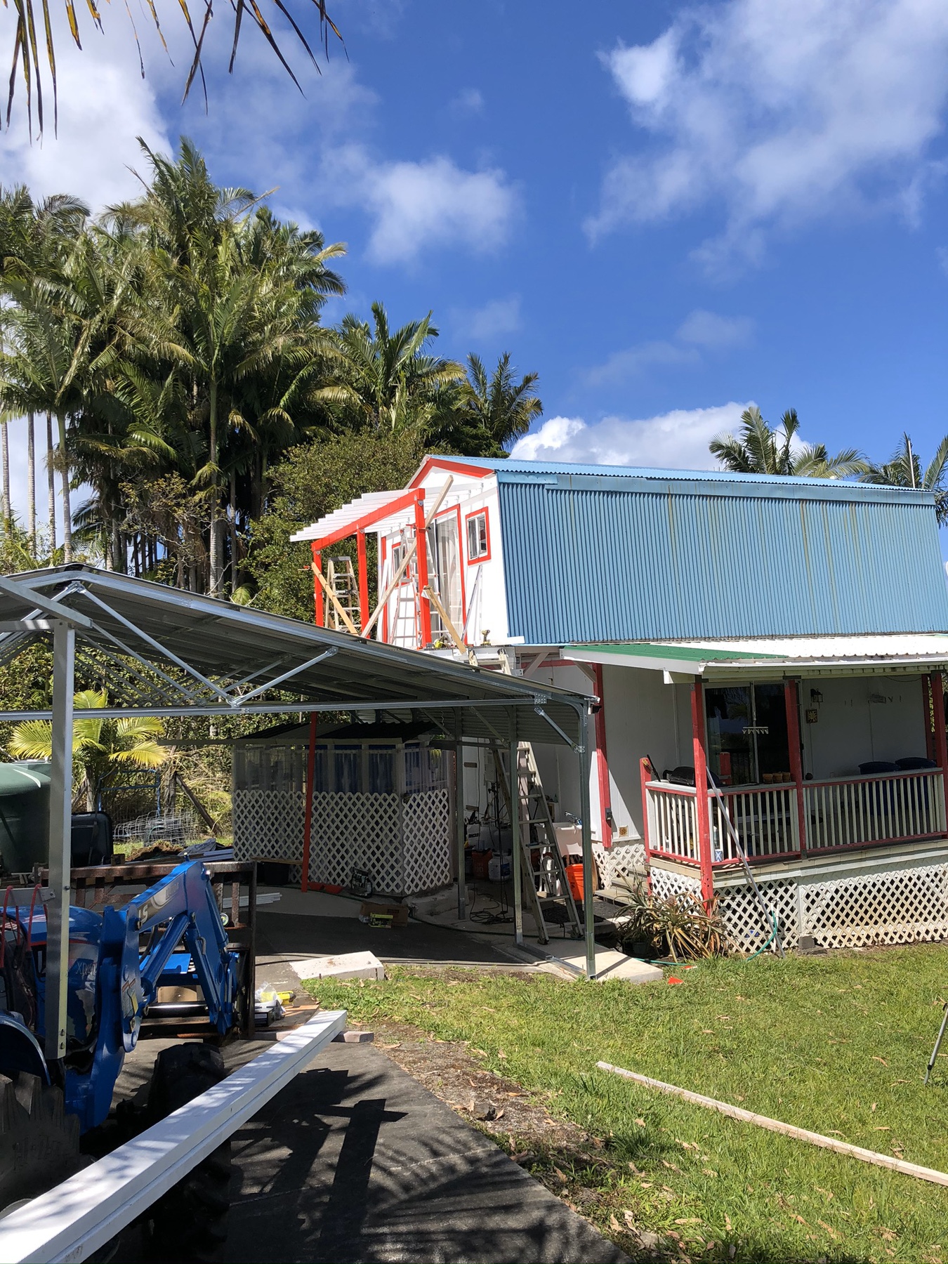

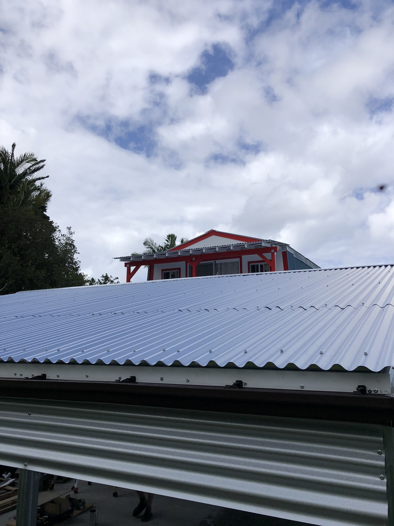

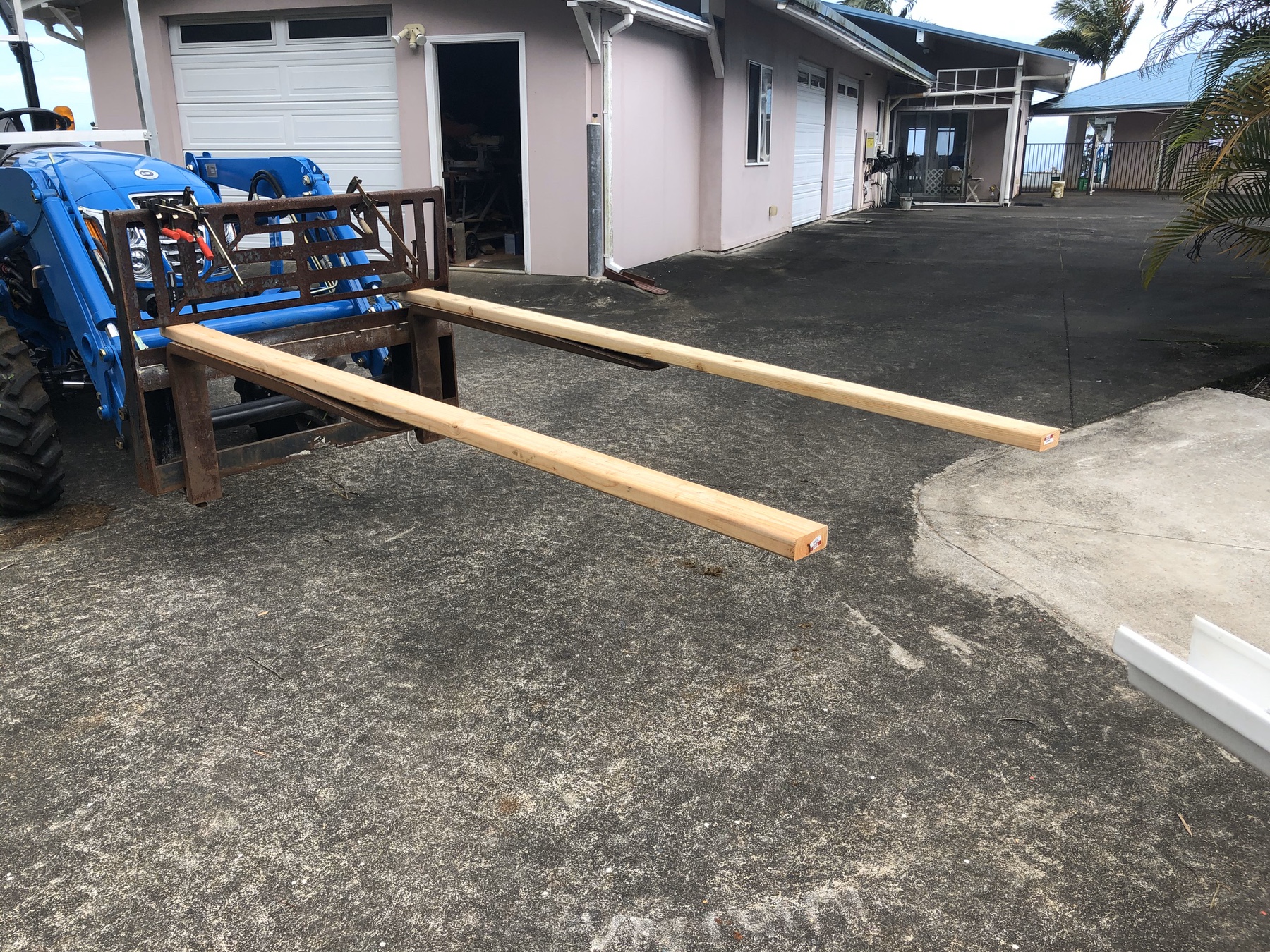

Tomorrow purlins and roof metal.

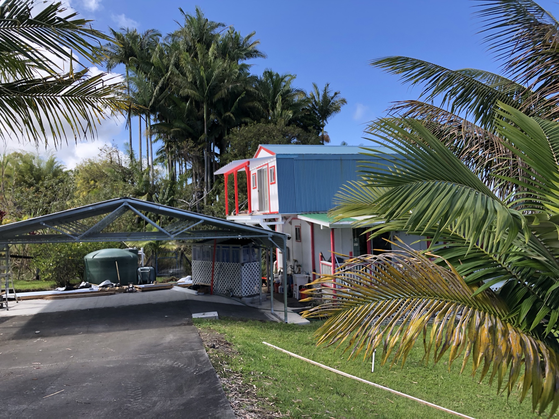

How warm or hot is the water coming from your water tanks after setting in the sun (just curious)?
In the 80s I spent 6 months in south west asia and all our water was in tanks and if it was sunny it was hot, but Hawaii is not as hot.
I like your carport. :thumbsup:

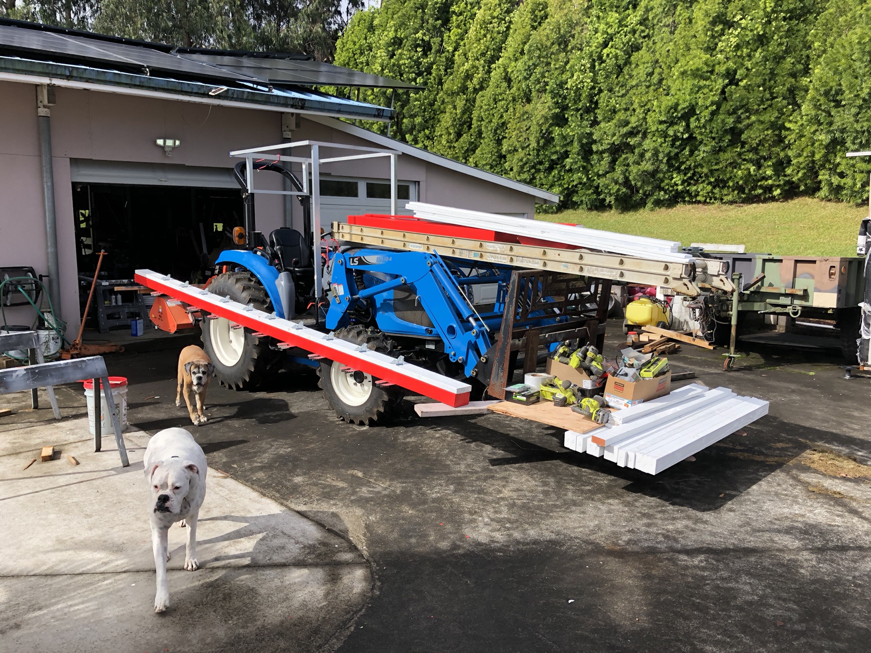

/ Cottage Carport #147
That's funny!!!! You just never realize how useful a tractor is until you have one.
That’s a tractor under there? I thought Jed Clampett had arrived.

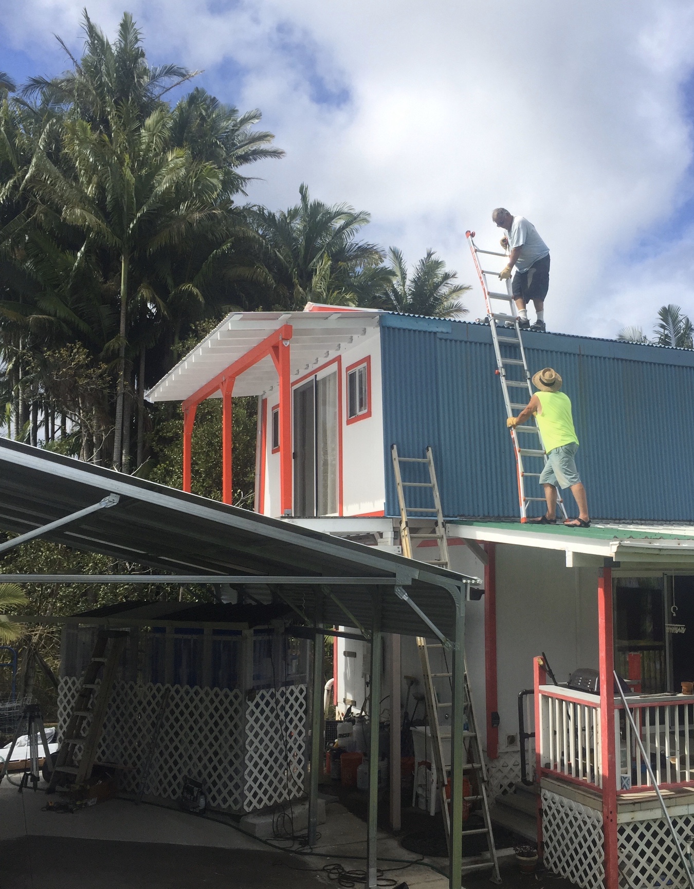

One more
/ Cottage Carport #151
Awful high off the ground for a couple kids!!!!
/ Cottage Carport
#152
I think the older one (me) may have left some fingernail marks on the new tin.
Normally in upper 60’s, maybe low 70’s at peak.

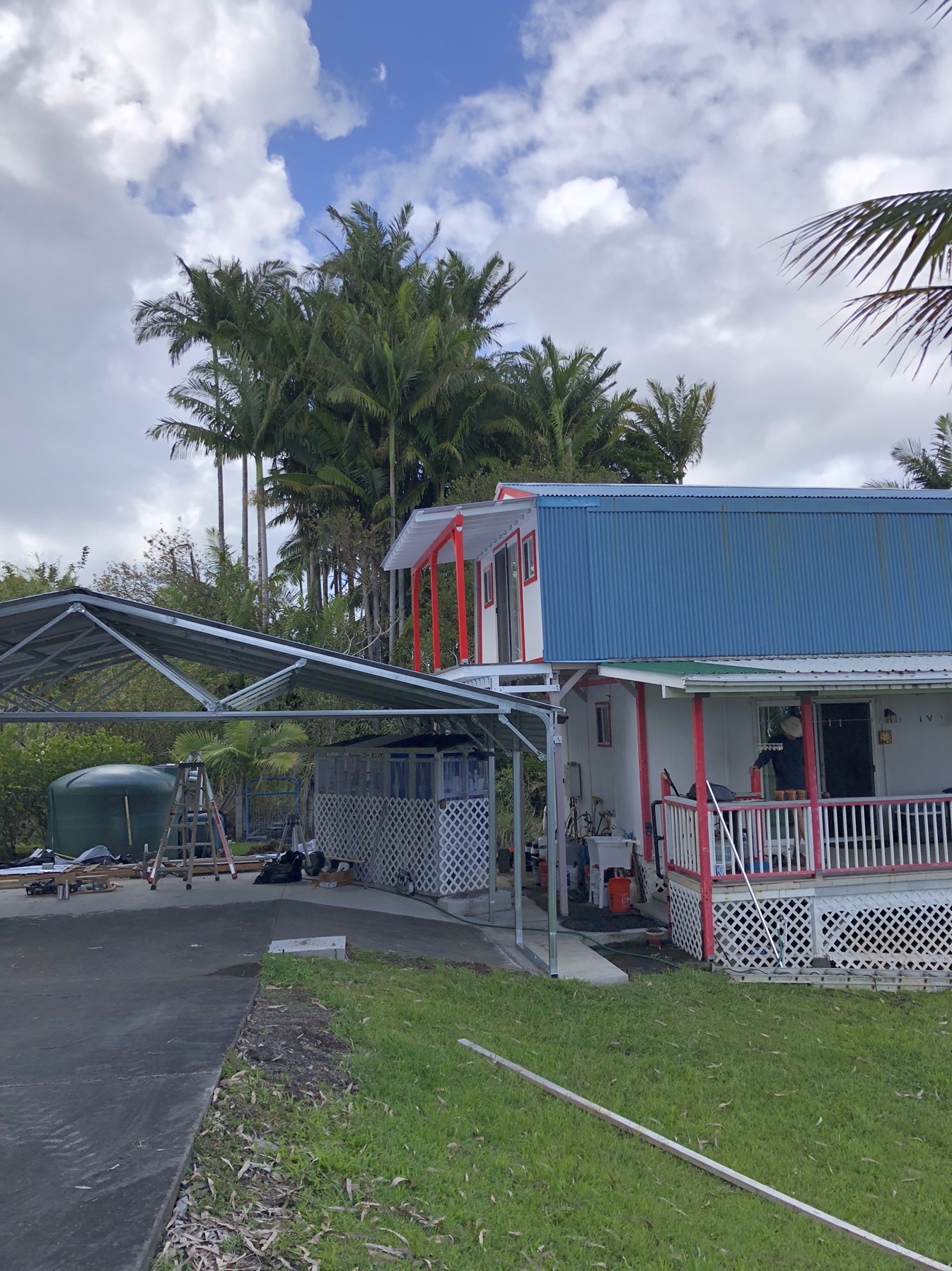

/ Cottage Carport #156
Nice!!!!
Maybe you said already, what kind of Drone do you have. I fly an Autel.
/ Cottage Carport
#157
I have a Phantom 3. My cottage tenant took this with his Mavic.

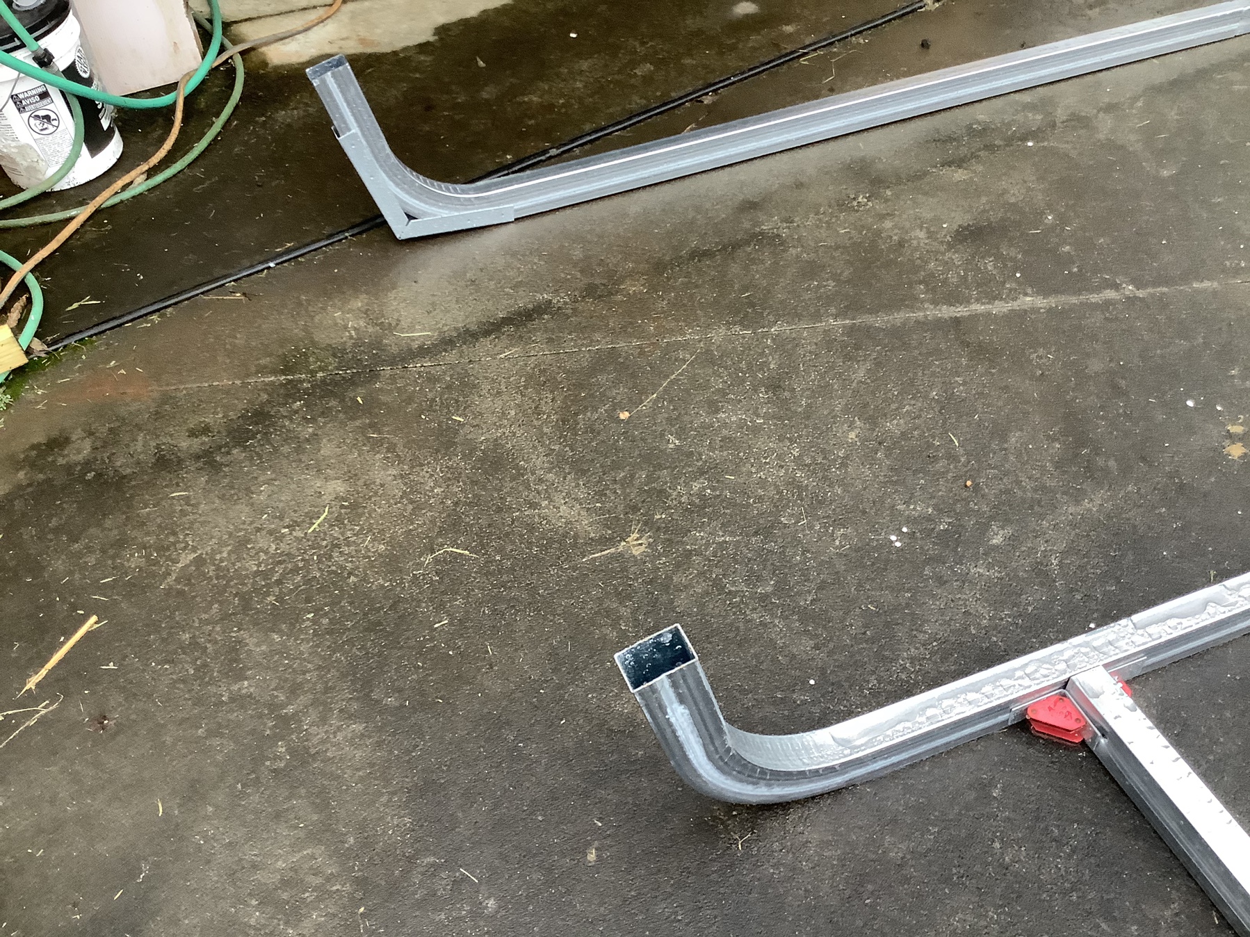

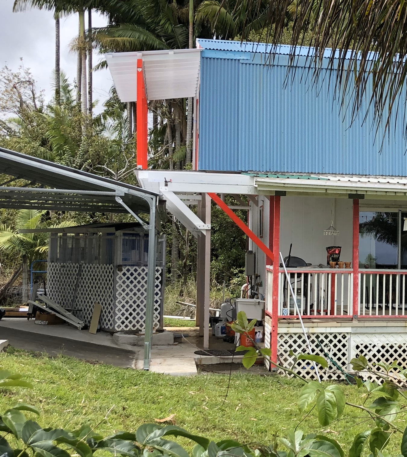

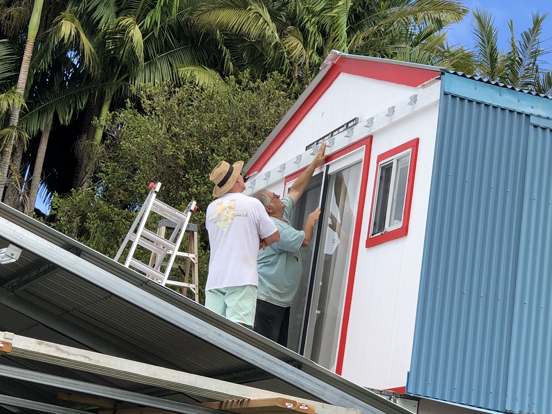

Last section of new roof finally in place, gutter installed. Still need to flash cottage side.
Still a lot of smallish details to address that will add up to be time consuming.
Hope to be able to start hooking gutters into catchment by next weekend.

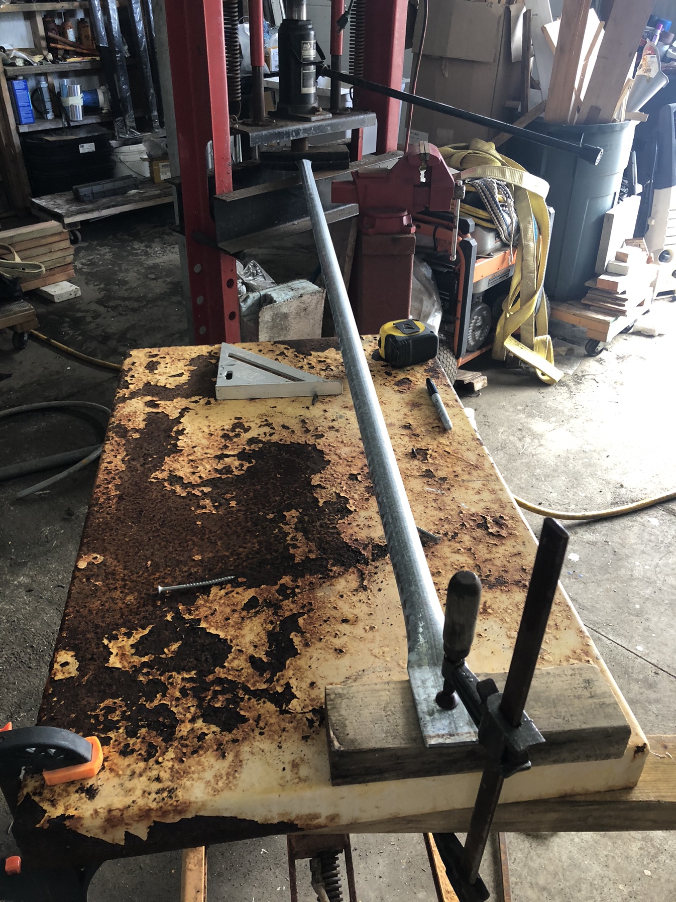

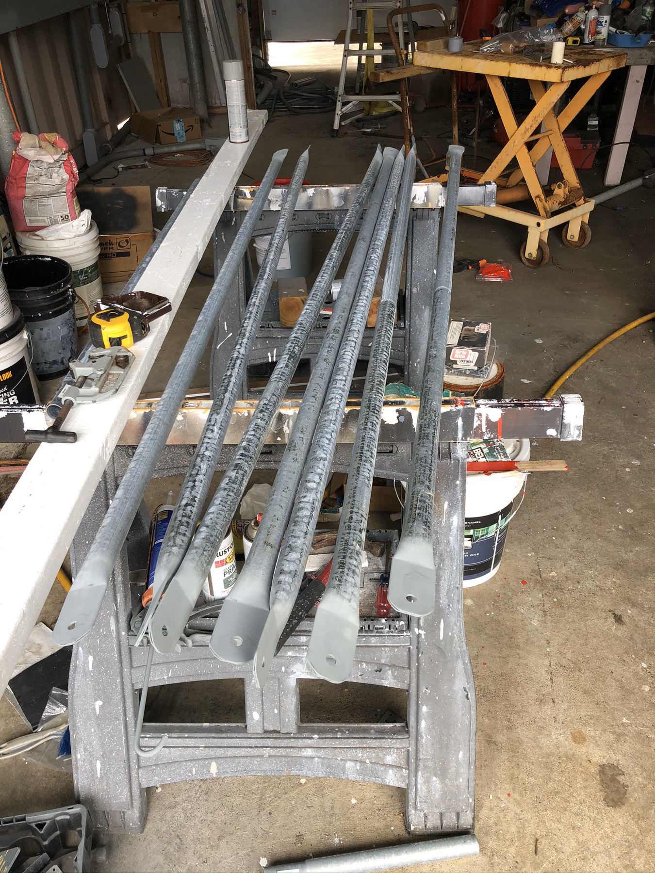

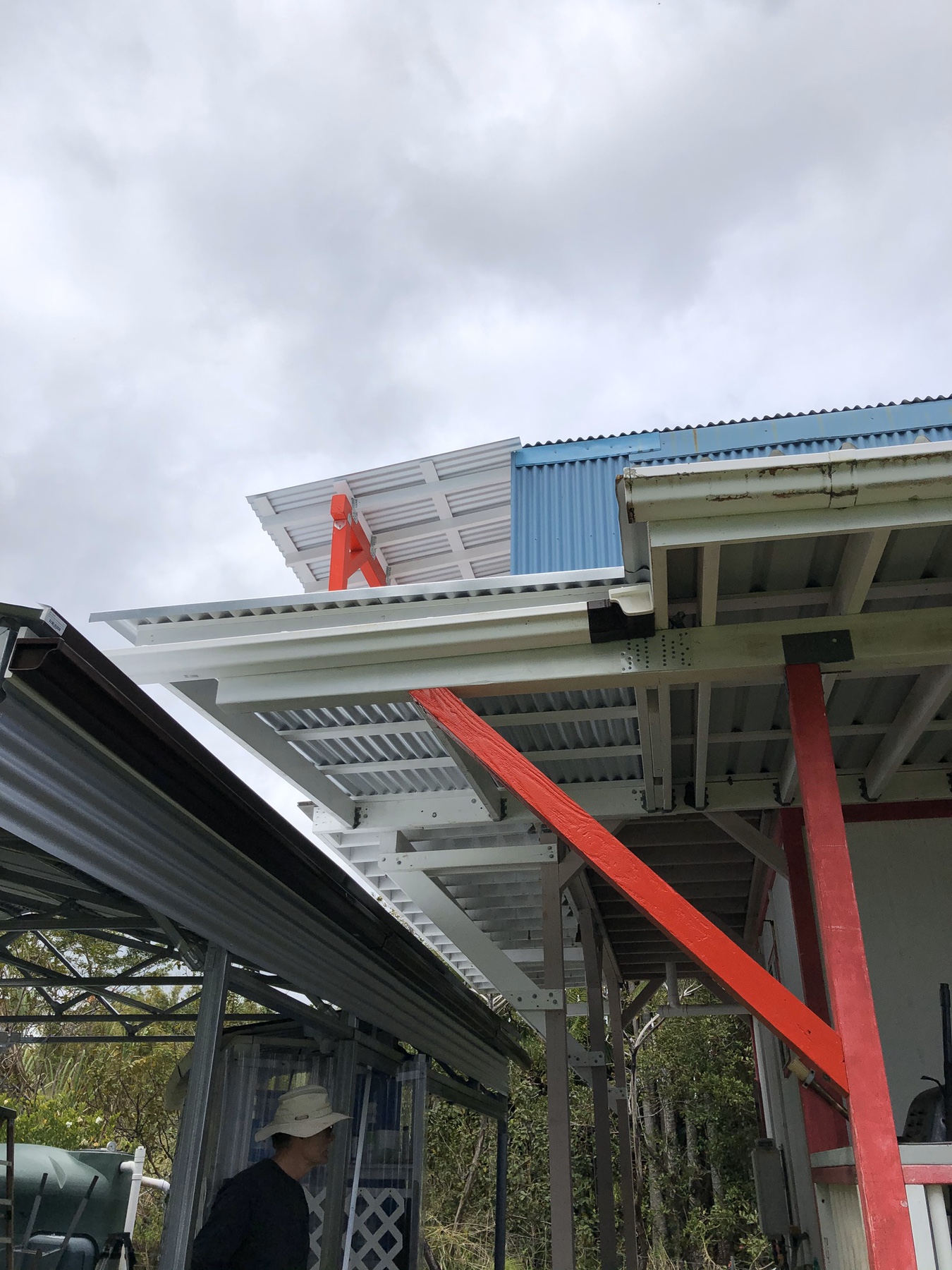

Another good morning
Got my cross braces installed. Not part of the kit, but my own addition.
Attached with 3/8” stainless carriage bolts.
Made from galvanized pipe, 1 3/8” I believe. Top rail for chain link fence.
20 ton hydraulic press, drill and some galvanized spray
