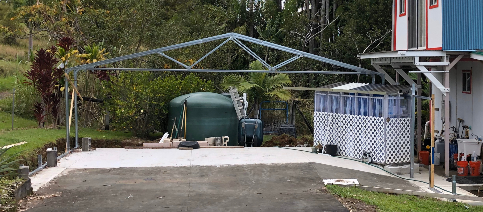

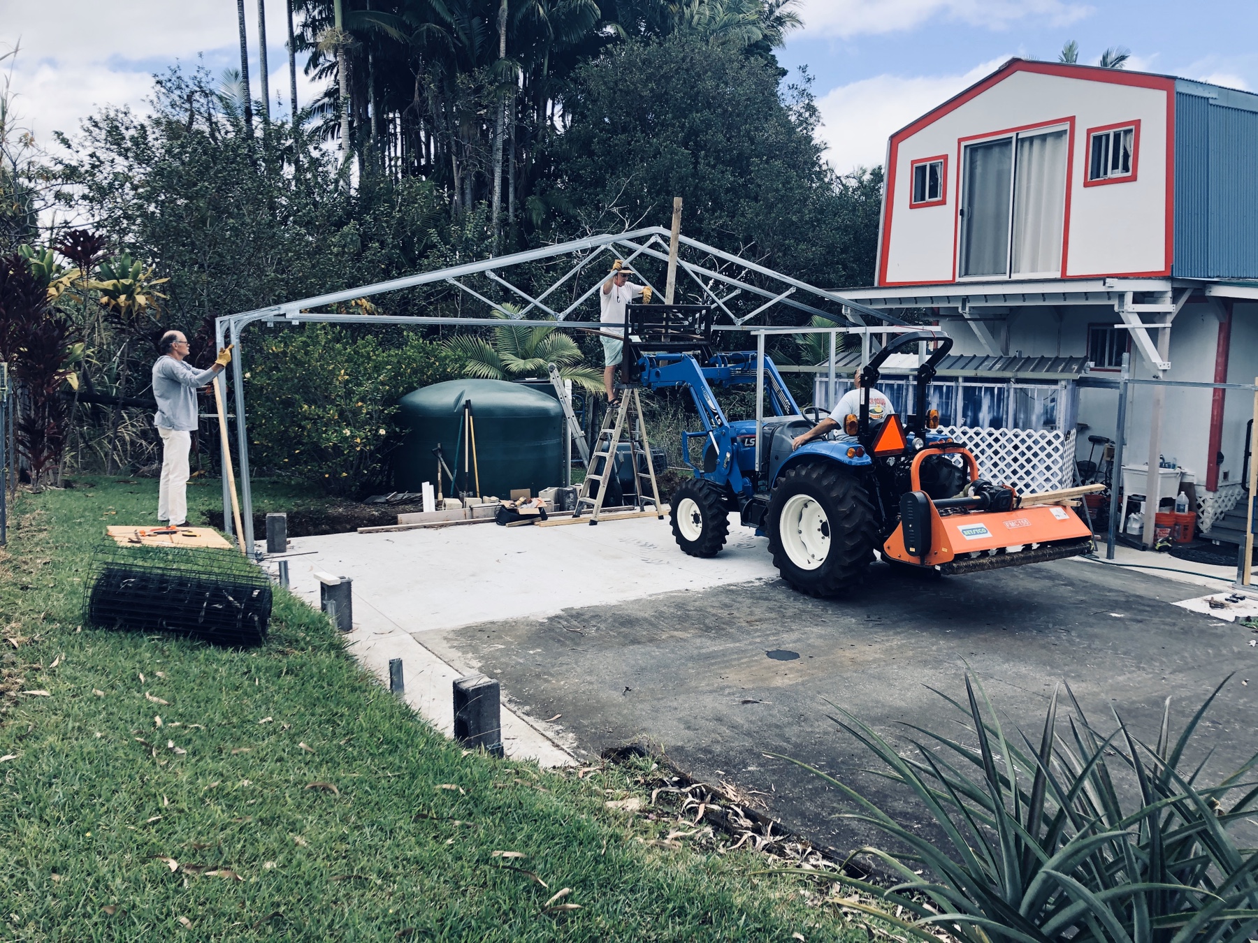

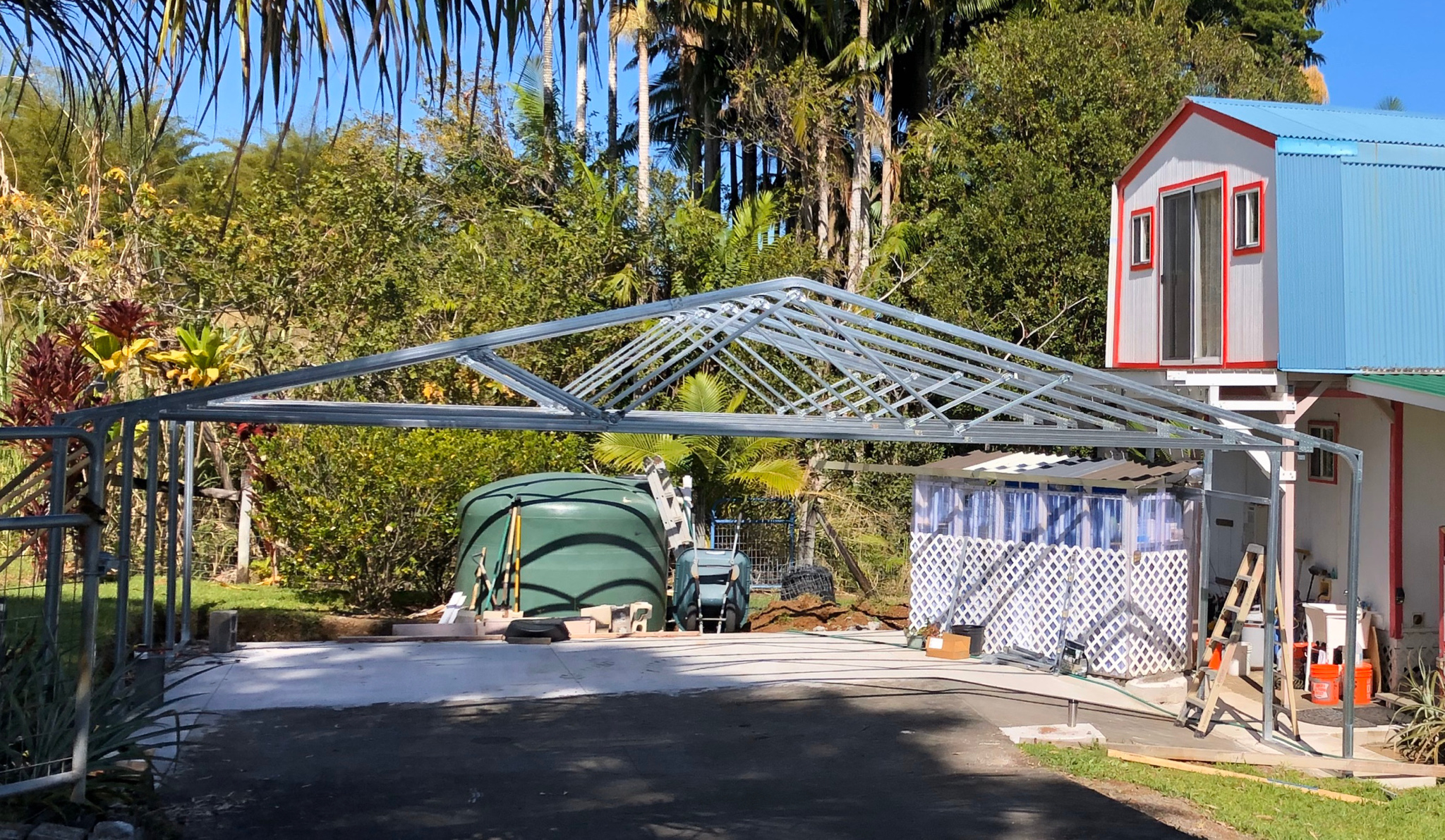

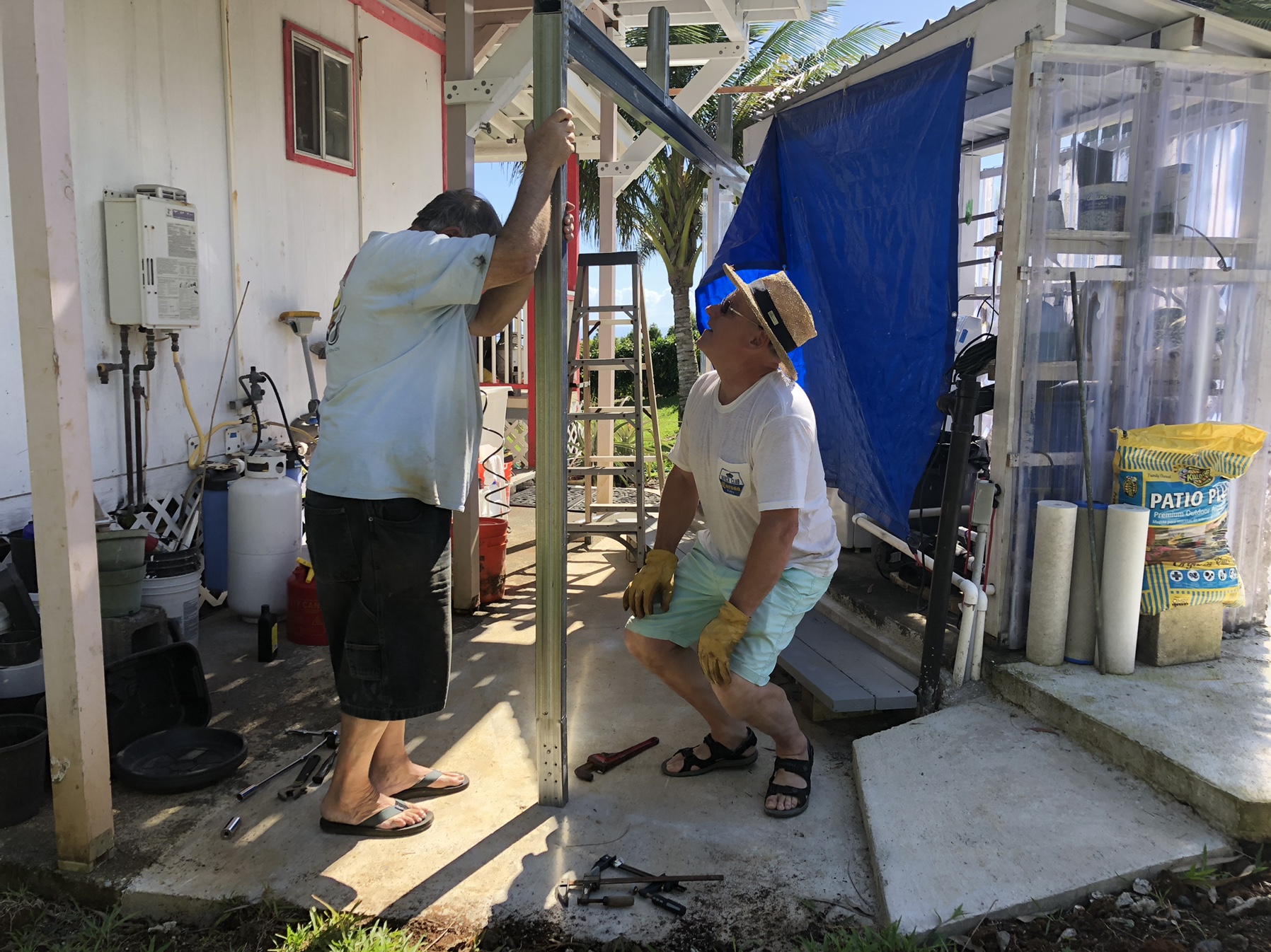

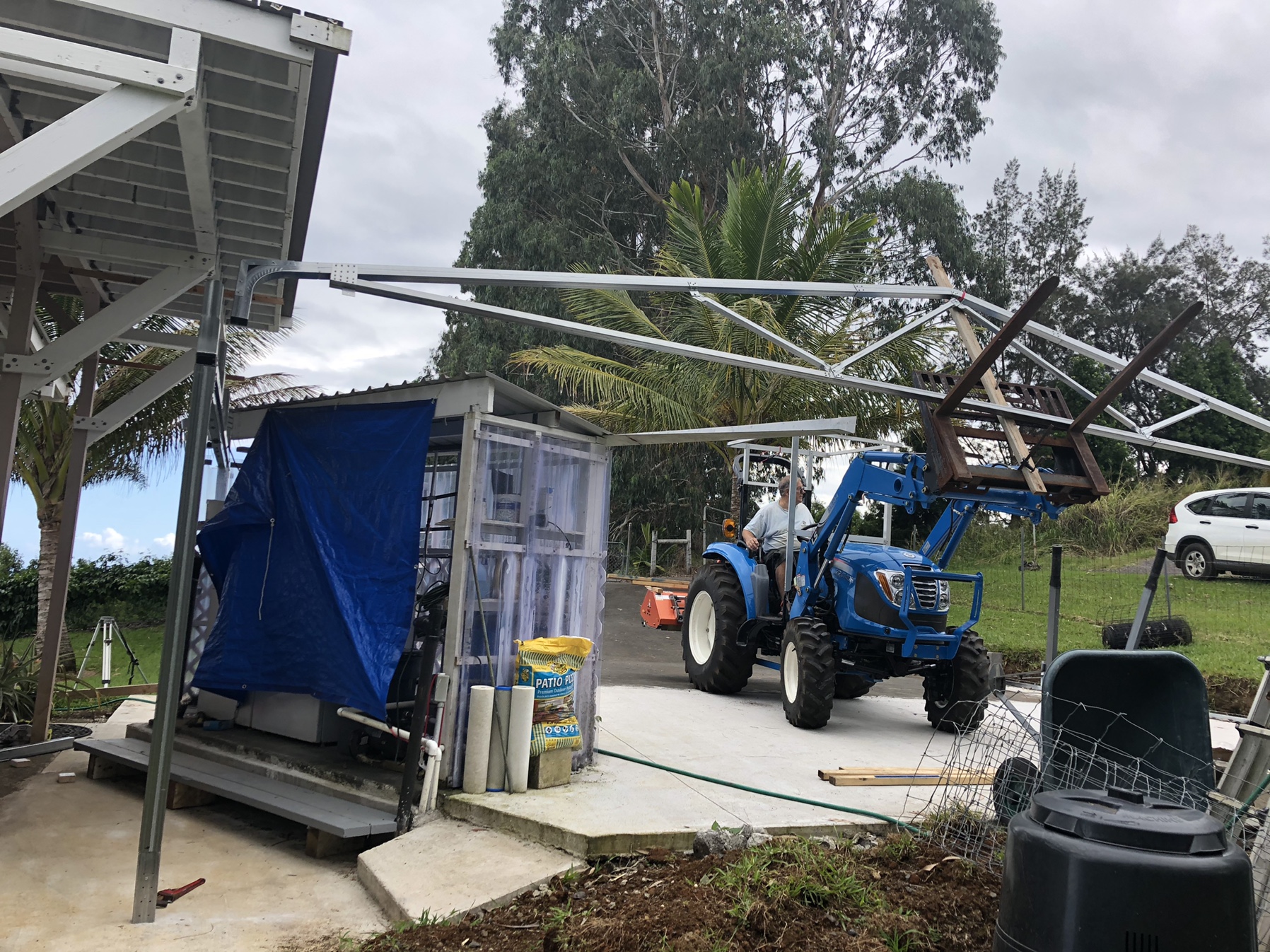

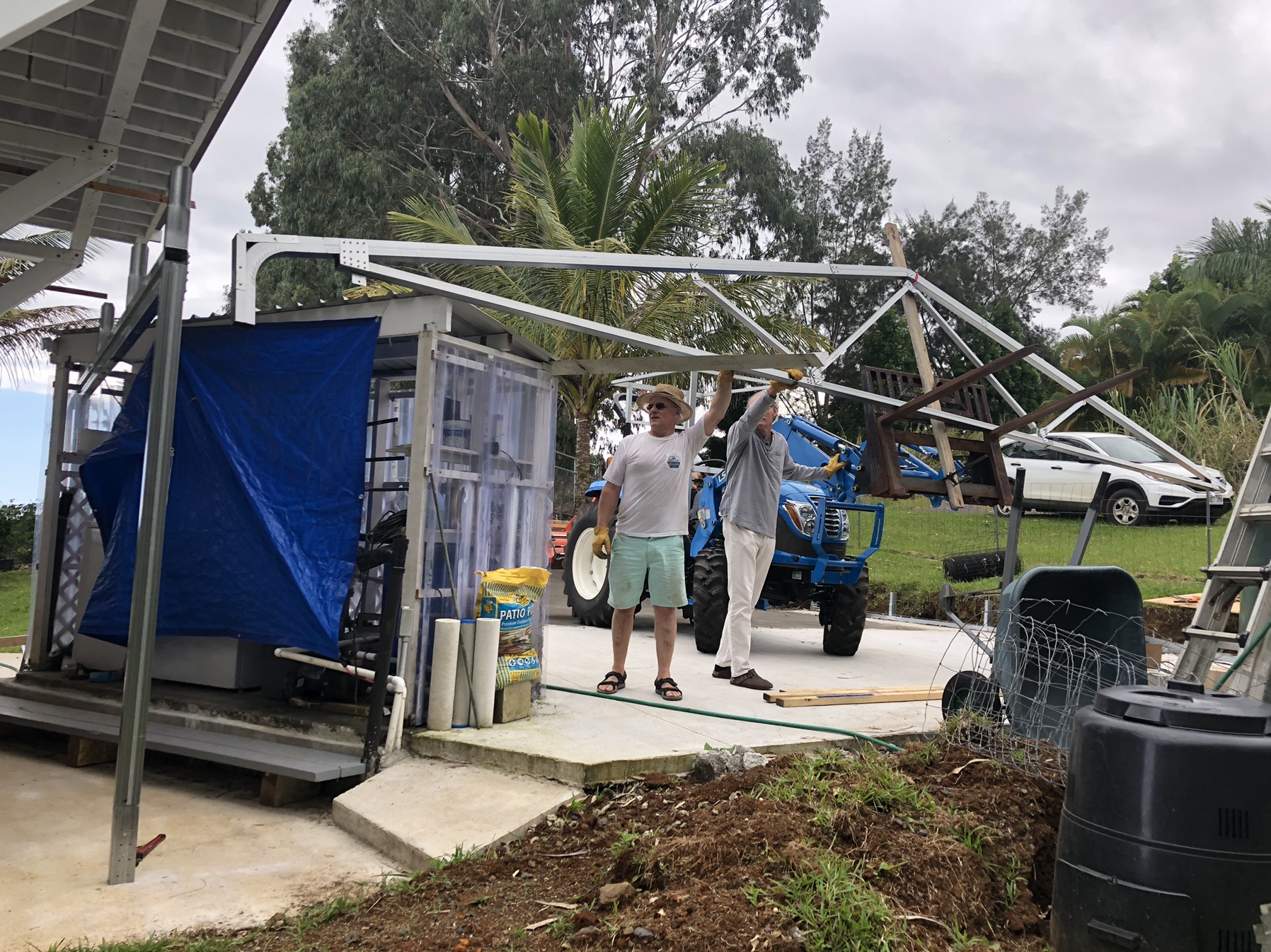

Got the rest of additional (5) braces installed. Used the unused 2x2 bracing from the kit at full length, just angled the ends for attachment. One end thru middle of 4x4 post with 3/8 bolt, other end attached with #12 self drilling screws to carport frame.
Also got the anchor bolts tightened down and trimmed all the long bolts from yesterdays bracing install.

Have the new carport catchment about 70% dry fitted. Going well..might finish it tomorrow. Done for day. Dinner and Hand & Foot with friends.
/ Cottage Carport #163
Really taking shape

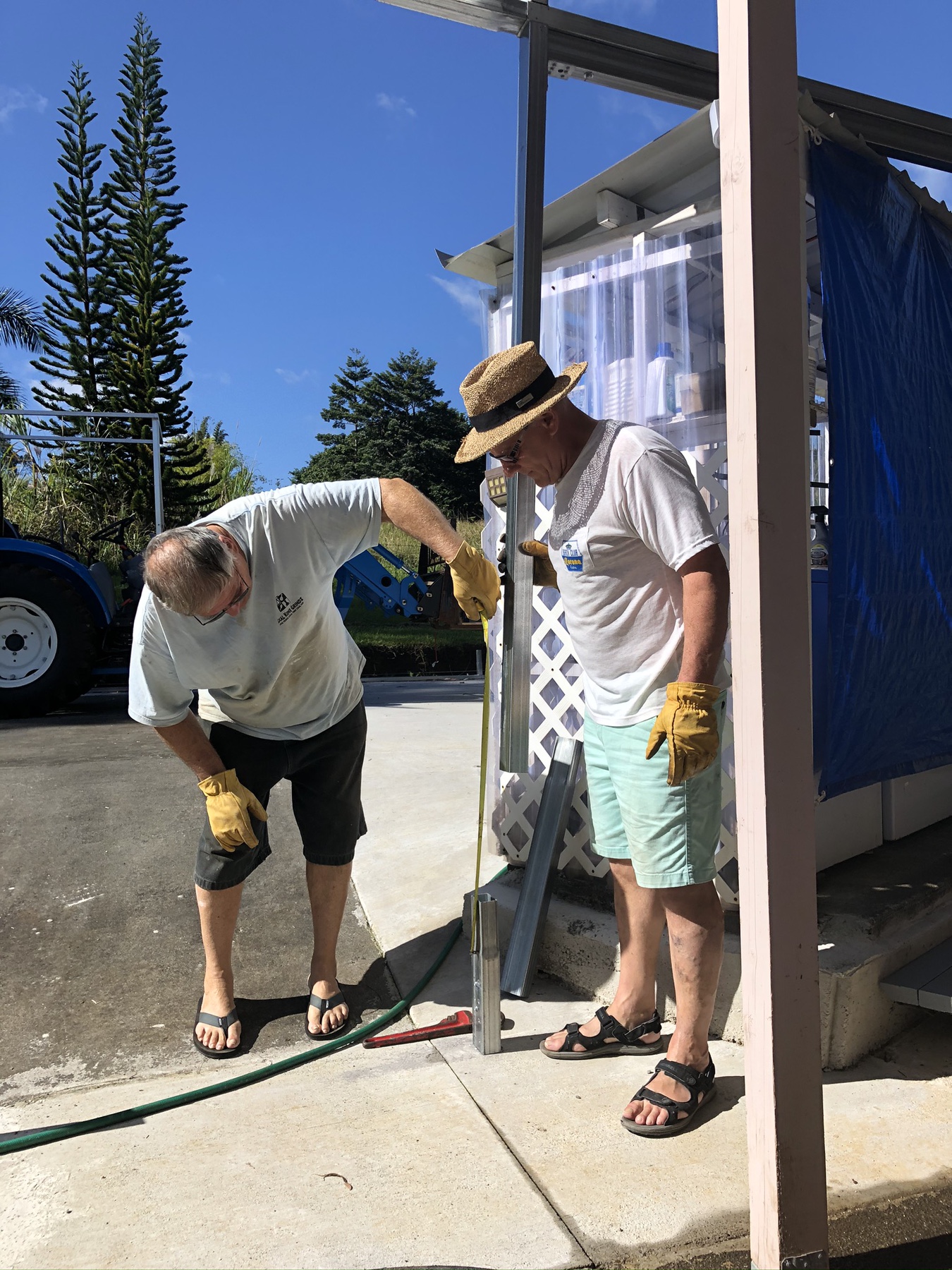

#164
Catchment plumbing basically done. All lines in and cemented.
Need a good rain or 2 to flush out debris etc before installing the filter. need to reinforce a couple of places and adjust the hangars.
This was designed to be a dry system, empties self of water between rains.
If any interest, I’ll share some details of the catchment later when I get better pics.
