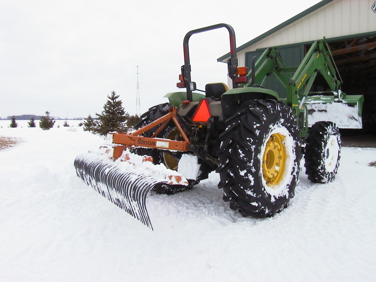

No backer material across the teeth. Somehow the snow vibrates? off the blades. Beats me but it works very well. You do not need a blade.
Of course chains will help and more tractor and more horsepower and more weight is always better. I use an 8 ft rake on a 75hp tractor and that combo works. That rake did not do well on a 40HP Kubota L4300.
I will say that a rake pulls easier than the same width blade. If the snow is too much just lift up some and make multiple passes. I have rarely put the rake teeth directly on the ground but keep a few inches off to keep the gravel there. Your rig should work after you figure out the details.
A sharp angle will or should work with the multiple-pass approach. And while I have not done this extra thing on this particular rake I have found a little Pam sprayed on a blade/rake makes the snow slide better. Not all times but some times.
On your plastic question...you don't need it but some farm places sell a slippery plastic that I have seen work well with snow on a blade. Remember I think a rake is better anyway.

This is my snowplow that goes with the above post. I forgot to attach. Keep us posted and welcome to the board.

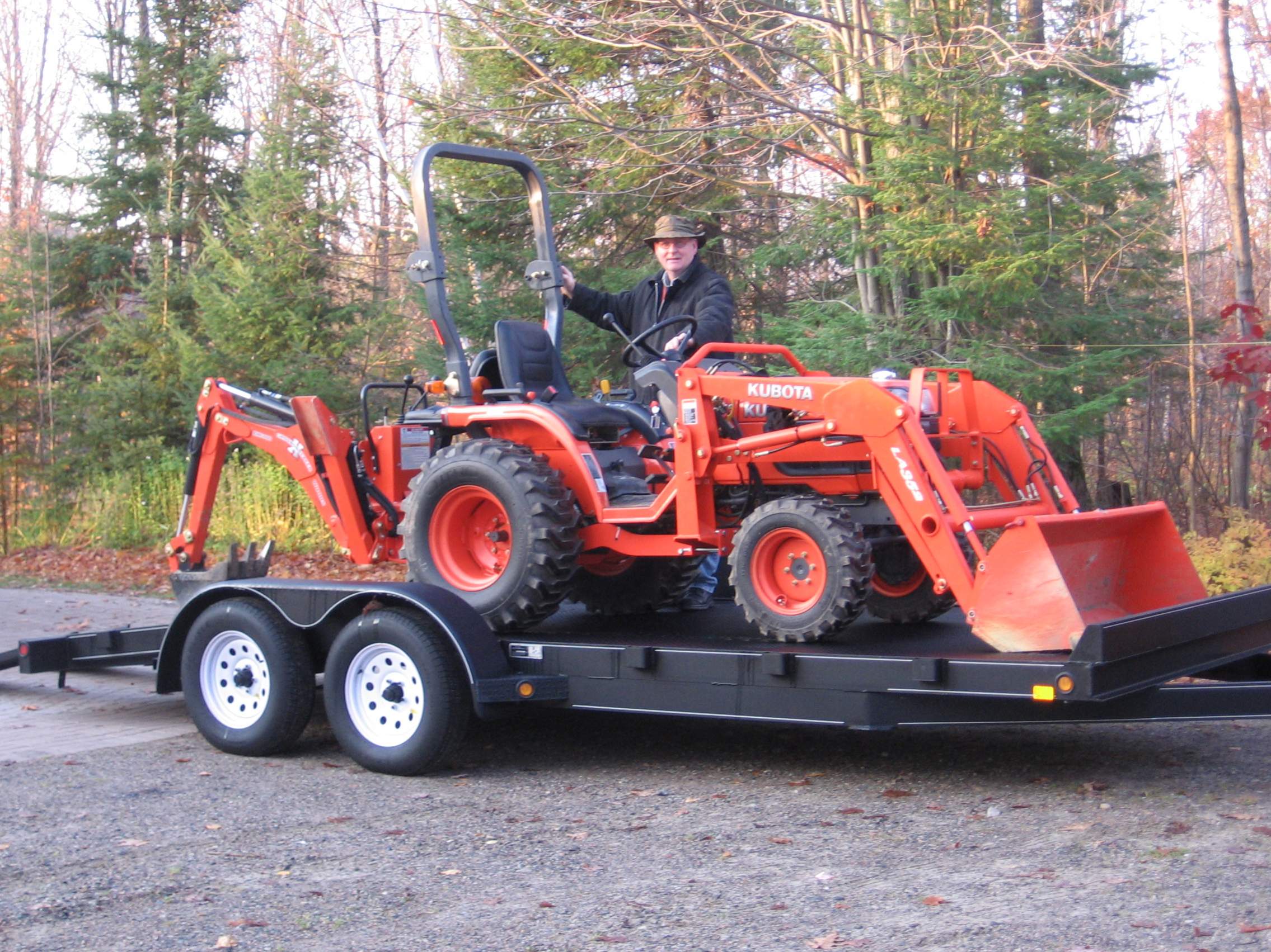

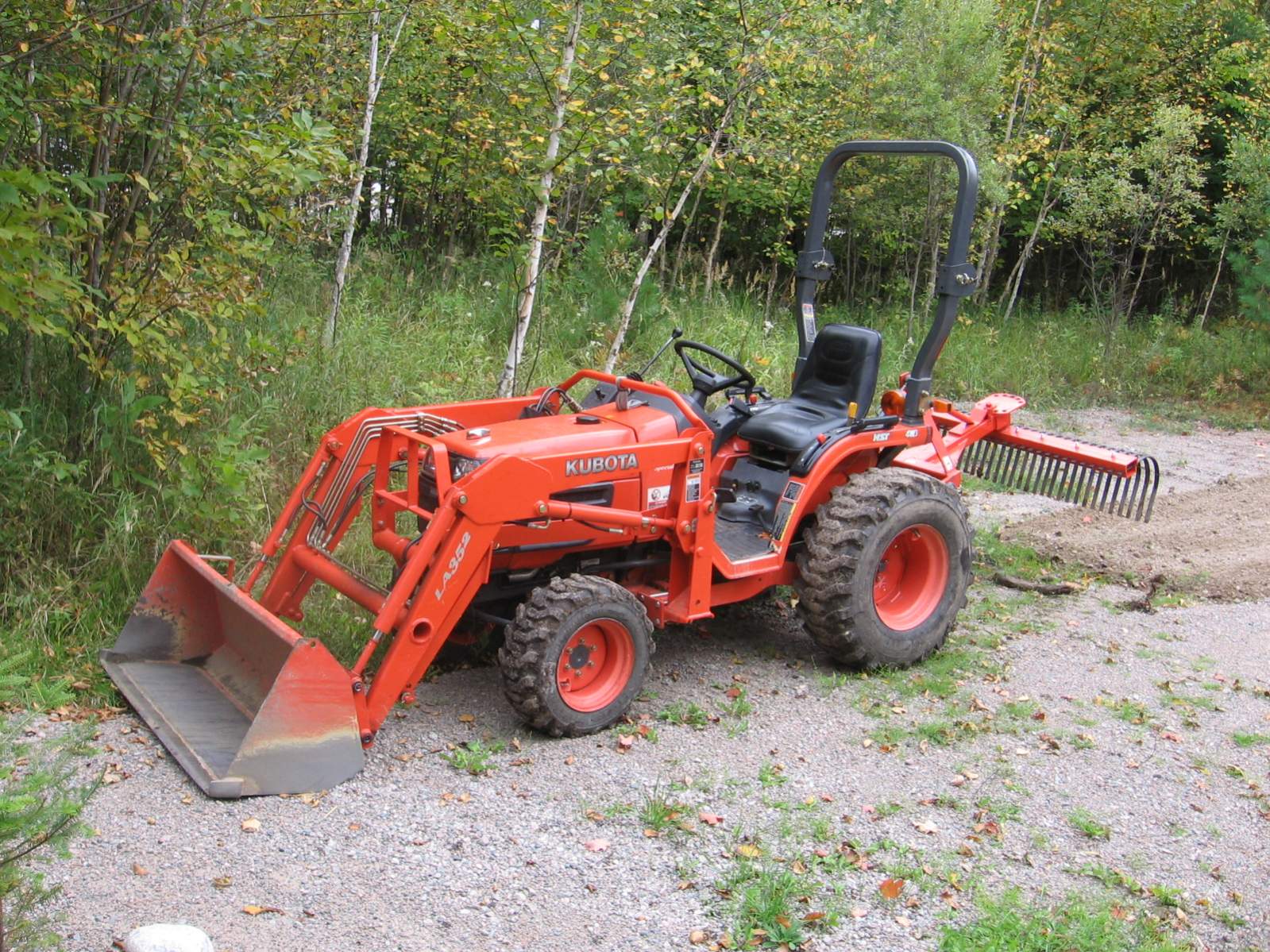

Sixdogs,I hope I mean I know this preview will work. Did the preview...wow I'm mov'in inta the high tech. arena now. These are shots of B7510 Bota wait'n for it to snow. Happy New Year :)

Sixdogs,your jd runs without chains. I enlarged the photo. I can see why no chains required. Your one tire weighs about what my whole outfit weighs. Have you ever used chains? Can I make my own or convert truck chains or is it better to bye 'em. Would I need 'em front and rear (4*4).

Glad to finally see someone else using a rake for Snow...I was beginning to wonder just how much an oddball I am:eek:
I find of all the other methods I have tried (Front blade, Rear Blade, FEL only, box Blade) it works the best for my 1500' gravel drive. The only tool I found that will leave much of the gravel in place.
I put my FEL in float raise the edge about 2 inches and float the rake about 2 inches.. One time down and up and its done. Am using a heavy Tractor and it does make a big difference 6500LB+. But even my old much smaller tractor worked best with this setup.. Just took more trips
Must get a rake that is at least a foot wider than your tires as you loose allot on an angle.
