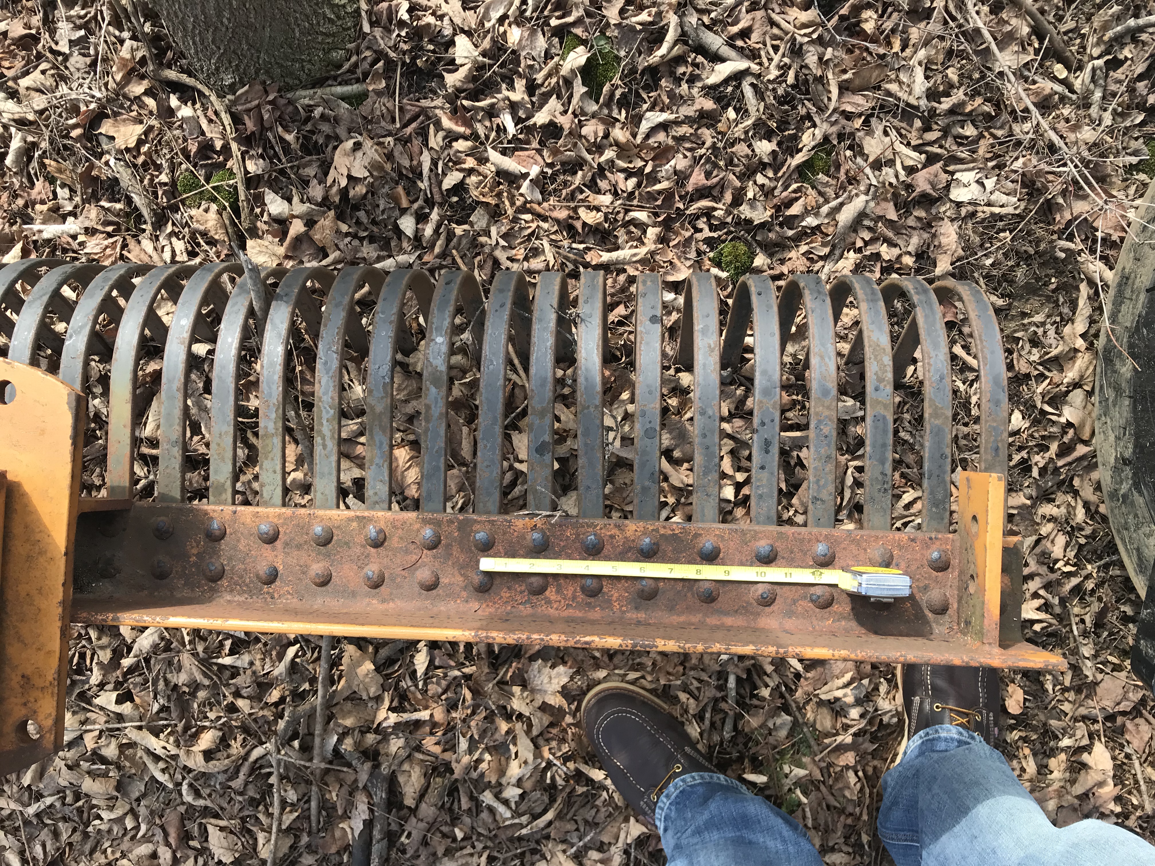

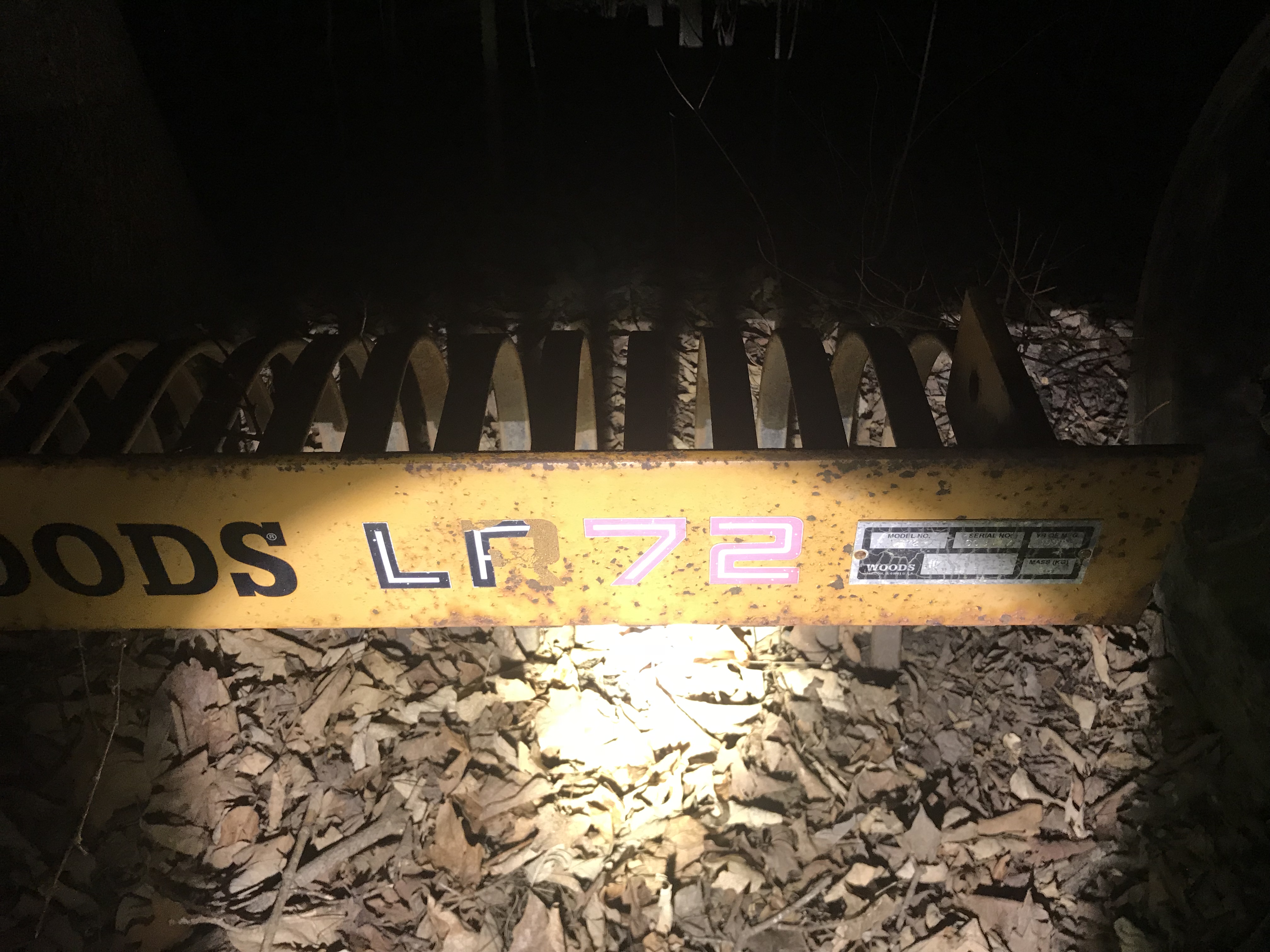

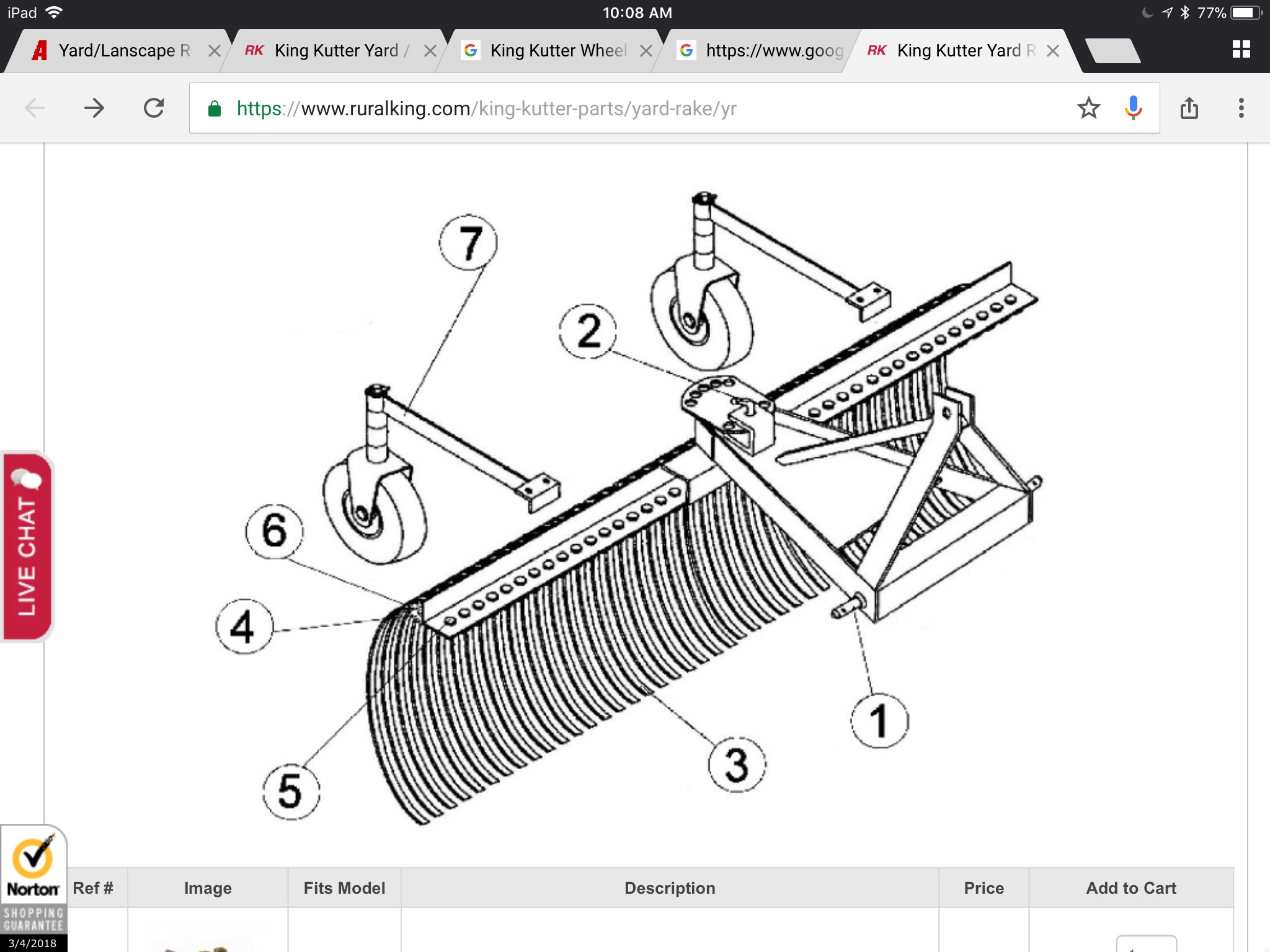

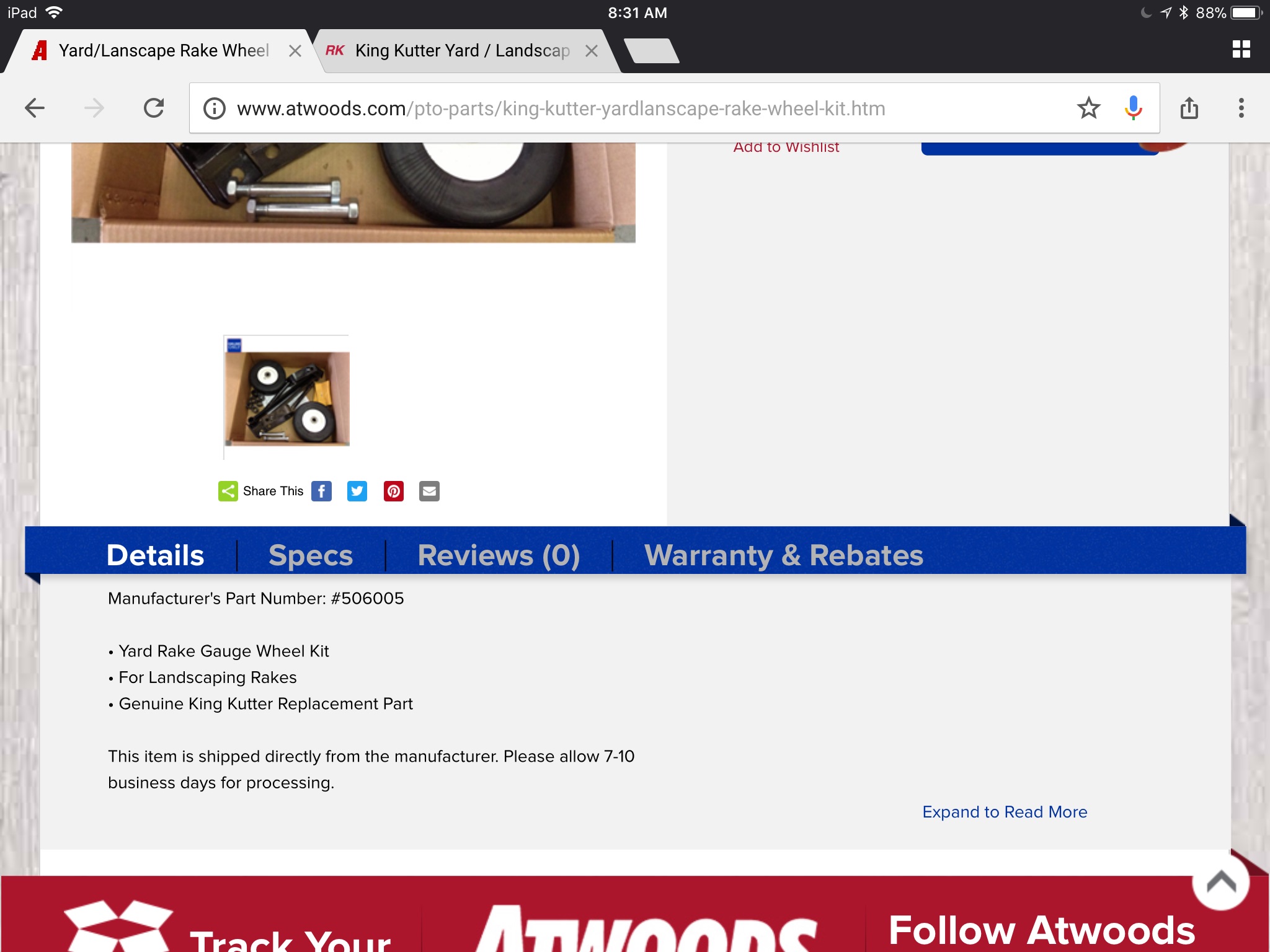

Hi guys, old thread.... Anyway looking for a set of gauge wheels for my Woods rake. Wondering which would be easier to modify for it? Tatar or King Kutter wheel kits anybody done this?

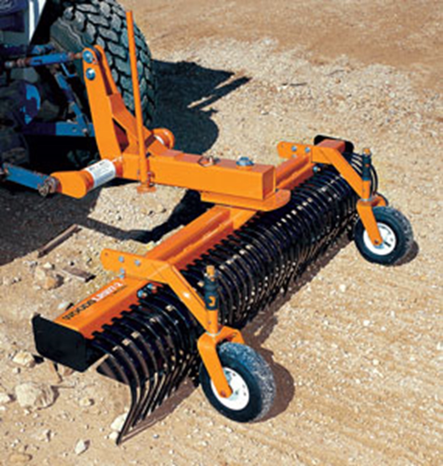

At some point, Woods changed their rake design so trying to modify the newer gauge wheel style to fit your older rake would probably be difficult.

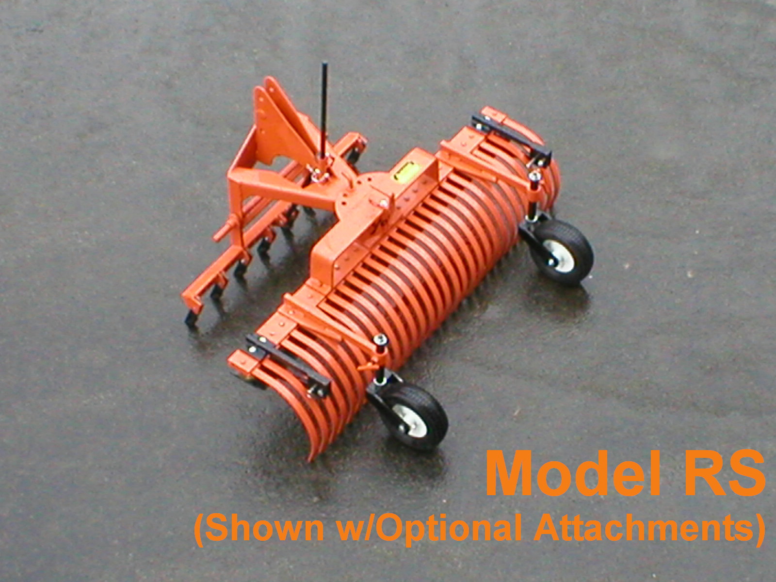

The design of the York rake gauge wheels might be easier to modify.
It's difficult to tell from the pic what the bolt hole spacing is on the mounting plate but with any luck, it would match the 2" spacing on your Woods. If so, you could knock out 2 tine rivets on each side and use bolts to mount the wheel brackets in the existing holes.
The down side is the cost. Replacement York wheels will cost far more than the King Cutter.
