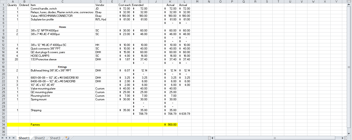

Here's a spread sheet of the parts required to install a true third function.
I just installed this on my L4240 for grapple control.
All of the mounting plates I custom made. I'll be doing a write up on the installation soon.
I tried to order this installed at the dealer but the factory kit was on back order for months.
The dealer was going to charge $900 installed. The Kubota kit is a really nice kit.
My installation cost for parts only was over $600.00
After you add my labor and fabrication my true cost is over a $1000.00.
