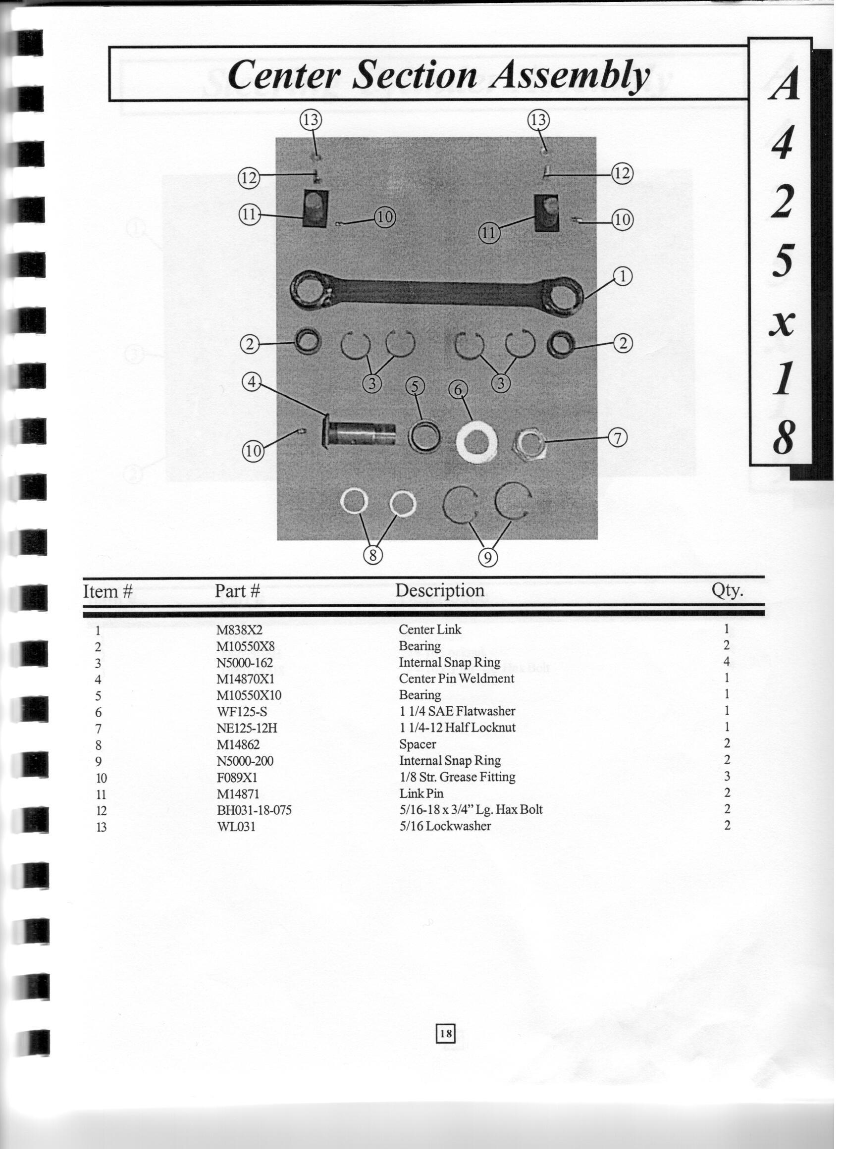

what is the correct wrench size for the pivot point nut (jesus nut) on the 425 series pt? normally I use a large crescent wrench for this nut , but after adding a couple of divots to my hand this past weekend it is time to invest in the proper/correct wrench

Page 18 of my 2010 PT425 parts manual is attached below. The nut may be item 7: 1 1/4-12 half locknut. Hope this helps.

1 and 13/16 maybe?
++1 for a 2005 PT-422. Just went outside and checked the wrench and the nut,.
Still tight. :)
Remember, wrench size and bolt sizes are different. Quick google shows that the standard wrench size for a 1-1/4" bolt is 1-7/8". But 1-13/16" fits mine quite well.

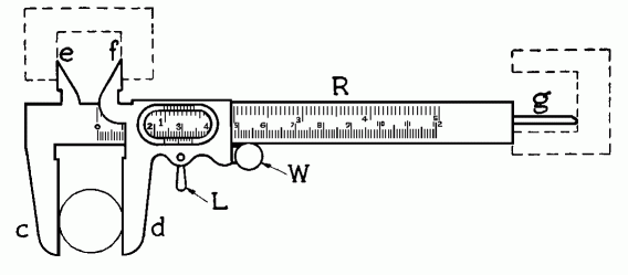

If you don't have one of these vernier1.gif, you can use the crescent wrench to find the size. Put it tightly on the nut, then measure the opening with a ruler..
