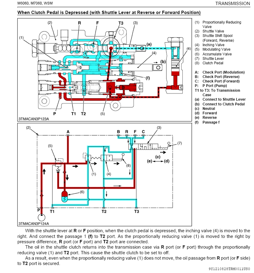

If it's a column mounted hydraulic shuttle you have no clutch at all. Your 'inching is accomplished by the loose and not clamped hydraulic pack only. Kubota has not installed a dry clutch in the bell housing for years know, They understand the principle quite well and negate a dry clutch 100%. All that is inside the bell housing is a spring loaded damper plate (to keep any shock load off the crank flange) and the input shaft for the main box. The damper plate looks like a dry clutch plate but no drive plate at all.
No clutch disc, no pressure plate no intermediate shaft, no nothing but the gearbox seal and the crankshaft seal and no wobbling that comes with a worn friction disk and the resultant seal failures from excessive run out and vibration.
Excellent information, thanks very much. I thought I was directly engaging/disengaging clutch packs when I depress the clutch, but actually I'm simply activating or deactivating the hydraulic clutch controlled by the shuttle. That's cool. I knew that there weren't dry clutch discs inside the transmission but I figured it was like a wet clutch pack that are common on motorcycles. Either way, that "feathering" I'm doing with the clutch pedal is simply modulating the position of the proportionally reducing valve ... is that right?

L6060 with hydrostatic trans doesn't have a dry clutch it has a fixed drive plate.
   / Correct use of shuttle shifter #39
Thats the hydrostat .
We are talking about the gear models here
So you're referring to gear type trans BUT this thread was initiated concerning hydraulic operated reverser which doesn't have a dry clutch designed to be engaged/disengaged. One link you posted also pertained to tractors with hydrostatic trans.
