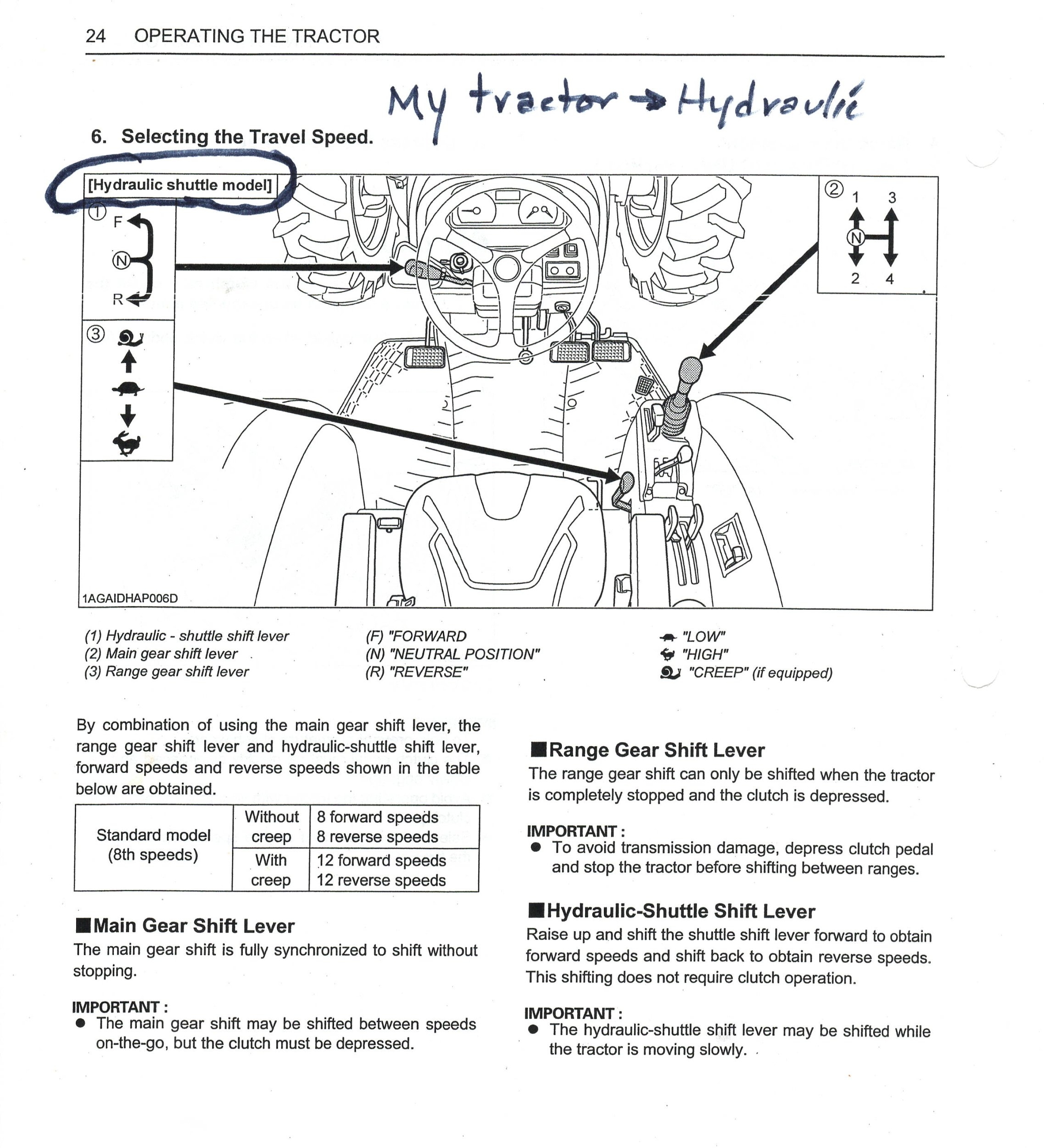

this discussion depends on what tractor manufacturer is in question. my only experience is with hyd shuttle on Kubota Utility 8540. i always come to full stop (or slow coast) before changing direction with shuttle with out using clutch pedal
the actuater valve within the wet clutch pack (as mentioned previously) does the rest

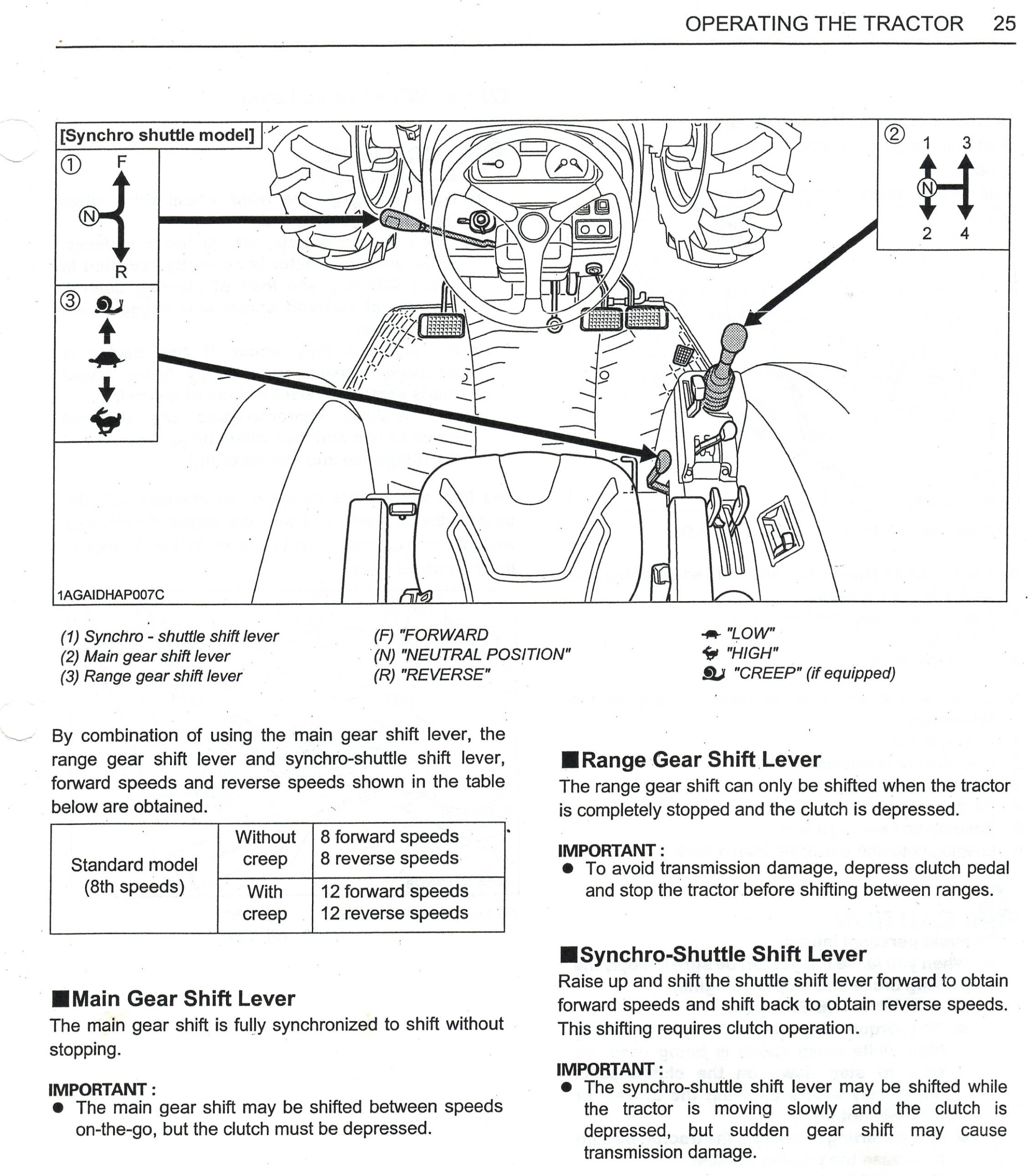

far superior to single dry clutch plate commonly called "shuttle shift" requiring clutch pedal depression when changing direction

Some modulate the motion reversal better than others, just fortunate my Kubota's modulate the pack lock up well and I suspect the spring loaded damper plate in the bell housing contributes to that as well. I never want a dry clutch as at some point they all need to be replaced and that entails a split and time and money. My 'clutch' pedal acts on the hydraulic valve that modulates the internal wet clutch pack in the main transmission case.
Clutching it basically locks the pack in the released position and even then, when released, the valve modulates the lock up pressure so no 'jerking' unless it senses a heavy load on the pto and then it's sort of abrupt. Not sure if you are aware but you can adjust the lock up pressure and the rate of lockup (least on my Kubota's you can but you need a workshop manual for those specs). Least on mine you do as the manual tells you how to and the required minimum and maximum pressure specs and on mine, it takes a special double end fitting to access the pressure port on the valve itself and I have access to it through my dealer plus I have access to the workshop manual and can bring it home if need be. I consider myself lucky to have a dealer like that. I can even use their scan tools and special tools if I want to but then working part time there does have it's advantages. The pay isn't great but the 'ancillary' benefits cannot be beat and I buy my implements and have bought my tractors at dealer cost in the past. I pick up and deliver his tractors with his single axle diesel roll back truck when needed or my tandem axle 28 foot Gooseneck trailer and work in the shop doing the grunt stuff when they are really busy which is more than I want to work anyway. Being 74 and gainfully retired and owning my own shop and having 2 full time employees is quite enough for this old man. I mostly do it as a favor and I get treated like family there anyway. He's a big volume dealer too. His back lot is always loaded with new and used Kubota and Case units and he sells Cub Cadet professional series lawn equipment and Echo chain saws as well and they work on Case and IH combines a lot. His lead tech has a reputation locally for quality one time fix work so he's always booked up and I won't let anyone but Dennis (lead tech) work on my Kubota's either. If he's busy. I wait, no problem and if it's something urgent, I can borrow a tractor from him if I need one and I let my repair sit in his yard until he can do it. BTW, I pick up and deliver to him, my tractors with his truck and they deliver parts to the farm, no charge. I have a fantastic relationship with them, you don't find that sort of thing just anywhere. Been dealing with him for over 30 years now. I know everyone that works there personally as well as the owner and his family.

Depressing foot pedal on M7040 with hyd shuttle only opens a hyd valve. Loading/unloading rd bales with my M7040 hyd shuttle I utilize foot accelerator pedal so engine lowers to idle speed when changing directions without depressing clutch pedal. Only utilize clutch pedal for changing standard gear box & hi-lo gears
I have to feather the clutch when backing up to a trailer or implement, putting the loader back on or swapping out loader attachments. I use the accelerator pedal and manual clutch just like a car/truck when I need fine control of the position of the tractor. I also reduce rpm to a minimum before moving the hydraulic shuttle, and wait for the tractor to slow down to a crawl or complete stop before changing directions.

If it's a column mounted hydraulic shuttle you have no clutch at all. Your 'inching is accomplished by the loose and not clamped hydraulic pack only. Kubota has not installed a dry clutch in the bell housing for years know, They understand the principle quite well and negate a dry clutch 100%. All that is inside the bell housing is a spring loaded damper plate (to keep any shock load off the crank flange) and the input shaft for the main box. The damper plate looks like a dry clutch plate but no drive plate at all.
Don't know about other makes but that is how Kubota does it. I would presume the other makes follow suit but again, I don't know as all I own are large frame Kubota's. No clutch disc, no pressure plate no intermediate shaft, no nothing but the gearbox seal and the crankshaft seal and no wobbling that comes with a worn friction disk and the resultant seal failures from excessive run out and vibration.
