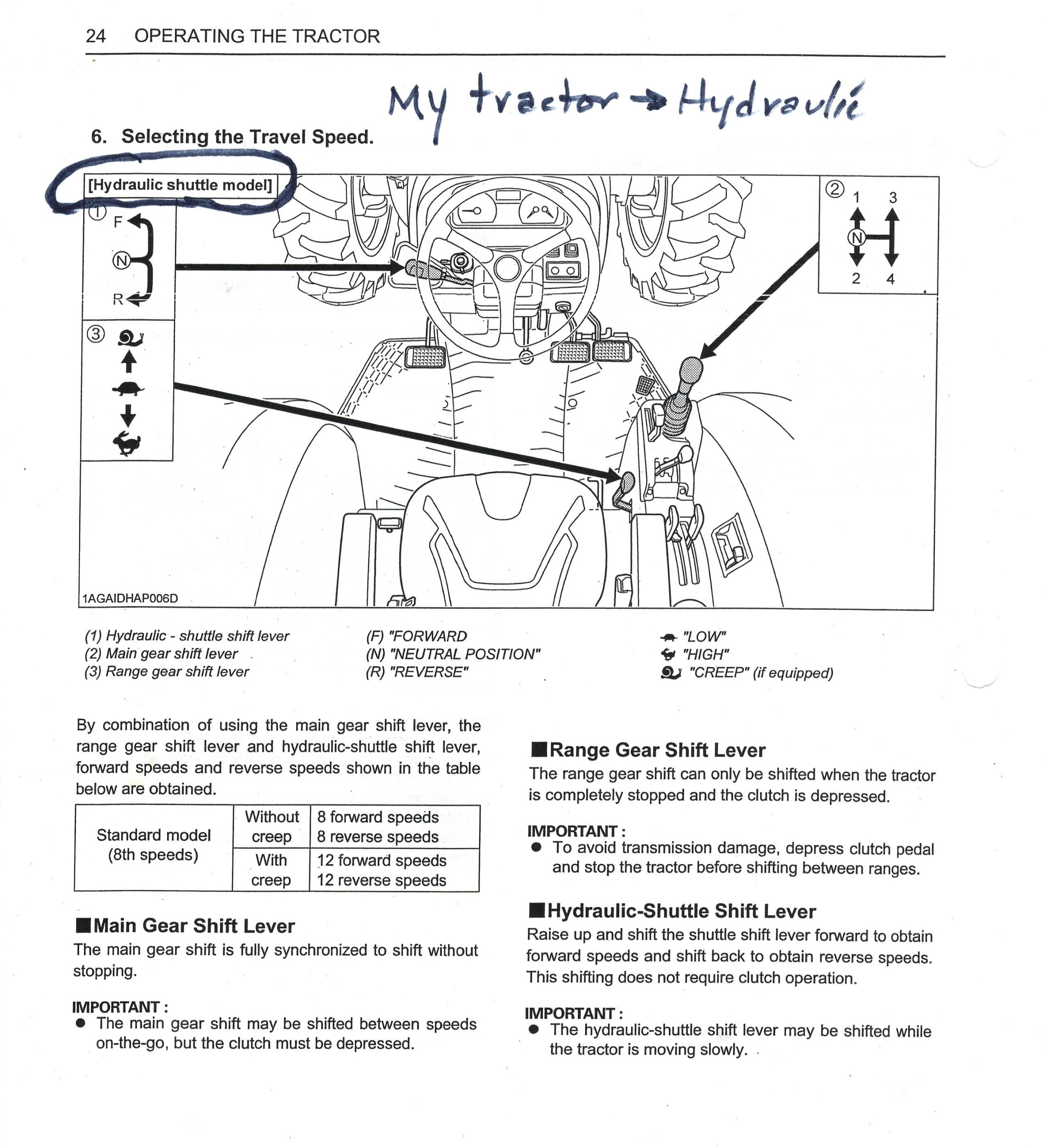

this discussion depends on what tractor manufacturer is in question. my only experience is with hyd shuttle on Kubota Utility 8540. i always come to full stop (or slow coast) before changing direction with shuttle with out using clutch pedal
the actuater valve within the wet clutch pack (as mentioned previously) does the rest
far superior to single dry clutch plate commonly called "shuttle shift" requiring clutch pedal depression when changing direction

Depressing foot pedal on M7040 with hyd shuttle only opens a hyd valve. Loading/unloading rd bales with my M7040 hyd shuttle I utilize foot accelerator pedal so engine lowers to idle speed when changing directions without depressing clutch pedal. Only utilize clutch pedal for changing standard gear box & hi-lo gears
I have to feather the clutch when backing up to a trailer or implement, putting the loader back on or swapping out loader attachments. I use the accelerator pedal and manual clutch just like a car/truck when I need fine control of the position of the tractor. I also reduce rpm to a minimum before moving the hydraulic shuttle, and wait for the tractor to slow down to a crawl or complete stop before changing directions.

If it's a column mounted hydraulic shuttle you have no clutch at all. Your 'inching is accomplished by the loose and not clamped hydraulic pack only. Kubota has not installed a dry clutch in the bell housing for years know, They understand the principle quite well and negate a dry clutch 100%. All that is inside the bell housing is a spring loaded damper plate (to keep any shock load off the crank flange) and the input shaft for the main box. The damper plate looks like a dry clutch plate but no drive plate at all.
Don't know about other makes but that is how Kubota does it. I would presume the other makes follow suit but again, I don't know as all I own are large frame Kubota's. No clutch disc, no pressure plate no intermediate shaft, no nothing but the gearbox seal and the crankshaft seal and no wobbling that comes with a worn friction disk and the resultant seal failures from excessive run out and vibration.

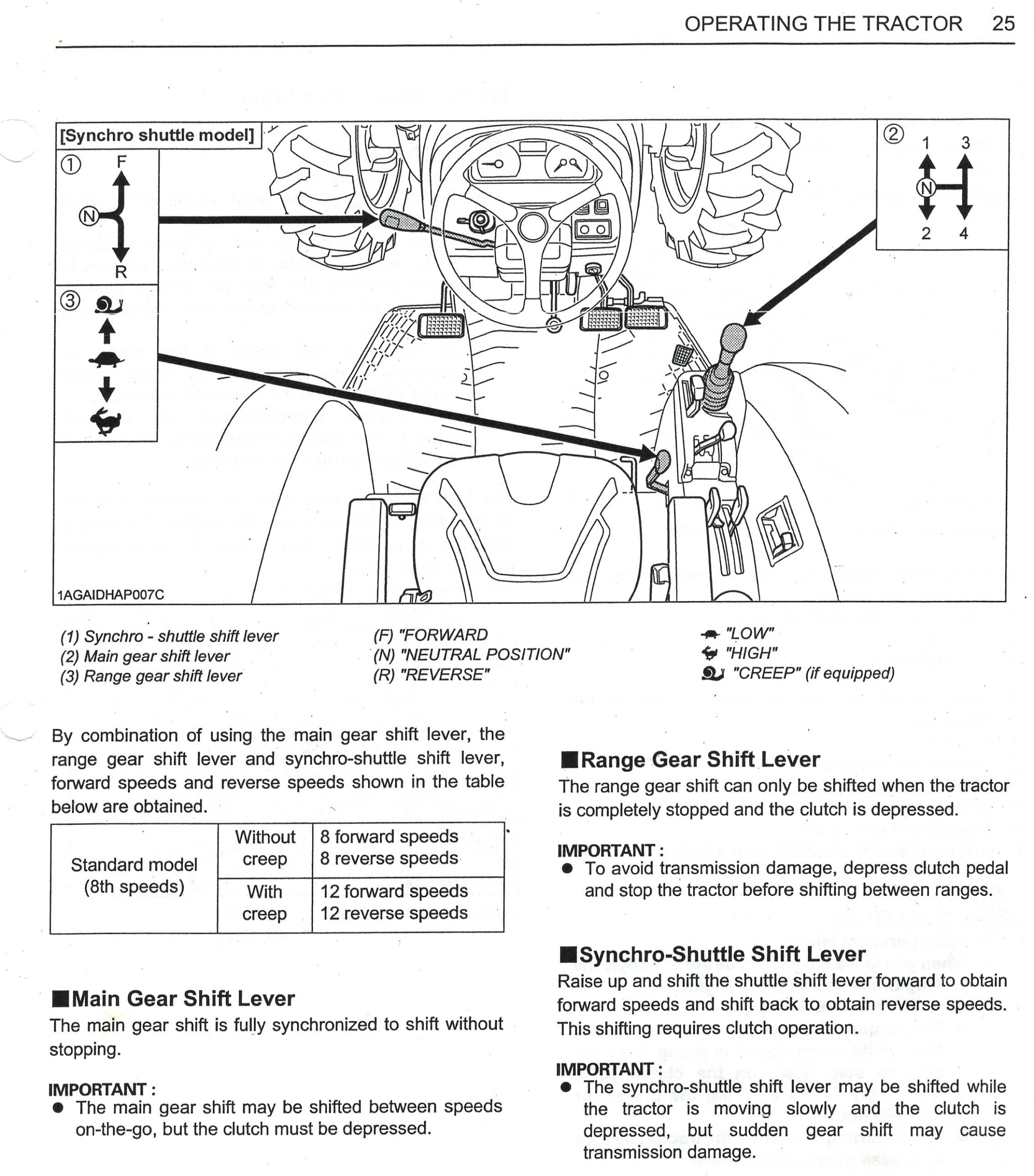

Excellent information, thanks very much. I thought I was directly engaging/disengaging clutch packs when I depress the clutch, but actually I'm simply activating or deactivating the hydraulic clutch controlled by the shuttle. That's cool. I knew that there weren't dry clutch discs inside the transmission but I figured it was like a wet clutch pack that are common on motorcycles. Either way, that "feathering" I'm doing with the clutch pedal is simply modulating the position of the proportionally reducing valve ... is that right?
   / Correct use of shuttle shifter #32
Yes they do and always have had models with dry clutch
The L series DT use dry clutch
Also dry clutch in the grand L shuttle

This thread was initiated concerning a M7040 which I also own that model with a cab. The hyd reverser clutch is located in the clutch housing in front of trans & can be repaired or replaced without R&R of the cab. I know for positive the manual reverser is located in clutch housing on an older M4900 could have reverser repaired with cab in place that I owned previous to the M7040.

The point I'm trying to make is Kubota has manual and shuttle transmissions models with dry clutch and hydraulic shuttle with wet clutch just like most other manufacturers offer.
You want a wet clutch where you can forward/reverse without clutching generally you have to purchase a hydraulic shuttle, power reverser/ glide shift model or similar to get that feature
