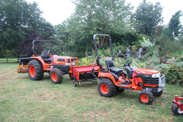

Do you have any closer images of your front dethatcher c-and-a? That is exactly the kind of dethatcher I'm looking for. I already have a trailer rake but I would prefer to have an "out front" unit... I have a box of 6in spring mounted tines out in my workshop and I had planned on making a simple frame on the front of my machine, but I really like the look of yours...
/ Core Aerator #24
Best bet is to look at these pics - I can answer any questions you may have.
This unit is from JRCo..and the aerator is from Leinbach...
I did have to drill a few holes in the brackets to mount it - but JRCo had plans to support the BX series - not sure if they made the mods yet...
Jrco Inc. - Heavy-duty Attachments for Commercial Mowers
To the previous post - you bet, not turns with the aerator or it becomes a messy sod cutter... :)
Let's just say, my hand never leaves the 3pt lever when running the aerator.
Thanks for the info and the link c-and-a. Wow, that is one strong dethatcher. I'm even more impressed now! The website has a lot of good quality close ups.

I have been very happy with my Turf-Aire core aerator. I purchased the tow behind with hydraulic lift so you can maneuver corners and make tight turns without lifting the 3PTH.
There is a big difference between a quality core aerator and the cheaper, lightweight units. This unit will pull 3-4 inch cores consistently in the Spring and Fall turf.
When loaded with additional ballast weight, it will put a big load on the BX23 to get it started, but then runs effortlessly.
I ran hydraulic lines to the front loader valve and use the joystick to operate the hydraulic lift. Very simple and easy to use.
I have not had any problems or repairs with the unit. It is a bit expensive, but you get quality and an extremely well built unit that will last forever.
I intended to purchase the unit for my own property, but it turns out that people drive by and ask about it. I have done enough "side" jobs to pay for the unit already.
