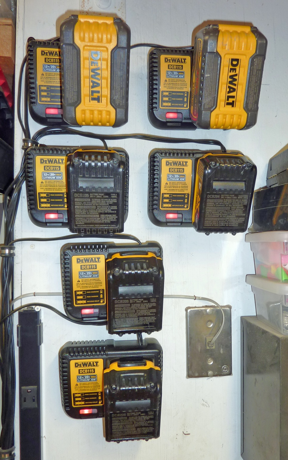

I've now converted 95% of my power tools to cordless. I have 6 wall mounted chargers which I keep on a timer. Whenever I've finished with one, I stick in a charger and turn on the timer for an hour or so. That way, I always have a bank of 6, fully charged at all times.

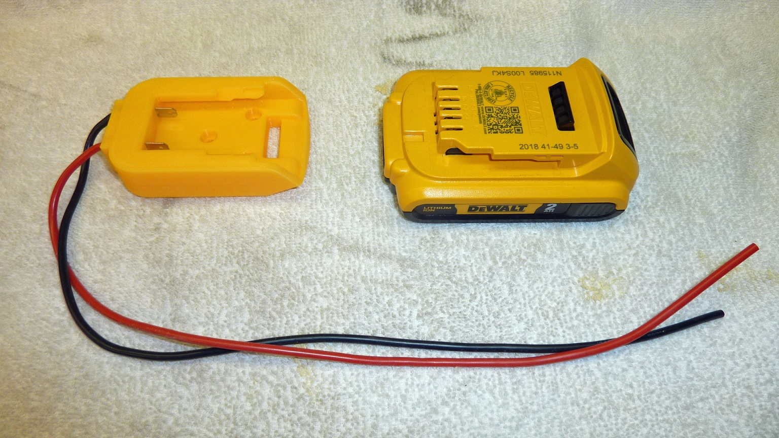

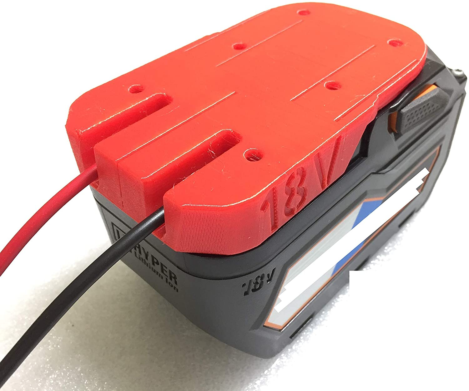

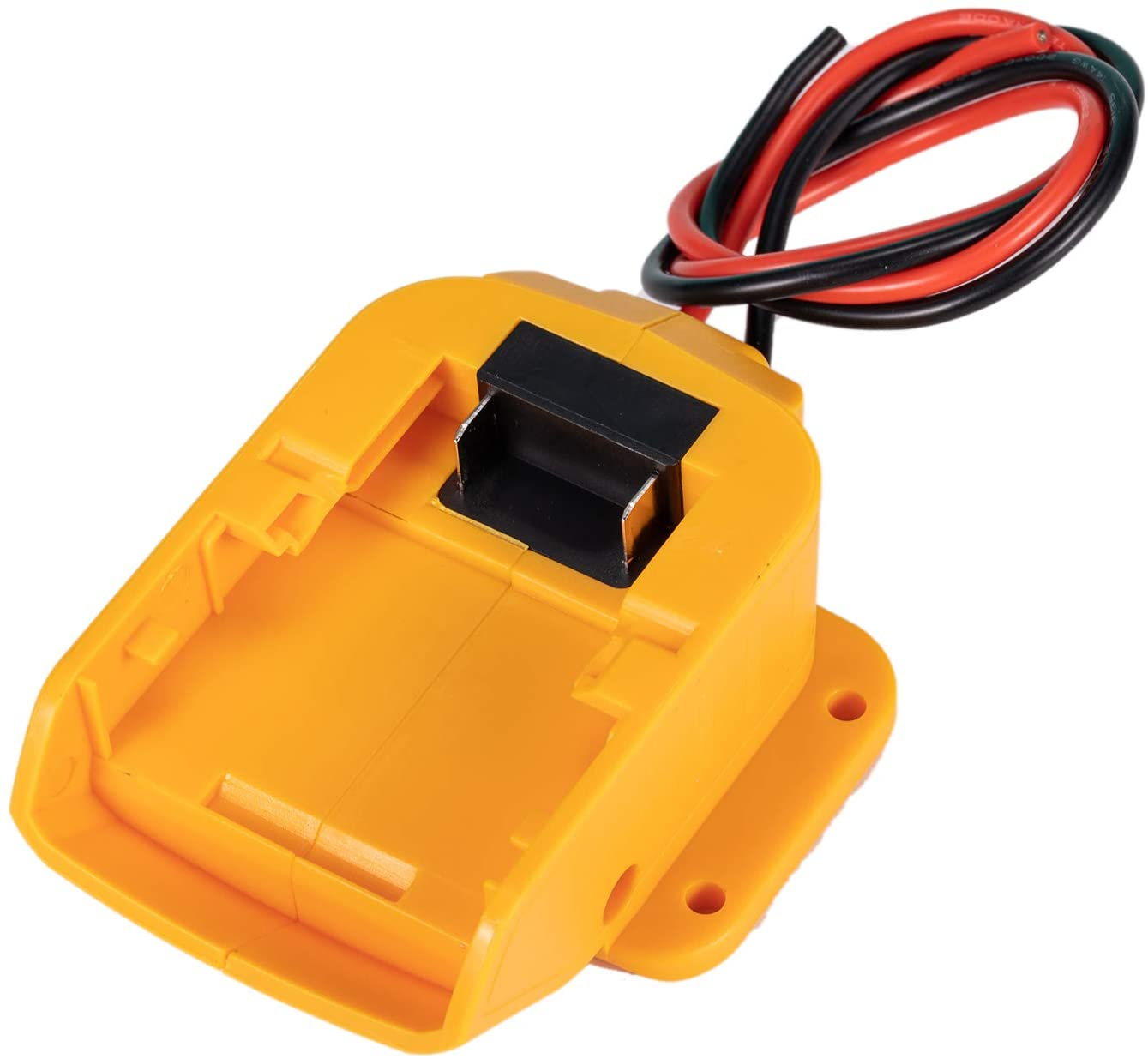

These power tool batteries can also be used for a variety of purposes. Using these adapters, you can even make your own tools:

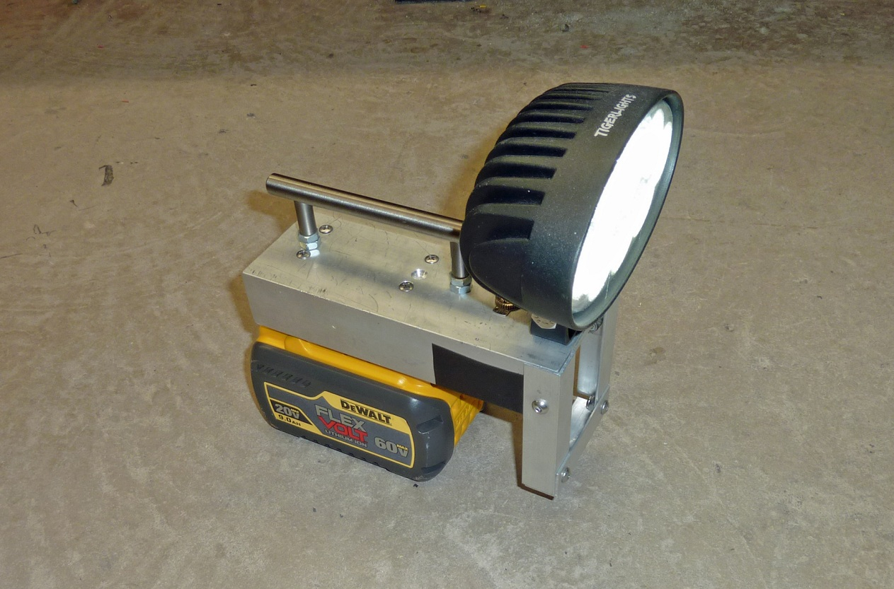

No need to buy a portable floodlight when you can make one from some aluminum channel, a drawer handle and an old tractor work light. The possible uses for these tool batteries are almost endless, especially in situations where extension cords aren't practical.

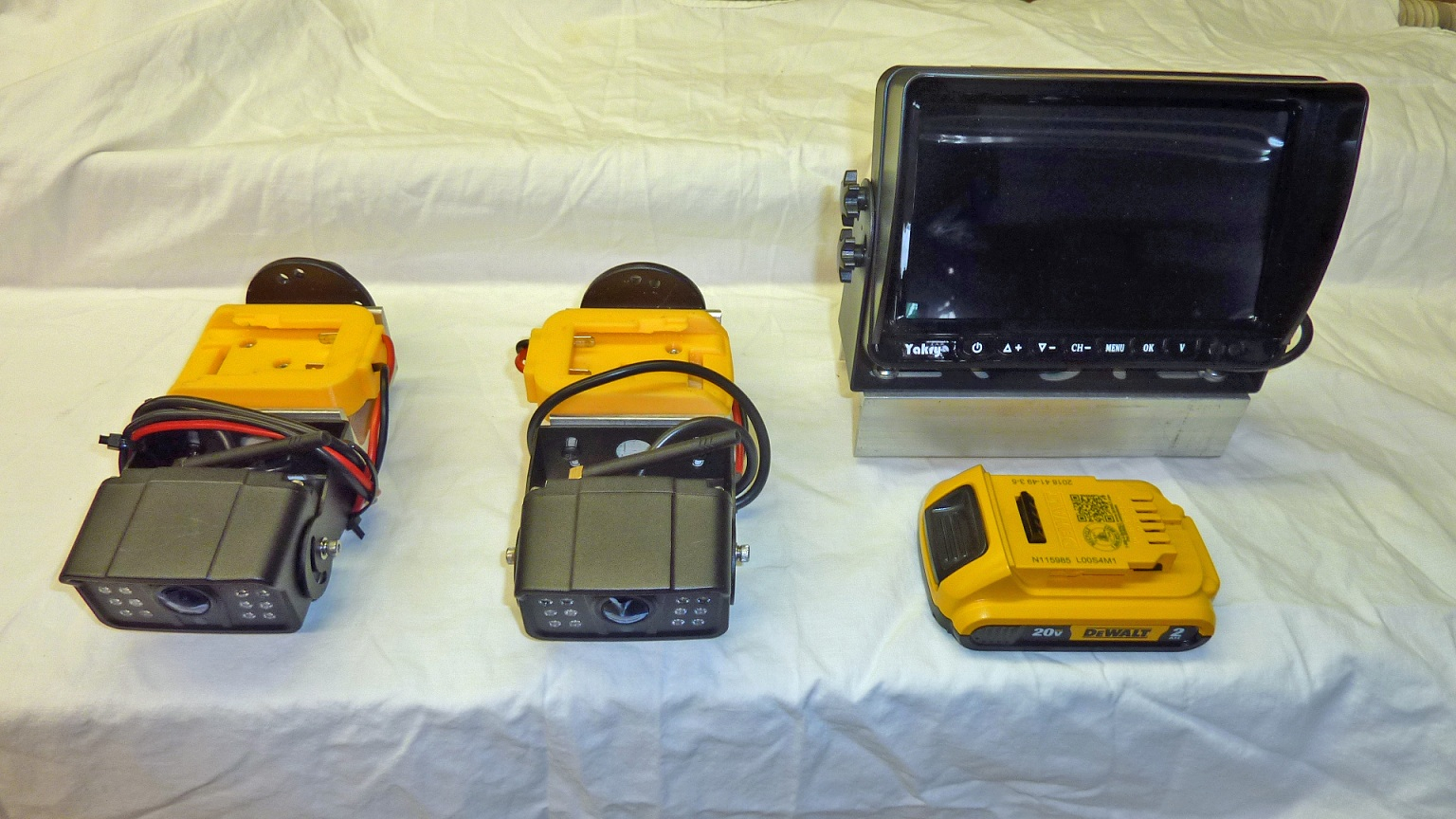

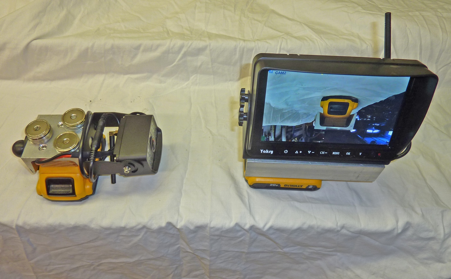

I use them to power portable tractor cameras and even the display. They can be placed almost anywhere without any wiring:
View attachment 717618 View attachment 717619 View attachment 717622
View attachment 717621 View attachment 717620

I like what I see :) is it possible to build a LED Spot light using a M18 Milwaukee battery? I would love a portable one with a magnet on the mount so I can transfer it from the 4 wheeler to the Tractor ROPS
/ Cordless Tools vs. Other Options #32
Many LED lights have a working range of 12-24V so shouldn't be a problem. Just make sure the light you are considering has the right voltage range.
This one is 9-36V
