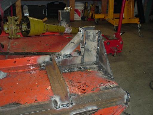

Update. The new and improved hog is all done and tested except for paint. I have three cans of chevy orange engine enamel for the job.
Here is the finished lower 3ph attachment point. I used the 7$ bimetal hole saw on the end of a hand drill to drill 4 of these holes. They aren't perfectly aligned but they don't need to be. The 15/16" hole saw left a 1" hole since it isn't exactly a precision instrument.
This picture also shows the lower attacment point of the top link structure. Note that I had to assure clearance for the cotter.

So here is the weak factory part showing how it bent. The channel is 4" so that's how much shorter my TL needed to be to be able to lift the hogs butt.
I needed to use the bent pieces to measure and lay out the replacement.

It wasn't easy. There are a few critical measurements and the setup took me way longer than I thought it would. I chopped off the old TL attachment point but made everything else from scratch.

Here it is getting test fit and finishing welds. The galvanized bars are 1.25" diameter G8 bolts that are used for luminaires. The TL structure can be much weaker in my revised design hog. I didn't get it totally straight but I was going freehand and alignment isn't critical here either.

It worked.
I noticed a little more slop in the hog since it is now freer to move side to side a bit on the pins. The PTO shaft has u-joints so I can't see that being a problem. I mowed my entire wetland and grass area in about 4 hours before the rains came. The mower is now resting in the container onsite. Plan is to go out there tomorrow to box blade some of the lowland and then paint the mower.
