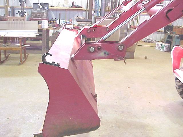

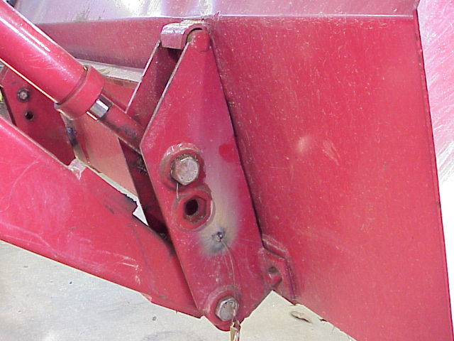

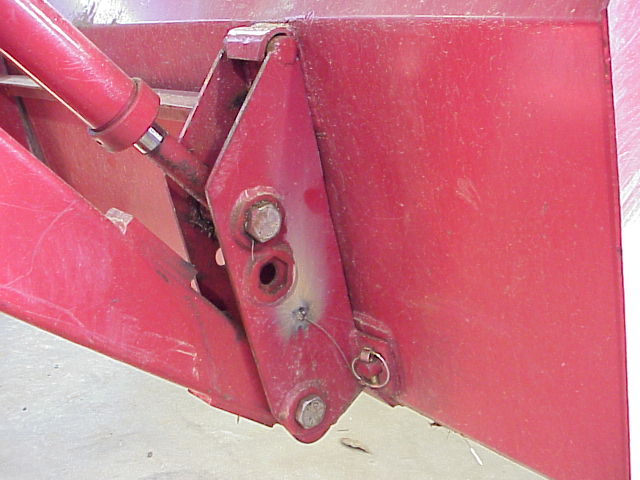

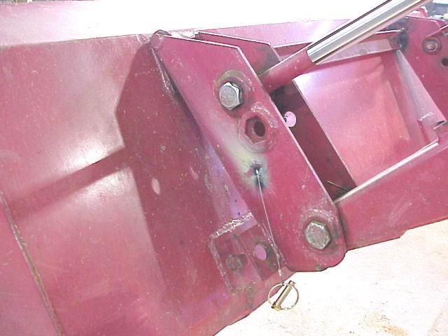

Thanks mucho for the additional photos. You've given us some great ideas for the winter. Too bad I don't know how to weld... /forums/images/graemlins/shocked.gif However I've got a welding shop nearby that is reasonable and does good work as long as I can give them a picture or a drawing. BTW - Your trusty companion looks like a good protector as well!
/ Converting J.D. 70 loader to Quick Attach? #34
I don't know if there is anyone else that has a QA like my MF one or not, but it just uses the same pins that came on the bucket to latch to. You just unpin the bucket, pin the adapter on the loader and then it hooks to the bucket allot like this custom one. The main difference is that you don't have to do any cutting on the bucket and you still latch on the pins instead of welding on the bucket. Clear as mud.
BTW I think my dealer said it was just $100! /forums/images/graemlins/smile.gif
/ Converting J.D. 70 loader to Quick Attach? #35
A quick attach like you described is easier to install but moves the bucket out further which reduces the breakout force and lift capacity. The QA method he used doesn't reduce breakout or lifting capacity. This is very important if you have a smaller tractor that already has a limited lifting capacity.
