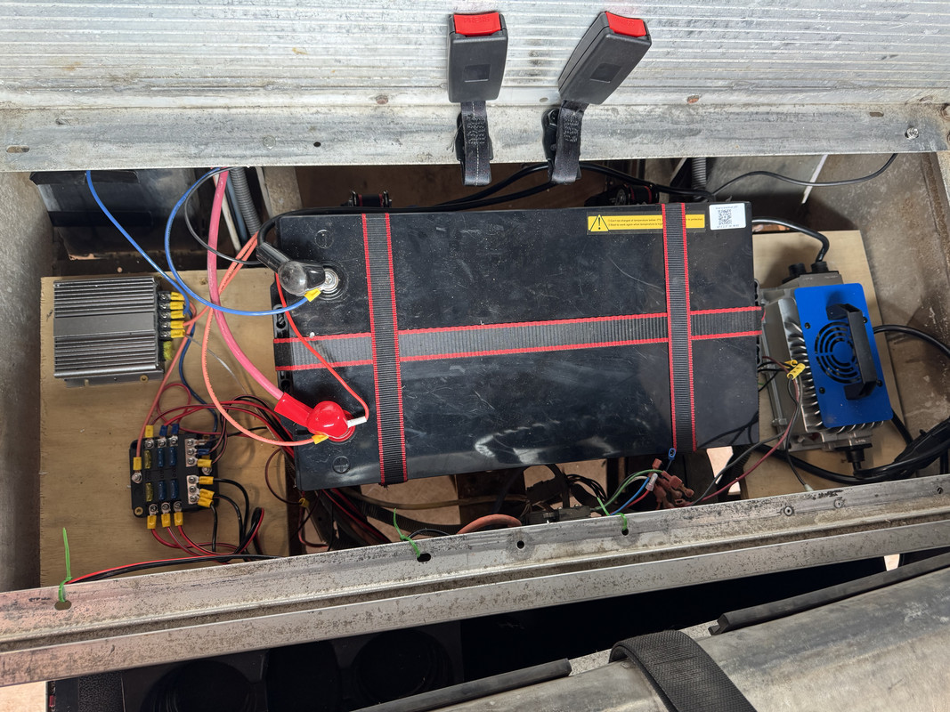

Greetings,
We would like to share how we converted a HiSun Sector E1 UTV to Lithium from the stock Lead Acid batteries. The batteries now have 16.4 kWh (315 AH) of capacity, 22 horsepower peak, and it reduced the weight of the unit by 360 lbs. We were able to use the same onboard charger but did upload a lithium profile to it. We also needed to add custom battery trays. The conversion process is explained below in this video:
Thank you.

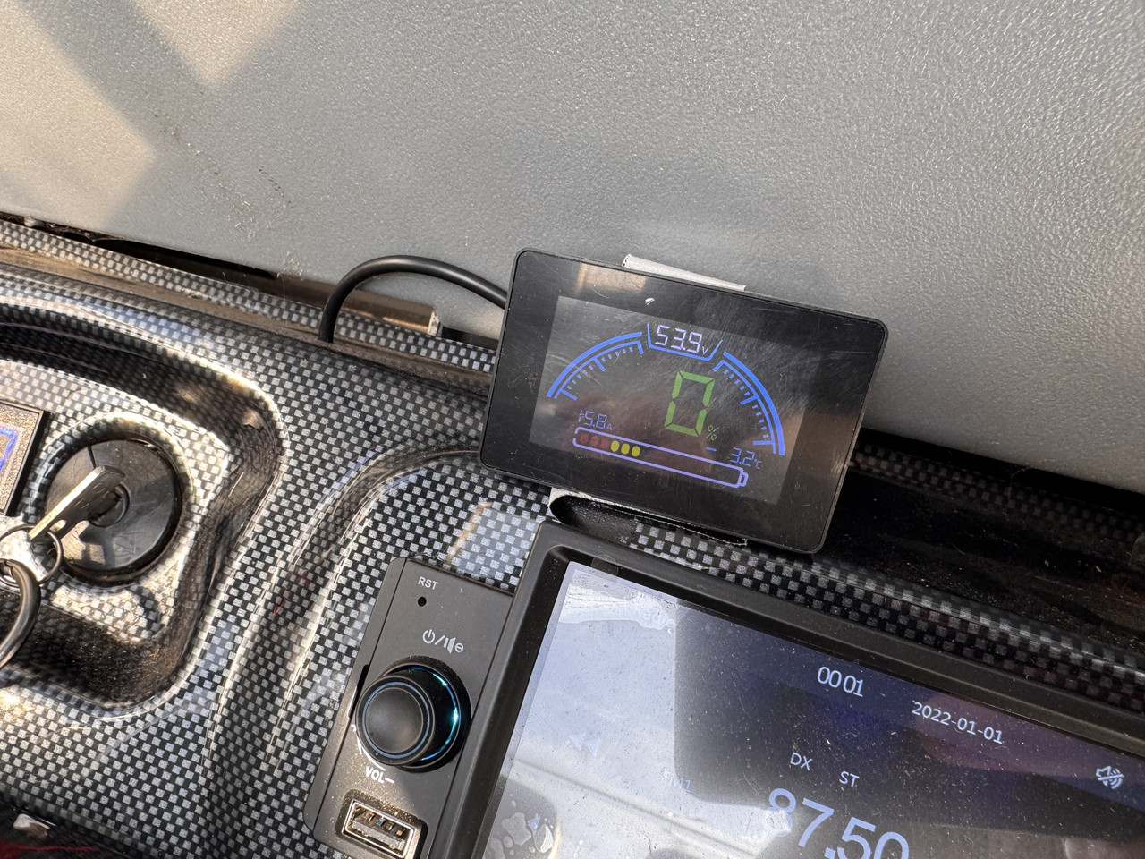

I converted my club car to lithium. It's been great, other htan last week. Lithium, specifically LiFePO4, or LFP, doesn't do well below freezing. To the point that the BMS, or battery management system will just shut the battery down in order to protect itself from damage.
Yes this is very important, so if using our batteries you can set them to maintain temperature, even when they are not charging, we call this standby heating. In cold discharging suffers as well so using some power to keep it above freezing is a fair trade off (45 mins, 31 seconds).
See this time stamped location of the vid:
www.youtube.com/watch?v=Em2sh-kYeQE&t=2731s
