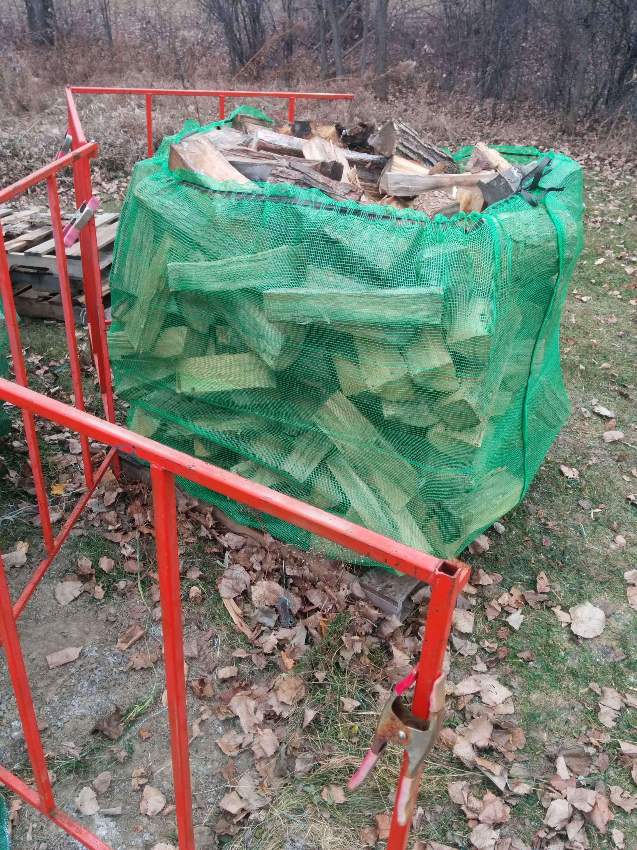

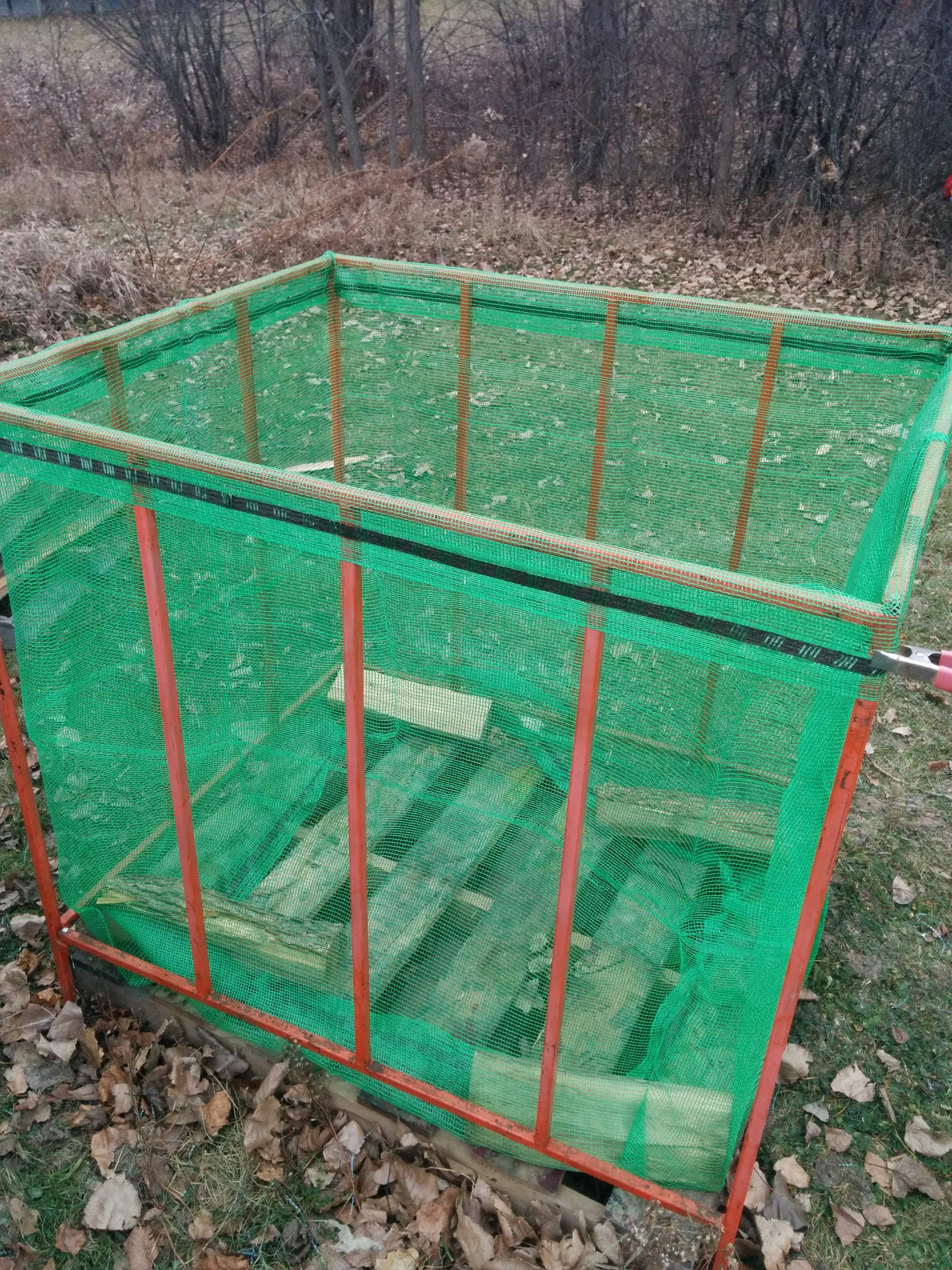

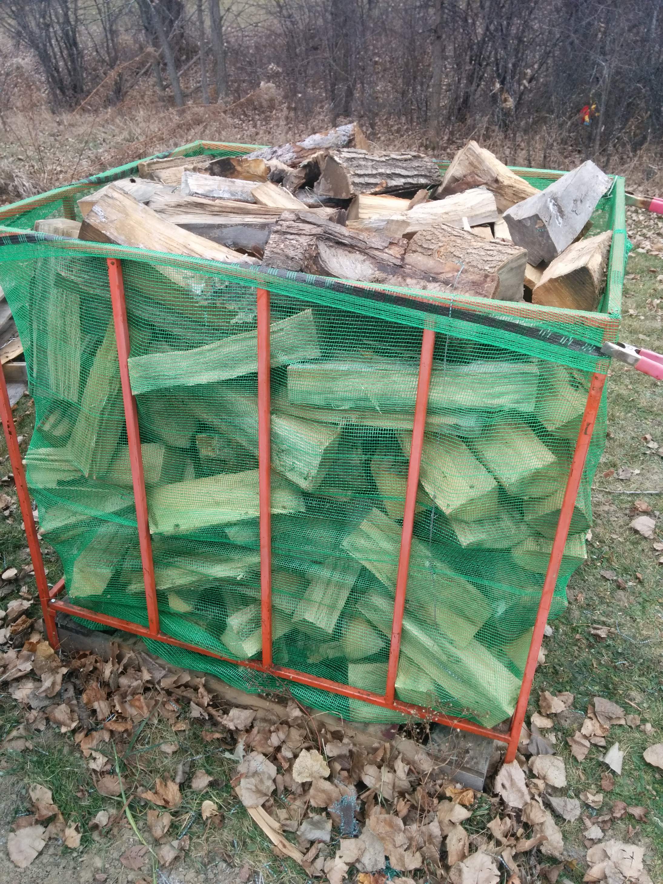

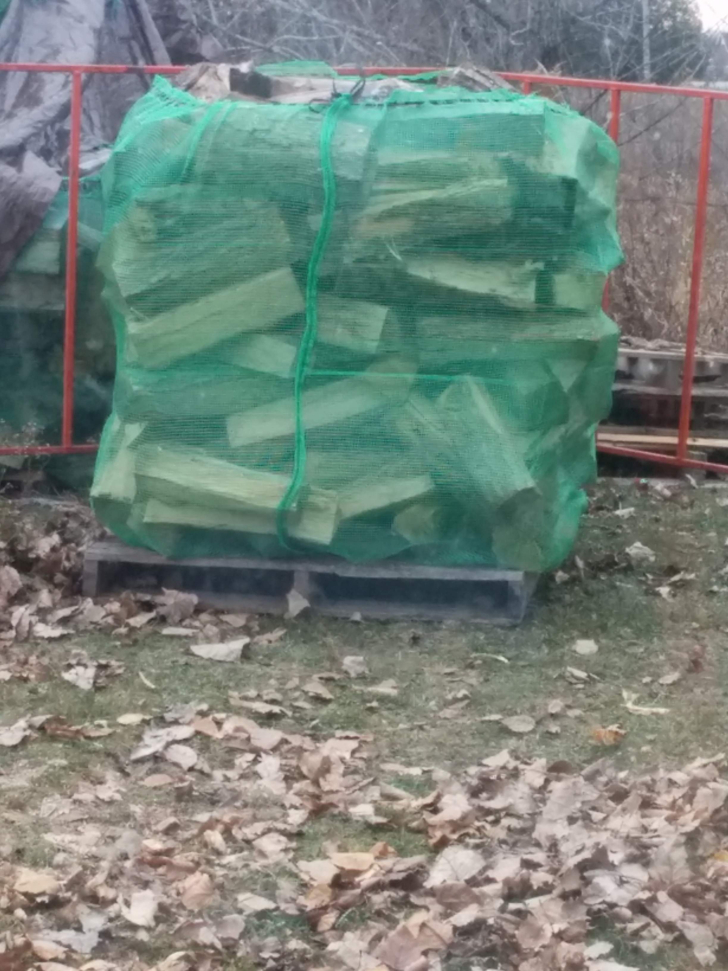

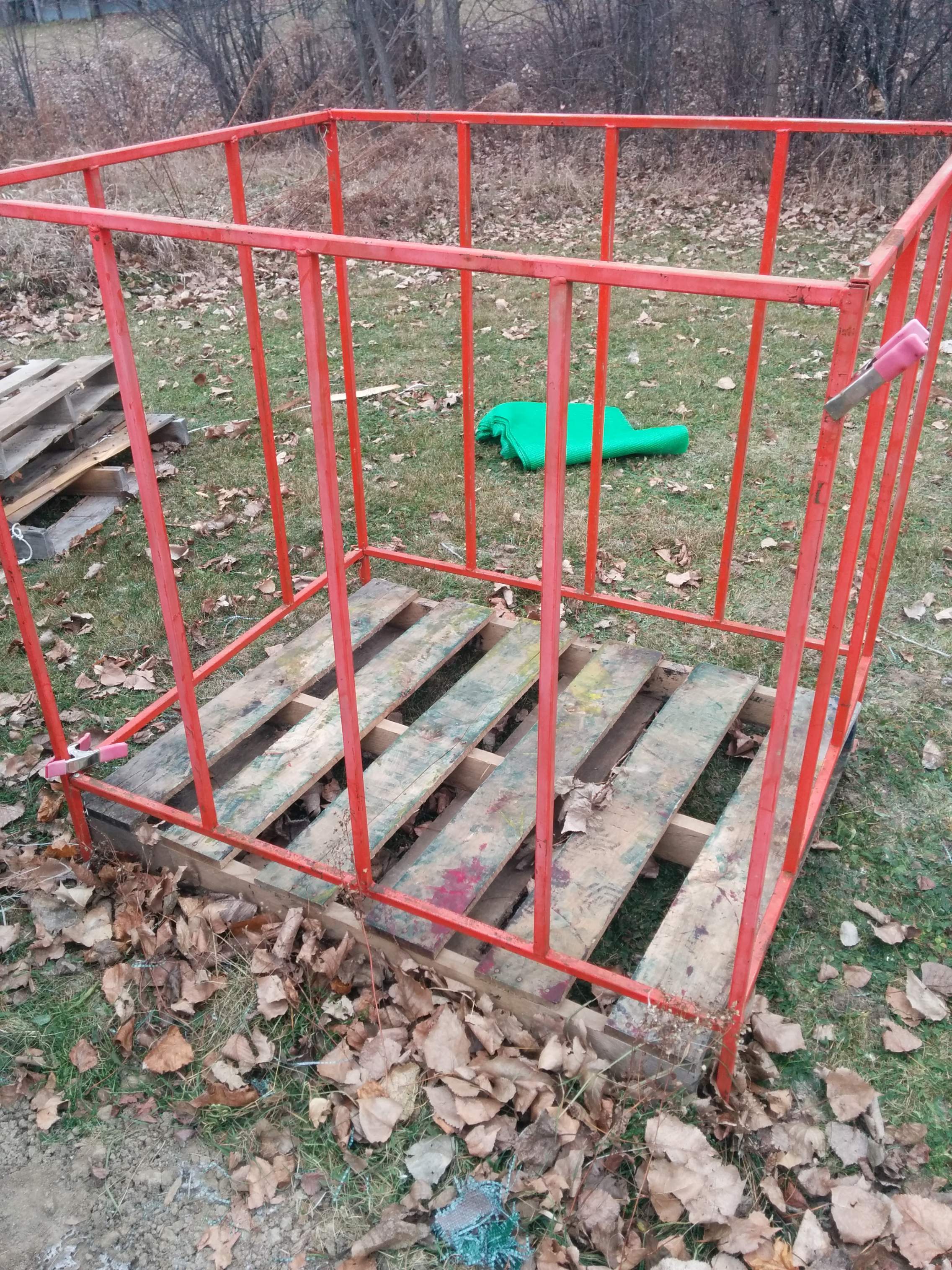

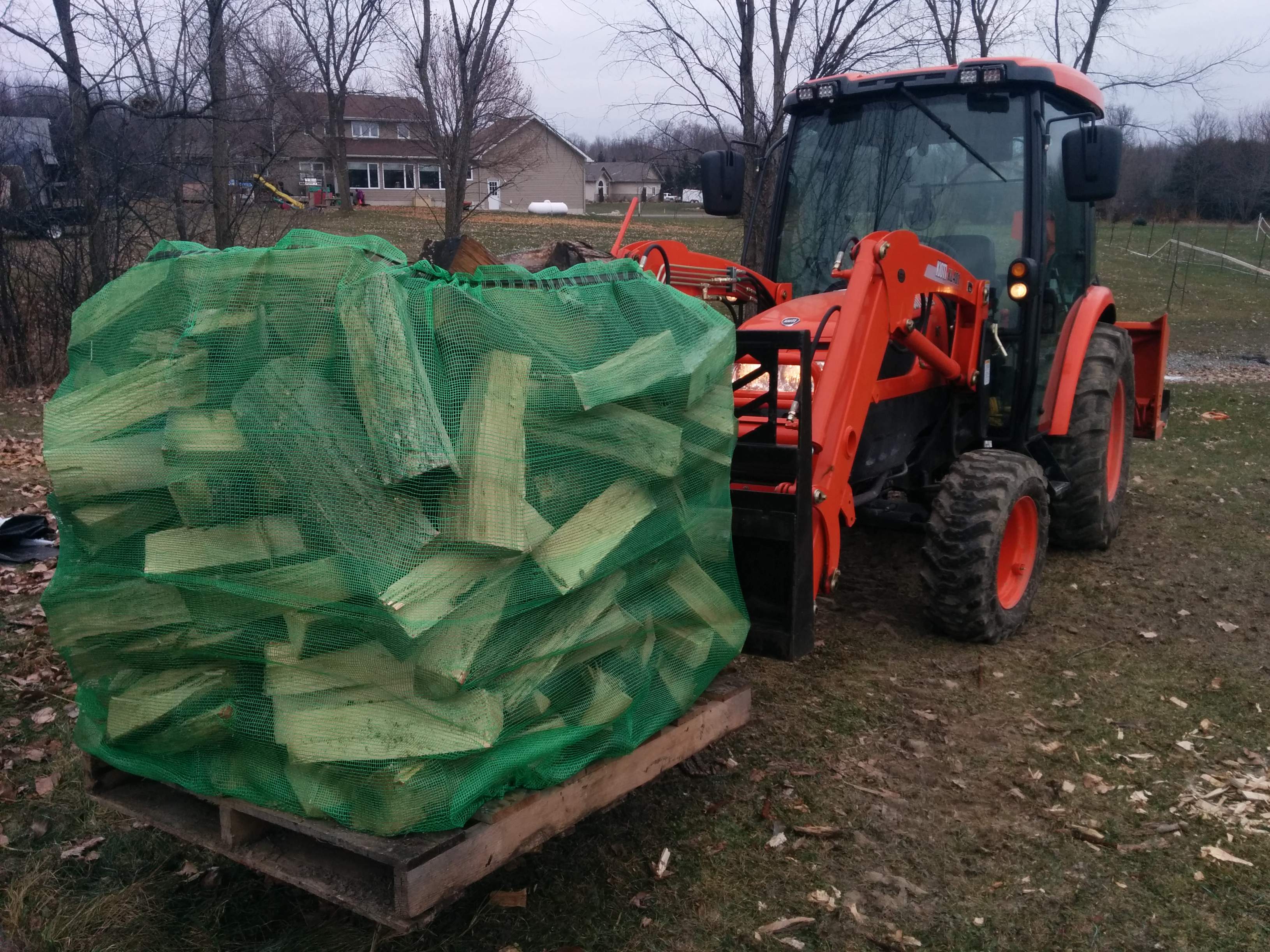

I'm pretty sure I've seen smaller bags on YouTube, but I've never found them for sale. When I first started using the bags, I had a Kioti CK30 that had a max lift somewhere around 1200-1300#. I would fill the bags as full as the tractor could still lift but couldn't stack them. It doesn't work though, they need to be completely full or they shift, don't hold their shape and can even fall over. They become a bit of a mess after a while.
I had an issue with a bag a few weeks ago and ended up dumping it. I finally got around to re-bagging it today so I took some pics to show. And yes, wood dries very well in the bags.
