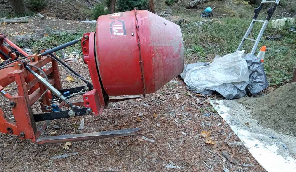

Well, it has been over 15y since I first started this thread, and I still use my mixer. This is the first implement I bought for my first tractor, back about 1997 or 1998. A Kubota L2550DT.
I just did an upgrade that I threatened to do years ago. It works well.
I was recently pouring concrete. Here is my con-mix loading area. I much prefer shoveling aggregates and Portland to using bags.
