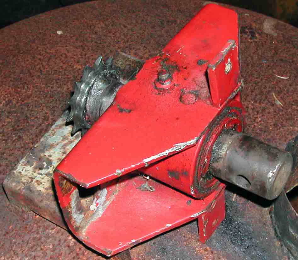

Speaking of putting the mixer back to PTO drive, here is the drive
spindle and drive sprocket. There are inner and outer ball bearings and
a zerk for grease. In this photo, you can see that the sprocket is
somewhat worn from use. I should have put chain lube on it more
frequently, which required removal of the cover plate.
I don't plan to go back to PTO drive, but ideally, the drive sprocket
should have less teeth so the drum would turn slower at idle.

   / converting a 3-pt concrete mixer from PTO to hydraulic drive #14
Resurrecting from the dead.............
Either one of you guys been using your converted mixers much? How have they been working out?
I just picked up a used Mixer 80 tonite I found on a bankruptcy auction for $450 - and I want to try and convert it to mount on the FEL on my B3200. I think my biggest hurdle is just figuring out the right hydraulic motor to use on it.

The Charlynn motor I used, and the equivalents, are fairly inexpensive. To get one big enough to go direct drive would be too expensive. Cheaper motors are lower displacement, and would run too fast direct drive.
If I did mine over, I would probably use one less tooth on the drive sprocket for a bit slower speed.

Yeah - that's pretty much what I'm seeing. I've looked around and any hydraulic motor that will spin at ~ 540 rpm (so I can hook it up direct drive) - is pretty expensive. All of the cheaper motors of lower displacement run way too fast for a direct drive.
Is there a formula to figure out how to size a motor based on pressure and flow to get a certain RPM out of it? I know the flow of my tractor is about 6.5 GPM for the accessories (steering is separate) - and if I remember correctly the pressure is about 2000 psi.
What I'd like to do is be able to just bolt the motor on with as few changes as possible.
You can calculate the RPM you are going to get, knowing your flow rate and the motor displacement. Or you can
just use the SurplusCnter motor app.
Pressure is not important for a hyd mixer, as it does not take much to turn the drum. However, it would be
great to have a drum spin at as little as 30RPM. 60RPM is plenty fast at the upper end. That rules out direct
drive, unless you get a gigantic motor. If your slowest speed is too fast, low-slump mud will just adhere to
the inside of the drum, without any mixing action. BTDT.
Because the power required to turn the drum is so low, you can run the tractor at barely over idle speed without
bogging then engine. This would give you about 1/3 of your rated flow, perhaps 2.2 GPM. Count the spocket teeth
and buy a drive sprocket that gives you the reduction ratio you want.
