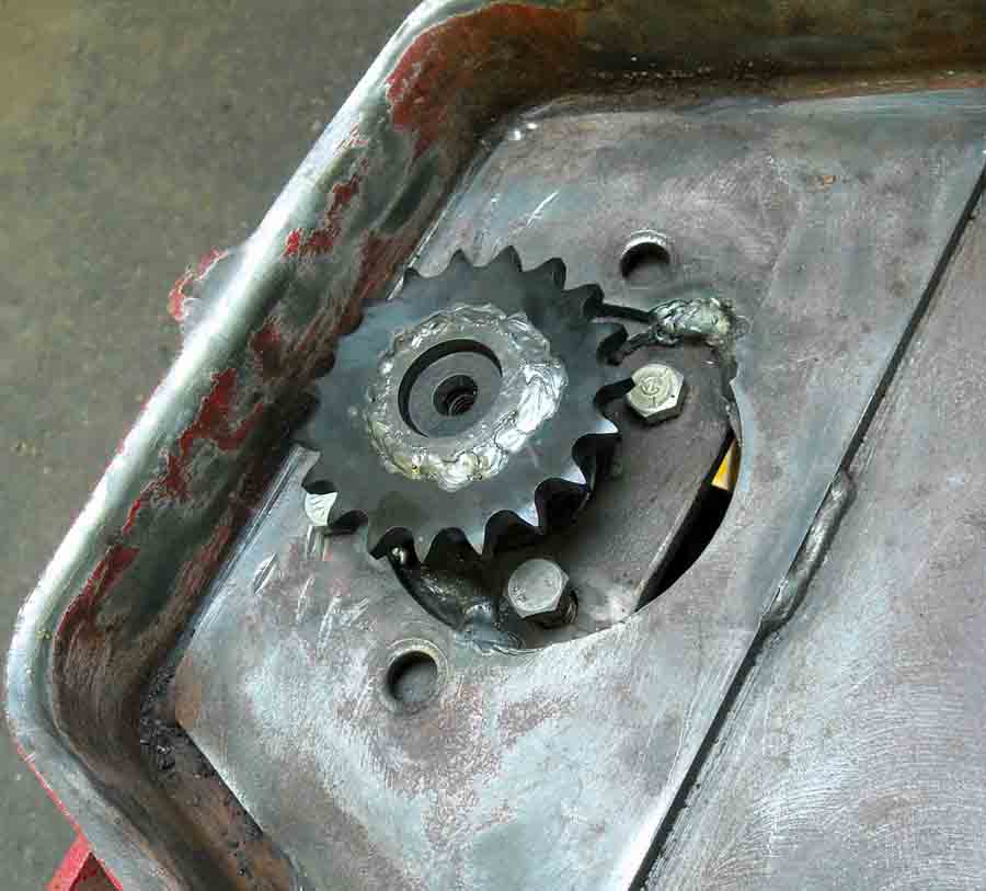

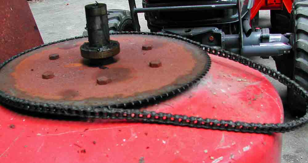

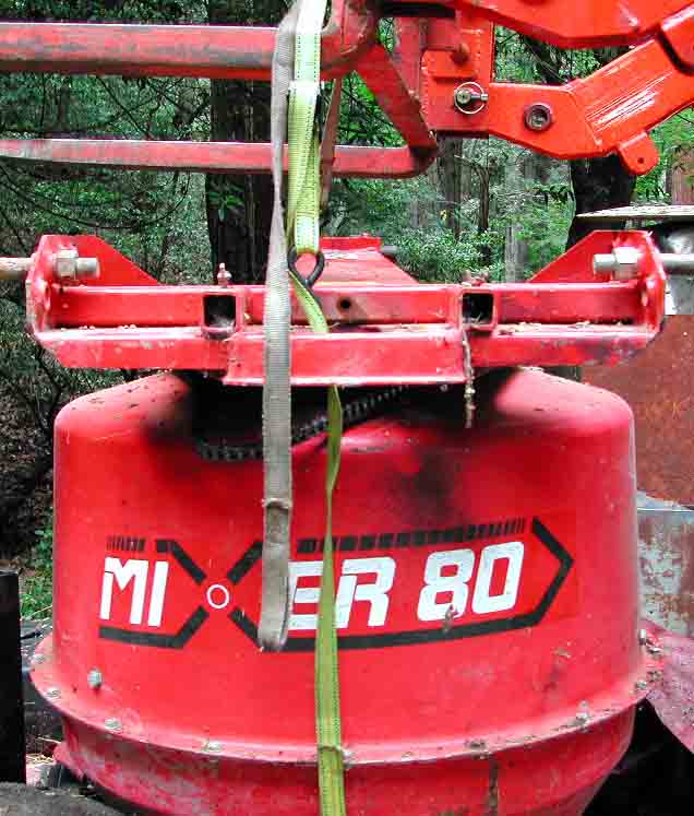

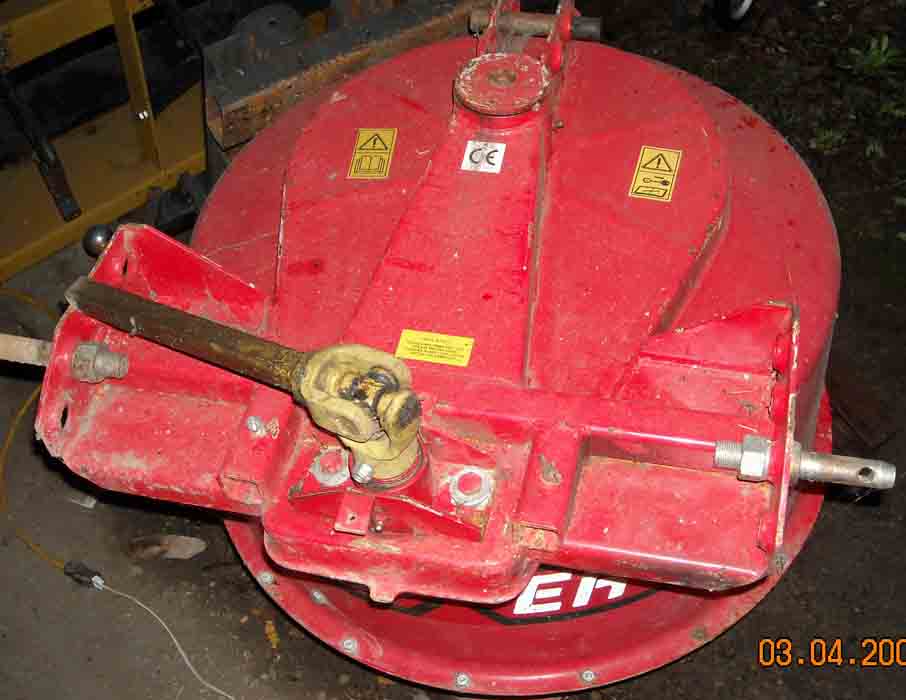

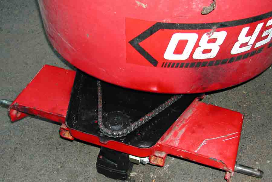

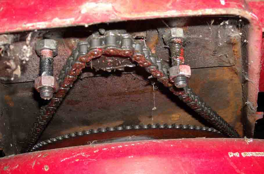

Anyway, the first 4 photos show my mixer as it is originally configured.
There is a tiny drive sprocket (2nd photo) and 40 guage chain, which drives
a gigantic sprocket with 114 teeth (4th photo). I used my FEL to pull this
thing apart. I have mixed scores of yards of concrete and stucco over the
past 10 years, and I always lube the chain with m/c aerosol chain lube.
Despite that, the drive spocket was pretty badly worn. :-(

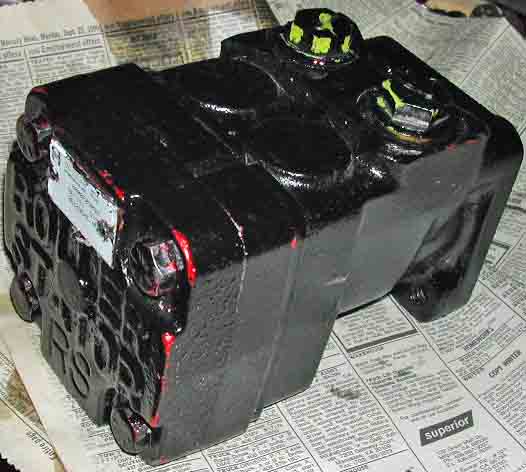

So, I decided to buy a motor that was between 7 and 12 cubic inches/rev.
I could just go to SurplusCenter and pay $150, but I know there are hundreds
of new motors on eBay for far less. The problem with eBay listings is that
the seller usually has no idea what he has....displacement, torque, shaft
size, etc. So you try to find his motor in a manufacturer catalog, based on
a part #, or serial number. I figured that if I was patient, I would find a
new motor that met my needs for less than $100. I would then choose my
drive sprocket and shaft adapter based on what I could buy. After a few

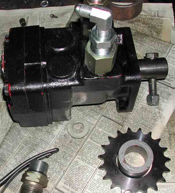

months of looking I landed a 7 GPM White roller-stator motor for about $65,
and it had a straight 1" shaft (first photo). That allows me to use 1" DOM
tubing instead of buying spline adapters or woodruff key adapters. Cool!
I next bought a drive sprocket from SS...a very nice one that is twice as
thick as the worn out one the mixer came with. The hole in the sprocket is
about 1.75", so I will have do some creative welding (2nd photo).

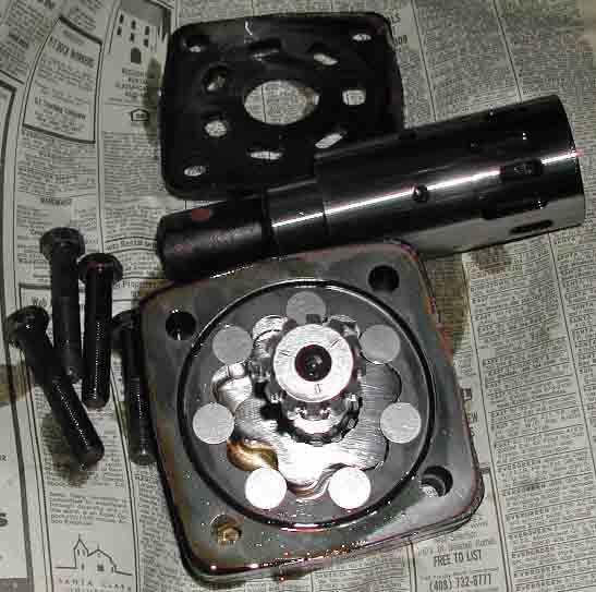

Ever wonder what it looks like inside these motors? See the 3rd photo.

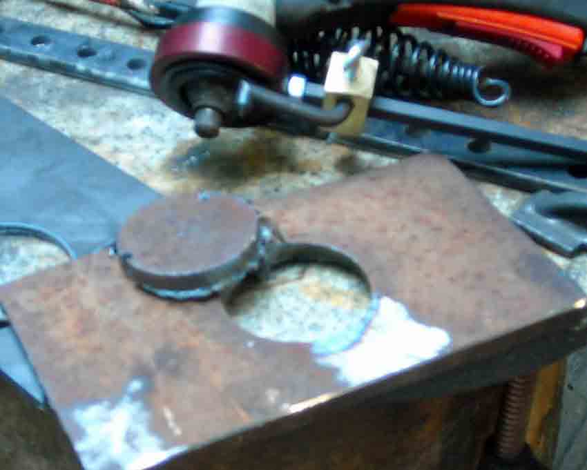

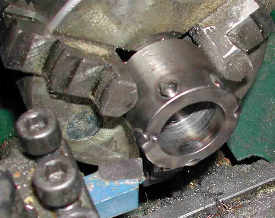

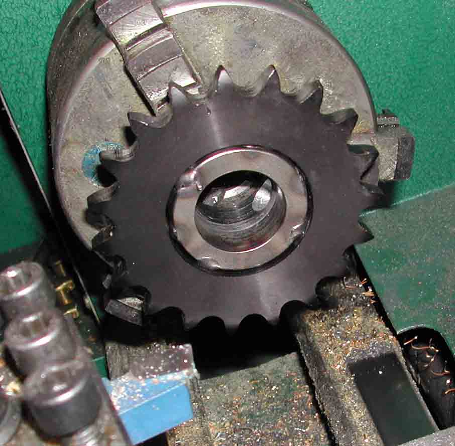

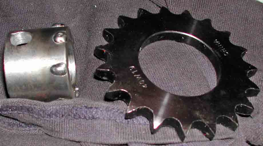

Now I need to get my sprocket centered on my DOM tubing. This does
not have to be perfect, since this is a very low speed chain drive.
First, I welded some nubs onto the tubing (photo #1), then I cut them
down a bit on the lathe (#2) to achieve a snug fit on the sprocket (#3).
I had to open up the bore a few thousanths so it would fit on the 1.000"
shaft. Now I am ready for welding the sprocket on.

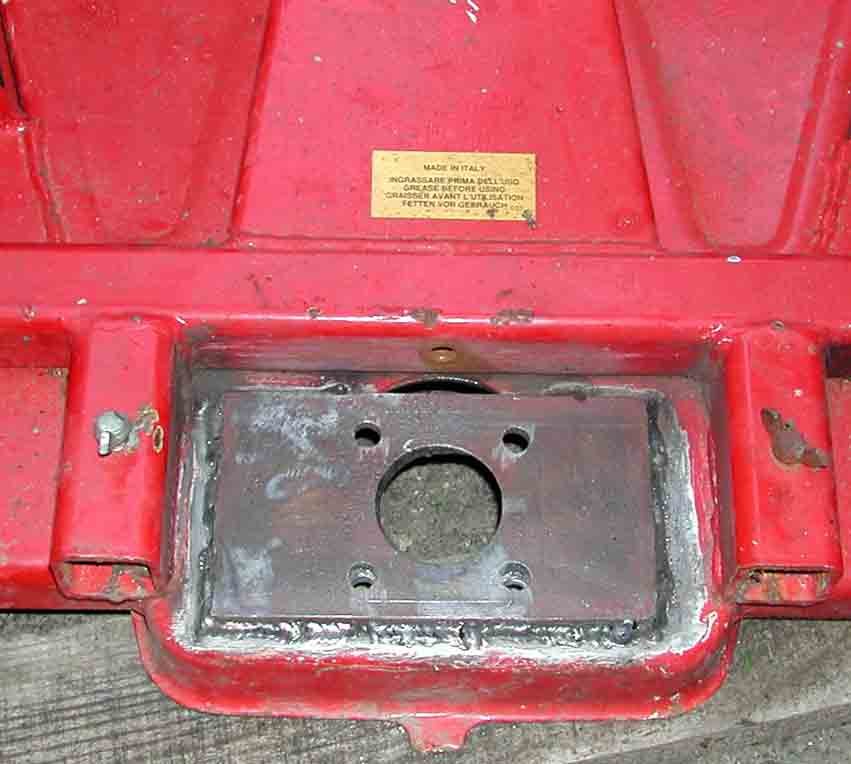

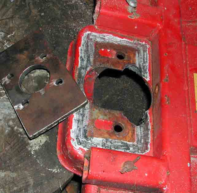

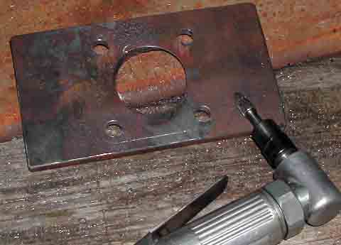

Before I weld up the sprocket, I need to make sure that it will be in the
same plane as the driven sprocket. So next, I will mount the motor.
I grabbed some 1/4" plate from the scrap pile (I have lots of scrap) and
cut out a central hole with my plasma cutter. My hole cutter guide allows
me to cut a hole that is almost exactly the right size, and it only takes
a minute or 2 (photo #1). I cleaned that up with the carbide air grinder
and drilled 4 mounting holes (#2).
Next, I had to prep the mixer for welding. That included trimming back some
of the steel to clear the motor bolts, as well as removing paint (#3). Those
free-hand cuts are ooogly.
Photo #4 is the result. Now I can mount the motor.

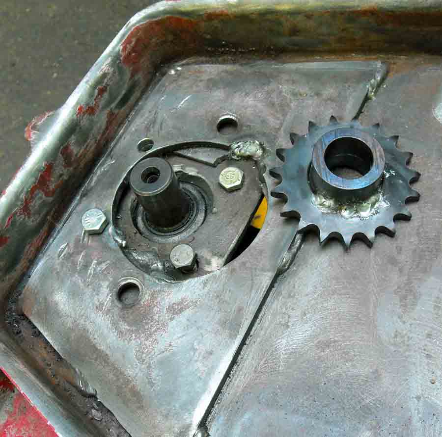

Now the motor is mounted, and the sprocket is welded up (#1 and #2).
Everything is put back together with a slightly lengthened chain, and I
am good to go (#3, and #4).

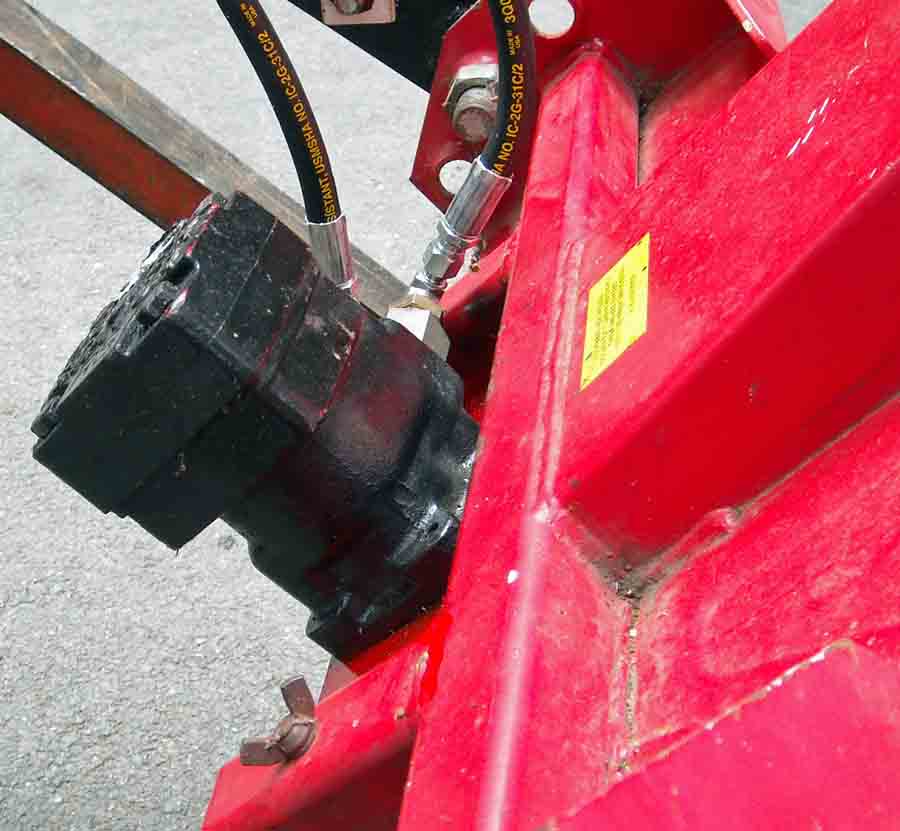

I chose to use 15-ft long 1/4" hoses after determining that my fluid
velocity would be about 13fps for 2GPM flow rate. This is a little high,
and will cause some fluid heating, but it is acceptable. I do not run the
mixer for extended periods, or I would have gone with 3/8" hose. I am
fortunate that my Kioti tractor's OEM AUX valve is detented. Buying
pre-made hoses of this length saves tons of money over having them
custom made at a hydraulics shop.

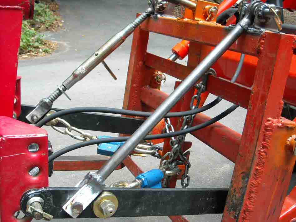

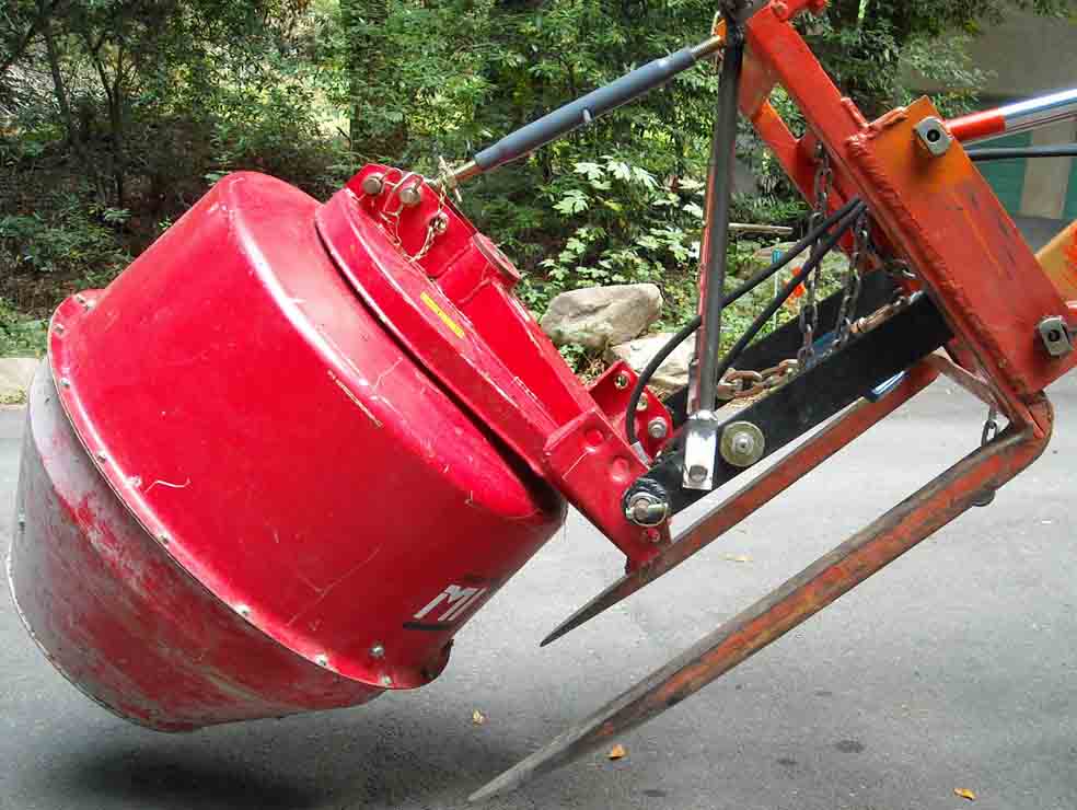

   / converting a 3-pt concrete mixer from PTO to hydraulic drive

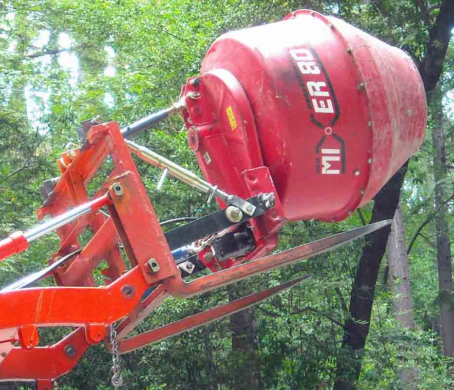

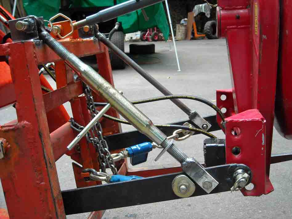

This is how I operate my mixer. I made a 3-pt hitch for my pallet fork
frame. I could also use this on the rear 3-pt hitch. I have just poured
some piers for a new carport structure I am making and it works well.
I chose to make a hitch for my fork frame because that is the implement
I most often use. I have tried my rock rake with it and it works great.
One could also adapt one of those 3-pt quick hitch adapters to the FEL
mounts.

   / converting a 3-pt concrete mixer from PTO to hydraulic drive #10
Nice job. Was there some reason you took the hyd motor apart?
