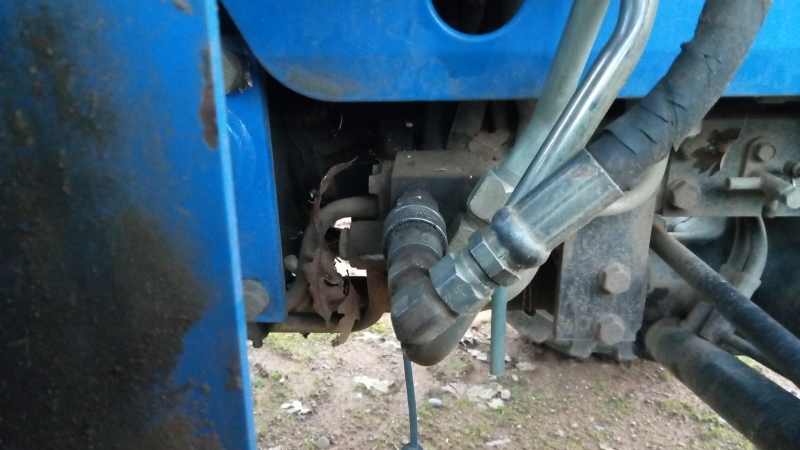

This illustration shows the diverter block similar to your 1520. To connect your backhoe, interrupt the power beyond flow from the loader valve back to the block and use that to power the backhoe valve stack. Connect the return to the tank port in the diverter block or remove the 3/8 pipe plug from the cover of the three point hitch valve and return the oil there. You do not need to buy any expensive valve or power beyond plates. Just a couple hoses and quick couplers.

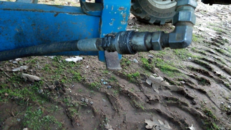

As Rick pointed out above , that is how my 757 connects to my TC 30 . The hose that connects to the front disables the 3 point , thus there is no chance of damage to either the 3 point or the backhoe . The back , shorter line is , is the return to tank line . Simple hook-up , takes about 1 minute for the lines , maybe 3 or 4 minutes to get the sub frame lined up .

IMG_20190125_165656 (800x450).jpg IMG_20190125_165706 (800x450).jpg IMG_20190125_165733 (800x450).jpg
First picture is hose from BH attached to hose from manifold block from loader .
2nd picture is what the manifold looks like after the hose is un connected from it .
