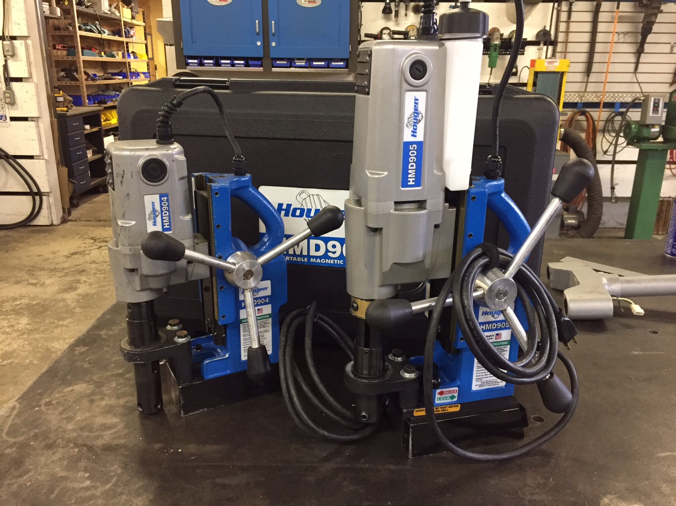

I mostly use this, diluted as recommended
https://www.amazon.com/Hougen-11742...F8&qid=1545639129&sr=8-9&keywords=hougen+lube
Mix it in these (for extended projects)
https://www.amazon.com/gp/product/B00AQV14SA/ref=oh_aui_search_detailpage?ie=UTF8&psc=1
or these for smaller jobs
https://www.amazon.com/gp/product/B00NQ8DO3I/ref=oh_aui_search_detailpage?ie=UTF8&psc=1
I also have one of the stick lubes, only use it when I can't keep the drill vertical (so far, not often at all)
I haven't quite got as brave as Terry on the compressed air, but probably will eventually - I'd need to set up a record-keeping method for # of cuts/material/thickness for one specific cutter (preferably NOT one of the bigger one$$) first.

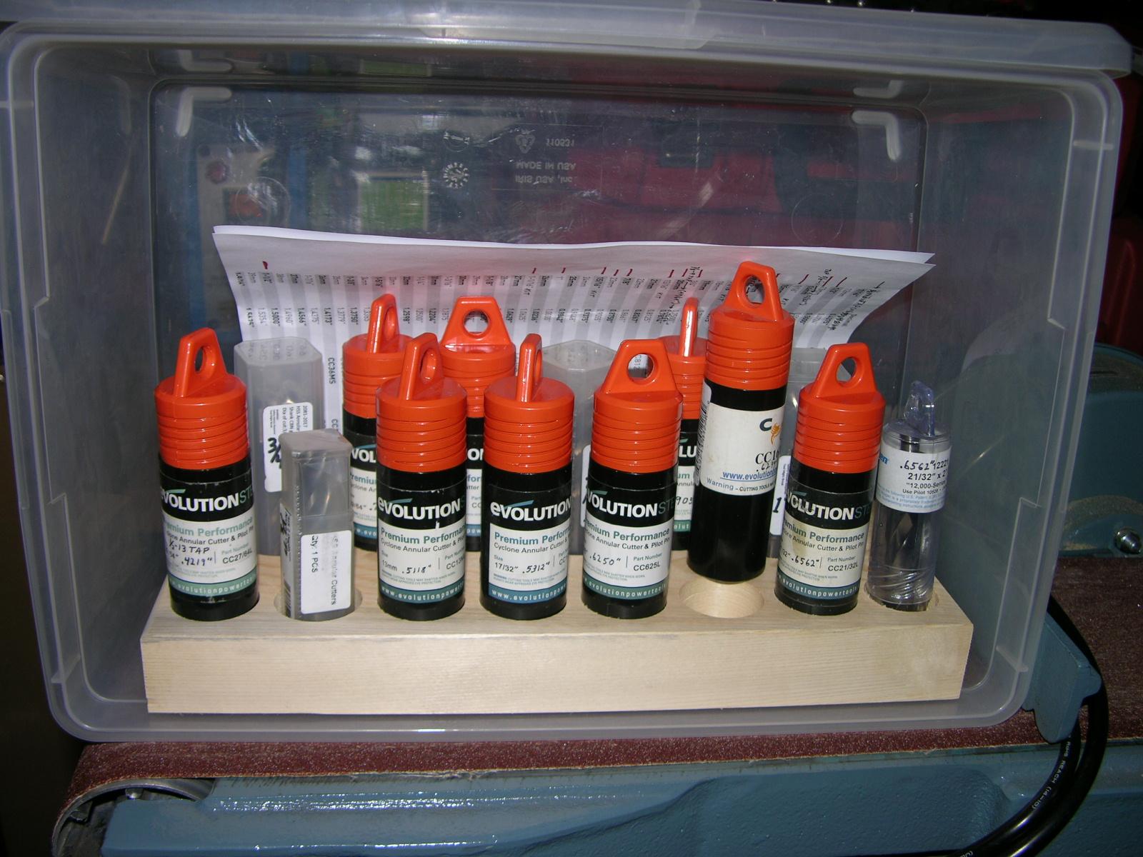

Another trick that works for me - I've bought several METRIC cutters, always just a few thou bigger than SAE sizes I use a lot - this gives me a hole with just enough slop not to need a hammer to drive a bolt in. I have Evolution's catalog, edited to show the cutters I have - if it's not too big I'll attach the pdf here - if that works, you can see that ALL the metric cutters I've marked are really just SAE with "built-in clearance" :rolleyes:
Looks like it might've worked. I like Evolution's cutters AND their containers, plus they don't make you buy a pilot SEPARATELY like some others - nice thing about their containers is MOST are the same diameter, up til the cutter is too big to fit it - DSCN1964.JPG - One of those "oversize shoe box" totes, a piece of 2x6 and a forstner bit and "voila" :D (couple more cutters and I'll be re-thinking that one :rolleyes:)

I like Evolution's cutters AND their containers, plus they don't make you buy a pilot SEPARATELY like some others - nice thing about their containers is MOST are the same diameter, up til the cutter is too big to fit it - View attachment 584209 - One of those "oversize shoe box" totes, a piece of 2x6 and a forstner bit and "voila" :D (couple more cutters and I'll be re-thinking that one :rolleyes:)

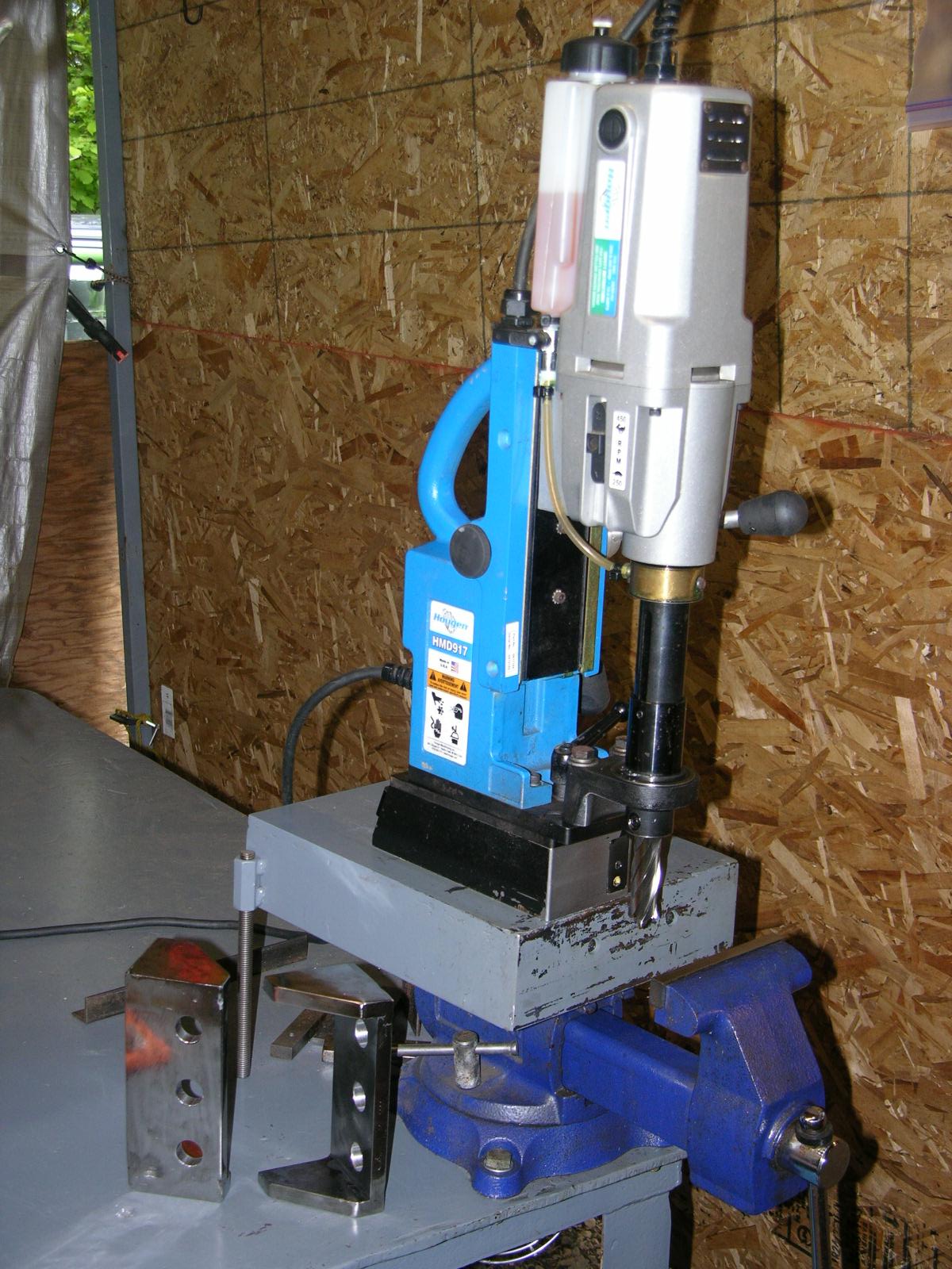

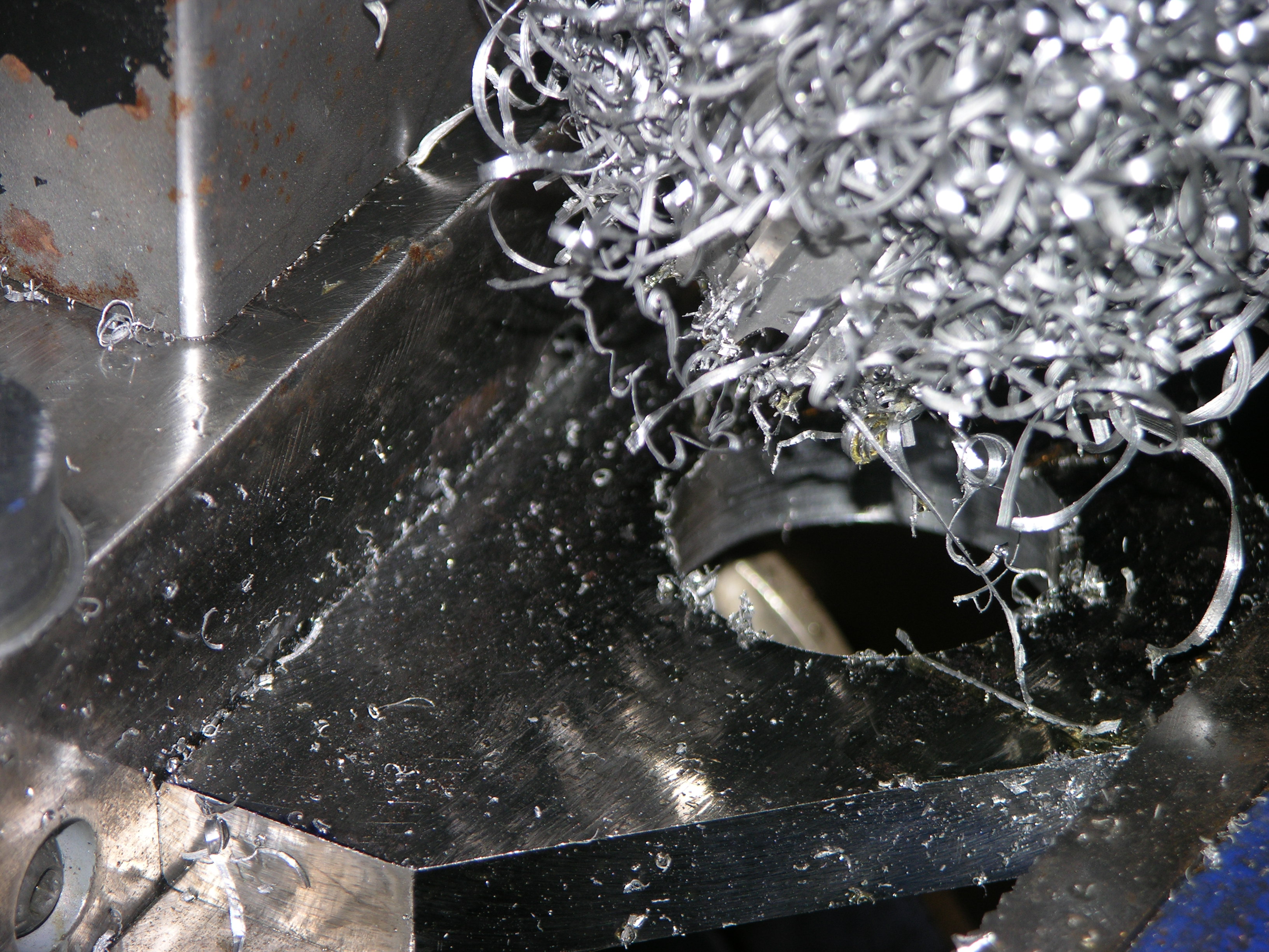

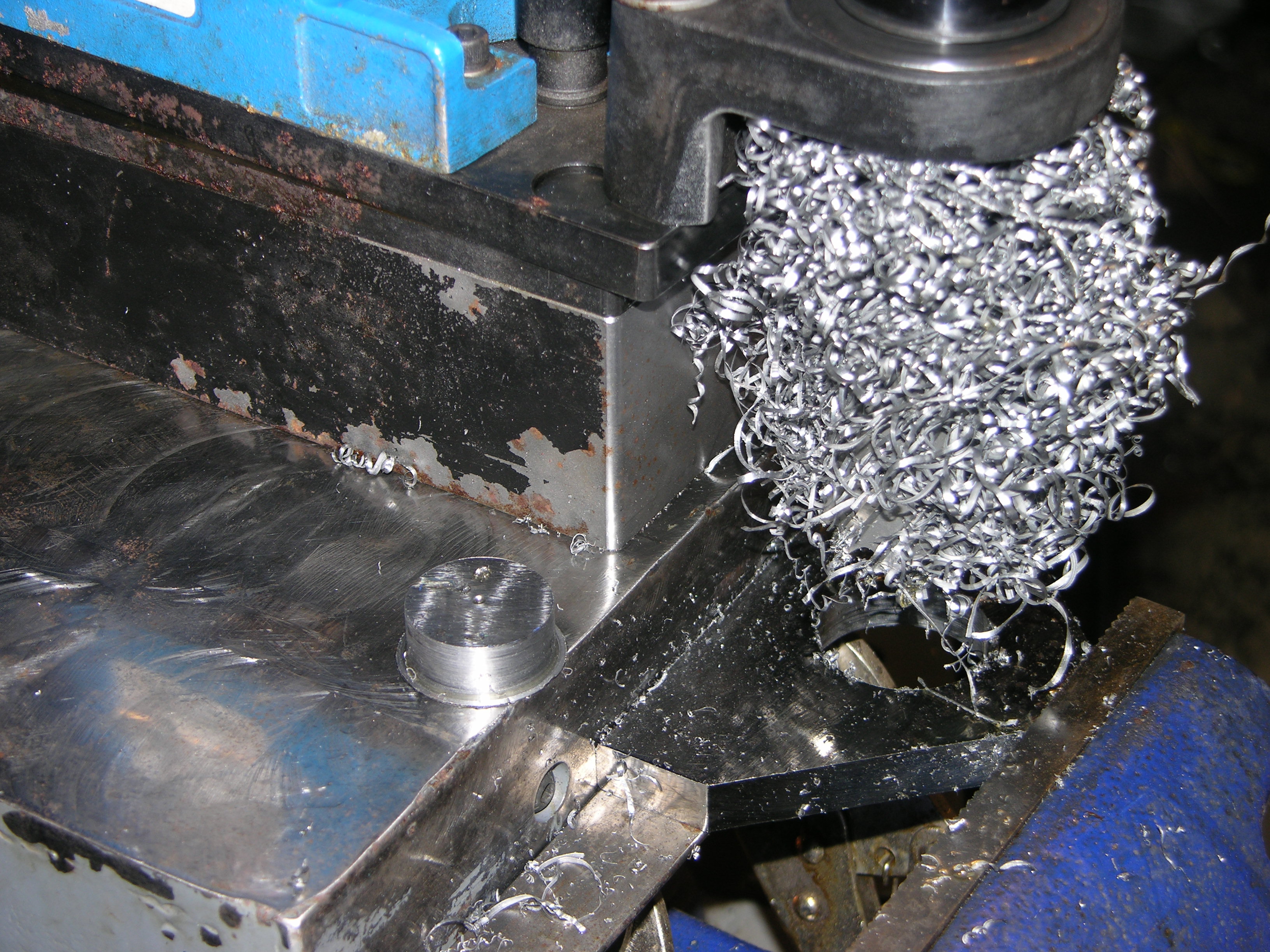

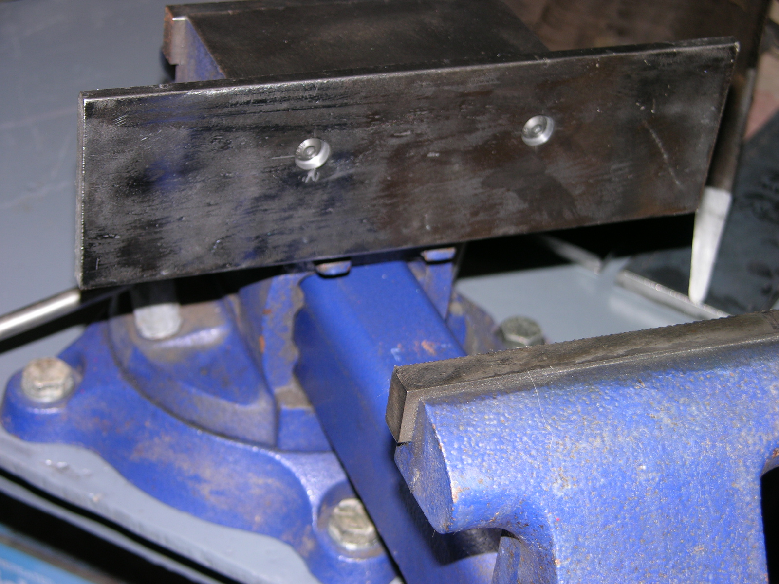

Found a little time, here's pics of the basic "MDVT" build - I didn't have any 1/2" PLATE at the time, so it's all 1/2x3 FB and 10" channel. Pics are named and (kinda) in build order. in order to make sure the mounting plate (replacement jaw) is perpendicular to the top I double-checked the channel end cut for true, then hard-clamped the jaw face to the channel and did multiple tacks before welding.
Then I knocked off excess weld on the top surface with a flap disk so it wouldn't tear up the fly cutter. Doing these steps makes it MUCH easier to get true holes in things that're clamped in the vise for drilling. There'll be a second post for the rest of the pics... Steve

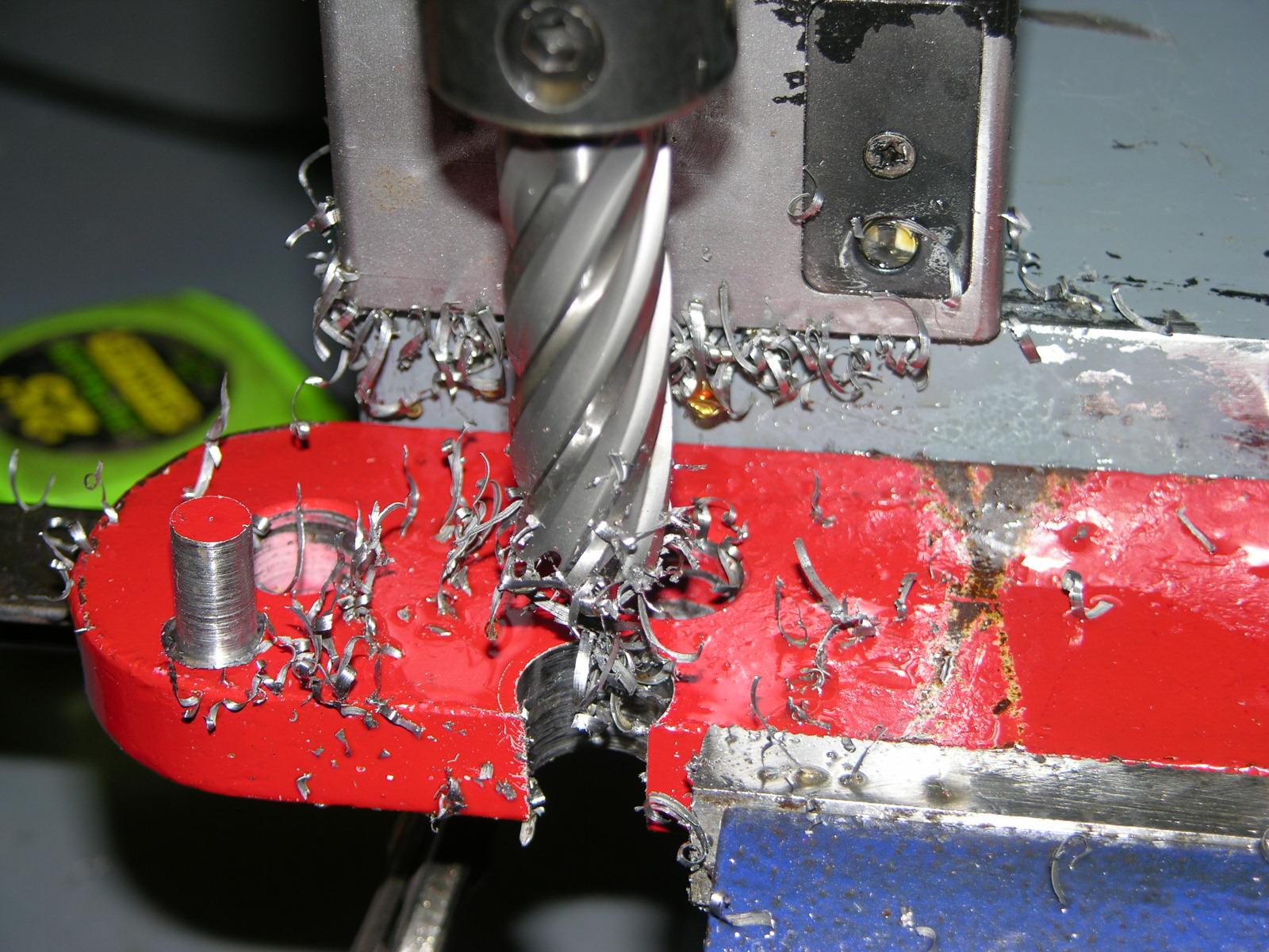

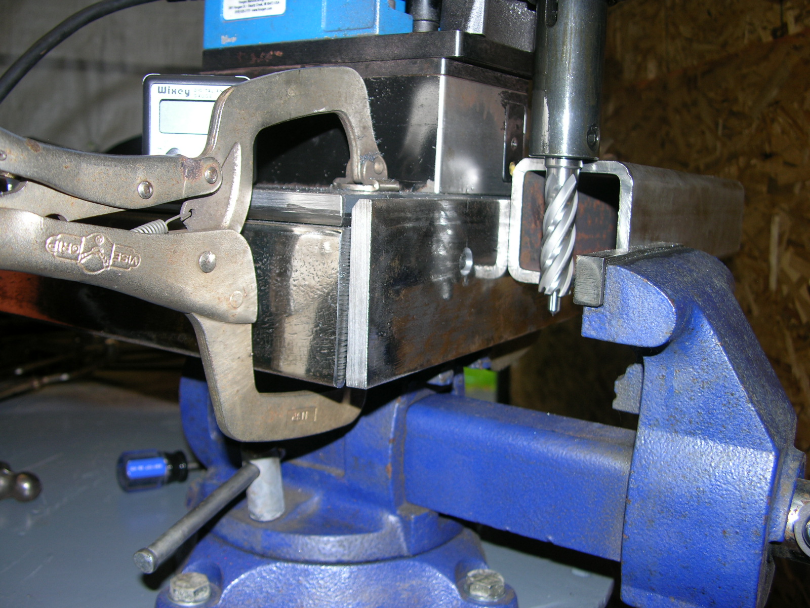

BTW, the ones with the partial hole in the red thingies was INTENTIONAL - necessary to defeat the FLOAT setting on my 6' Caroni flail. Also shows ways to drill multiple parts identically. The last TWO pics show using an internal stop for drilling multiple pieces of 2" tube EXACTLY the same distance from the end...
ANOTHER BTW - this is the vise I used
https://www.amazon.com/Wilton-14500...F8&qid=1545689289&sr=1-9&keywords=wilton+vise
NO particular reason other than I HAD it - also, you can get one for a few $ less if you're a previous ENCO customer registered at MSC.
Again, no reason any vise wouldn't work as long as you can remove the jaw insert... Steve

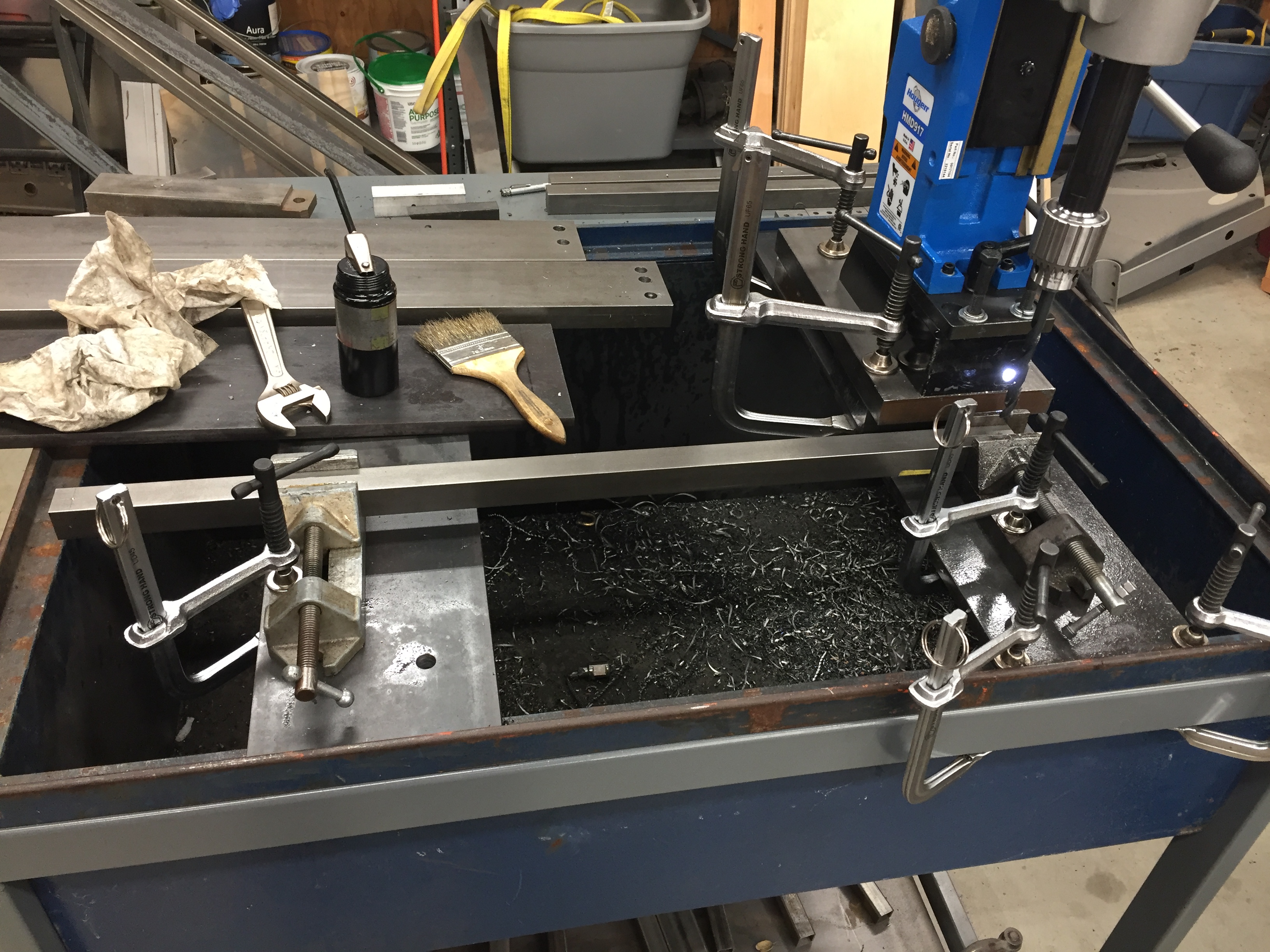

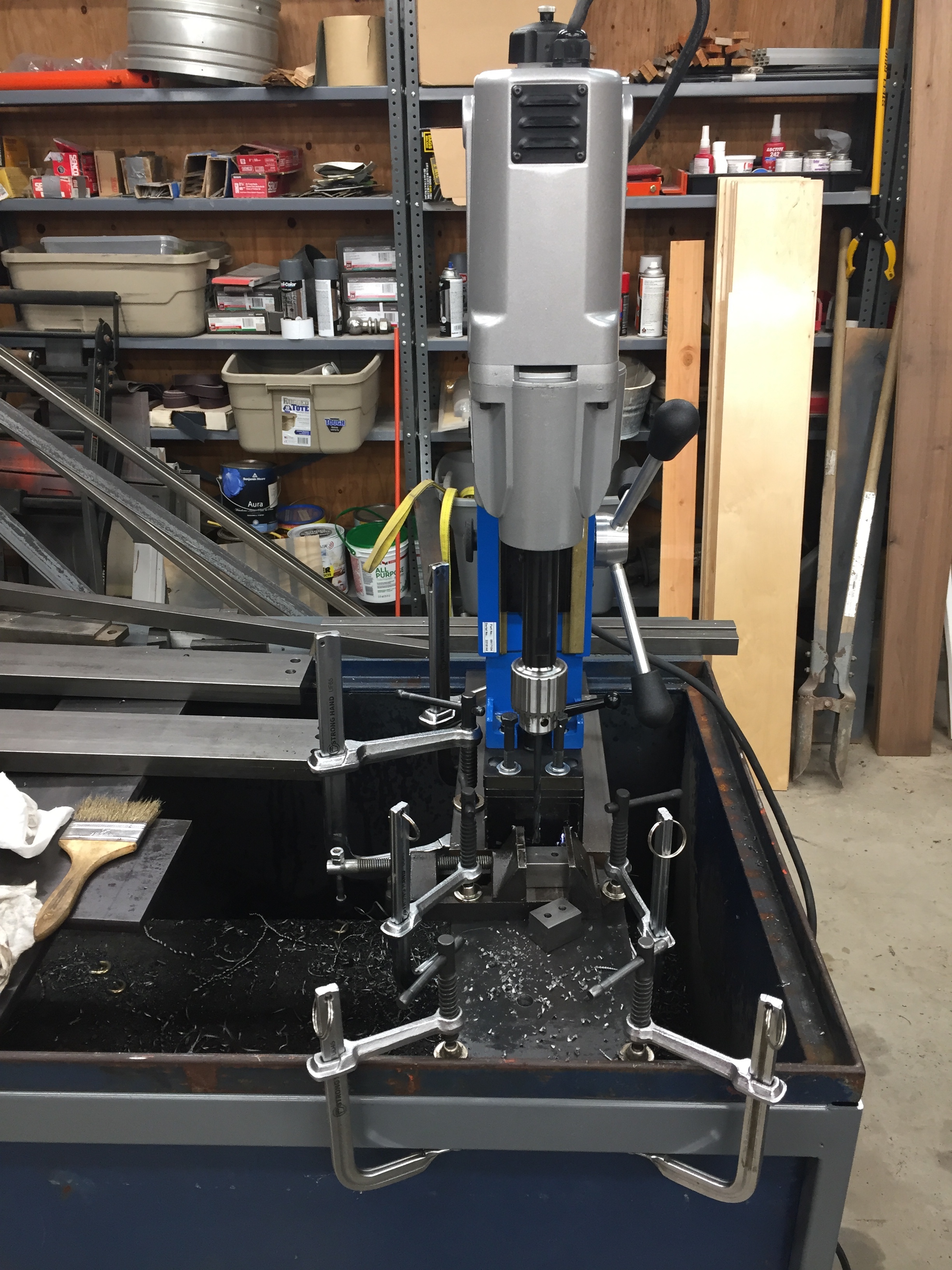

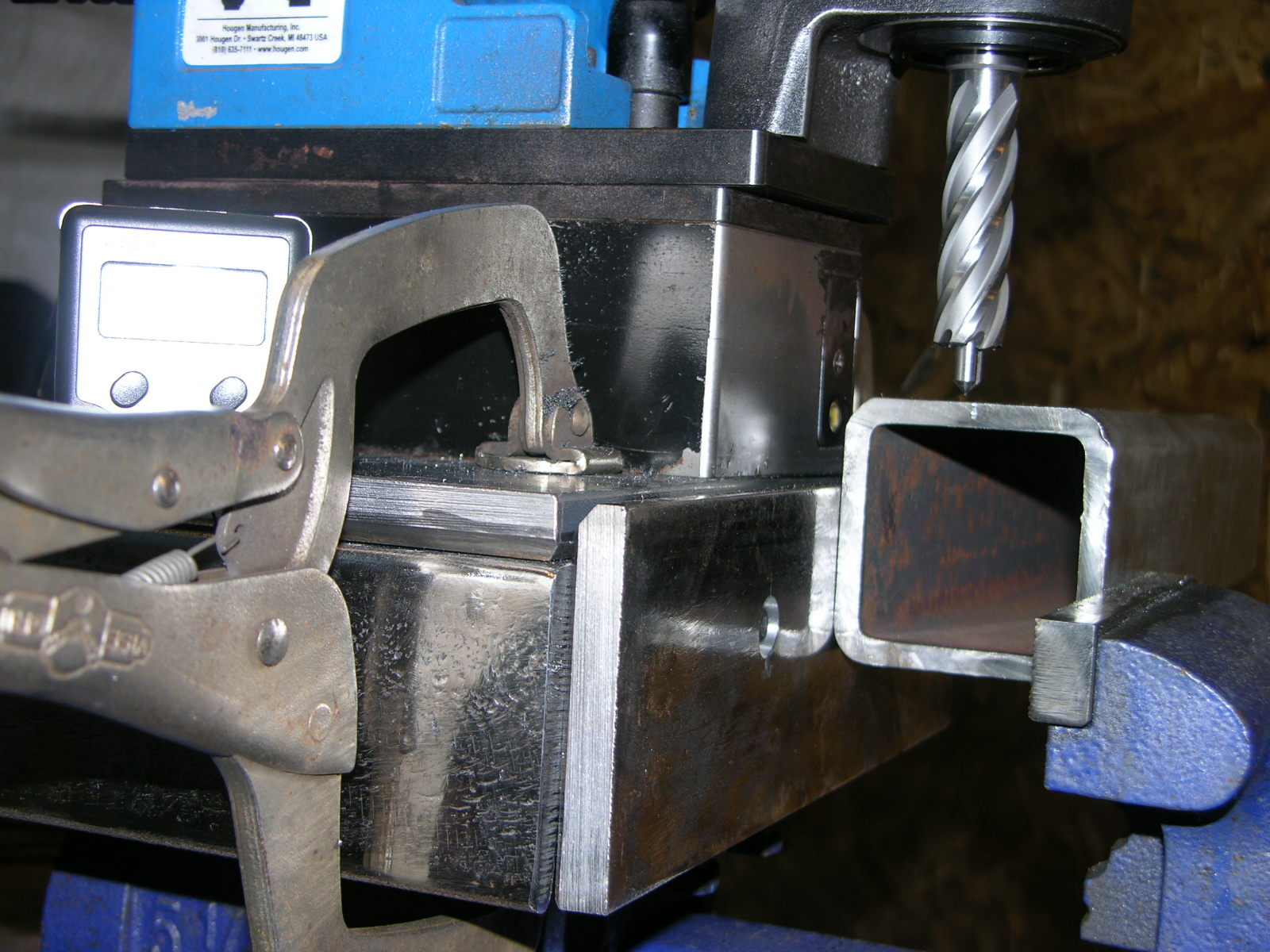

Got started making the drilling table for the mag drill. Immediately broke a cutter drilling a half inch hole through 1 inch bar. Expensive lesson. Drill lifted off the half inch plate it was magnet-ted to.
Photo 1, a thicket of clamps.
Photo 2, never thought of using parallel vises until I saw Steve's photo, works well.

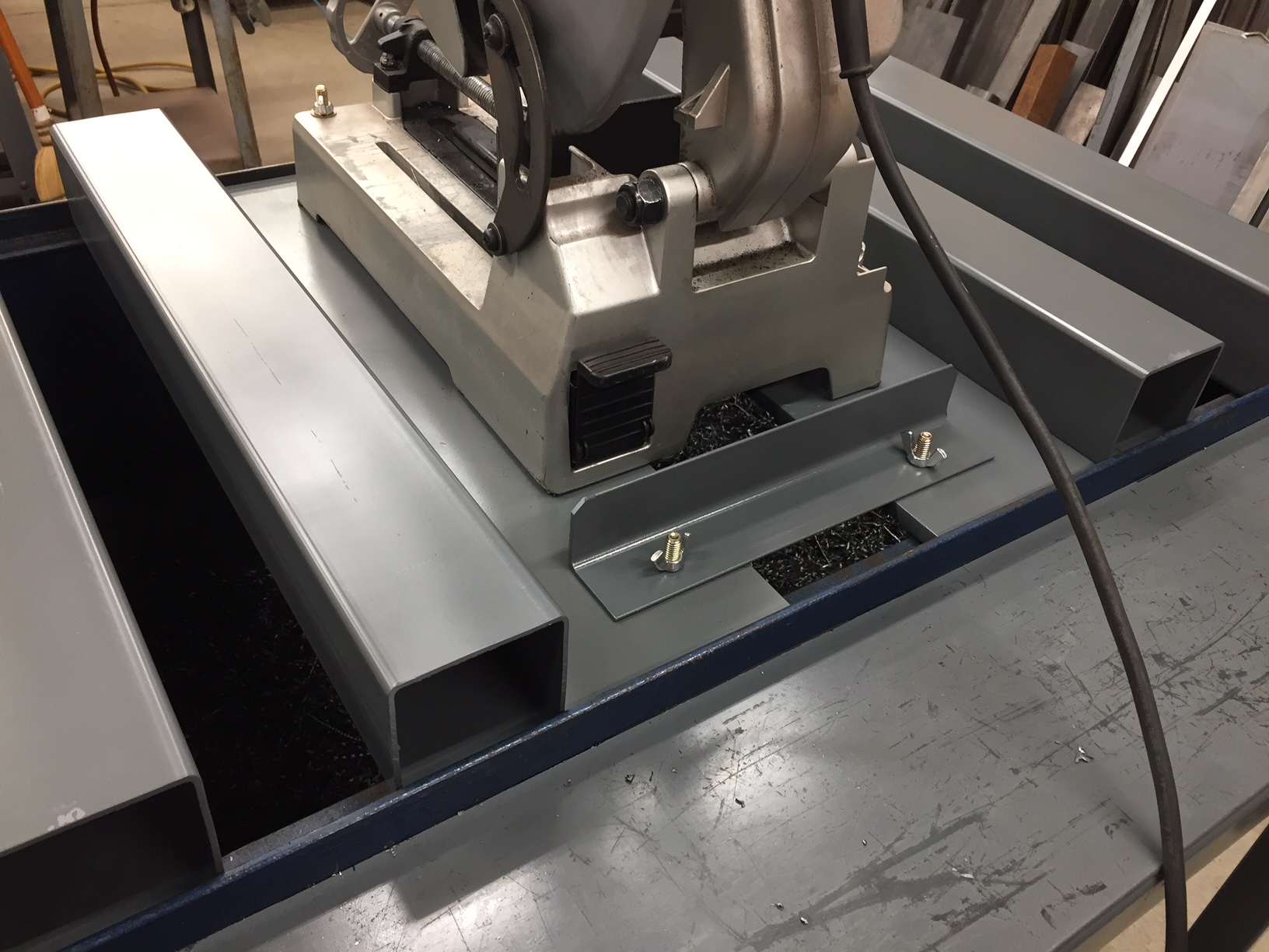

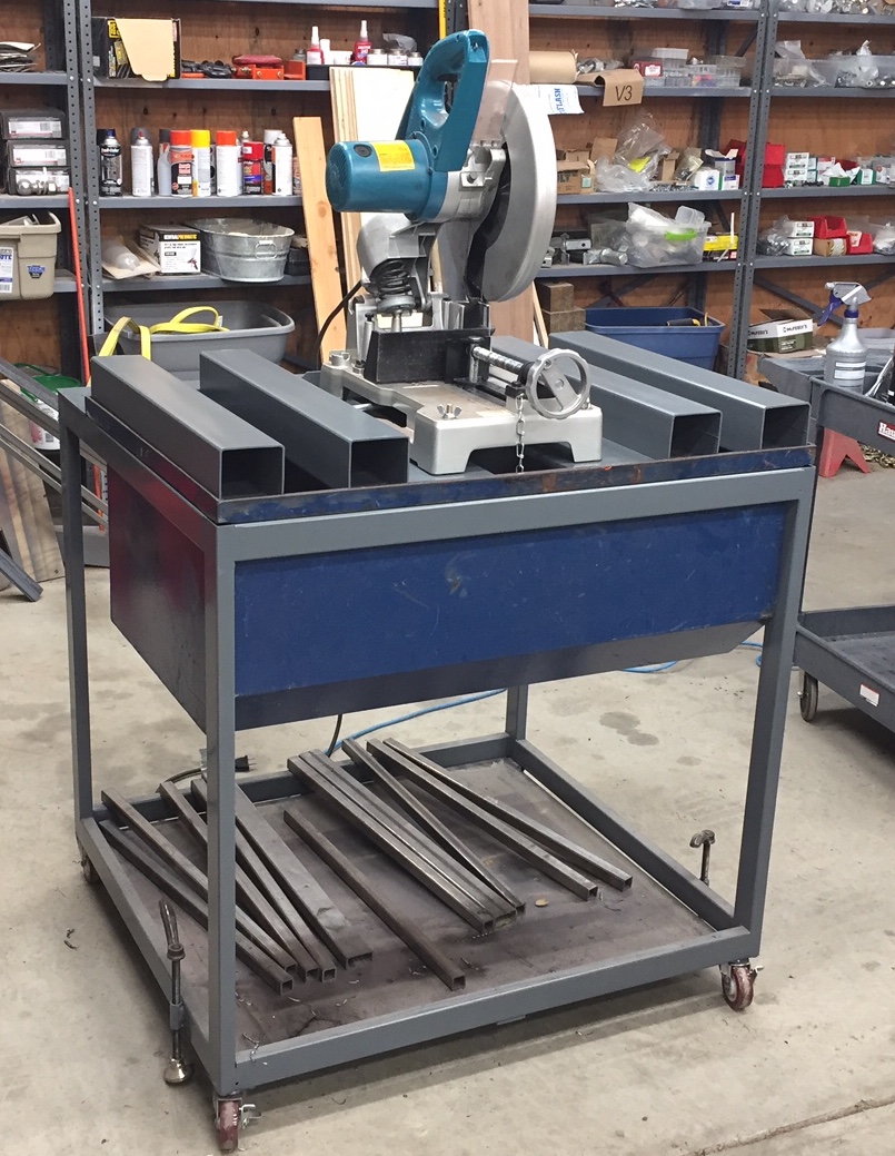

After seeing BB's nice Makita saw table I thought I needed to pull up my socks at least somewhat. So invested in some DupliColor Machinery Gray. Also added a small fence at the back, to keep rogue chips in the table.
I meant to mention before, there is a second thing that can lead to a slanting cut. There is a build up of hard black gunk between the saw blade and the inner and outer flanges. How it gets there I have no idea. But eventually it makes for vibration and inaccurate cuts. A bit of emery cloth takes it right off and all is OK for months at a time.
