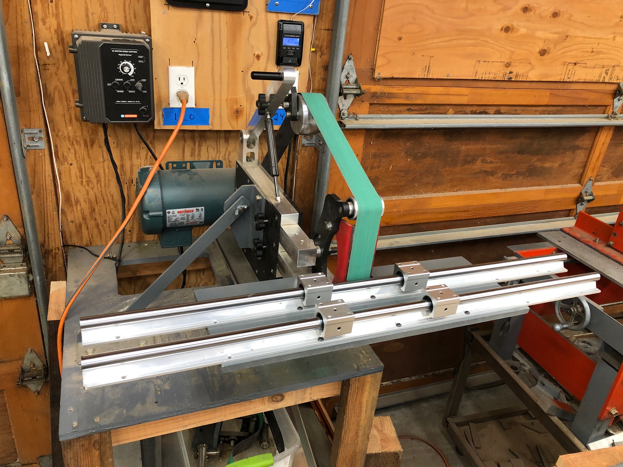

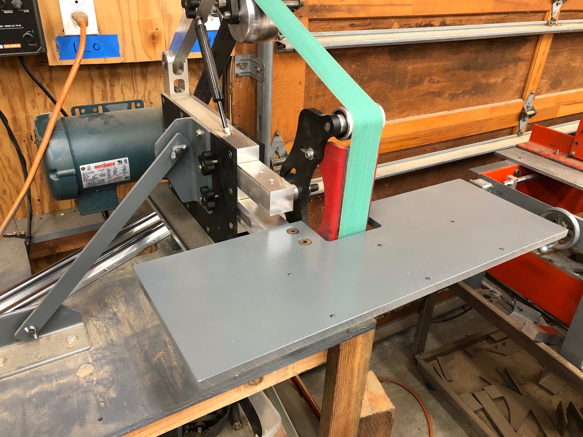

I use a 2x72 belt grinder a lot, it is very versatile and powerful. I decided to make a sliding work table to improve accuracy on some operations.
Photo 1 - this is the fixed work rest I made when I first got the grinder. 1/2" aluminum. It is much larger than what is normally used but handy for many things.

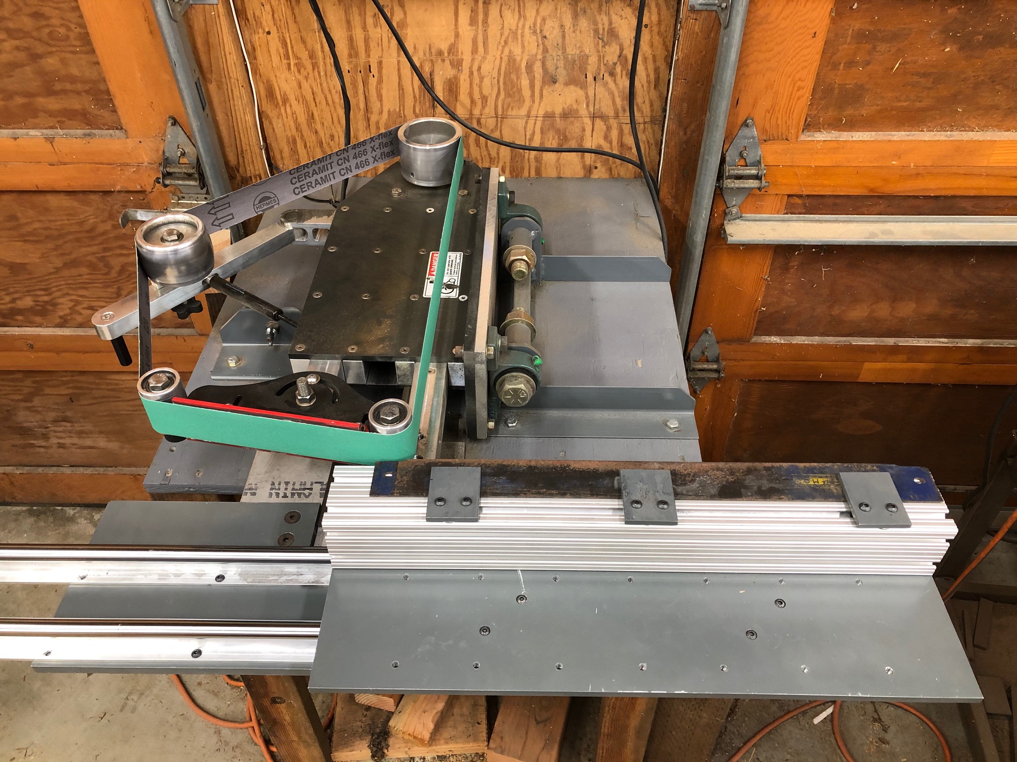

Photo 2 - I installed 20mm rails and linear bearings for the slide mechanism.

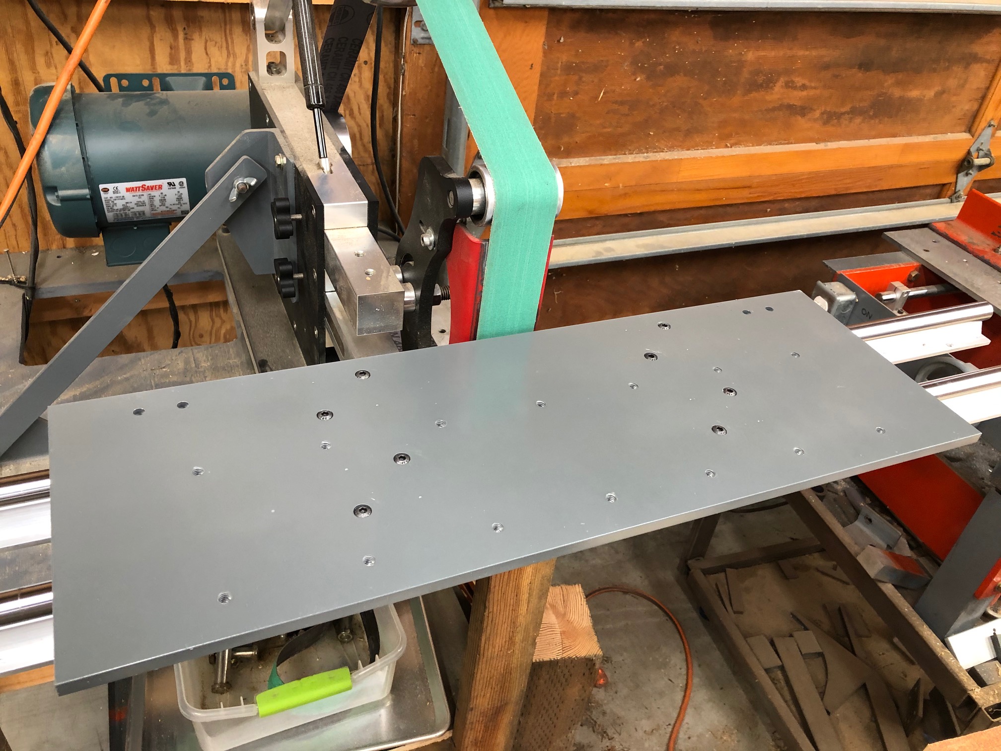

Photo 3 - the work table is 3/8" aluminum. I put a grid of threaded 5/16" holes so standard milling machine hold-downs can be used on large or irregular work pieces. It is also drilled to accept a sliding T-nut extrusion.
Photo 4 - T nut extrusion installed. I am making a long bread slicer knife from a power hack saw blade. It is fixed to the extrusion with three clamps made from 1/4" steel.
With this setup it is easy to get a perfect bevel on the 20" knife blade. As well as perfectly square and even finishes on other workpieces.

Excellent build Pat. In essence you have a very nice surface grinding jig for your belt grinder
I am in other process of designing mine. I would really like to find a magnetic chuck though.

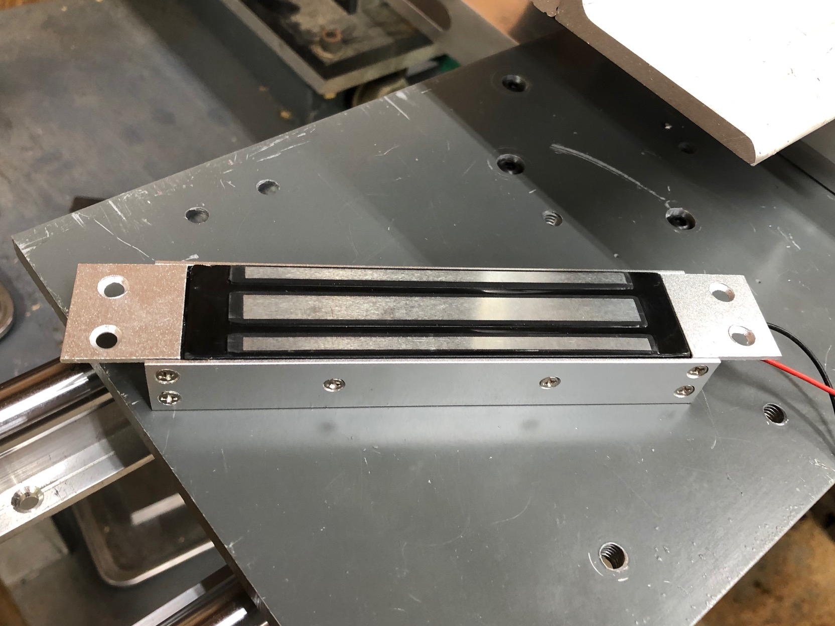

I have thought of a magnetic chuck too. Large ones are costly. I have seen DIY setups using rare earth magnets but not convinced that is the way to go.

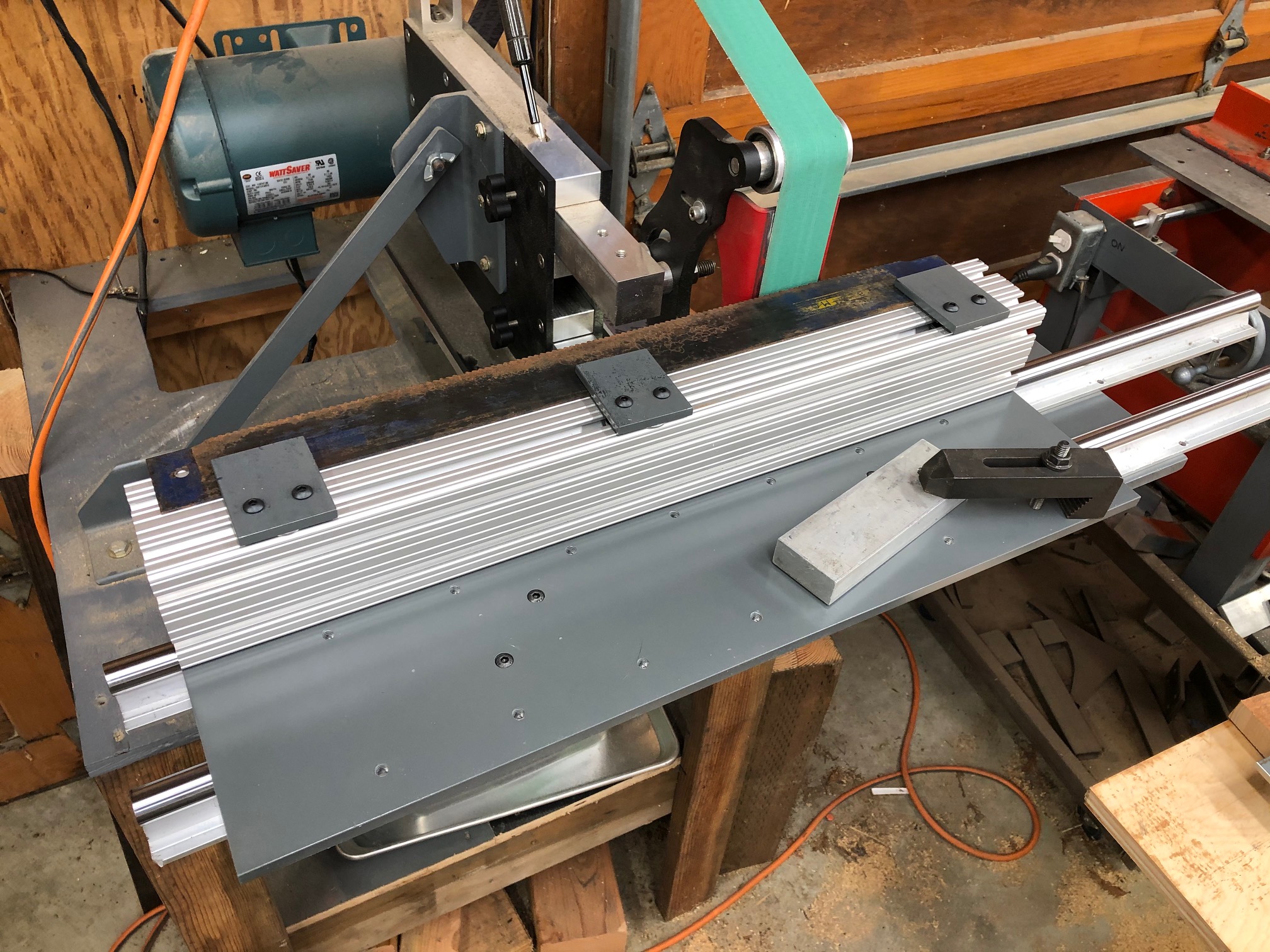

I got the sliding table set up to work with the grinder in the horizontal position. It removes material very fast and accurate. I debated making a fine adjustment mechanism to move the table toward and away from the belt, but decided for starters to just move the tool rest arm in and out. That works but is too clunky. So the next step is to make a screw in/out adjuster.

Totally looking forward to what you come up with for feed adjustment. Again, nice work so far
And I know you did it a while back but I love your vertical to horizontal mechanism.

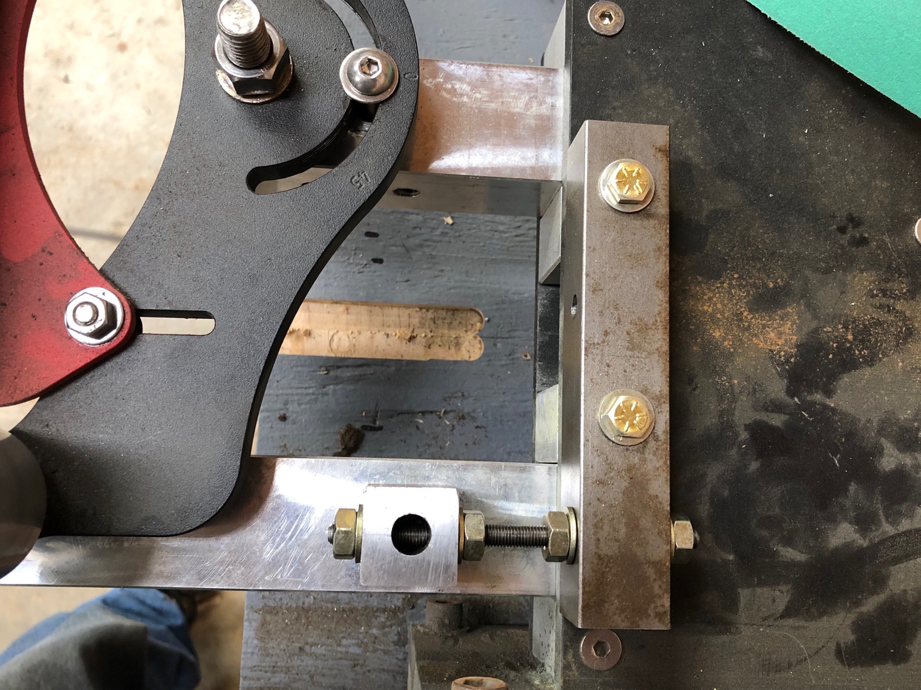

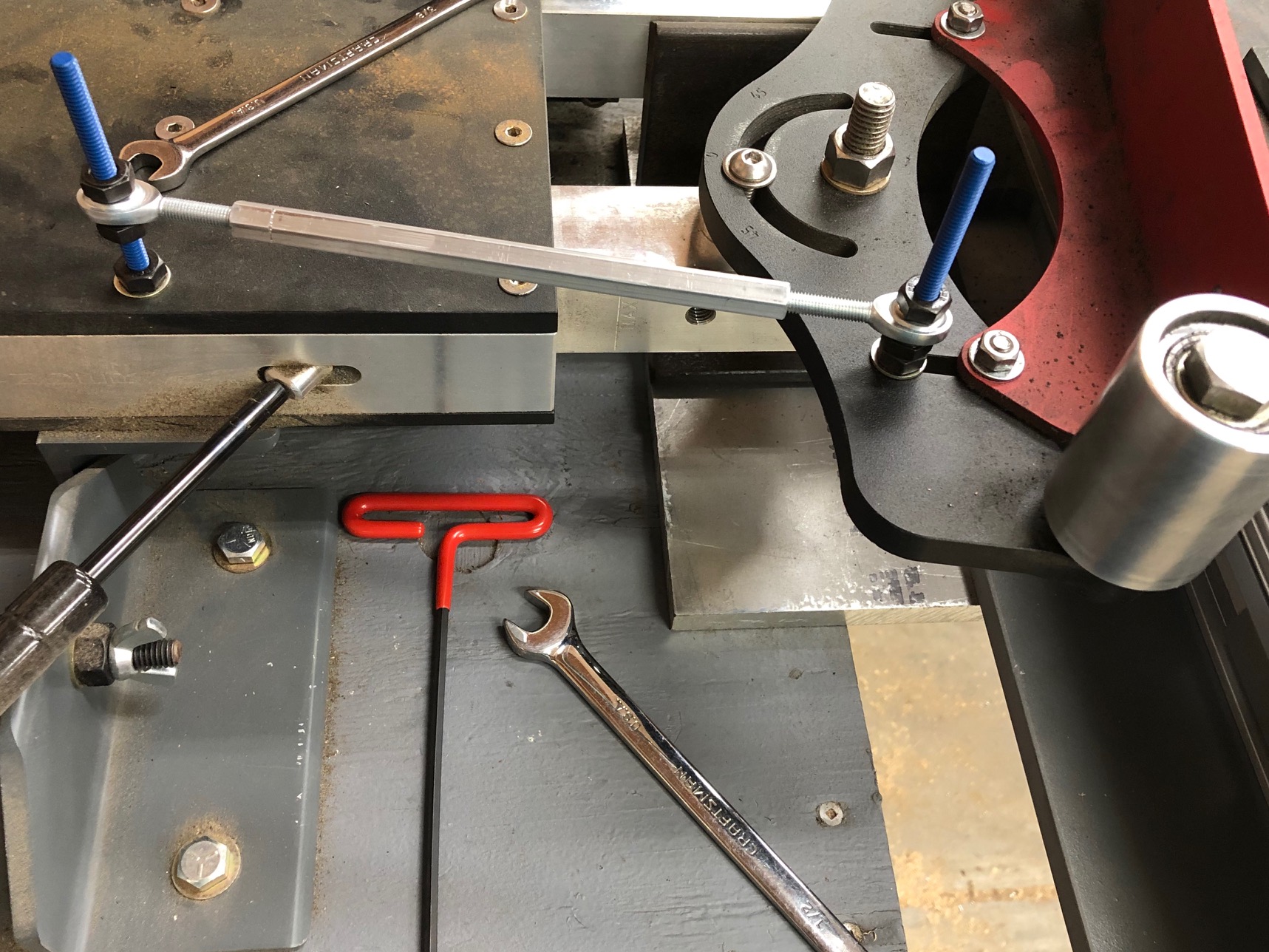

#15

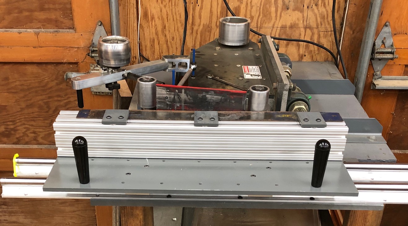

I had to order some specialized hardware for the fine adjustment mechanism so that took a couple days. Installation took two minutes if that. Didn't even have to drill any holes. I am using a sort of turnbuckle with ball ends. The threads are 1/4x28. I calculate that a 1/12th turn of the turnbuckle (half a flat) translates into about .011 movement of the roller. For this type of operation, poor man's surface grinder, the angle of the belt doesn't matter. What matters is engagement of the roller to the material.
Anyway it works well. I added a couple handles for ease of use, probably safer too.
I still want to add another motion to the work table (to get both x and y motions) but that can wait until I figure out a good way to do it.

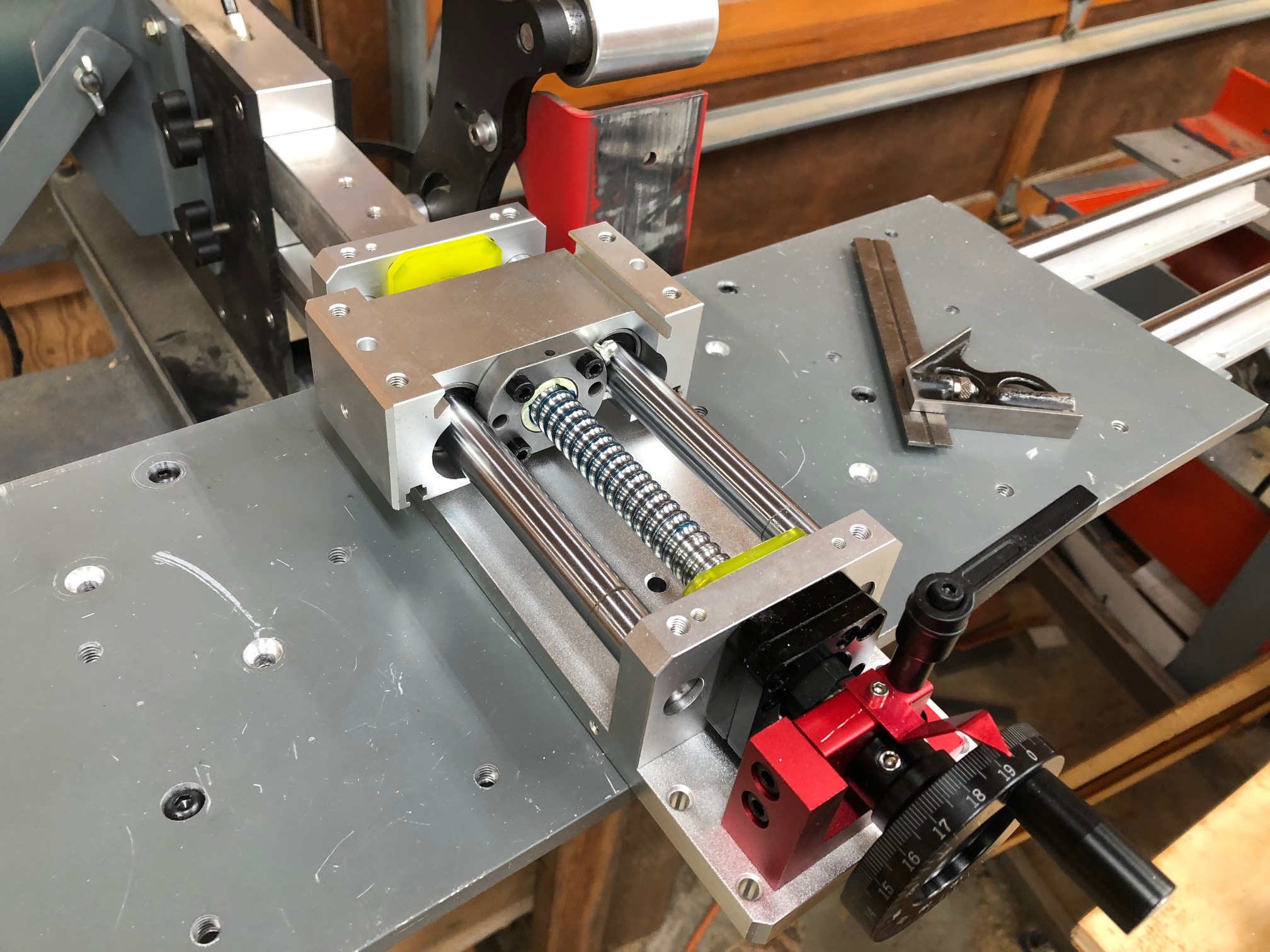

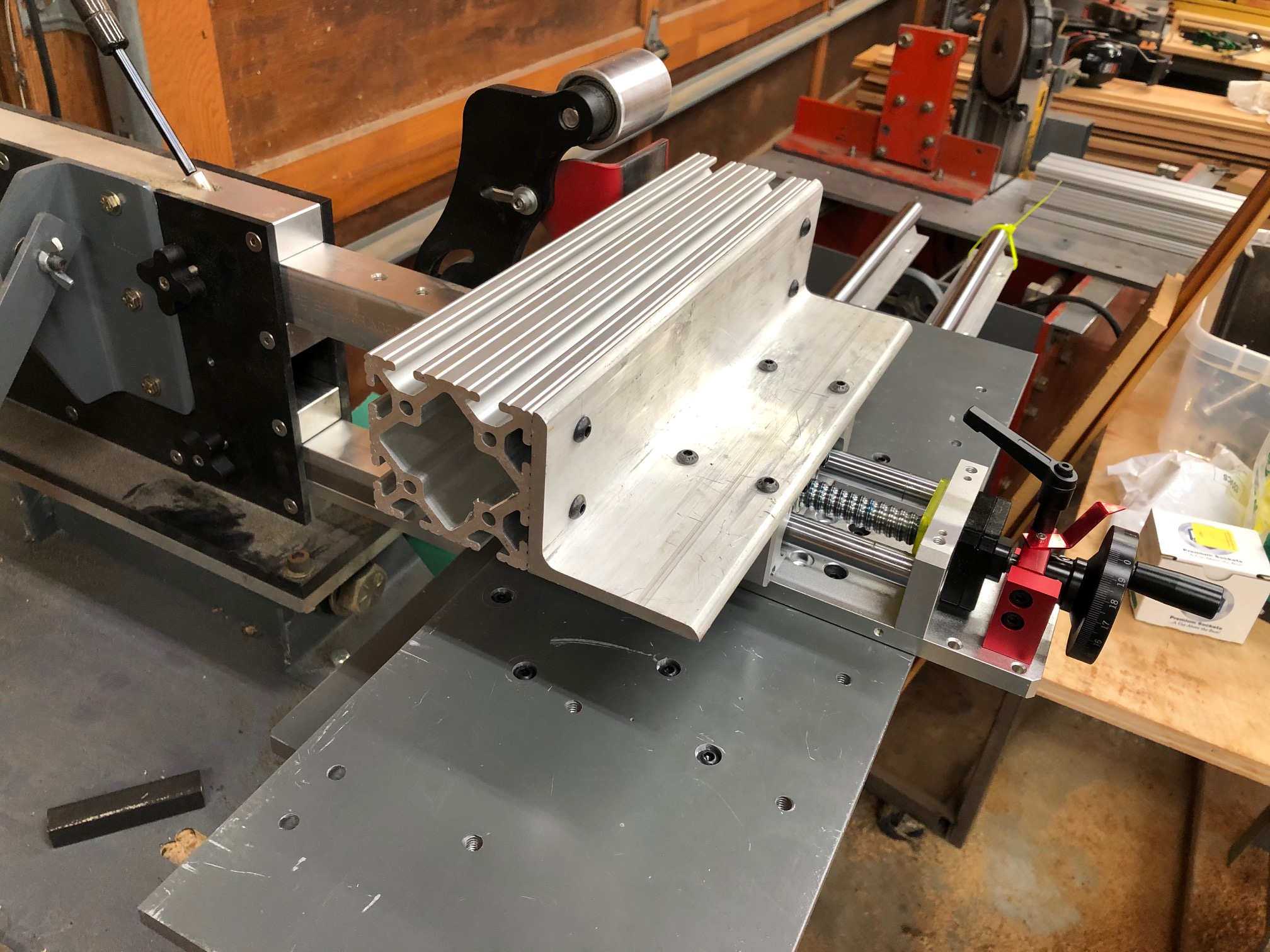

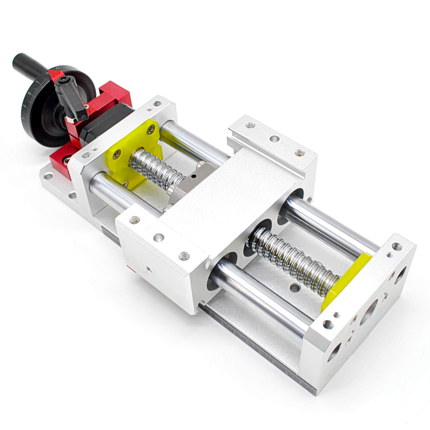

#19
