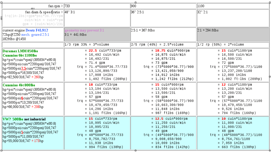

There, i added up the beans for a nominal 5000 psi setup and the pump volumes (weights) look much better now. I hope I didn't screw up the calc anywhere :)

those motor torques are in error, i made 2 separate goofs, should approximate 1500 & 1000 ft-lbs

Alright, did a little looking and a 26 series Sundstrand motor is efficient into the 400 rpm range. It is 13.87 Cuin and is a E pad mount, sooo this is a large motor FYI. I can get these rebuilt fairly reasonable. It would fit what you want to do. 55 gpm would get you 900rpm and over 900 ft lb of torque at 5000psi and 157 hp at the shaft. Soooo I hope the blower is stout!! Most don't want to spend the $$$ to do this right so I usually don't get in this deep on the net. A 23 series Hydrostat will supply enough oil to power this unit. You will need to somehow control your RPMs on that engine from load to no load, these pumps like constant smooth rpms. CJ

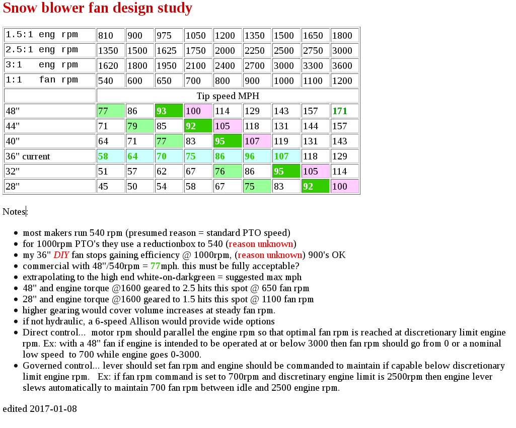

I cooked up some more #'s, they are definitive of nothing but do give me a much needed "sense" of the thing. The fan is strong enough but it sits on the original JD throughshaft auger gearbox, not sure but it's only about 1-1/4" shaft. That gearbox comes off if i go hydraulics and using the existing platform. In all cases a smaller motor will turn just the auger as is mostly done on skid-steer blowers for example. The original JD blower had been designed for about 50hp :)))
I can make a fan but this one might be based on drawings made by experts or bought as-is, they put a lot more into the design than i could and it does make a difference. The target spot is still in the left top box but "A" it's much too soon & "B" i will stray from it if i have to.

If you look at that chart, the center box is almost exactly the figures I have in post 29. If you only have a 1-1/4 shaft you don't want to play with the figures you are looking at. The hydraulic set up that was laid out will destroy that shaft the first time it is fully loaded at speed with a chunk of ice, dirt ect. Let alone a gearbox only rated for 50hp. CJ

That means I was poking around dead-center :laughing:
I haven't found those 26 & 23 series units you cited, can you give links? I need all the data including weight & maybe approx street price. As for the gearbox I'm aware of its flimsiness (1-1/2" btw, just measured it) and it's coming off except if I continue with a mechanical solution on the existing platform and with a 150hp or so engine (this combo being unlikely but they say never say never).
I'm working on the next edit of my doodle-page but I have just now run into a new issue. In any hydraulic solution except maybe the most powerful one where I might HAVE to use a big gearbox, I intend to use no gearbox but have the motor hold up the fan. This also means a separate motor for the auger and that's the current homework. I think around 100rpm would be OK and anything like 500-2000 ft-lbs. The new toothed augers with teeth are what I need to gouge up any ice and not just broom snow into the fan like some feather duster. Sooo, this will take a low-rpm high torque motor that I can bury into a pipe at the end of the auger axle, or both ends. AND the extra demand has to be covered at the pump level.

About the auger torque: the present setup delivers a maximum of about 370 ft-lbs to the impeller gearbox the sideshaft of which I think is not geared down any further as some others are. On the other hand the chain drive gears it down another 3.5 so we have 1300 ft-lbs. The torque I do have is, like the power all-around, inadequate but I had forgotten that pointed nose-down the auger actually cuts (planes) ice and frozen ground so re-evaluating it I think that even 3000 ft-lbs and more would not be out of place. But I don't know if the skid-steer blowers that use a hydraulic auger motor also use further gearing.
