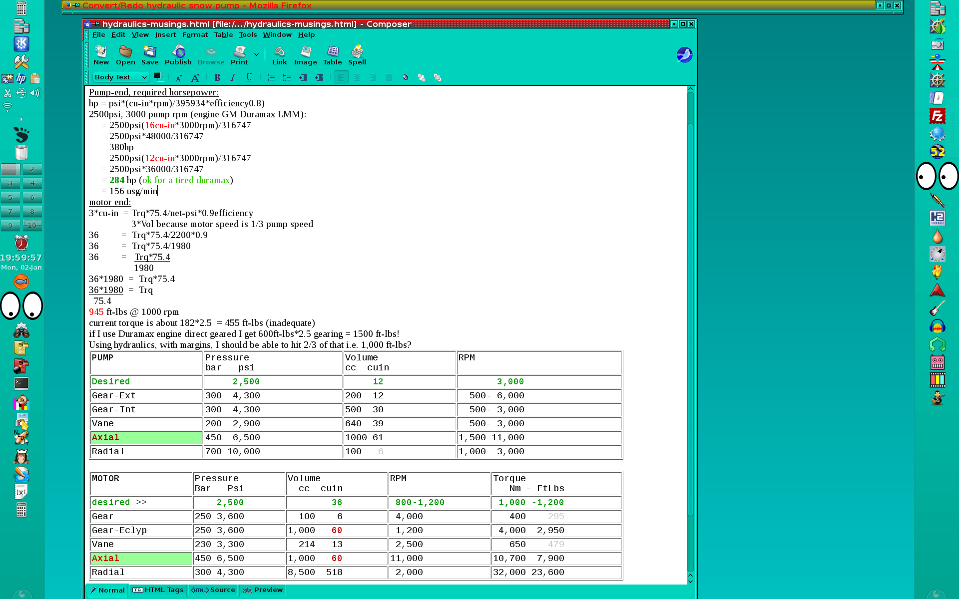

For hydraulic drive have you considered going to higher pressures?
Rexroth makes fixed displacement A2FM motors in 250 cc, 355 cc, 500 cc. All of these will operate at 5,000 PSI and speeds up to 2,000 RPM depending on the size. They also make variable displacement A6VM motors in the same displacements for use if you wanted two speed option for wet vs dry snow.
At 285 HP you can drive a pump to provide around 85 GPM @ 5,000 PSI. a 125 cc pump at 2,500 RPM would produce 82.5 GPM. Depending on the brand of pump you may be able to get manual displacement control Vs electric.
I would run this in a closed loop circuit to reduce the reservoir size and limit losses from valving.

5000 psi scares me, a pinhole leak can kill you at that pressure and DIY 300hp ANYTHING is a very violent environment. I may eventually have to re-evaluate but for now I'm still crunching the very basic formulas (been like 50 years since a few rudimentary air-force lessons & I've never touched hydraulics since!).
From what I see so far is that axial piston pump/motor is the most flexible and would easily accommodate my numbers (rpm-pressure-volume-torque). A closed system would save weight and since it would be for a SNOW blower, thermal dissipation should be OK although that may still require a radiator and THAT would be simpler with an unpressurised reservoir. I think I have already seen pumps in the 12 cu-in/2500psi range, the 36 cu-in motor not yet. It may bee too costly or inexistant.
Until now I had envisaged only fixed displacement pump/motor planning to modulate fan rpm +/- 600-1200rpm by changing engine/pump speed. I kind of do that now with the existing rig. The thing is I still have a LOT of learning to do. That 500cc @ 5k psi might be the one for me, I sure am going to bookmark it.
Some of my 'fishing' notes:

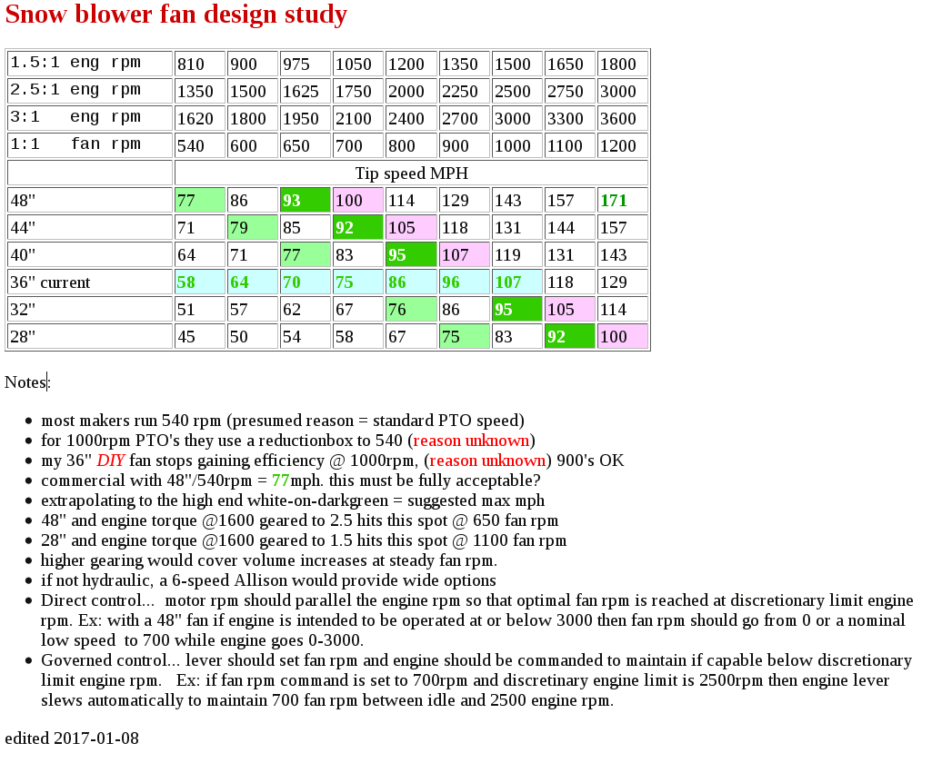

I've been tinkering with fan tip speeds and such, here' s the results
I don't understand how variable pressure pumps work i.e. just how that pans out in practice. The last 'notes' entry on the attached image is what I would consider a pro solution but have no idea how I would accomplish it. Another possibility (if using a Duramax) would be to also use the 6-speeed Allison connected directly to the fan, giving a very wide range of control.

Variable pressure or variable volume? Variable volume pumps can be controlled via pressure. These pumps would have a control that senses pressure and at some preset point the control would start to reduce displacement to maintain a constant pressure.
If using a closed circuit pump like a hydrostatic transmission you can proportional displacement with pressure override. This allows you to set a displacement and then at a preset pressure the pump will start to reduce displacement.
On both of these example the displacement will increase if the pressure falls below the set point of the control.
Do these definitions help at all?
