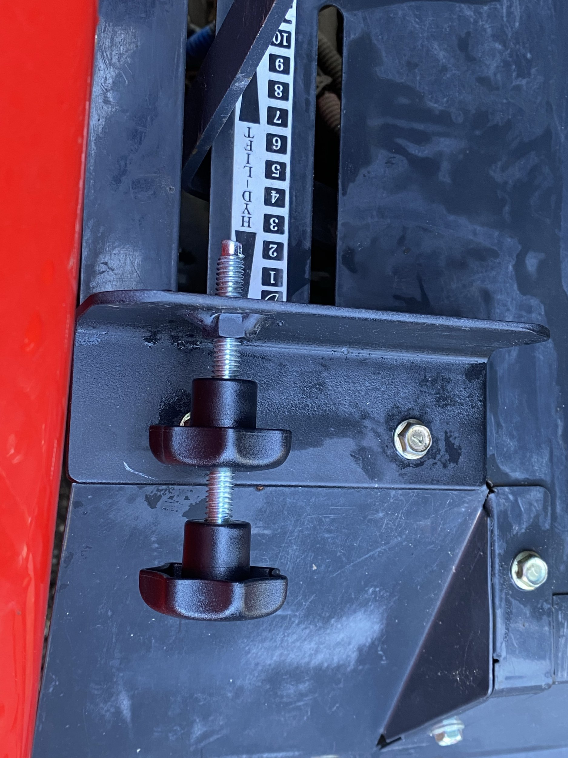

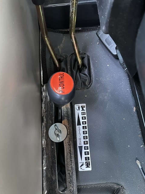

If I understand your question you can control the depth with the lever. You may want a stop if you do not have one. If it is open station, Branson has one you can purchase. If it is cab version you may have to make something like I did.

If you are on even/level ground set your lever so the scarifier can only drop to the depth you want. Using a stop as above allows you to repeat the setting easily. As you run along the scarifier will raise above your set level when you come to harder ground. If you make an additional pass(es) over the same ground eventually you will have even depth every where as the harder ground gets worked deeper.
You can vary how aggressive it digs to some degree by lengthening or shortening the top link.

My Branson didn’t have a depth stop so I simply whipped one up so I can adjust the level. IMO it should be a standard feature. I just set the depth and just go. Not sure if it helps ya.
