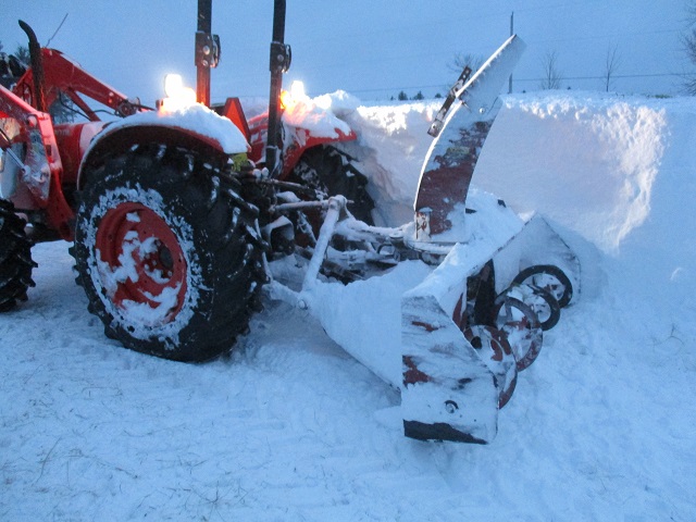

Do 99% of my snow removal with rear blower, have loader/bucket on front too. A blade would work REAL good for this kind of snow.....
/ contemplating a 3pt snowblower..... #26
I have a 40hp tractor and loader, a rear blade, a 3pt rear mount snowblower and an ATV with a plow.
1-2" - ATV with plow
2-6" - Tractor with rear blade
6" + - Rear mount snowblower
I would love to have a rear pull snowblower, and keep looking for a reasonably priced used one...

it does help to have the blower as wide or wider than the tractor - How wide is yours?- i couldn't quite figure that out from tractor data.
Is yours gear or hydro?- much easier to feather the speed with a hydrostatic. edit- i saw that its hydro- good
The beauty of a rear blower in your case is that many different widths are/were made and they are largely interchangeable rather than being model specific

The Ford 1210 with turf tires is 48" both front and rear (sidewall to sidewall). My 1210 is hydrostatic drive. It does have the mid-PTO. Have been watching Craigslist for something I can adapt to it. Since I already have the front blade and sub-frame, I'm thinking I can adapt a blower to fit the sub-frame and use a 50" or slightly bigger snow blower to work. I also have a ninety degree gear box with a pulley on one side I could use but, I'd rather not have to go with belt driven.
IIRC I have about 4" difference, and it's "OK", but would prefer more.
There are two places where you tend to fall short:
1. After doing one pass in and backing up for a second - it's almost impossible to keep between the lines.
2. Curves - even slight ones, 2" is nowhere near enough. I'd like 6" on each side.
