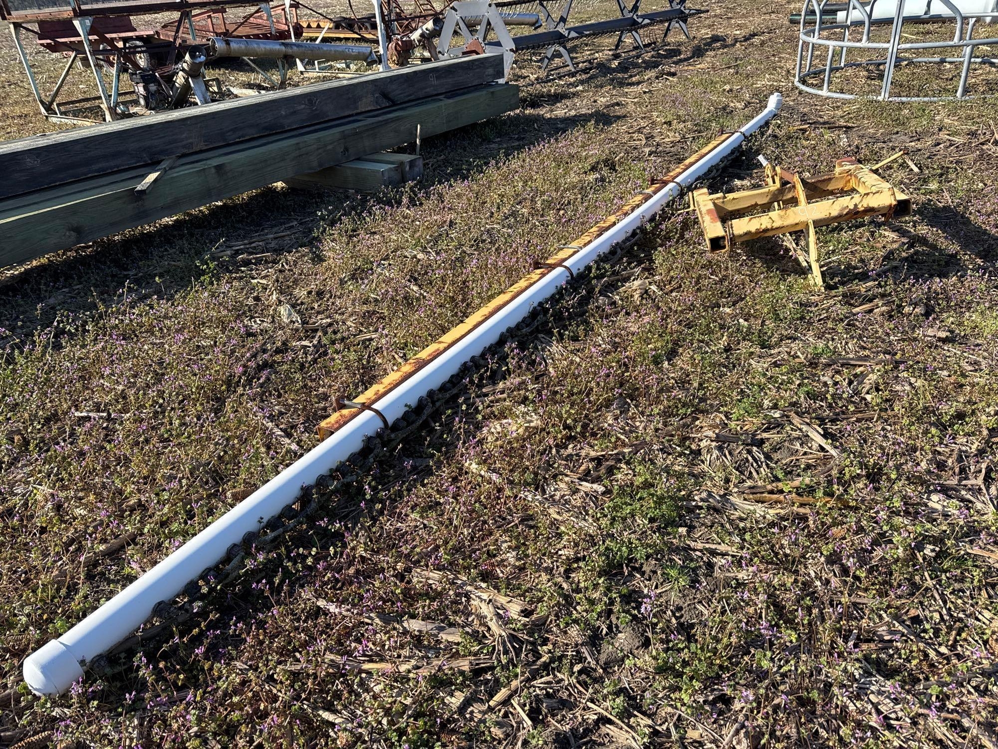

I built one in March with straight blades 96" to plane for new lawns and pastures. Made it with 60" skids instead of 48" ones. At about 950 lbs it does a very good job flattening fields or yards. I set the blades straight instead of angled since I was not concerned about maintainng a crowned road.
Steve
