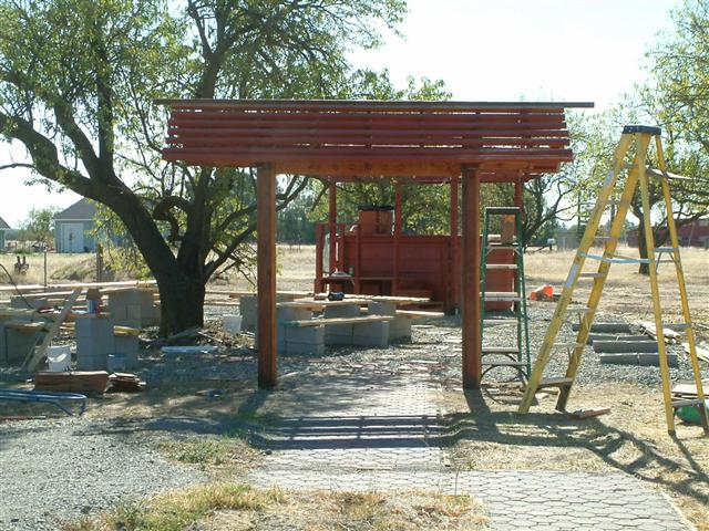

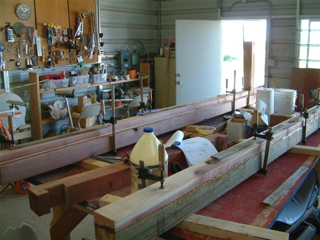

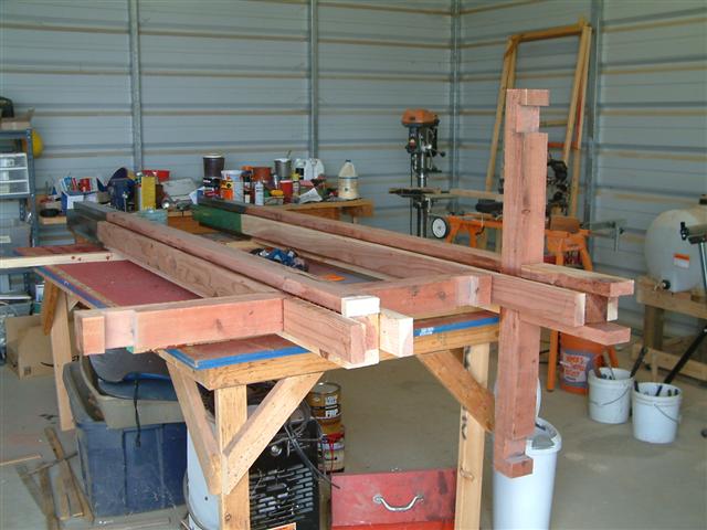

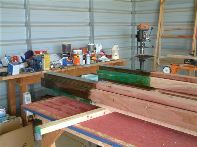

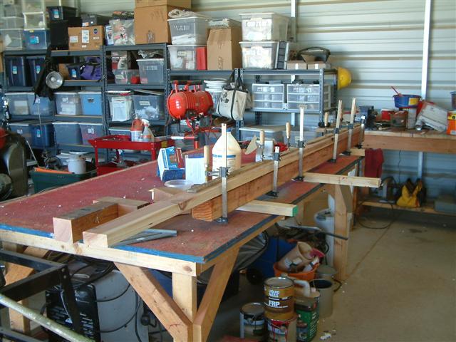

Several years ago I made a gate for my Japanese garden using laminated posts (one 4x4 PT center post with four 2x4 redwood pieces glued to the faces of the center post).
DSCF0104 (Small).JPGDSCF0116 (Small).JPGDSCF0123 (Small).JPGDSCF0124 (Small).JPGDSCF0163 (Small).JPG
Used Titebond exterior grade wood glue.
Hope this helps
Good luck

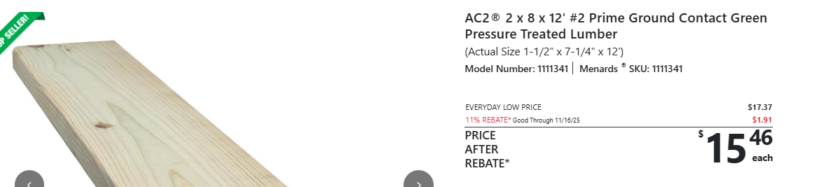

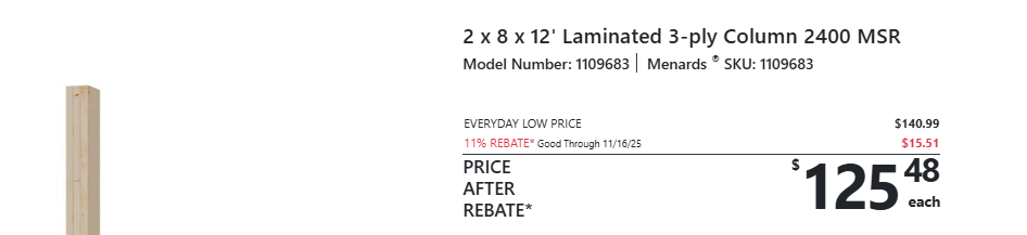

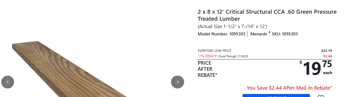

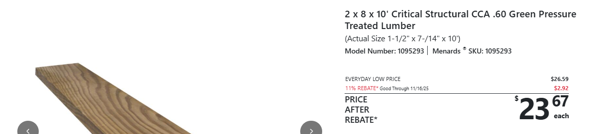

top 2 are CCA 0.6
Bottom one is just "ground contact" and I dont see a CCA value. It says "Ground contact level treatment (.15 pcf) has more than double the preservative of above ground level treated wood (.07 pcf)"
But I guess for $4, or $12 per pole get the CCA 0.6
But watch the prices. At Menards the 12 footers are much less than the 8 and 10s. And the 20 footer is less than two 10 footers!
