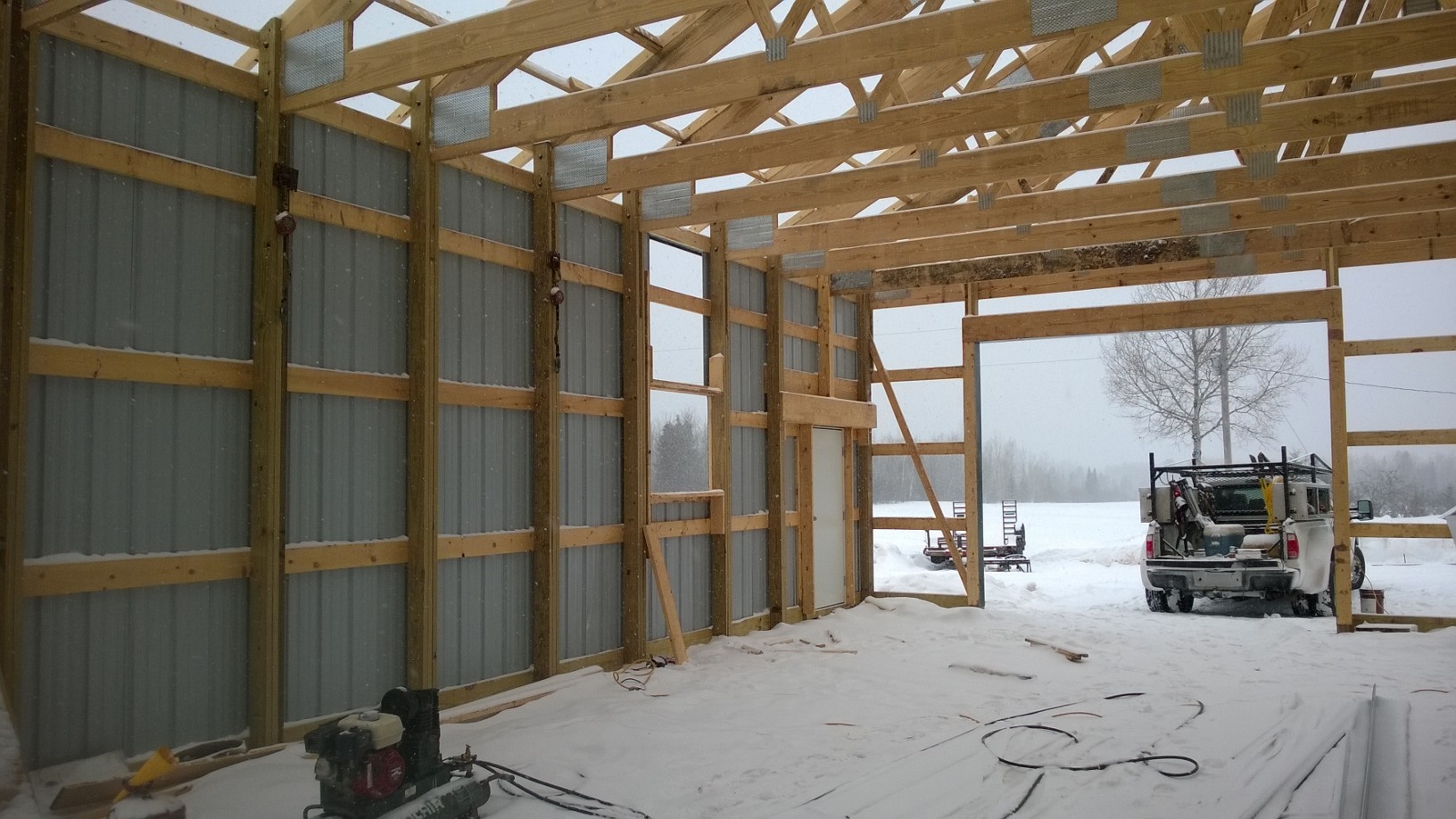

I am probably repeating what is already said, but what I have found to be the benefits of laminated posts are:
1. Lower cost -- no need to have PT all the way up, just the portion that is in the ground.
2. Better treated wood -- 2x6's are going to be treated more uniformly than a 6x6 would. Not sure how much of the treatment of a 6x6 would make it to the middle of the beam.
3. Weight - Untreated wood for the upper portion of the pole will be far lighter.
4. Ease of use - Setting your posts in the ground should be far easier with a shorter lower section of laminated PT than trying to set a 12'-16' PT post.
Morton Buildings use the build-up method for making posts. I am sure if there were problems with using them, they would have stopped years ago.
I started making some posts for building my own Pole Barn -- I made them with one 2x6x8 and one 2x6x12. The 8' piece is in the middle, and I cut the 12' piece into a 6'8" piece and a 5'4" piece.

<font color="black"> </font> I'm not sure I agree that the continuity is important provided that the building is braced adequately. I am currently in the middle of a pole barn project (I'll post pictures soon). I designed the construction according to an adjacent Bonanza horse barn (I think Morton bought them out). I am using 3-2x6 CCA to 1' min above grade with staggered heights. I will then extend these with 2x6 SPF forming a pocket at the top to drop my 2x12 rafter into. 2x6 T&G sheathing will be installed around the perimeter of the building, extending above the post joints. My Bonanza barn, with the same construction, has stood for 20 years with no problems. Now I will say that if I wasn't using the T&G sides (which add alot of stability) I would install diagonal metal bracing all the way across each and every wall.
Keep in mind though, that if you have any freestanding exposed columns that these should be 6x6. For instance, some horse barns have an overhang where the horses can stand under. These outer posts will take a lot of side impact (esp. if you have an itchy horse) and no laminated pole would be adequate.
Advantages:
Knowing I would be doing this project by myself, I felt it easier to move and attach everything in smaller pieces. The posts are much less prone to warping and twisting and the tops provide a nice slot for the rafters without getting into tricky cuts.
Another great advantage....When the gravel truck backs over one of your posts, its an easy fix. Try fixing a cracked 6x6x16. /forums/images/graemlins/frown.gif
